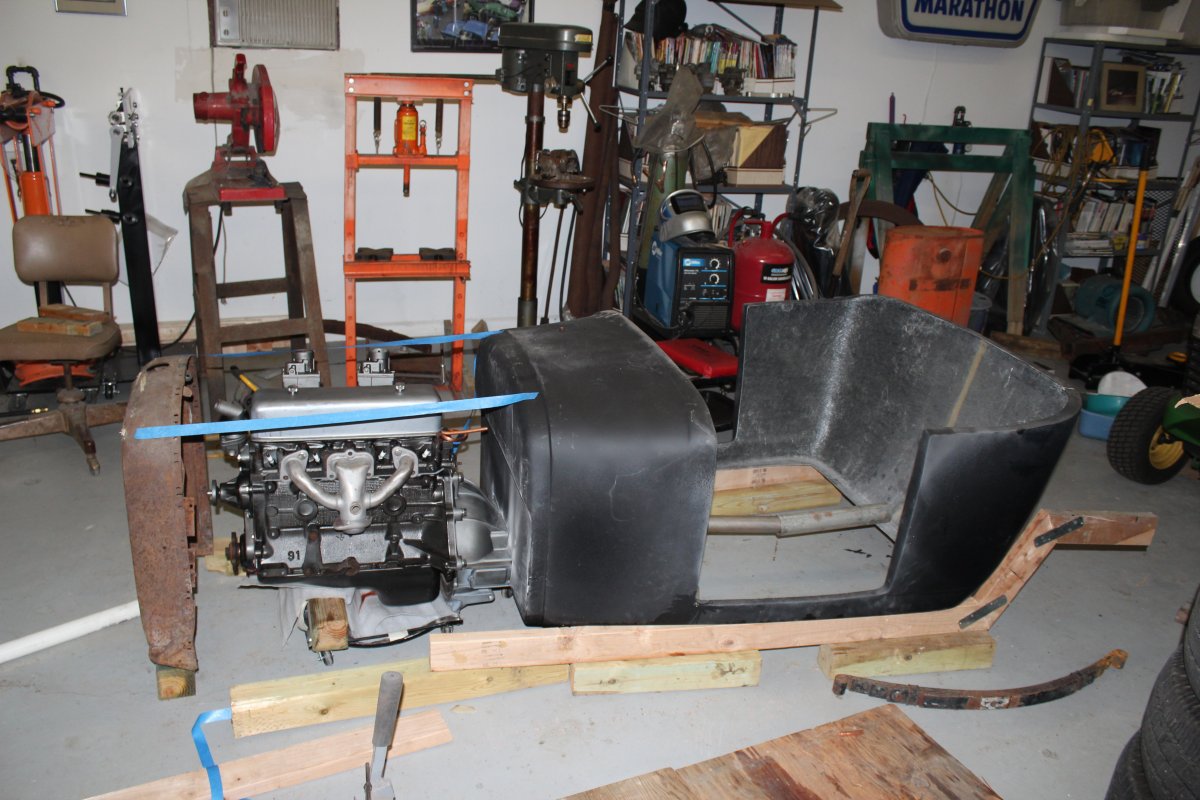

    Before I could build a frame, I needed a body. A cursory search for a steel one within my price range revealed only rust, rust and more rust. A Shadow Rods steel body would have been nice, but then I would have more invested in the body alone than I have in the whole car. All of this led inevitably to fiberglass. The only suitable, that is to say floorless, body I could find was from an outfit in Maryland. Class Glass, I think; but it's been too long to be sure. With body in hand, I could sketch out a frame and buy some steel. 2 x 4, to be specific.

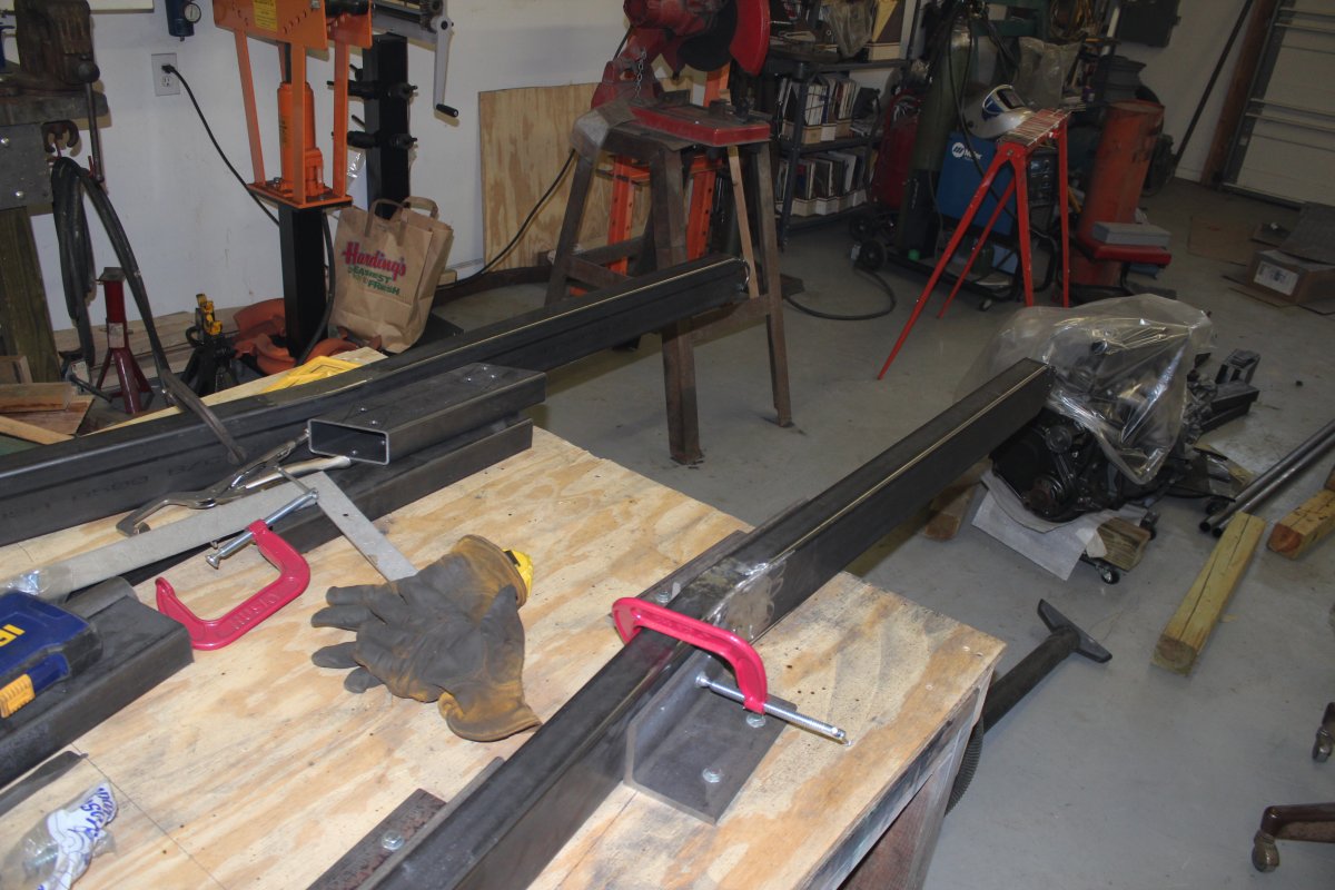

    The frame begins to take shape. Nip, tuck, weld, grind. 007.JPG 001.JPG 002.JPG 007.JPG
    kidcampbell71, scotty t and Hnstray like this.

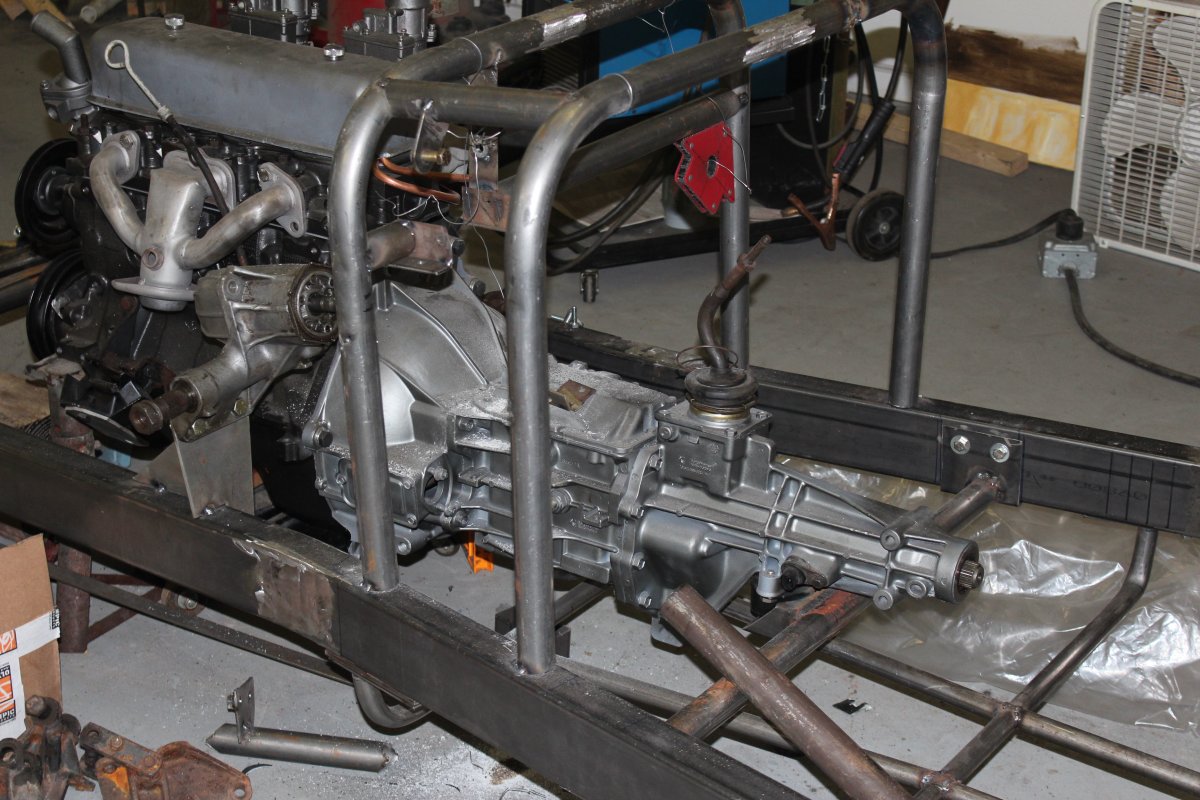

    More frame work. The gas tank was another junkyard find, this time from an old Case combine. You can begin to see the suspension plan. Everyone uses the tried and true transverse buggy spring and split wishbones. I decided to follow the lead of Harry Miller, Fraser Nash, and HRG; using over/under quarter eliptics front and rear. 006.JPG 014.JPG 001.JPG 005.JPG
