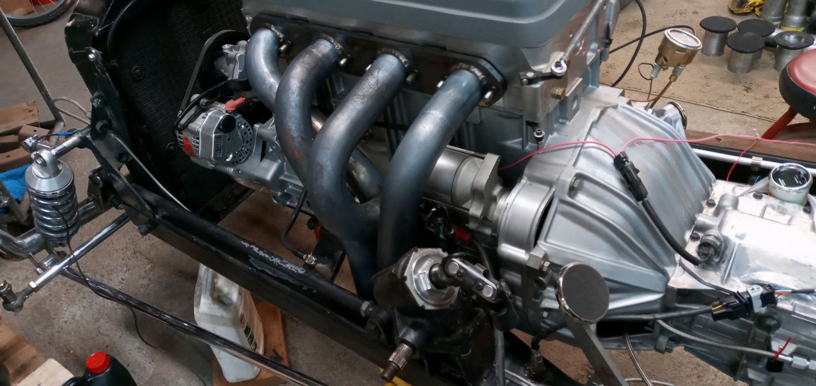

  25. GearheadsQCE
    Joined: Mar 23, 2011
    Posts: 3,402
    GearheadsQCE
    Alliance Vendor
    Dennis,
    A couple of pictures would help.
    Jiminy likes this.

    I don't understand cutting 5/8 off the block. There appears to be different blocks in this area. I have 4 engines now, one running, all of mine are the same. I had to put a pilot hole in the crank and then everything bolted up like a factory chevy set up. I know Gearheads has a block with smaller bolt holes, at least I think that is what he said. Others have reported 1/2 dowels, all of mine are 5/8 dowels, but are really tight where I had to ream the the bellhousing to get it to fit. If I would of cut off 5/8 of the block, I would be making a spacer, or have a ruined that block. I say check first before you just whack it off.
    edit
    Looking at my blocks 3 have 1/2 starter bolt holes and the one with a starter on it has 3/8 bolts.
  28. GearheadsQCE
    Posts: 3,402
    GearheadsQCE
    Alliance Vendor
    Flatrod,
    I agree, mock up and measure everything before you cut the block. I believe that the need for that modification is dependent on the input shaft length of the transmission. I'm planning to run a T5 with the Jeep case and input shaft. I also have a T5 from a Camaro which has a different input.
    I've also seen at least two variations for mounting the starter. One of my blocks has threaded hole and one does not.
    Measure, measure, measure!!!!
  29. Flatrod17
    Joined: Apr 25, 2017
    Posts: 469
    Flatrod17
    My T5 is the T5Z Ford trans, but I put all the guts into a GM case,(Camaro T5). The Ford and the S10 T5 have the same case to input tip length, but different splines. And it is the same lenght for the T56 and the Muncie I have. I went with the GM case so I didn't have to use any adaptor's. header2.jpg
