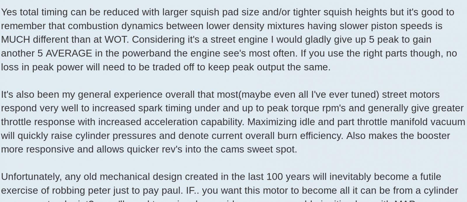

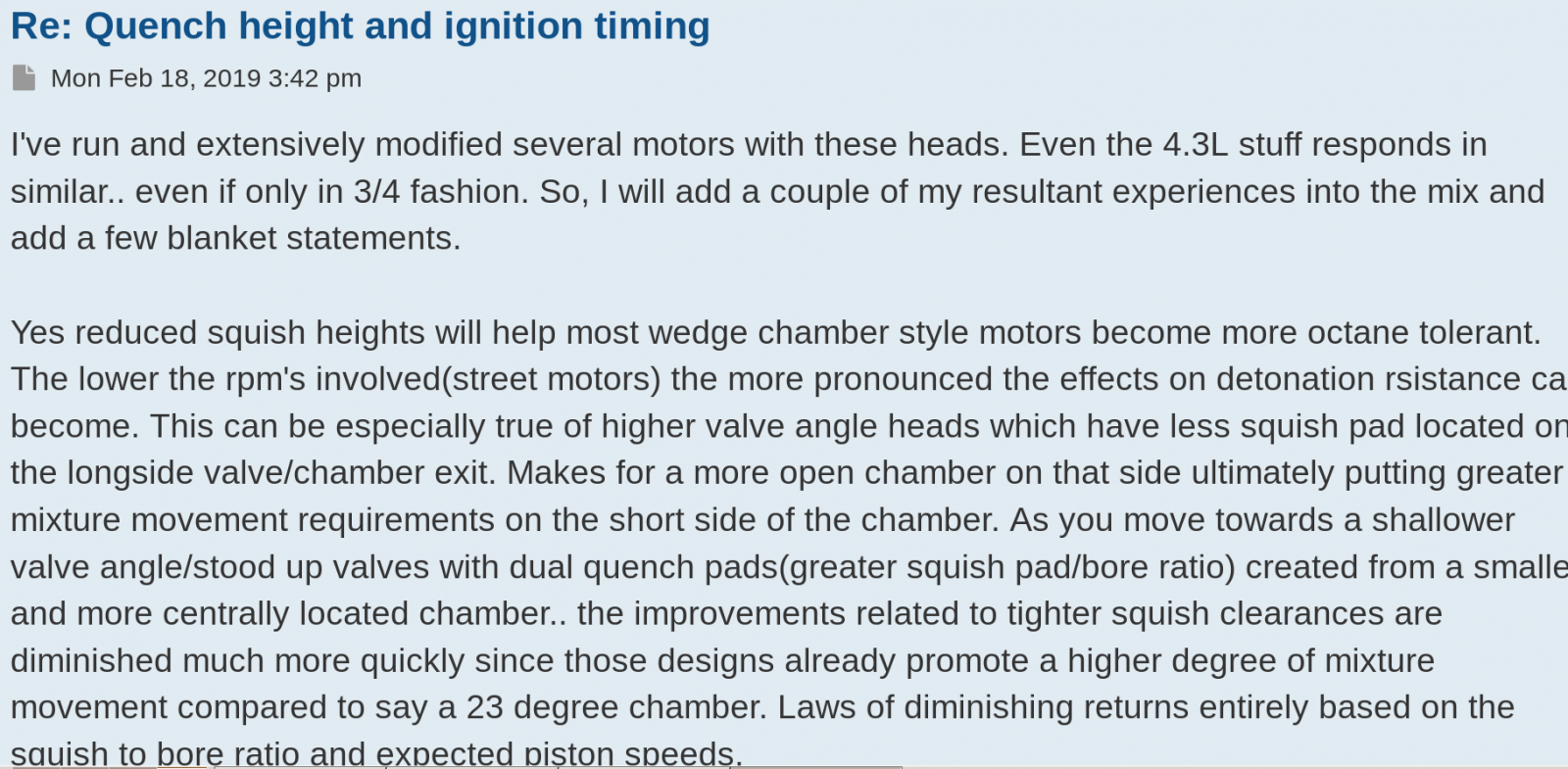

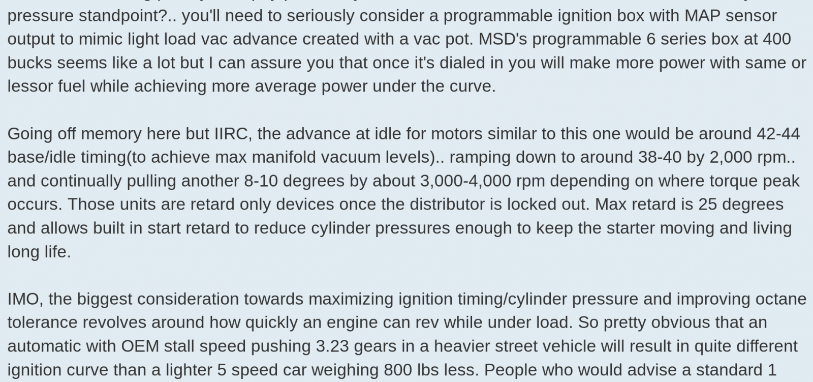

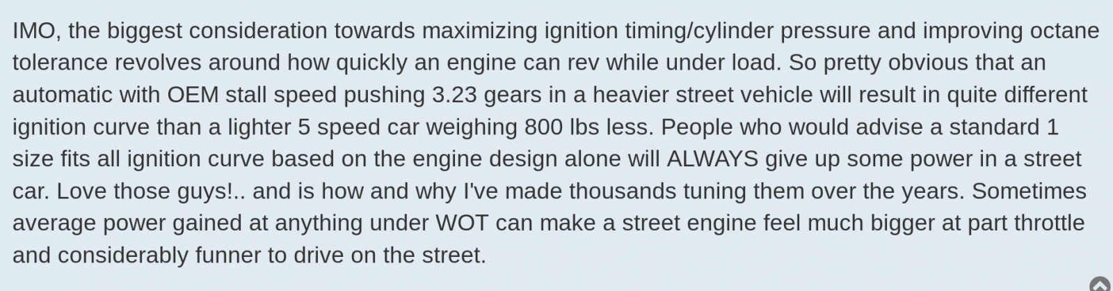

  10. There is excellent information on " Don Terrill's Speed-talk."
    Look for "Quench height and ignition timing".
    the final post explained how it all comes together and it applies directly to us.
    Especially to those of us who run at reduced throttle settings.
  11. had to do this one by one
  12. second page
  13. third page
  14. last page I took an hour to type it and still could not post it

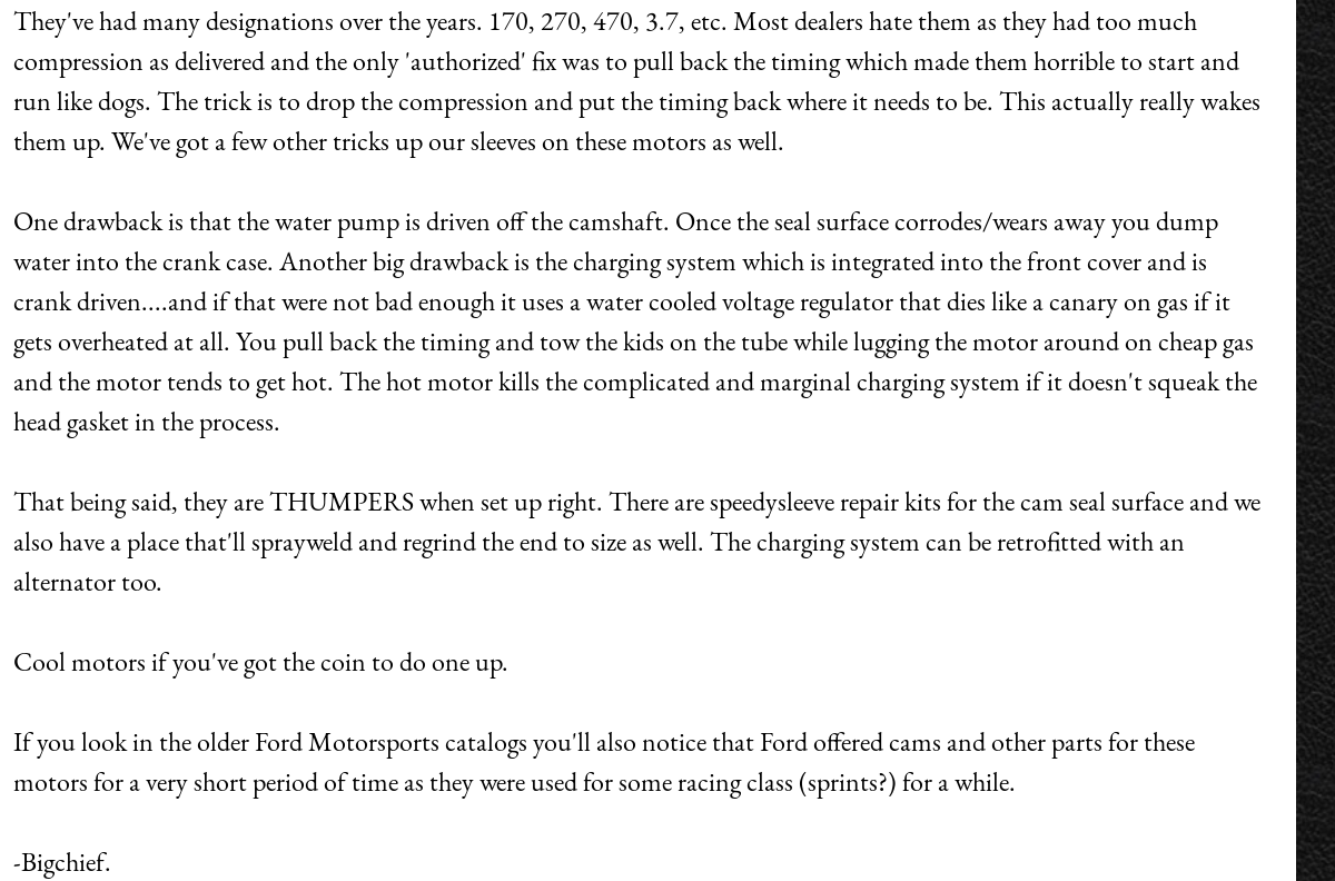

  15. Bigchief wrote this years ago, I repost it here so you don't loose it in 95 pages
