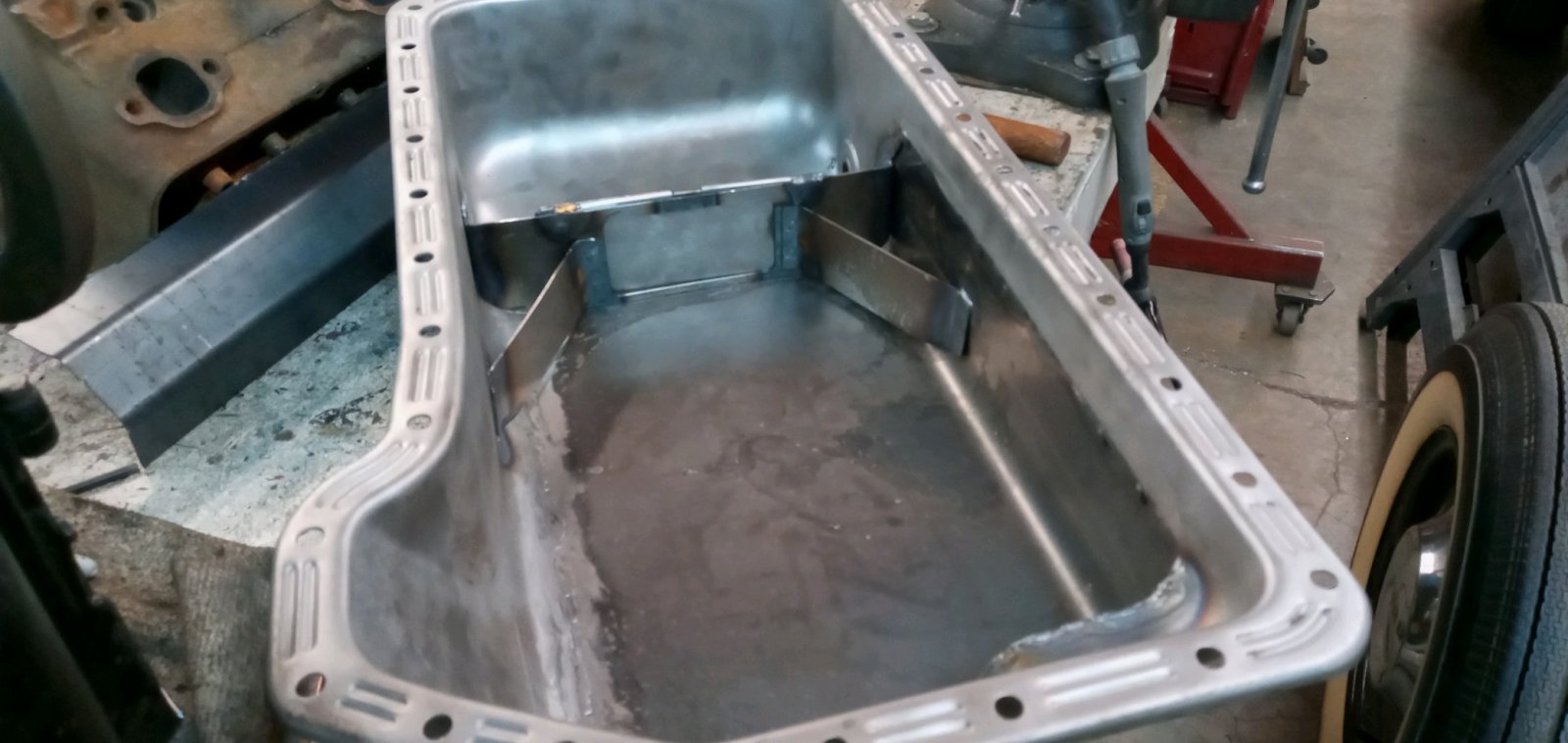

  7. Flatrod17
    Joined: Apr 25, 2017
    Posts: 469
    Flatrod17
    This is all I have done so far. I'm not real happy with it. My mind has a good picture of a weld, but the eyes and hands are up to doing it anymore! This is just the rear trap door, there will be a baffle up closer to the front. Most of the oil control will come a windage tray that will bolt on to the main bolts. It will have louvers and built something like a scraper. pan5.jpg pan6.jpg pan7.jpg
  8. drtrcrV-8
    Joined: Jan 6, 2013
    Posts: 1,709
    drtrcrV-8
    The horizontal baffle that I recommended would fit over the pick-up & below the crank throws to keep the oil from walking up the back of the block under acceleration

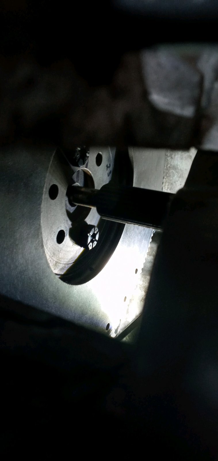

    If I can turn the discussion away from oil pans for a moment:
    Early on in this thread @dennis g mentioned that the dowel pins for the bellhousing might need to be special. In fitting up my mockup engine with a Chevy bellhousing I came across an odd situation The upper left bolt hole above the starter is only 1/4" in diameter. looks to be centered in the housing bolt hole. No problem, drill and tap it 3/8 -16. The dowel hole also looks to be in the correct position, but is 3/8" or so in diameter, not the 5/8" it needs to be. I hate to use the bell housing as a drill guide as it is supposed to work the other way around. The dowel is supposed to locate the bell. The right side dowel hole isn't even close to being centered, and the block is too long to fir in my mill. So, I'm thinking that I have to plug the hole so I can hand drill and ream it on center and then indicate the center hole from the crankshaft. Then install offset dowels to center everything up.
    Did any of you other guys have to do this or am I over thinking it. Just put the bolts in and run it. That doesn't seem right to me.
    On a related issue: since the original Mercruiser starter can't be used with the Chevy bell housing, it looks like the aftermarket gear reduction unit will be needed. With the 157 tooth Ford flywheel can the small Chevy aluminum housing be used or is the larger unit necessary? I looked at @beck s picture but it appears that he is using an aftermarket housing.
    Has anyone thought about using a different starter and mounting it on the right side of the block where the Chevy unit was? Might be able to use a more common (cheaper) gear reduction piece.
    If everything fit it wouldn't be hot rodding!

    All my bolt holes are the right size, 3/8x16. There is the upper right bolt looking from the back that is nowhere close to fitting together. I plan to leave it out as LS engines don't use it. My dowel pins however were a press fit in the bellhousing. Twice I put the T56 trans to the block and twice I had to pry it back apart. One of the dowel pins was stuck to the bellhousing, came out of the block. I have reamed the bellhousing to .625, so now it goes together ok. But I want to probably use a 4 speed and have not tried that bellhousing yet.
    I think Dennis G used the stock starter and cut out the chevy bellhousing to fit it in. Worked for him, but didn't look good to me. I bought the International starter.

    That's what I was expecting to find. I guess I'll drill and ream my block and indicate the bellhousing center hole when I do a more complete mockup. For the dowel that is way off center, I think I need to plug the hole in the block so the drill bit can be centered. I learned a long time ago that you can't drill overlapping holes:D Do you think a drill bushing would be a good idea?

    Yes a bushing would be good to use. Drilling a haft a hole should be no problem using a center cutting end mill. Start a little smaller then needed and work up to the size you need. Do you have a 90 degree attachment for your mill? I use mine when I have to do work that is to tall for my Bridgeport. If I was going to cut the 5/8 off the back of the block I planned to do it that way. My mock ups says I just need a pilot bearing will need to press in to the flywheel, or make a special holder for it attached to the flywheel. Not going to cut the block. If you have to plug the hole, I have plugged a lot of holes so that will work fine also. I usually thread a plug in so there should be no problems with it moving later.

    Yeah, I don't have a right angle attachment for my Bridgeport. I might have to buy one. Can never have too many tools, you know. That would be a good way to cut the back of the block if needed.
    The dowel hole that's there is just offset about 1/4". The plug will be completely cut away once it gets out to 5/8". I'll probably make it a light press fit and Loctite it in before drilling.
