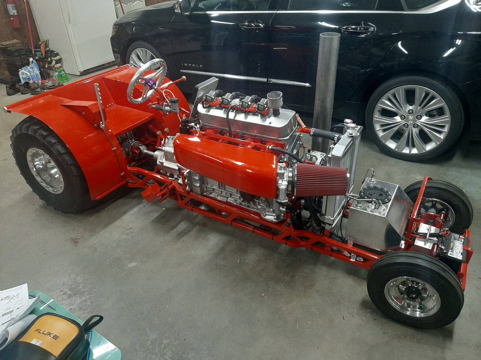

    That tractor is fricken awesome, a real hotrod tractor! The motor is pretty much what I hope to build , except I will use a pair of 50 or 55 DCO Webers, or vintage Hilborn mechanical injection. I have both to experiment with.
    Do you have a build thread somewhere?

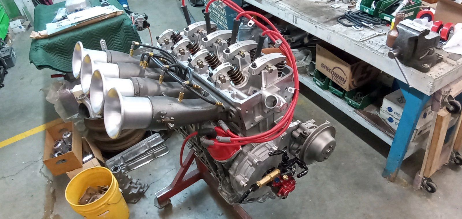

    073833.jpg As for my fake MSD dist, what would you like to know about it? I am currently gathering parts to build another one with real MSD parts.
    That's a great looking engine you have, but with your intake I don't think my dist will fit. I had to kick my injector up to get things to fit.

    Your motor is looking really good. Those Boss heads are amazing. Your injection is too!

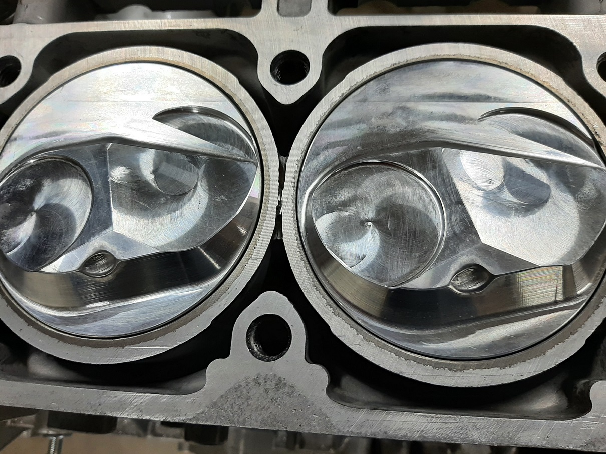

    If I would cut them I would need to figure out how much to cut off. The tops are irregular shaped so calculation would be hard. Here are the piston tops. The small dimples were required for spark plug clearance. I considered using rubber / wood / nylon blocks between the jaws and piston for a pad. I like the idea of the pin sticking out to avoid rotational slippage. I could take baby cuts allow minimal clamping pressure.
    Click to enlarge

    You won't be able to hang on to the piston without some kinda fixture like shown. Maybe if you used a 4 jaw chuck. Pistons are egg shaped, so maybe a 4 jaw could work with light cuts.
    I would be surprised if that dome is solid, if it is that is one top heavy piston! Does your paper work with the pistons say how many cc's the dome is? Do you have a way to measure cc? Find a online compression program and play with cc input to find what you need, then when you know you need, say 10cc less, that will probably be about .100 off the top, but yes needs to check with some way to cc it.
    I don't care for your pockets for the spark plugs. I think you will find it would be better to put in a fire slot as we called them, to get the spark to spread up over the dome. If the piston is solid adding a slot will knock off about 3 to 4 cc from what I have in my mind.
