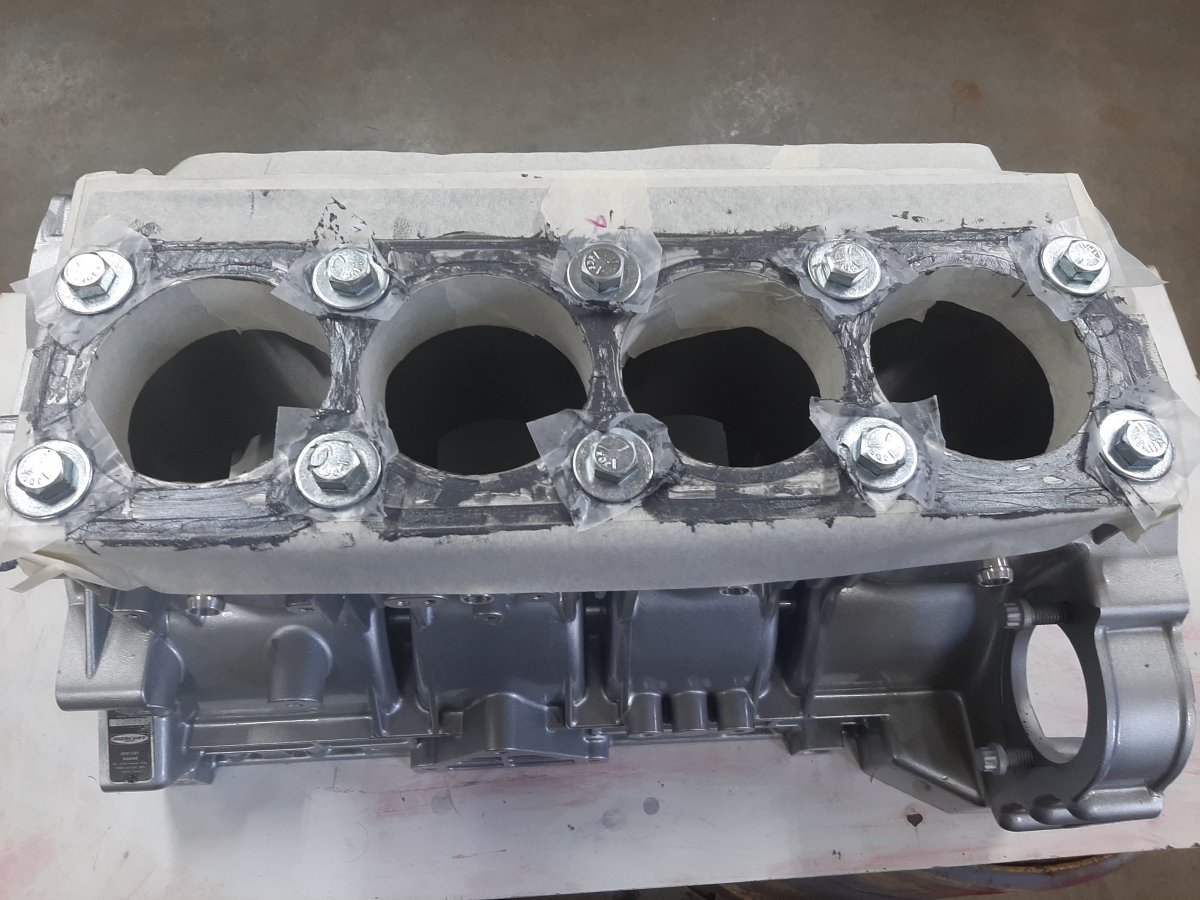

    I have been very hesitant to post the following, being afraid readers will see this as a successful modification. This is nothing more than a TEST. I am unsure if the epoxy will hold up to the heat and stresses of usage. I doubt this block will ever see service, so further information on its success or failure is doubtful. The following information is an explanation of how I did it, NOT a “how to” on it.
    I had been stating that I thought epoxy would work to “glue” a deck plate in. Further research on most of the epoxies showed that it would probably fail due to the heat. Most manufacturers rate the upper heat of their epoxy on when it totally fails. There is another temperature that they don’t rate. That is when the epoxy starts to get soft.
    For example, the epoxy used on Ford truck bed sides is loosened with a heat gun. Somewhere around 185 deg F the epoxy softens and is separated by prying the pieces apart. If the epoxy softens when used holding a deck plate in the clamping pressure on it would push it deeper into the block destroying its seal.
    There were a few candidates that have better listed properties. Cotronics Corp has 2 possibilities. Duralco 4540 and Durabond 454B. They appear to be nearly the same, 454B is thicker. They are both rated to 500 deg F. Unfortunately Cotronics has a $100 minimum order, so I did not order any to test. I know nothing about that manufacturer.
    My other option was silly simple, Original JB Weld. JB Weld is rated to 550 deg F. Most of us are familiar with the product. A 10 oz. package is available online for about $14. One of these is enough. Some of the epoxies set fast enough that I wouldn’t have had enough time to “butter” all the surfaces before assembly. JB Weld has a fairly long working time.
    The outside nightly temperature here has been in the mid 30s. I left the heat off in my garage overnight to cool it down to further slow the cure time. It was about 60 deg. After I had everything “glued” I turned the heat back on to 70 deg. I put a couple little electric heaters at the ends of the block to bring it up to about 80 deg.

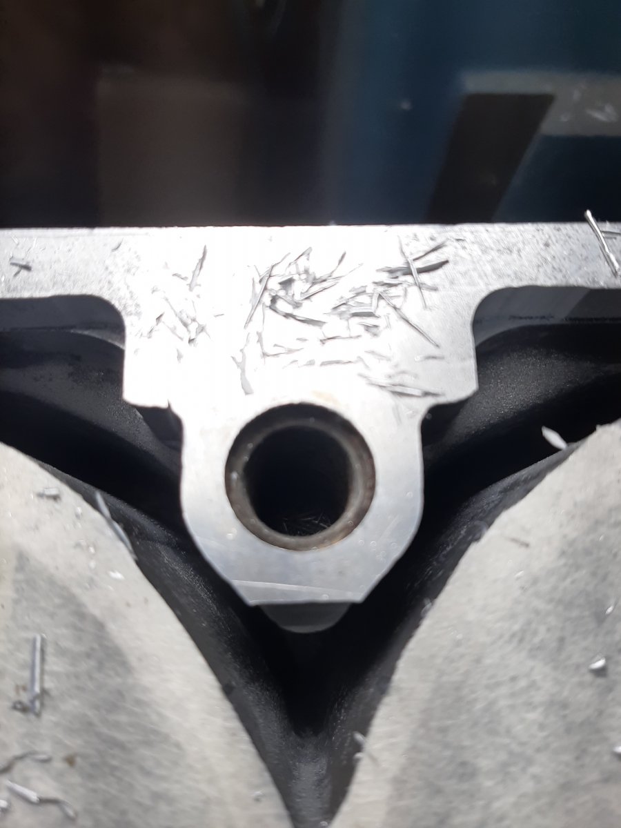

    I have a small mill. I mounted the block on the table and trued it. Using a 3/8” end mill I cut .360” steps at all the bolt bosses. That would give me a stop when putting the 3/8” thick deck plate in. I used the end mill to slightly cut all the perimeter of the block. That took it down to clean metal. I cleaned the cylinder ODs using a ¼” sanding drum in my Dremel. There were a few places to tight for it which I used a small stone on. The metal has to be clean for the epoxy to stick.
    I cut the plate from 3/8” 6061 plate. It wasn’t easy. I cut the outside dimensions using a table saw. Wear safety glasses! I then cut the bolt notches using a band saw. The blade won’t turn tight enough so little wedges need to be cut out. I thought I would be able to cut the cylinder bores out on the band saw, but my blade wouldn’t turn tight enough. I struggled through the 1st hole cutting wedges. The other 3 I marked the center and used a 4 ¾” hole saw. That still isn’t big enough. I used a big end mill like a spindle sander and removed the rest. There were a lot of hours fitting the plate to the block with a file and carbide burr.
    I intentionally put a gap between my spacer plate and the block. I thought a tight fit would cut the epoxy off of the parts as I put them together. I didn’t have a problem getting the pieces glued and assembled by myself. It is really messy. Initially I used gloves, but the epoxy basically pulls them off. I wound up with bare hands. Once I had the parts together I used a 1” piece of body putty spreader to work the JB Weld into the joints. When happy, I put some wax paper under 9/16” washers and bolted it in each head bolt hole. It was quite a mess when finished. After a few days I took it to have it decked. I intentionally had .015” of the plate sticking out of the block. Because of the amount of metal to be removed I was charged a bit extra. After decking there were some small spots where there were air bubbles opened up. Using a tiny burr on my Dremel I opened these up and roughed them up to allow patching with more JB Weld applied with a tooth pick.
    I did that just a few minutes ago. After curing I will gently sand the high spots off completing the installation.
    I still need to drill coolant passage holes into the filler plate.
    REMEMBER; this is NOT a proven instillation. It is possible it will fail.
    Click on a photo and scroll left or right to see all 4 photos full size.

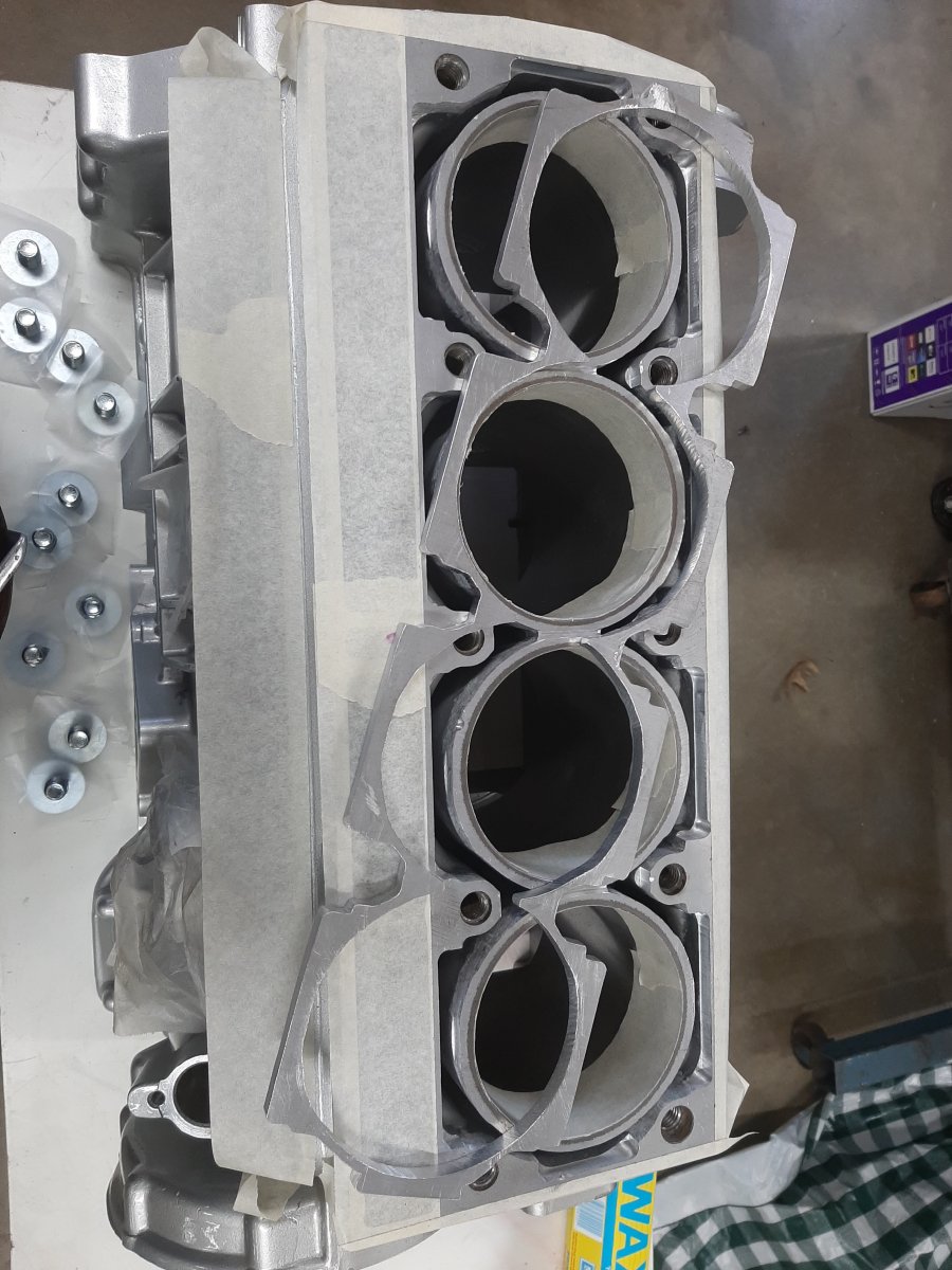

    Deck plate setup….. I would do some things differently the next time.
    If using a 1/4" or a 3/8” thick plate again I would cut the block differently next time. I would cut the entire bolt boss off to a depth slightly less than that. I would “square up” the deck opening. That eliminates cutting all of the notches in the outside of the deck plate around the bolt bosses. It does however create another problem if you are planning to use epoxy. The epoxy is going to want to run into the bolt holes when the plate is installed. A Q-Tip with acetone would help clean it up. I would grease the bolts and bolt holes so they don’t get glued tight. If it was being welded in there wouldn’t be an issue. Definitely bolt the deck plate in while welding or gluing.
    The OD of the cylinder walls is not round. Things get easier with round cylinders. I would devise a holder for a router, and make them round. The drop out from my 4 ¾” hole saw is larger than the cylinder bore. I would take one of those drop outs and chuck it into my lathe. I would cut the diameter to be a snug fit into the cylinder bore. The center would have been drilled and tapped to fit a heim joint. That heim joint would be the center pivot for a router bracket. The router will sit flat on all the surrounding block deck, it just need something to guide it in a circle. Use a cutter small enough to clear the block walls. Router bracketry depends on your router.
    Obviously I wouldn’t try to cut the cylinder bores into the deck plate with the band saw. That was a failure. Using a mill and having round cylinder ODs makes it much easier. Using my 4 ¾” hole saw I would cut the 4 bores on 4.9” centers. I would then swap the hole saw for a boring bar and gently take the holes to the correct diameter. The cutter will want to snag on the opening. Take into consideration how much clearance to add. Whether you’re using epoxy or welding, you will want some clearance. If it is a tight fit and you’re welding there won’t be enough penetration and when the block is decked you will probably be back down to the joint. If not it will be very weak.
    If you’re going to add big aftermarket sleeves you don’t need to worry about putting the cylinder holes into the plate. Cut the cylinders off deep enough to get them out of the way and run the plate over them. You will want to put a hole there to allow an indicator into the cylinders to find centers of the original bores.
    Now you need to measure the distance from the cylinder OD to the block. It may be different from side to side and end to end. Measure carefully, calculate your clearance on both sides of the plate into this measurement. Cut the outside of the plate with an end mill.
    Attach by your preferred method. Above I showed how I test fit a deck plate with epoxy. In my opinion I would not do that if the block machining was not completed yet. Welding is a much more secure option. The only reason I did it on that block was because it was already finished machined and I was afraid of warpage.
    1 other thing I would change. I wasn't careful enough when I was masking my cylinders with tape. Since I used epoxy and wasn't going to bore or hone again I was trying to protect the cylinder walls. I accomplished that, but I didn't get the tape high enough to protect the chamfer at the top of the bore. I need to clean that up.

    I know we discussed filling the block temporarily with sugar or soda to keep the glue from dripping into the water jacket. Did you decide against it? I would use soda and then recycle it in my blast cabinet.
    Another thought: When drilling the water passages in the deck plate, it might be worthwhile to copy the Mercruiser gasket for hole size. They obviously felt the need to force more water to the back of the block and head. It can't hurt.
    Stay tuned for my solution to make the outside of the cylinders round and concentric with the bores.

    I did not put anything in the block before gluing. I am sure there are JB Weld goobers hanging in there. The steps I machined into the bolt bosses located the depth of the filler plate.
    I have made a major coolant routing change on that block. If you look at the "finished" photo you can see a tube coming out of each cylinder. Those are the coolant inlets which will be tied to a coolant manifold. The manifold is designed to deliver equal flow to each cylinder. That should eliminate the extra heat at the rear of the motor. This is something I copied from others. The tubes are from Sweet mfg on ebay. I used 5/8 dia so I could use regular heater hose. The tubes were glued into the block holes with JB Weld. I am building the manifold out of copper water line fittings and tube. A 1/2" copper tube is 5/8" OD.
    I have also modified the crankcase venting system. 2 fellow tractor pullers running these engines have issues of spraying oil out the valve cover breather when they really rev their engines. At high RPM the motor over oils the top end putting a lot of oil in the valve cover. They also have some blow-by when turning that RPM. That creates a battle in the oil drain back holes. The blow-by wants up and out. The oil wants back down to the pan. The blow-by wins taking oil out the valve cover breather.
    Since I moved the coolant inlets to the side of the block the old inlet was plated off close to #1 cylinder. I was using JB Weld everywhere else so I just glued an aluminum plug into the hole. I drilled a hole in the timing chain cover and a few in the block to connect the crankcase area to the old water inlet area. I added a vent tube going down the front of the cover. This is now my crankcase vent. This eliminates the fight between the blow-by and oil draining from the valve cover. I am also adding another drain tube from the side of the valve cover to the fuel pump block off plate.
    As I stated above; This is a test, not a "how to".
    I wonder if I could get sponsorship from JB Weld. This sounds like a commercial, but I have no connection to that company.
