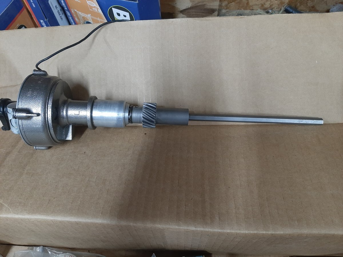

    I'm going to re-ask a question I ask here back in 2015. How is everyone mounting their oil pump? There is a Mercruiser tool to align the pump with the distributor shaft. It is no longer available. dennis g posted back in 2010 that he shimmed the bolts to center them in the oil pump housing. That centers the pump with the bolts but possibly not the distributor shaft. Does anyone have one of the tools? If so a photo would be nice. I'd like to make something like the Mercruiser tool.

    I had read that. I cannot open the photos since I'm not a member. I don't like the idea of the white plastic. I machined some last week for chain idlers. It sure machines easily but it isn't as rigid as a metal part would be. I had considered trying to design my own similar to that. I would make a sleeve that fits into the block like the distributor. I'd put an oversized steel shaft in it to reduce flex. It could be nearly the diameter of the cam gear, since my cam is in. I would reduce the shaft where it went into the pump. I wouldn't put a hex on it, just a round end that was the diameter of the flats of the hex.
    Do you think that may work?

    As I was reading that write-up, I was thinking the same thing. Maybe just a mock distributor housing with a round protrusion at the end.
    What is the size of the hex shaft?
    Is there a way to dowel the pump once it is located?

    beck
    The shaft is 5/16" hex. A cut off allen wrench could be used on the pump end if a hex was desired.
    It has been a while since I looked at the bottom end, so I don't know if the pump could be pinned. I don't know that I would dowel pin it anyway. I doubt all the pumps were machined exactly alike. The next pump may not line up using the dowel, and you would have to transfer the dowel location to the next pump.

    beck
    Distributor. My hex shaft has some play where it attaches at the top.

    Just to document the thread for future reference:
  25. The merc distributors that I have worked with have some play at the top of the hexagonal shaft. two slugs of metal or even brazed on washers well apart, ground to appropriate diameters of the distributor would center a hex shaft in a center location for mounting the oil pump.
  26. It will work. You could use 1/8" pipe for most of it, build it out with two rings fitting on the pipe, 1 above and 1 below the camshaft location.
