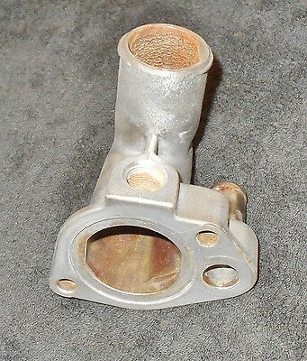

    The 488 thermostat housing (it has the t'stat recess and matched the 1-1/4" nipple in the head) connected to a Chevy housing in the upper hose. (I used Cosworth Vega as also 1-1/4" but a straight 1-1/2" would be more universal)You need to slightly elongate the holes.

    I was looking at the SBF 90 degree thermostat housing on my OT 5.0 Mustang last night and then looked at one online. It seems that you could cut a water port in the end of the cylinder head, very much like the stock port, and then drill and tap to apply the 90 degree elbow. On SBF intakes it mounts to a flat surface, housing the thermostat and providing a bypass port all within the elbow. There are other angles for this unit as well, if a 90 is not to your liking.
    You just need a flat surface to attach it to on the end of the cylinder head. There are a number of ways to achieve that if it doesn't already exist. Most aluminum heads are very close to completely flat already. You could epoxy fill the engraving and smooth it for example. If executed well it would look as if it were designed to be that way.
    And in this pic you can see the recess to house the thermostat

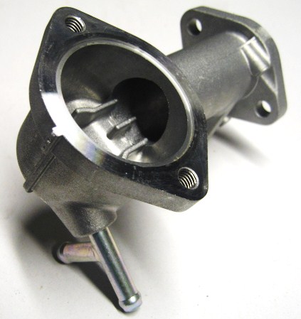

    I don't know if its of any help, but the Mazda Miata has an extended thermostat housing with a barbed fitting for the heater.

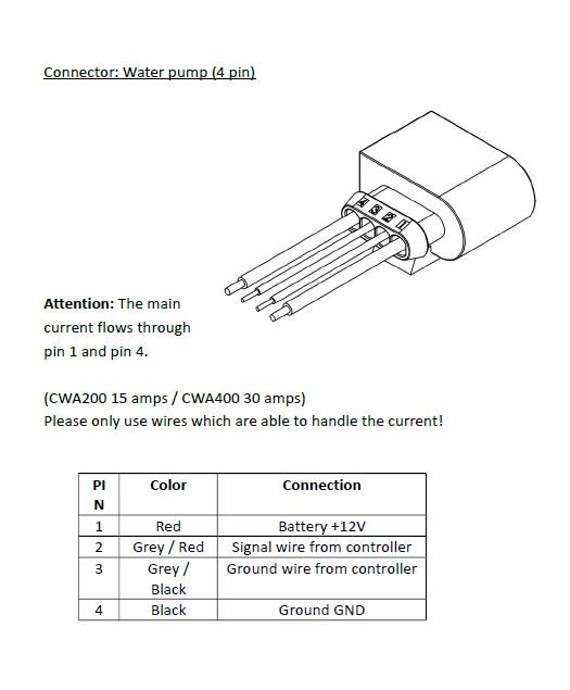

    I still have not ran my motor. Mine is a competition engine. My cooling plan is to run the electric water pump used as an intercooler pump on the Ford Lightening. This will be plumbed into the hole where the original water pump fed. The outlets on the intake manifold surface will T together feeding back to the radiator. I have the rear of the head drilled and tapped for a water temp sensor. I am going to use a Holley EFI system. That system has the capability to turn the pump on and off, OR it has the ability to control the pump speed using PWM . The pump will require a PWM driver to run it, which was available on some Ford or Corvette electric fan controllers.
    Warpspeed has brought up some good water pressure information which I was not familiar with. It makes sense. I won't have that kind of water pressure. Now I'm wondering??
