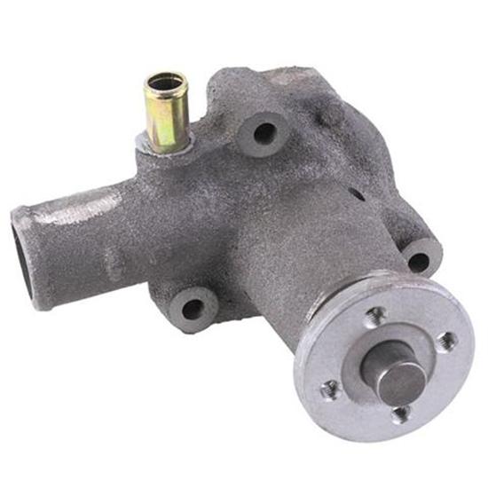

    I've been thinking the same thing but using the water pump from a 1960 thru mid 70's Ford 200 CI six. Smaller profile and has only one outlet for heater hose. Or from early 2300 Pinto.

    Pulling water from the front of the block WILL cause issues. Here is a diagram from Mercruiser for coolant flow. The intake does not need water flow if used in automotive applications. Imagine the intake connection going to lower rad outlet, port from head goes to upper rad outlet. You will need to install a thermostat in the upper hose somehow. If you will be modifying an aluminum head have it machined for a thermostat housing.
