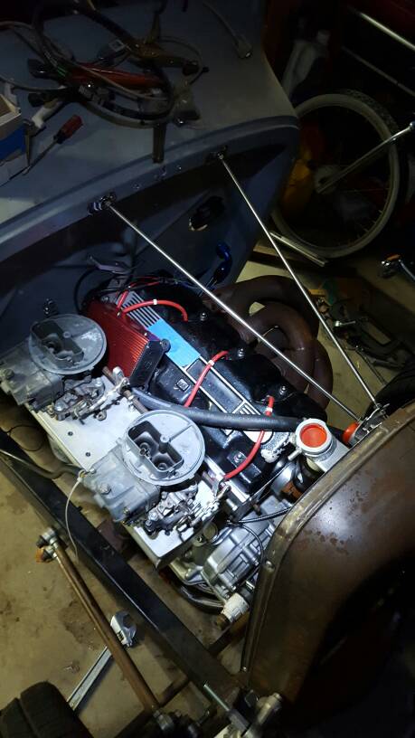

    Not yet. Just got it bolted in the car though. It barely fits. The whole car has been a 5 year project and the engine has been 3 years so its coming close now. [​IMG][​IMG][​IMG]

    So damn cool!
