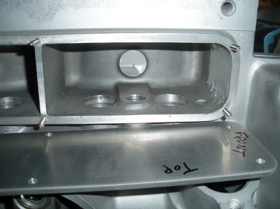

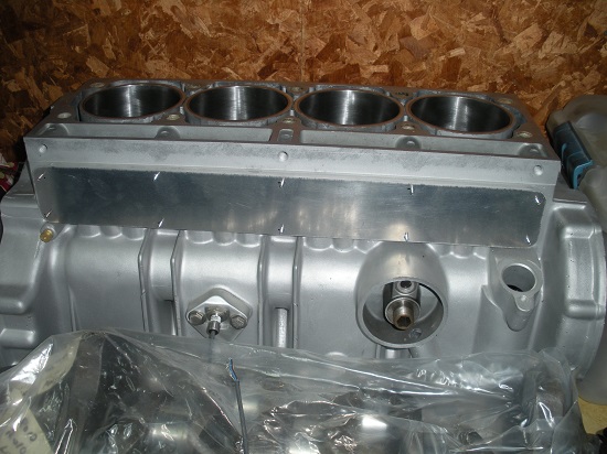

    I see a market for the lifter galley cover conversion now. I think anyone spending this much will want to go to a roller setup. Here is what I did. It requires some mill work. The bolt bosses are milled out and the gasket surface is milled flat instead of rounded. I plan to us silicone for a seal. The studs are 6-32, which is small but there isn't room for anything larger.
    The other method I have seen, which I like better than this one, is to weld threaded aluminum blocks in the galley. Place one inside each end and cut notches to put one in each of the vertical webs. That method would require a cover a little stiffer than the flat sheet cover I used.
    FlyHiFlyLo has another method he is working on, which may be better yet.

    Yes that a great way to do it. My plan is to have a milled and finned set-up from .50 plate. The goal is to have any guy with a hand drill be able to install. Basically they would drill a through hole in three center walls and a hook would grab the hole and the hook stud would stick through the plate and you nut it down in three spots and use the factory gasket. Then stick a sawsall down in the block and cut the nubs off with a bi-metal blade.
