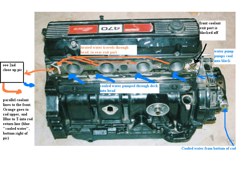

    Done quite a bit of research on cooling system routing. Some of the newest engine designs, like the Audi V6 turbo, are using some very complicated and unique routings. I feel that's one of the major ways they can run combo's like 10.3:1 Cr/89Oct/14-17+ Psi boost... and run 180,000 miles on average.
    So I got to looking at a head gasket, and the fact that I will not be using the factory casting which incorporates the thermostat housing..and I will be using a heater core, unlike most on here.
    I'm a little hesitant to be put this up on line for opinions, because I am not sure I'm done researching this, but I have a quick Paint drawing of what I believe is the ultimate cooling routing.
    I've checked that the rear crossover port can be opened up to basically whatever area I want- for sure the equivalent of a 1.5" hose.
    Thoughts?
    This would be using the factory water pump design.

    I found the pics promising but a little confusing. Can you draw up a pencil-and-paper block diagram of how this would work? If you can show radiator, block, deck, head (etc, all water passages on engine itself), water pump, thermostat, heater; and then the hose or passage sizes and all the in and out and flow direction, I think you'd get better opinions.
  21. iadr
    Joined: Apr 14, 2007
    Posts: 147
    iadr
    rad cooled water is blue, hot water is orange. Arrows indicate direction. Not sure how it's confusing.
    Oh. You did expand it to be able to read the text? I know the thumbnails don't allow you to do this...

    I have also given the cooling system a lot of thought and also plan to introduce the cool radiator water from the bottom of the radiator into the front of the block where the original water pump pumped water into the block.
    I am not using the original Mercruiser water pump because of the sealing problems associated with that design. I will use an aluminum Toyota Cilica pump similar the the one Dennis is using.
    I am putting a pipe plug into the Mercruiser intake manifold at the rear of the head where you indicate that your return will be.
    The return line is going to be a 5/8" hose. If I find that inadequate I will also run a return from the front of the head.
    My very experienced Marine Mechanic assures me that he has run big blocks with no more flow than that and had no problems.
    I am using Walker Radiators that are good to over 450 hp so I do not expect any problems.
    I plan to run the hot water return through the Mercruiser intake to help with start up. I may use a cable operated heater valve to bypass the intake after warm up if that works better.
    None of my cooling system plans are set in stone and because I have so much room around the engine to work with almost any system can be developed if my initial system has some surprises.
