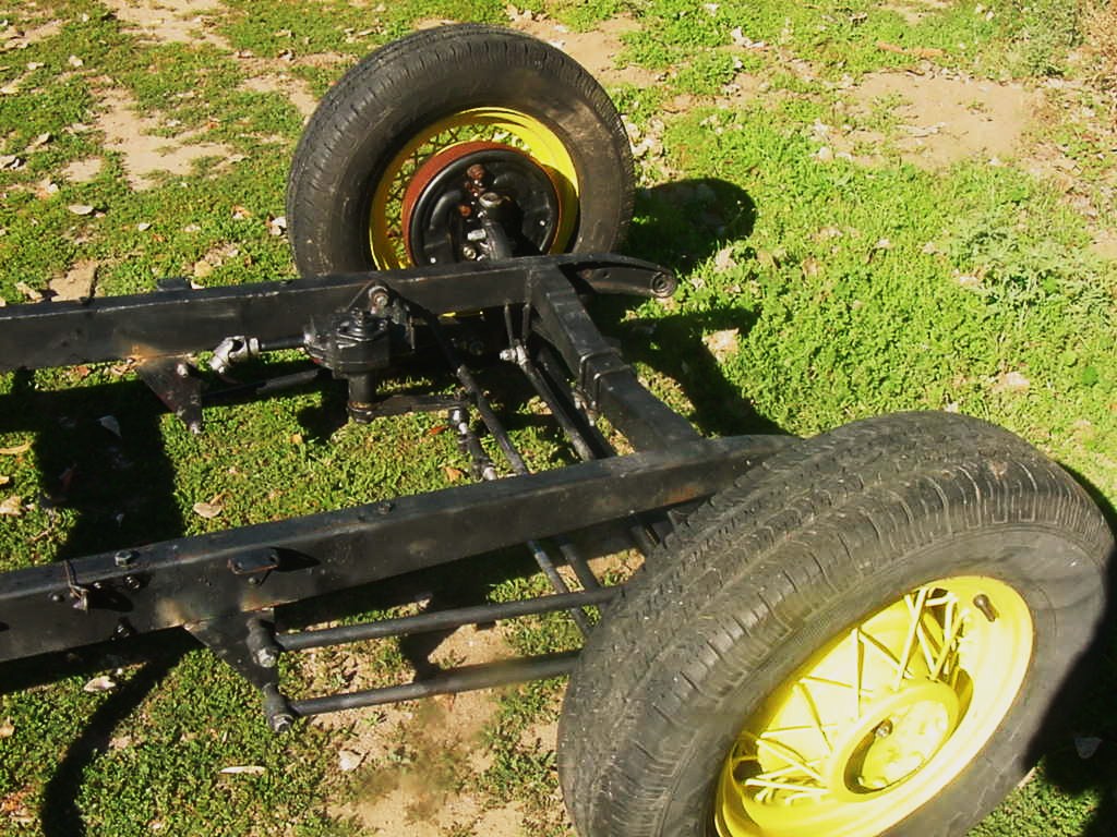

  23. dawford
    Joined: Apr 25, 2010
    Posts: 498
    dawford
    Dennis,
    The first install is going in a stealth mode stock Model A Ford.
    I am trying to avoid as much modification to the firewall as possable.
    I am using a 4 bar suspension with a Vega steering box and a cross steer setup.
    I will put the oil pan as close as possible to the steering member.
    One of the reasons that I took the original alternator harmonic balancer off was to gain a little room behind the front crossmsmber so that I could change the belt without having to jack the engine up.
    As you know it's the little things that can bite you if you don't plain ahead.
    After the first sucessful install the others will be easy. I plan to use the cookie cutter approach making improvements as I learn better ways to build them.
    I think that I have found a good basis for light weight sleepers built around the 3.7 Mercruiser.
    I start with good looking, light weight, pre-smog, 4 cylinder cars that have the room for this Big Block engine.
    So far the plans include Model A Fords, the Volvo 544 and I may even slide one into a 240Z the only 6 cylinder car I am presently looking at.
    I would call it a 370 ZX Turbo. with 300 hp and great torque it would be a fun machine. I believe that I could maintain the 2360 lb. weight while doubling it"s hp.
    I am having fun just thinking about it.
    Dick :) :) :)

    Dennis here is a picture of cross steering. Borrowed from Speedway.
    This configuration is pretty good if it is set up right there is not much bump steer.
    I made mine so that in the straight ahead position the drag link is parallel to the tie rod.
    Making it more parallel than the Speedway diagram not only makes it look better but it also allows the 470s full pan to be clooser to the front of the car while extending below the drag link.
    The steering box is quite far forward on my chassis. This is not a problem with the 470 because it has more room between the engine and the frame and the motor mounts and exhaust manifold are not going to be in the way.
    This steering box is actually a Saginaw bos off a full size chevrolet. I am trying it because I had it in my junk and it is has a quicker ratio than the Vega boxes that I have.
    I also made the Panard bar run as close to parallel and level to the axle as possible.
    Because of the lingth of the drag link and the fact that the suspension only moves up and down a few inches the arc at the end of the drag link during suspension movement is minimal.
    That all adds up to very little bump steer.
    Some cars built by those who do not understand the geometry of the straight axle suspension system have a tendancy to steer badly while hitting large bumps in the road especially pot holes.
    The steering wheel will almost pull out of your hands when the car is hitting bumps.
