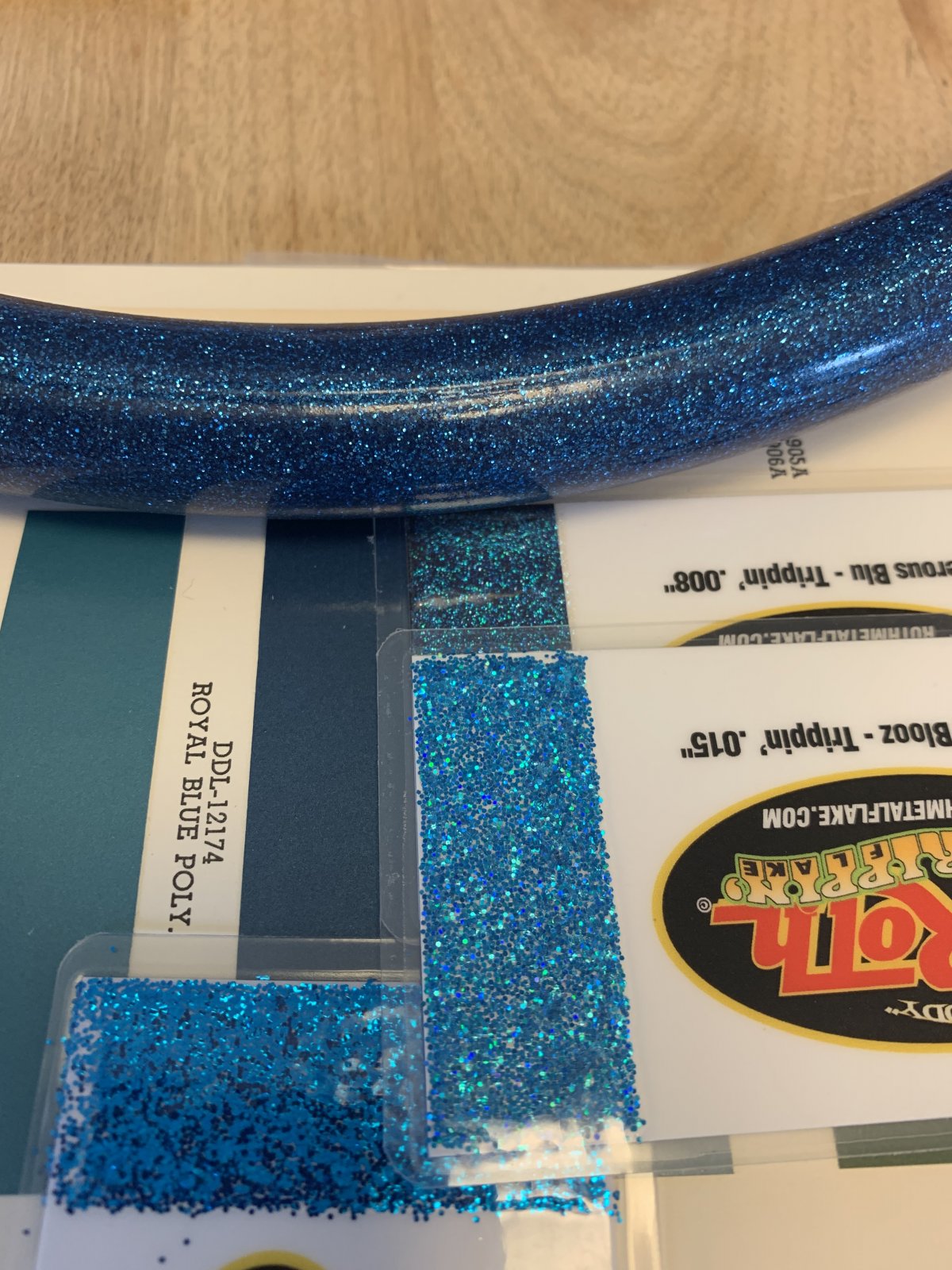

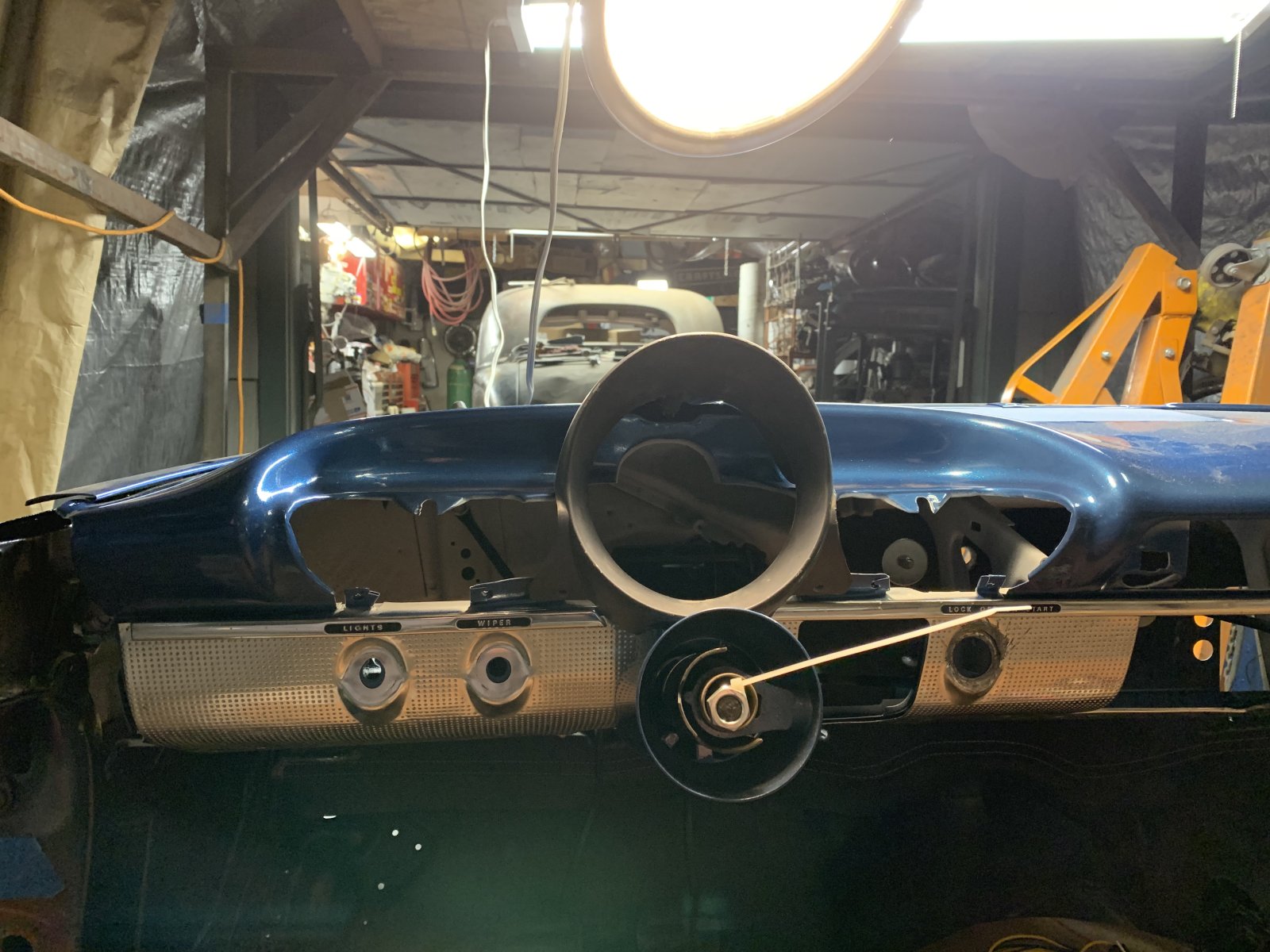

    I’m trying to get a dash color chosen. I want flake, but I also want to be able to match factory Impala upholstery colors in case I just order a kit. One of the major kit suppliers says they’ll sell swatch samples for $25 on their website, but they won’t answer the phone or emails. I did get factory paint color chips and Roth chips so that’s something…

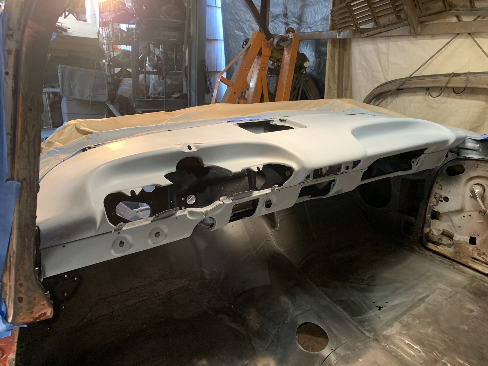

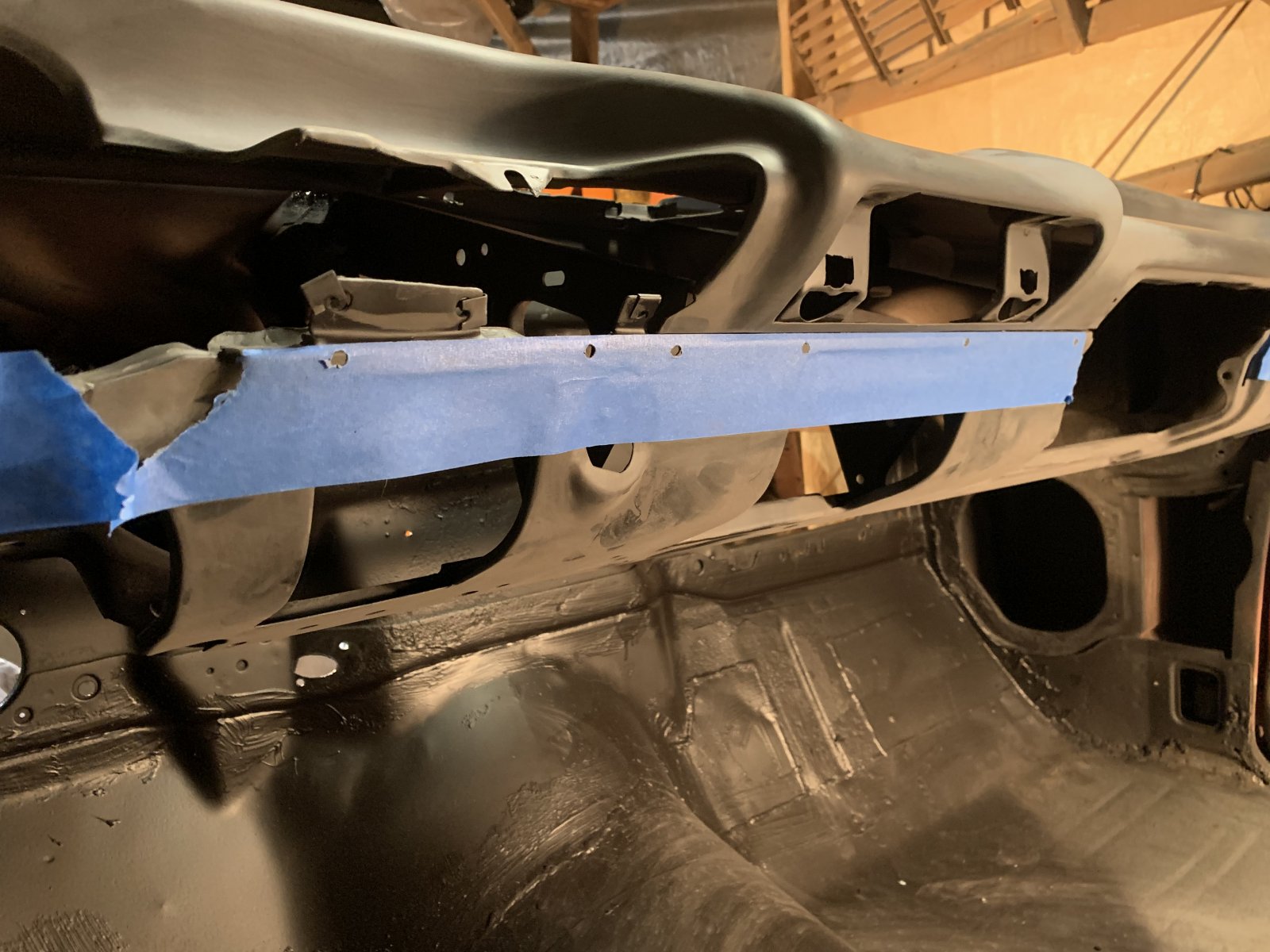

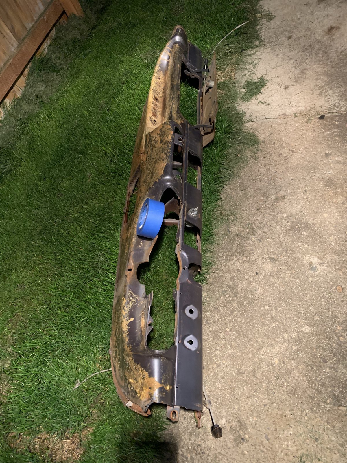

    Firewall filled and seam sealed.
    Dash sanded beaten and filled. I think whatever bent the frame left some sore knees, because there were dents on the lower portion of the dash.
    And sprayed with epoxy primer.
    I’ve got it sitting with a space heater and a heat lamp. Hopefully I don’t have cure problems. If the primer turns out, I’m hoping to topcoat the firewall mid week when there’s a couple warm days. I’ve got to get my dash paint, flake, and clear coming. I should also find my garnish molding, gauge housings, and steering column stuff.

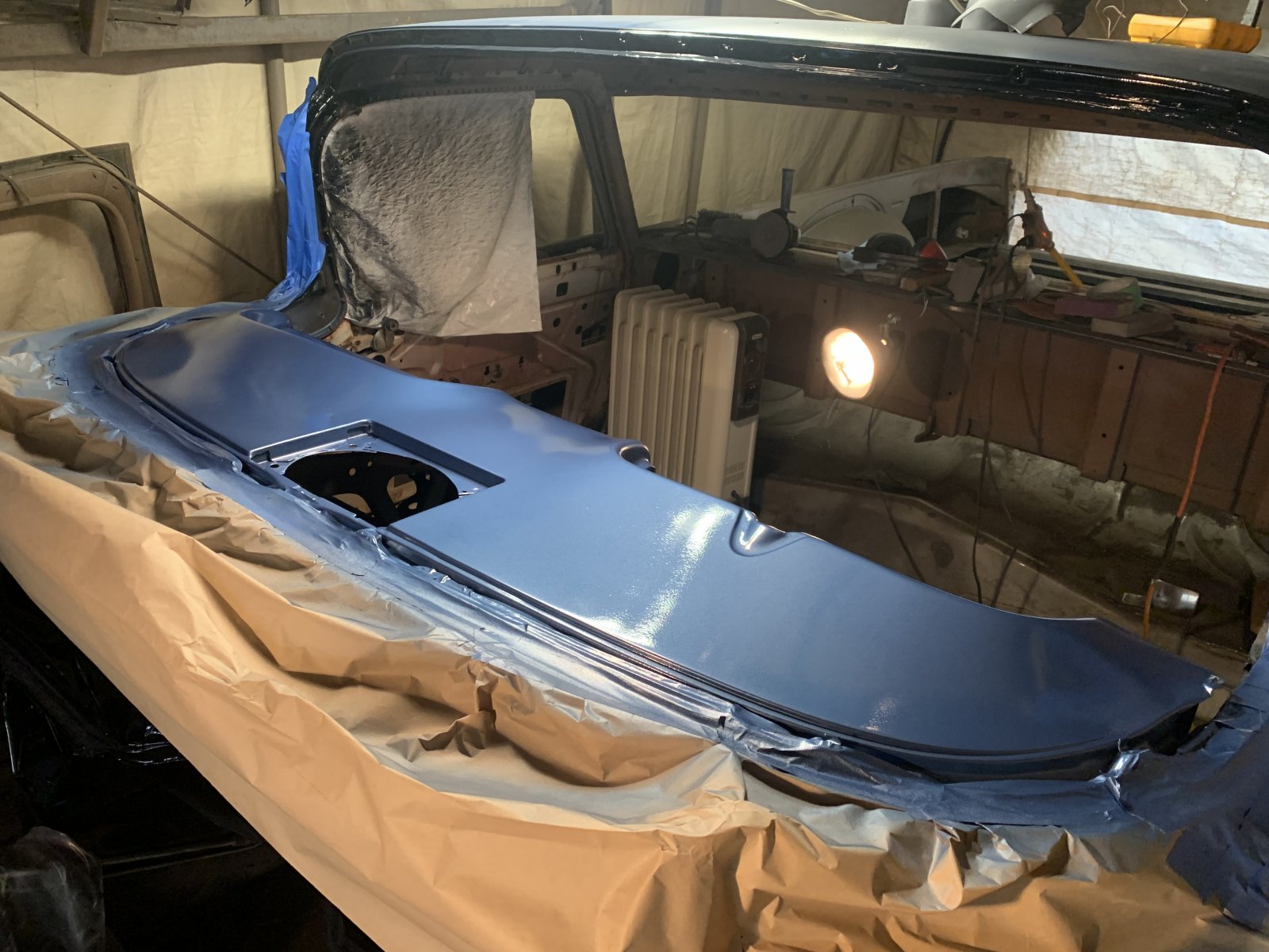

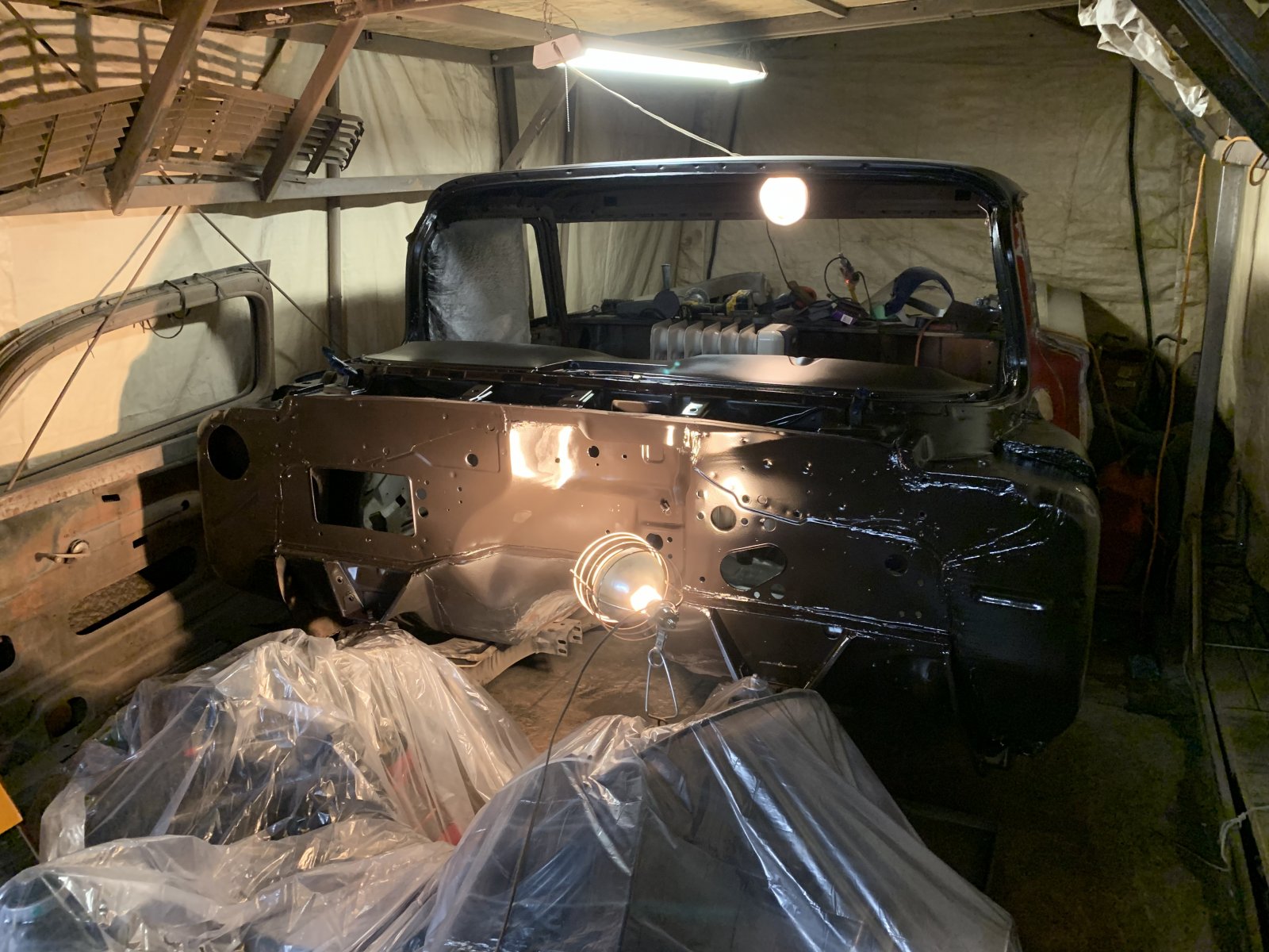

    It was a busy week. “Interstate Black” Tuesday after work:
    Then I drug out the Bel Air dash and transferred the trim holes.

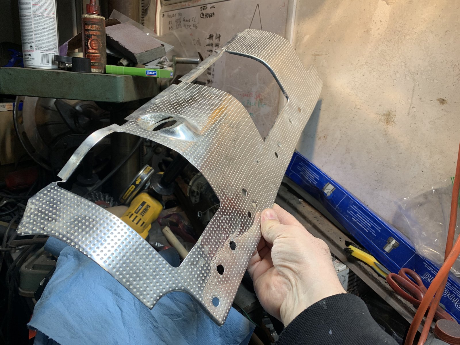

    I also dug around and found most of my dash and garnish chunks that need paint. I can’t find the lower windshield garnish seam filler piece. I should have at least 2, but one might have been stepped on… I found good lower windshield long parts, the knee knocker trim, back window garnish speaker grille, gauge pods, ‘60 Impala glove box, and column parts from the three speed column. I ground the nub off the 3 speed column collar and filled the hole with JB weld.

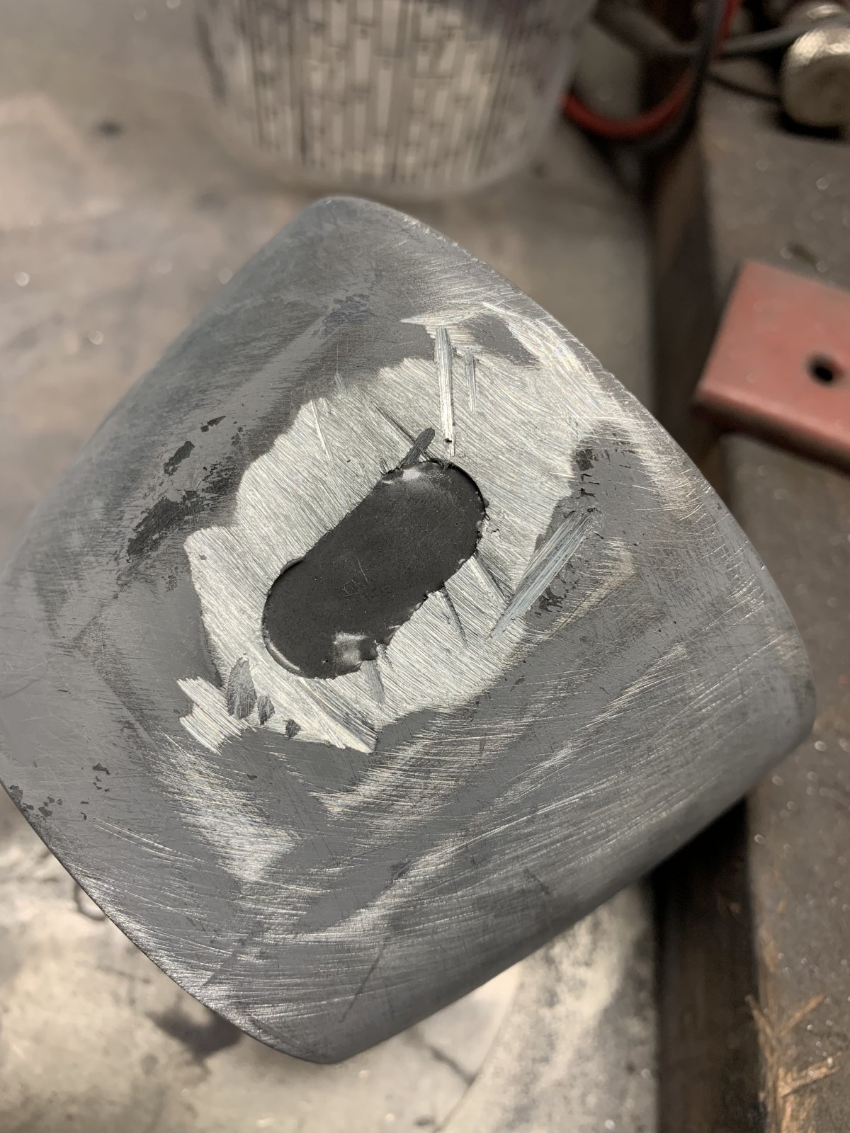

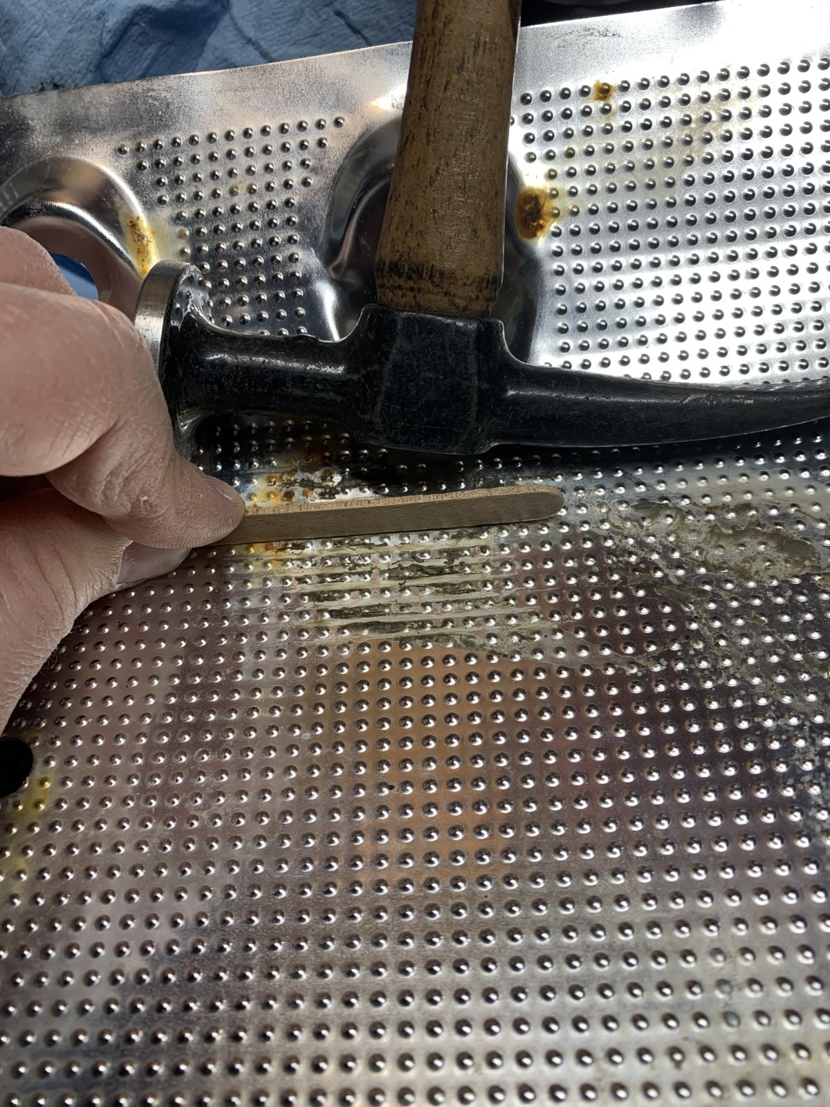

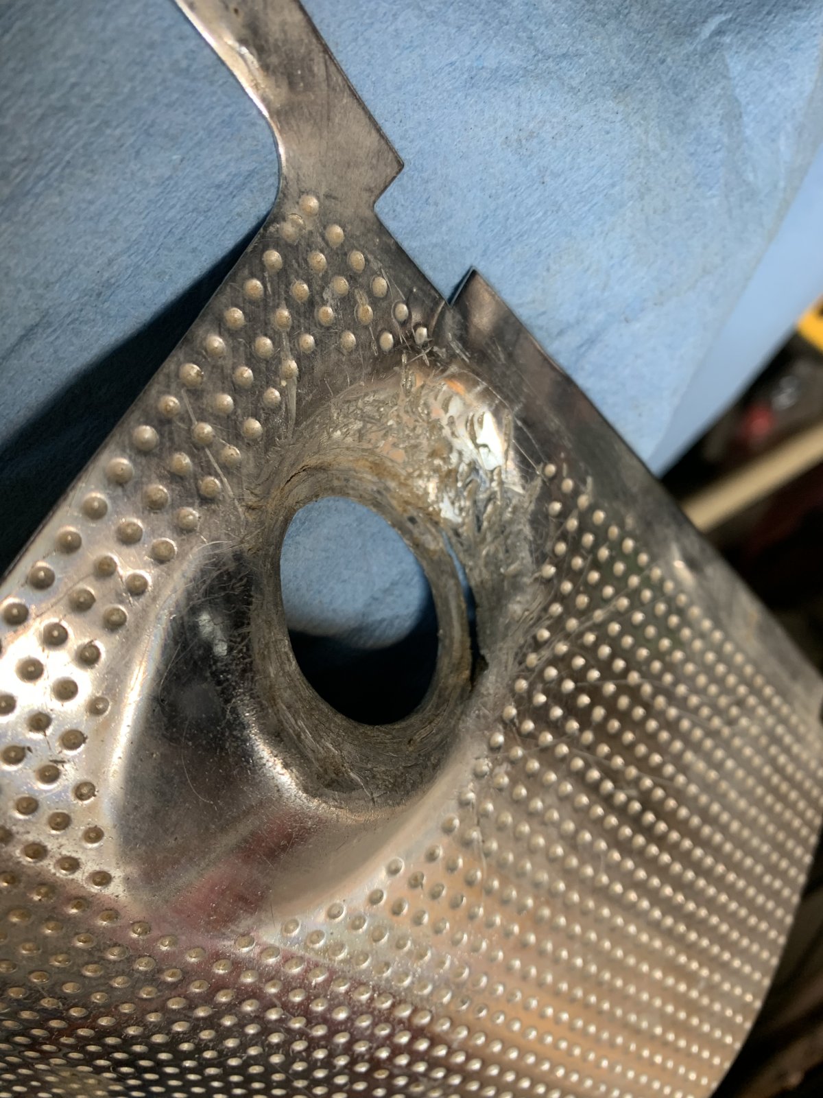

    My grinder work wasn’t pretty. My old boss used to call crap like this “pig surgery”. My only excuse was late at night on a Thursday and I should have been asleep already.

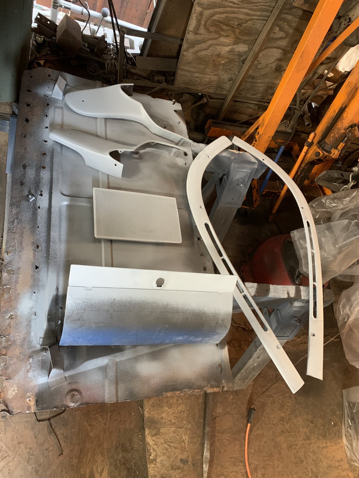

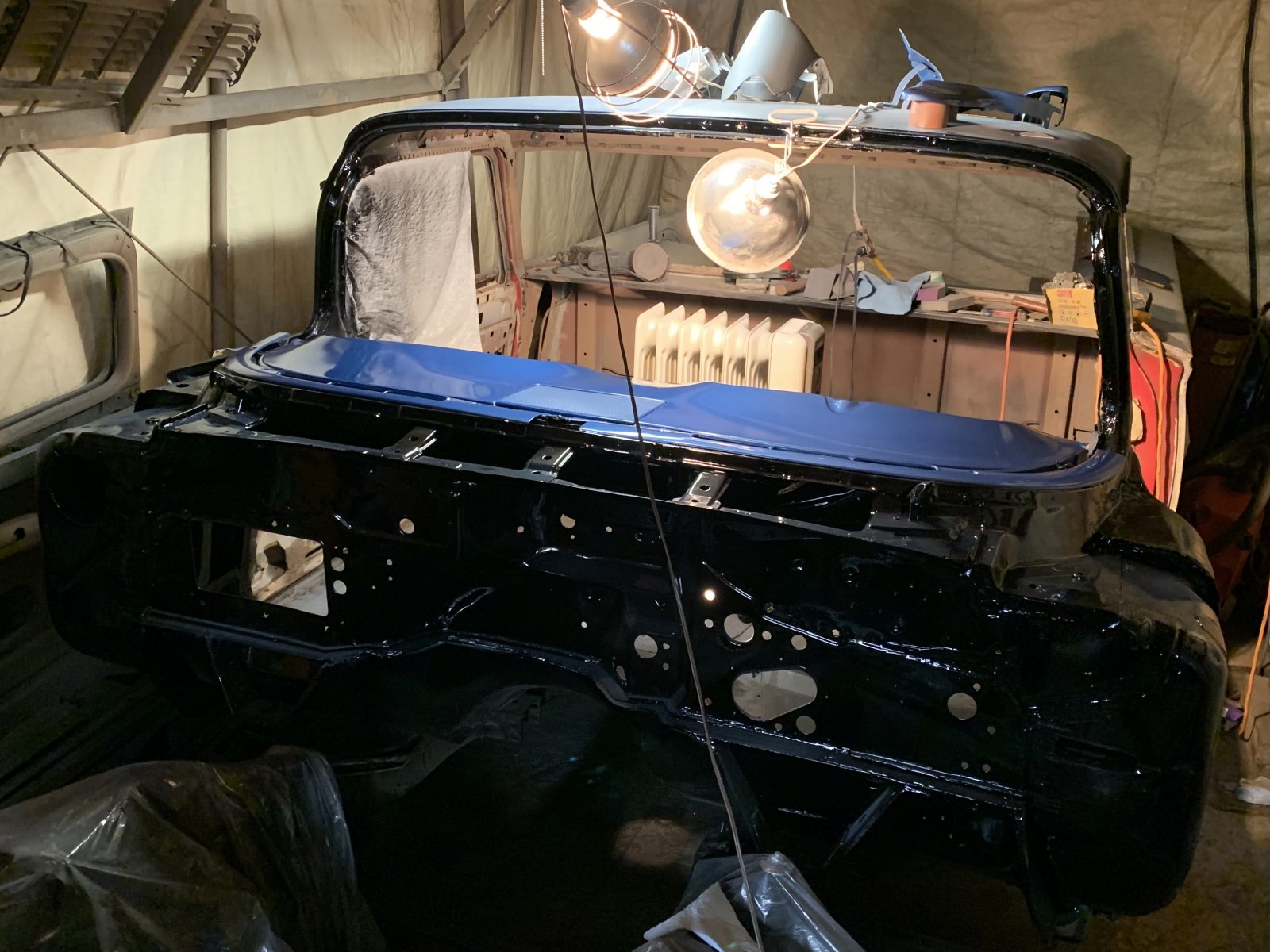

    I dipped out of work early on Friday to get all the little crap into epoxy. After a bunch of finish work, I rushed the primer trying to get into the house and help with kids. I put fat runs in everything and then didn’t get the car tent shit down and heated in time. The runs on the gauge pods and column stuff that may or may not be curing. I also hit the dash with Upol high 5 high build.
    Saturday I got the surviving garnish stuff in high build.
    And Omni Royal Blue Poly.

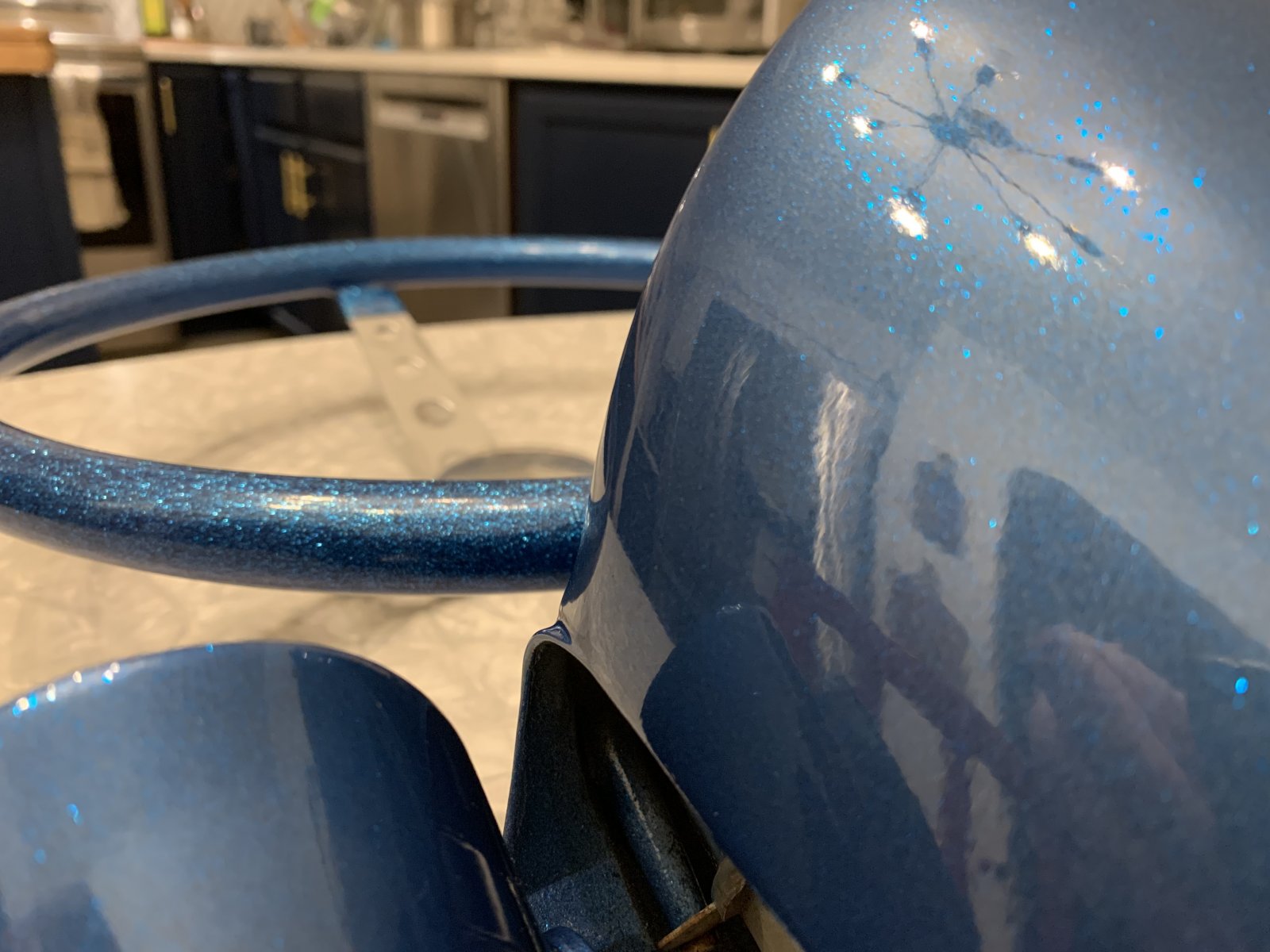

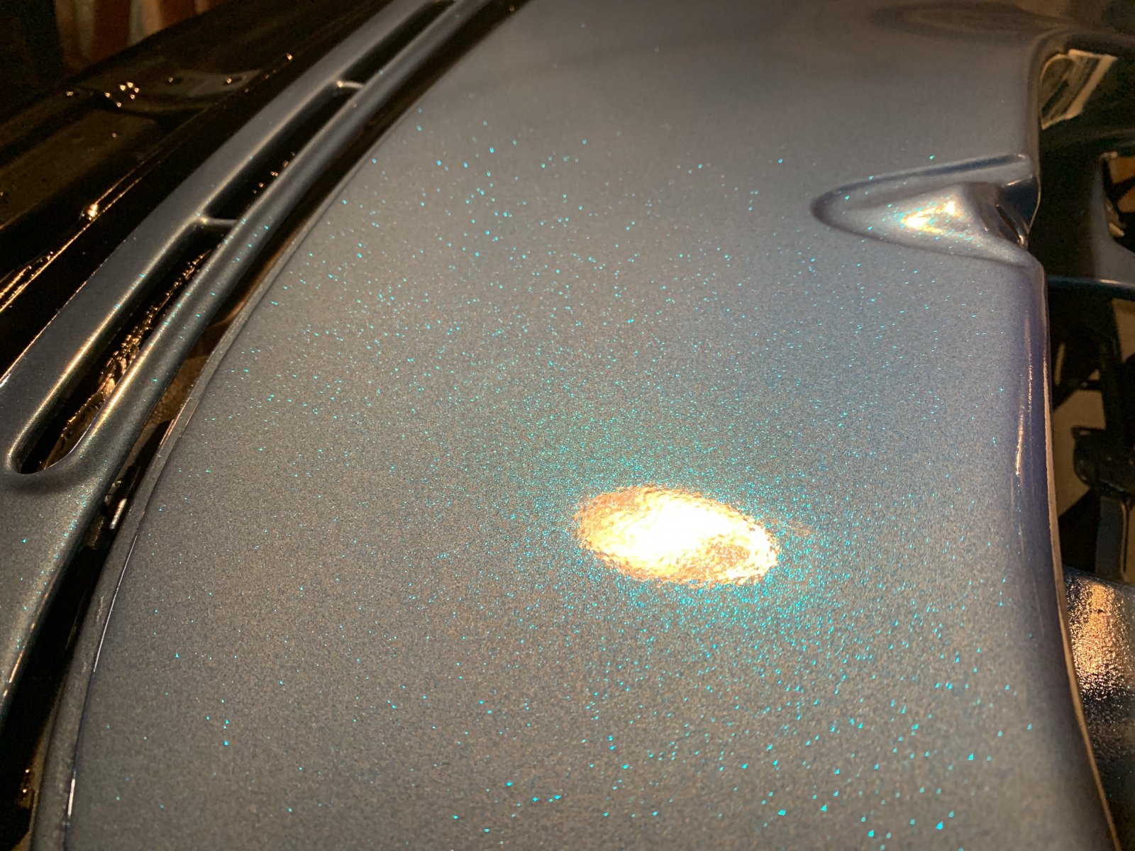

    I finished the day with 2 cans of Roth Rattlebomb Bad Azzz Blue flake. This is their .004 flake. I could have used a 3rd can, but didn’t know how much to order and those little shits add up.

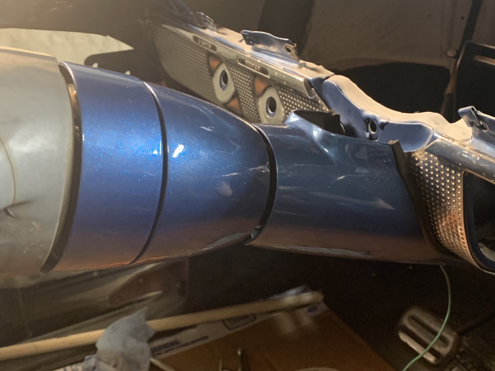

    I hit it with 2k clear today and had to pull the masking off. I’m pretty happy, especially for working in a filthy car tent.

    Thanks for the kind words! I’ve got a little dust in the dash to clean up and a couple runs on the firewall to sand out, but I got really lucky.
    I never showed the end result of the pig surgery. It’s still in primer but it’s also much better.

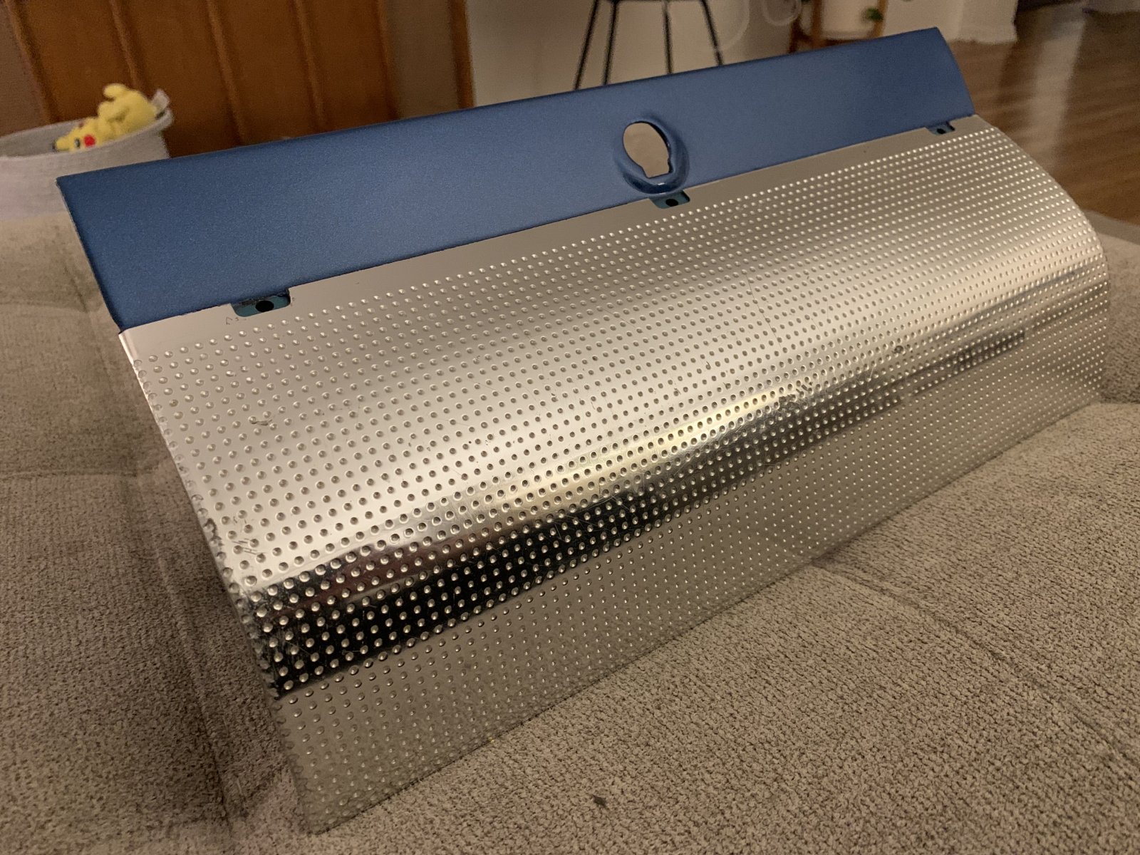

    And this is glove box door. Glove box door is our new centerpiece on the table. I hope my wife likes it.
    The runs in my gauge pods seem to be curing so I’ll sand them out soon and keep moving forward.

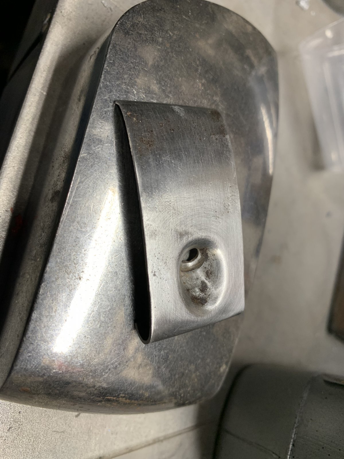

    Apparently the only garnish molding filler I have is the one I stepped so I fixed it.

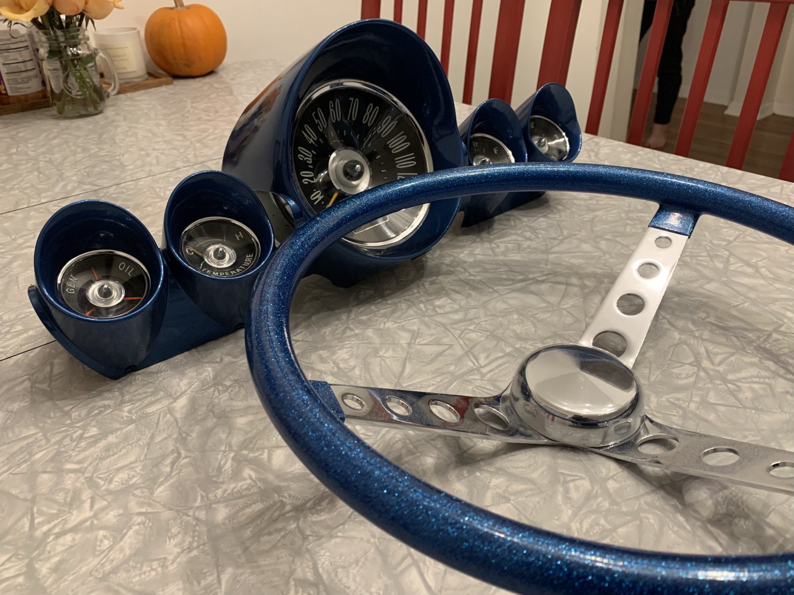

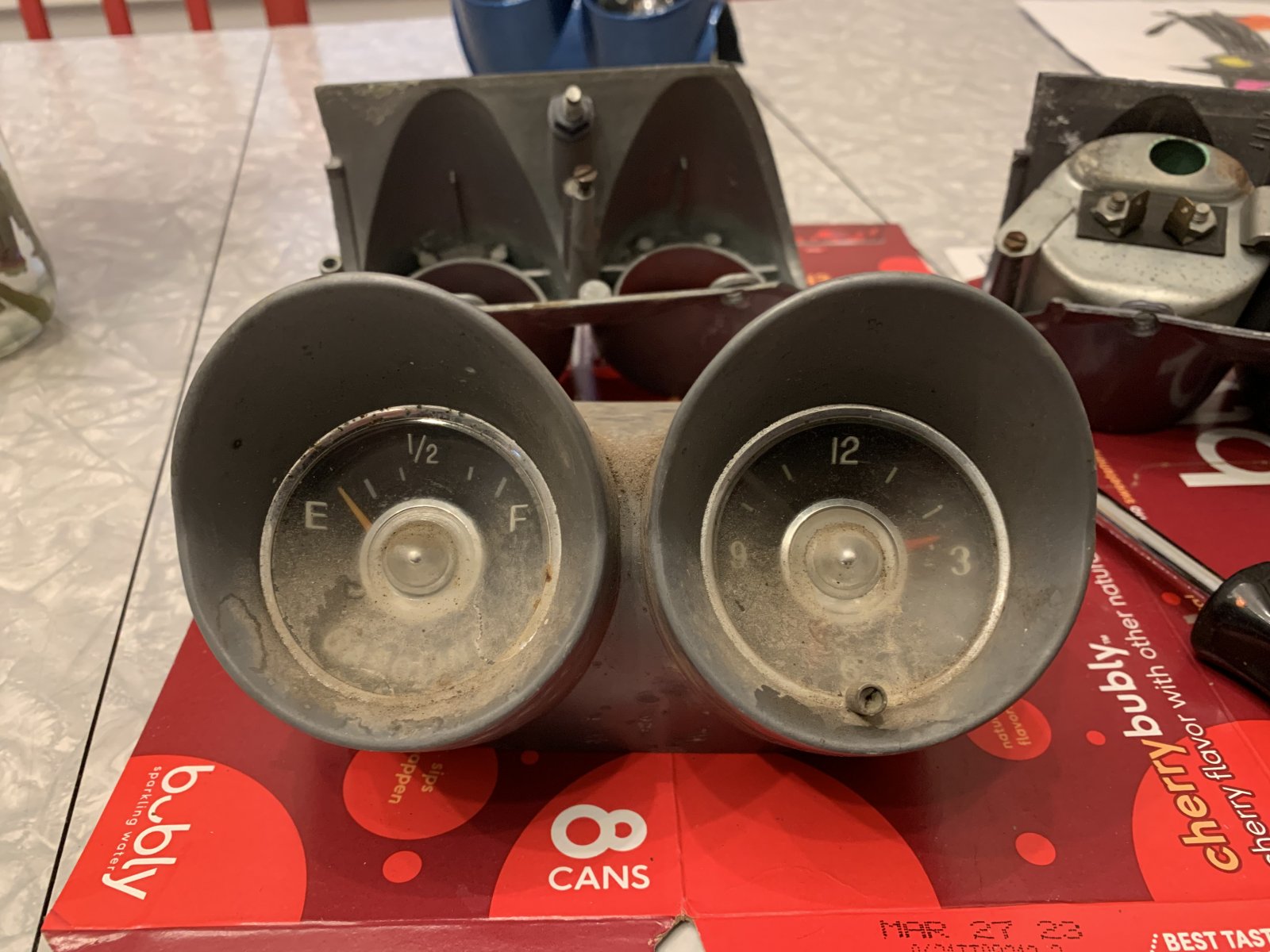

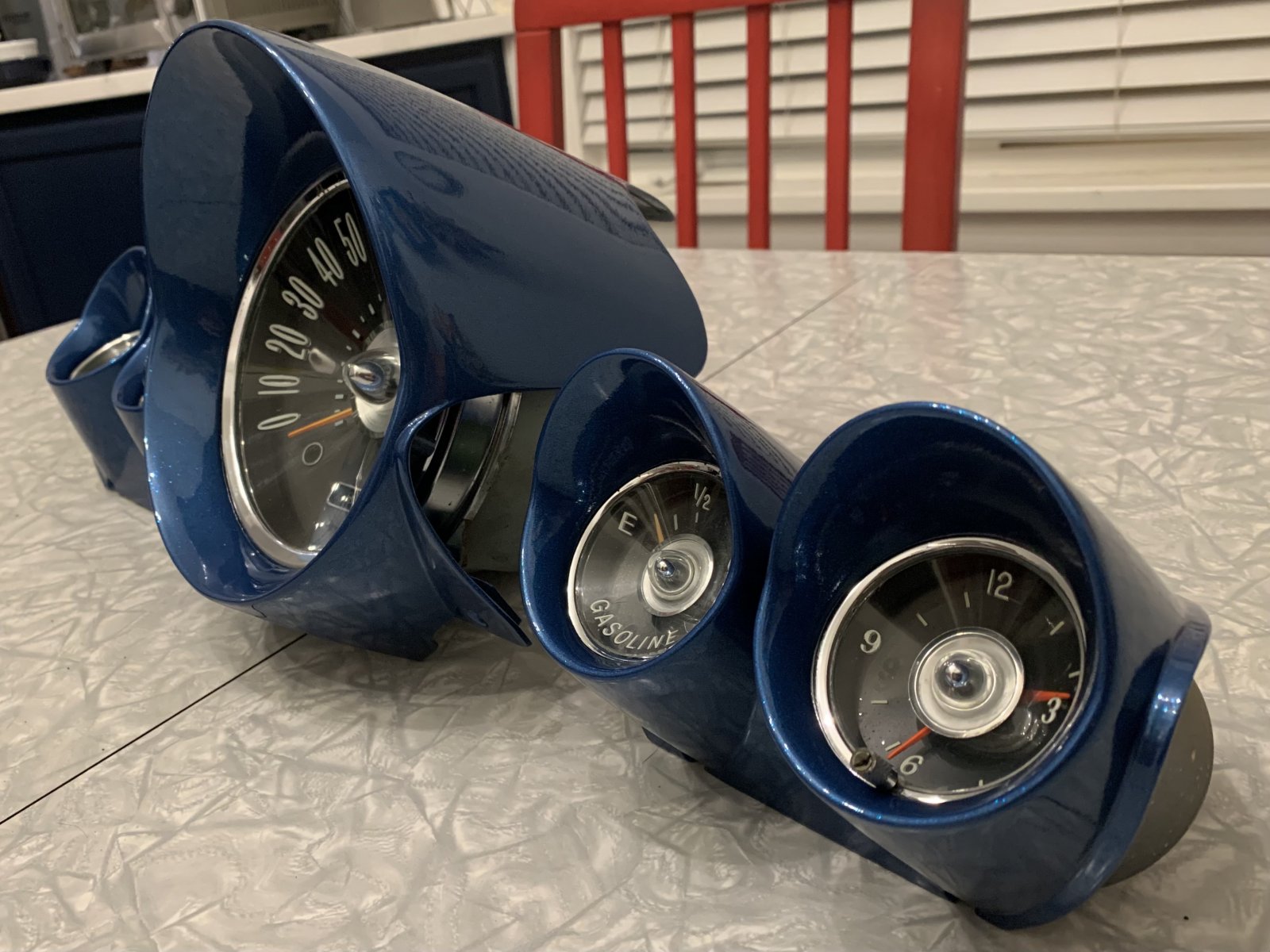

    I got the gauge pods, filler, and the column parts painted. I chose the best gauges and assembled the clusters. The lenses aren’t perfect and some of the needles are faded, but I’m going to let them be as long as they work.
    They cleaned up with some elbow grease.

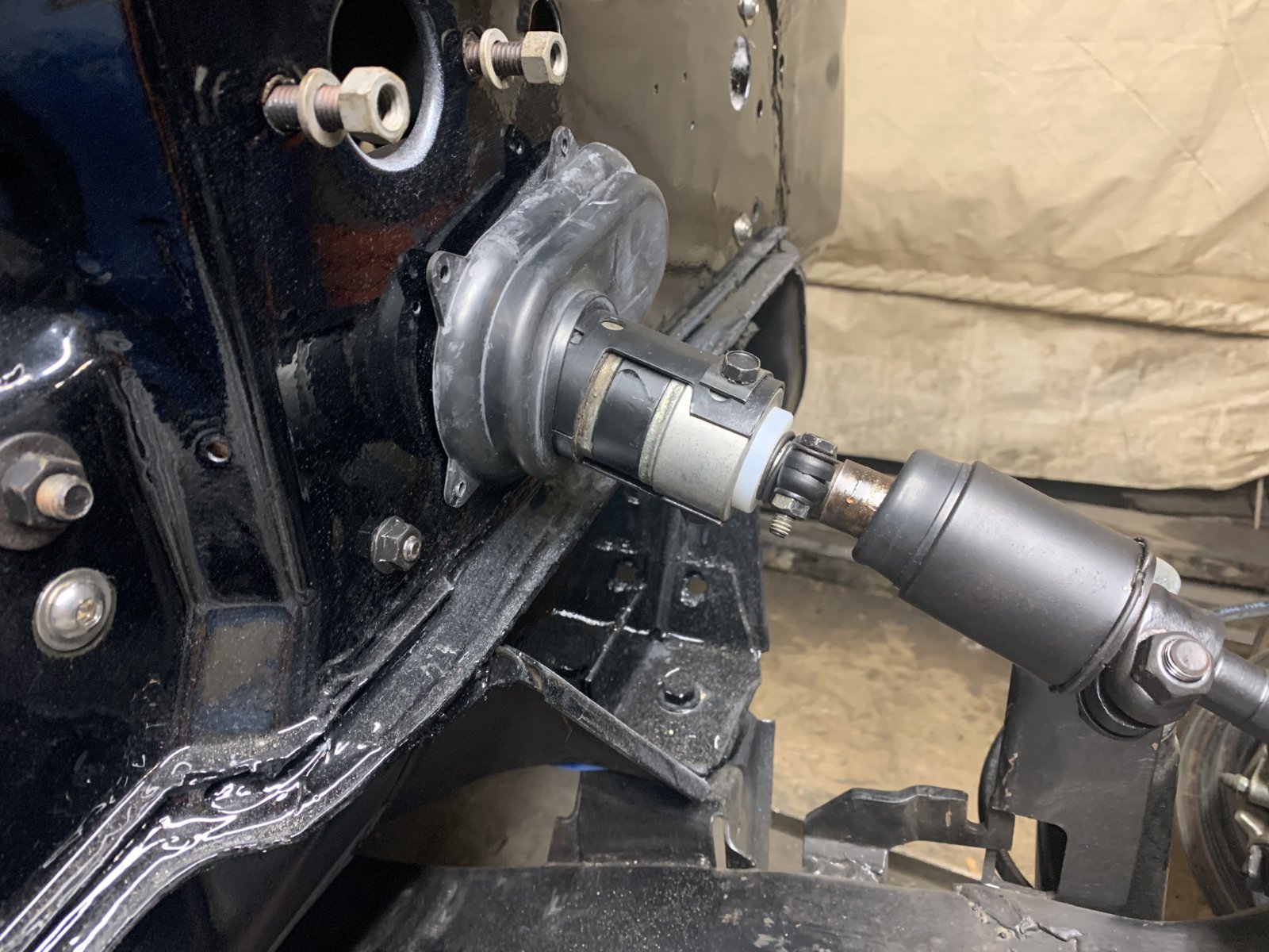

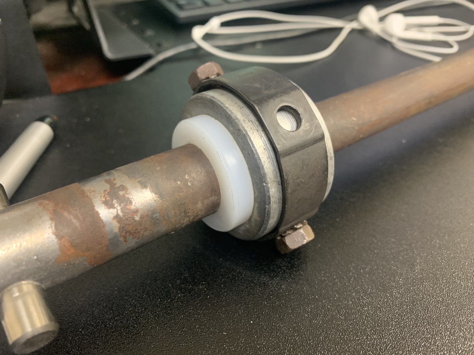

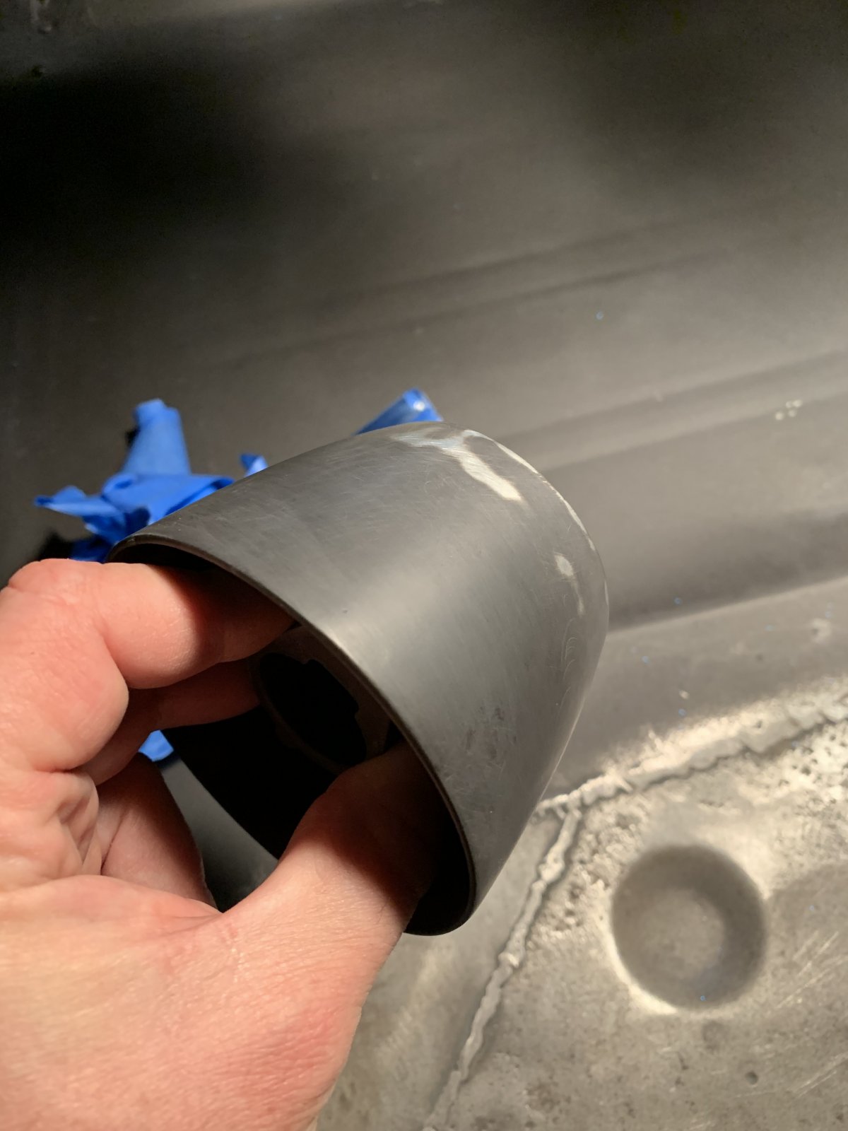

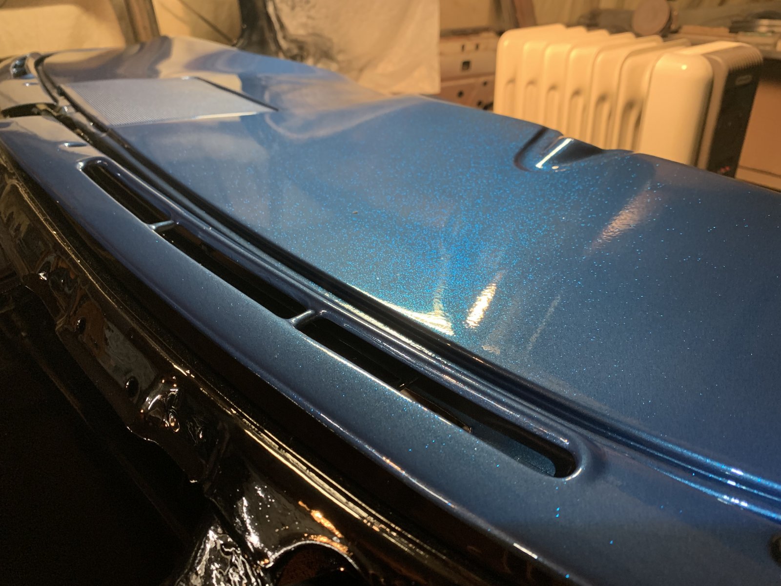

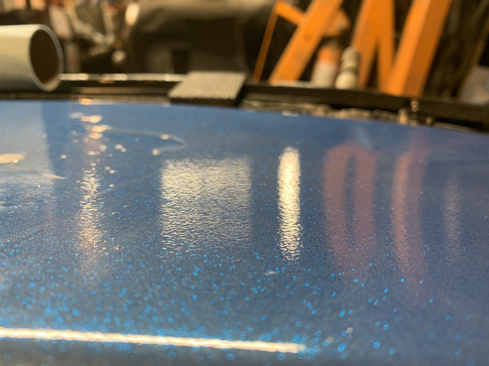

    Even with holidays and the cold, I’ve been busy on the ElCo. The dash had more orange peel than I could ignore so I went after it. My wet sanding water kept freezing under my sand paper, but things worked out. I started with some old 3m compound I had around, but it was causing problems so I switched to some Meguires products and things improved.
    The bottom bearing on the column was junk so made a new one out of UHMW. I didn’t want to wait a week for the junky stock style and the brass one is out of stock.

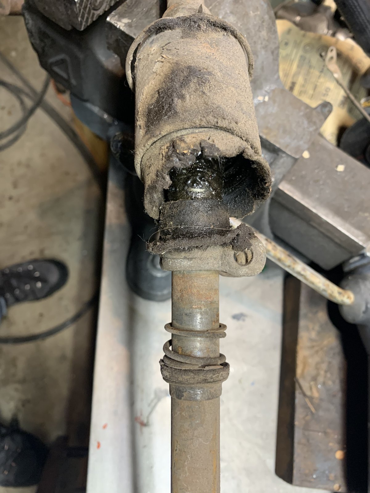

    The column joint was trashed. I built a good one out of two and put a new boot on it.
    I mostly used the ElCo 3 speed column with parts from the Bel Air and the 59. After surgery it’s a “4 speed” column.

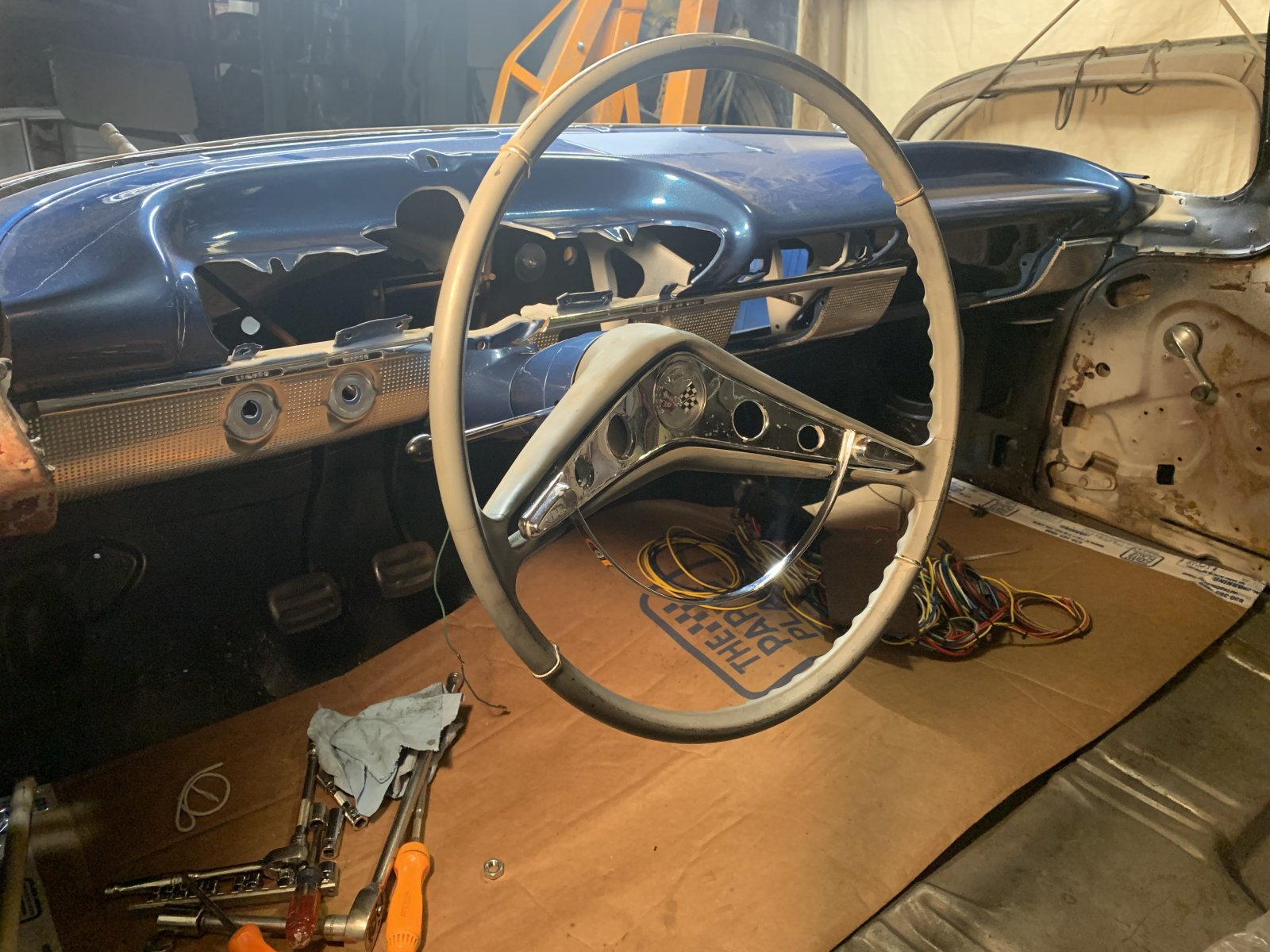

    The column was a pain. There’s a surprising amount going on in that tube. I also put a new firewall pad on. I don’t like the plastic retainers the factory used, so I used bolts and fender washers. I painted them after I took the pic.
    I dug out my ‘60 Impala dash trim and straightened it out and put a shine on it. The area behind the keyhole is gone, but everything else cleaned up.
    It came out pretty good.
    The Impala wheel is probably temporary. I was getting the signal mechanism working. I’ve got the Moon, but no adapter yet.
    Next up, start wiring, heater crap, get a clutch together, and final motor stuff.

    I guess calling it a 4 speed column is poor word choice. I meant a floor shift column. The factory ones are hard to find and expensive, so I cut off all the shifter stuff and cleaned things up. A 4 speed column shift would be cool though. It seems like I read that Citroen or someone had that in the 60’s.
