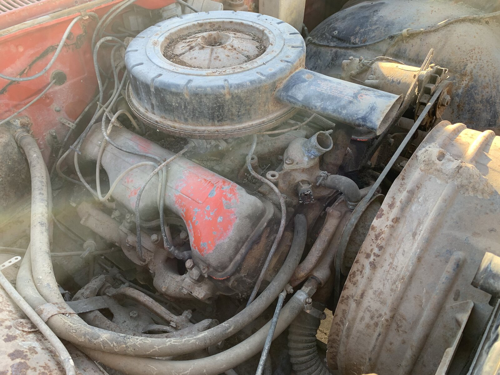

    Glad you found a good frame! I cringed a bit when I saw they grabbed that poor 235 that supposedly has that good 848 head with the excavator. I´m telling myself it´sjust a photo illusion:D

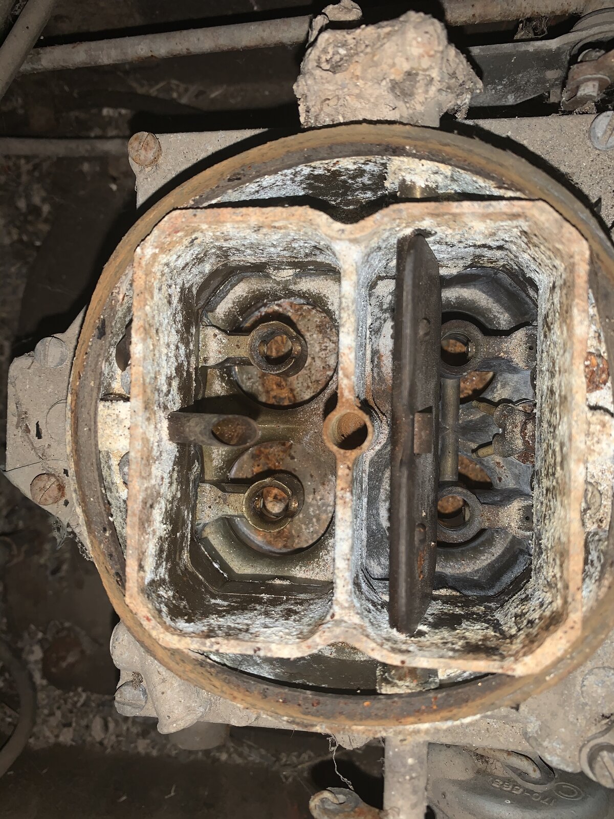

    That poor motor had sat with no hood and an open carb for decades. If people like that head, I’ll see if the motor is still around next weekend when I go out to break down the body.

    I don´t know what it´s worth in your area, but here these 848 heads are hard to come by. They had the smallest chamber and the highest cr of all stovebolts.

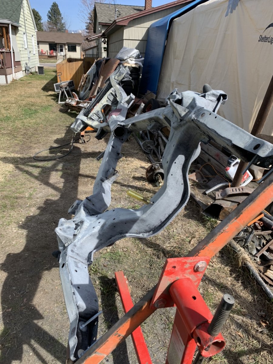

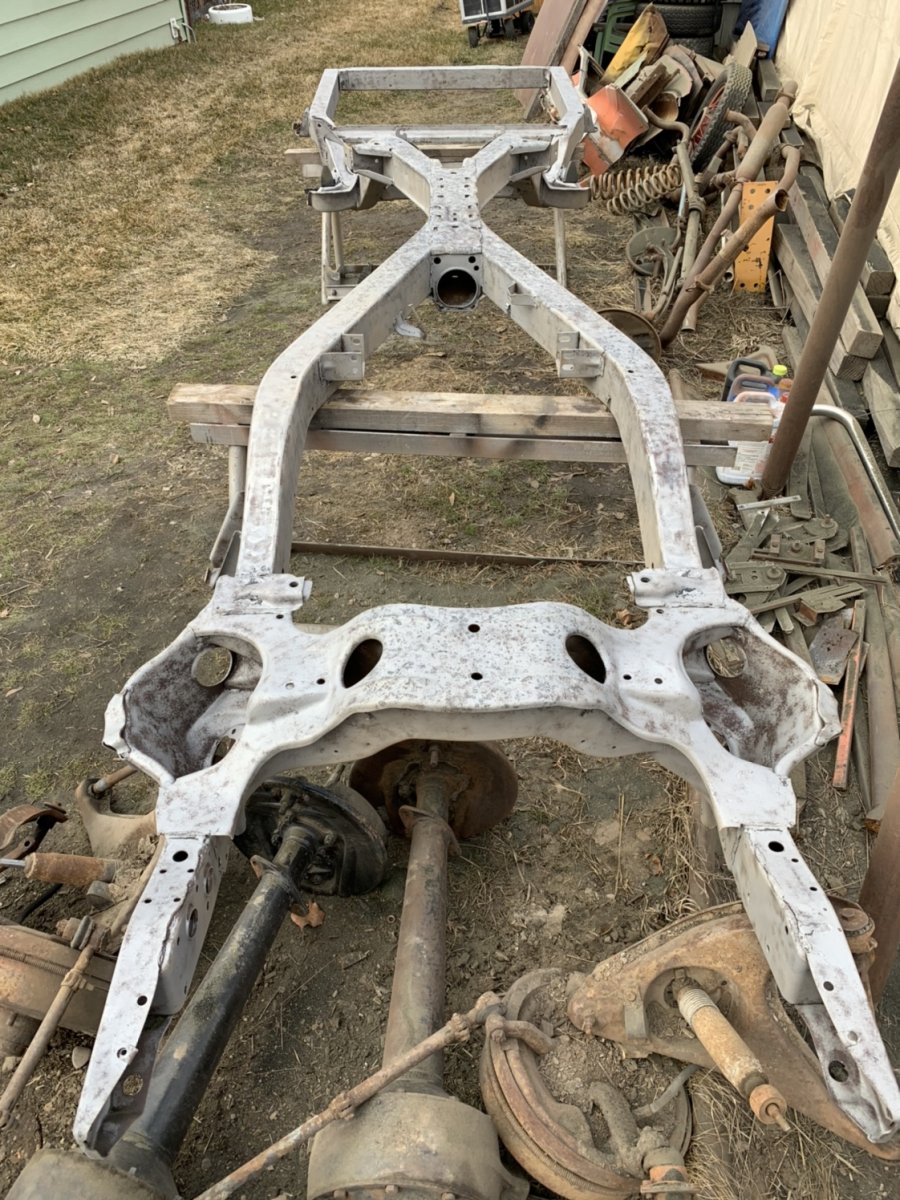

    The parts car gave me a decent Canadian style frame. There are a couple body mount holes where the rust is nasty from water sitting under the rubber. I’ll either patch em or cut the good ones off the bent frame depending on location. I gave it a half assed blast and it’s generally good with a couple cracks in a front spring pocket, some light pitting, and a front cross member scuff from a parking block or something. The biggest hassle is the rear cross member. It cracked out and someone burned in a “brace” plate with a stick welder and a fifth of whisky. I’ve got grinding to do. Global West and Show-Cars both make braces to prevent this cracking. The Show-Cars brace is more in line with the car I’m trying to build. I may order theirs or draw something up and get laser cuts from our vender at work.
    Crusty.
    Couple little cracks.
    The frame is upside down, you’re looking at the passenger rear crossmember with plate scabbed on.
    And the other side of that.
    They managed to trash that crossmember with a 6 cylinder and a powerglide. Imagine what the 348 4spd cars did.
    It may snow again soon, so I’m coating the frame in Ospho and trying to get primer on it ASAP. Having more light after work is helpful.
  15. indyjps
    Joined: Feb 21, 2007
    Posts: 4,127
    indyjps
    Just saw this, good build, sucks that it needed a frame swap, that took it up a level.
    Hows the rear window area, seems like every elco from those years are eaten up in that area.

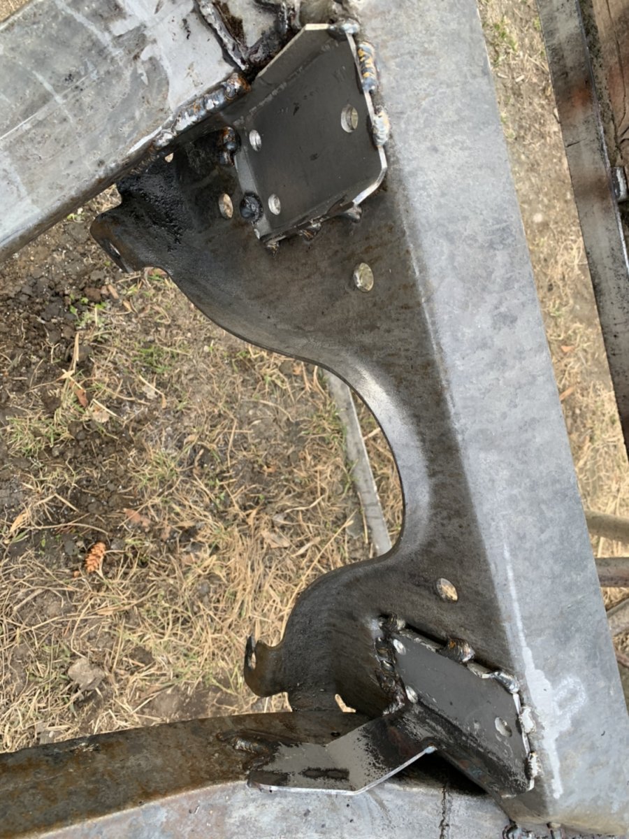

    I’m trying to get the frame squared away and back under the car ASAP. My driveway is an eyesore (worse than usual) and I want to get the car back to a parking spot and a half instead of the three or so it’s currently occupying. It’s spring and the frame is outside so I’m fighting surface rust too. I beat it back again with Ospho today and if it doesn’t snow tonight, I’ll try for primer after work tomorrow.

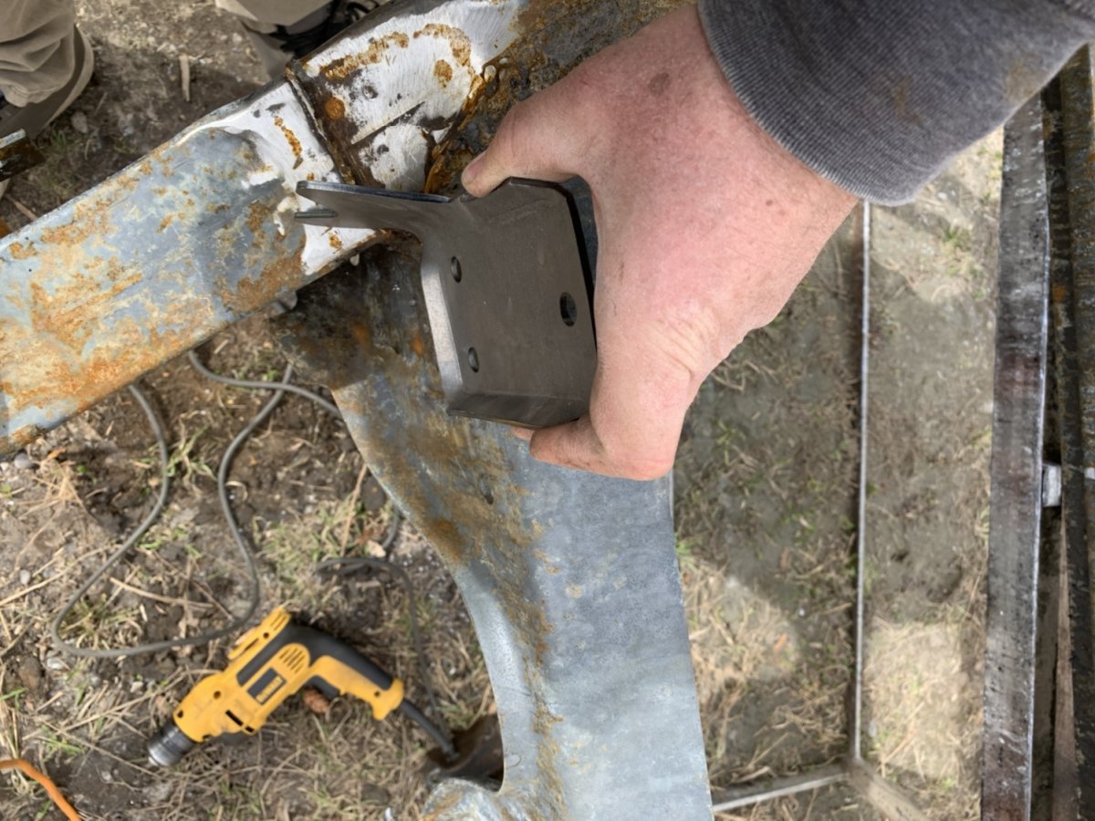

    I cut the body mounts behind the rear tires off the bent frame, cleaned them up, and welded em on the Bel Air frame.
    I drew up some patches for the other mounts and got them water jetted out of 12 gauge.
    Firewall:
    Rear Spring Pocket:
    I’m not going to show you the rearmost mounts ‘cause them shits came out ugly.
    I wound up ordering the crossmember reinforcements from one of the previously mentioned companies to keep things moving rather than dinking around for a couple days drawing at break time and testing templates at night. $100 later and I can’t understand how anyone thinks these things are supposed to fit. Aside from the arms being wrong, there’s a stamped pocket in the subframe that they simply wouldn’t fit in. BFH, torch, and a grinder made it happen.
    Primer/paint ASAP, weather permitting, seam seal and paint the floor pans, and hopefully frame back under the car Friday.

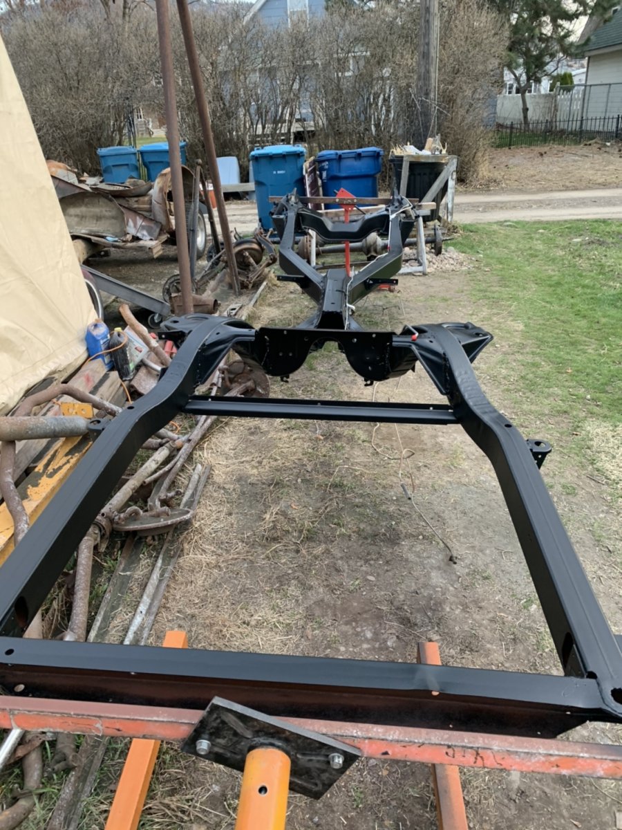

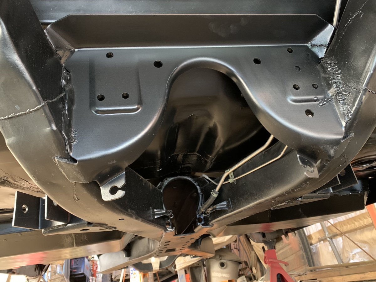

    I’m getting closer to stuffing the frame back under. The Ospho leaves a scaly mess but hitting it with a 3M pad leaves a nice surface.
    And with paint. It’s just Rustoleum Semigloss over rusty metal primer.
    The floor seam sealed with Eastwood Brushable Seam Sealer
    And painted.
    Nearly there. Stainless brake lines and 3/8” fuel line.
    Next up I’ll bolt the frame in, deal with the trans hump, toe boards, bed subfloor, and wheel houses. I’m also gathering front end parts. I’ve got Scarebird disc brake brackets and some other chunks.

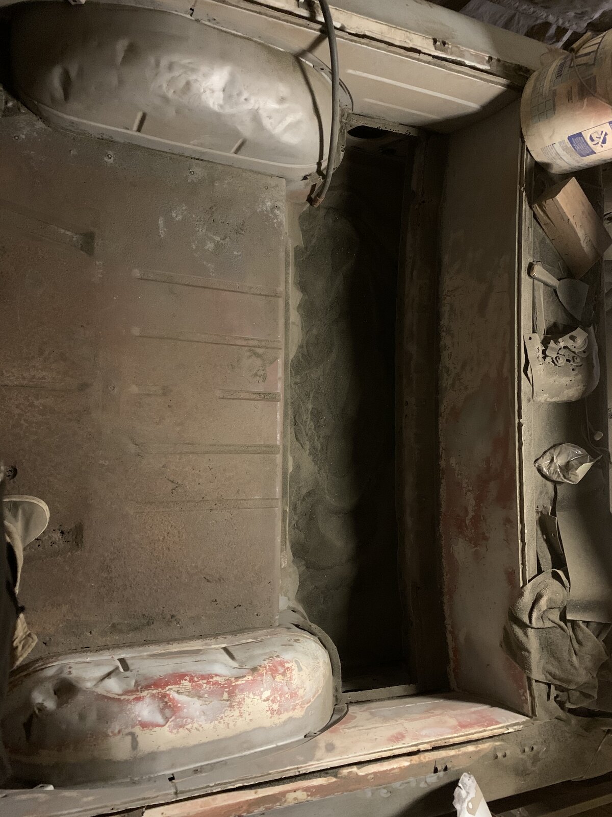

    The passenger wheelhouse is crushed and punctured. I’ll try to beat out the drivers. The whole subfloor is pinholed.

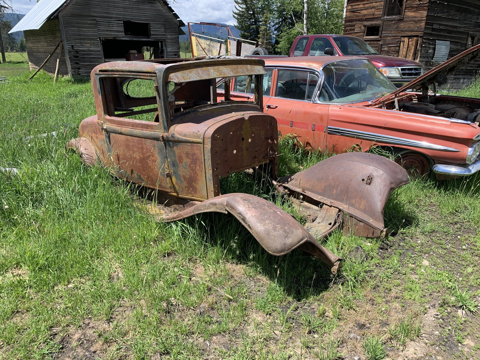

    My engine plan has completely changed. I found something in the woods behind a barn. Meet the Short Stack 59.
    0B5CA04C-271F-413F-BB1D-EBC151B2E66E.jpeg DAFC1D33-D518-4660-8BDF-C7F8B4804C05.jpeg D0C81DDD-6C04-45FB-9FA8-86D82D8864FB.jpeg
    It got rear ended by a logging truck so they built a wooden box on the trunk floor and drove it until 75.
    I’d heard about it for a long time but couldn’t get in touch with the owner. The guy who knew about it couldn’t get me in touch because someone else was mad at him so I had to find someone else who grew up down the road. All this from in a couple dinky towns 2 1/2 hours away. Also, the owner wasn’t really into phone calls. It took like 9 months. The brakes were all frozen and one of the tires I put on it popped on the ramp. After breaking two come alongside, we finally shoved it on with his Massy Ferguson. Then we hit a deer driving home.
    My wife has informed me that we are now remodeling the kitchen. She pointed out that I’ve bought three cars in the last year....

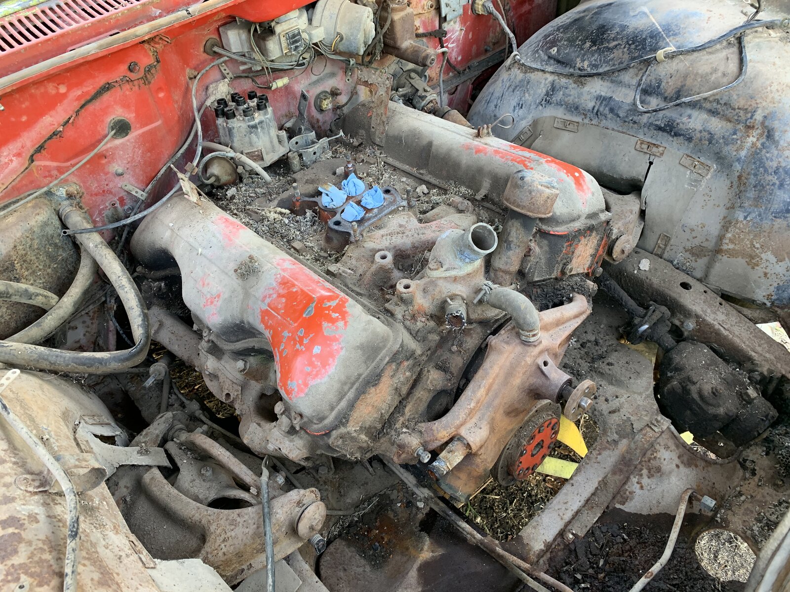

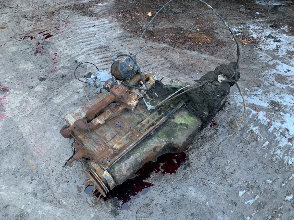

    Thanks for the kind words guys! I’m super excited about the 348, but I don’t really get to mess with it until I get the rest of the 59 processed. I can’t really have that car sitting around too long.
    Sneak peaks:
    I’m going to pour some kerosene / ATF mix into it and soak it while I tear the car down.
