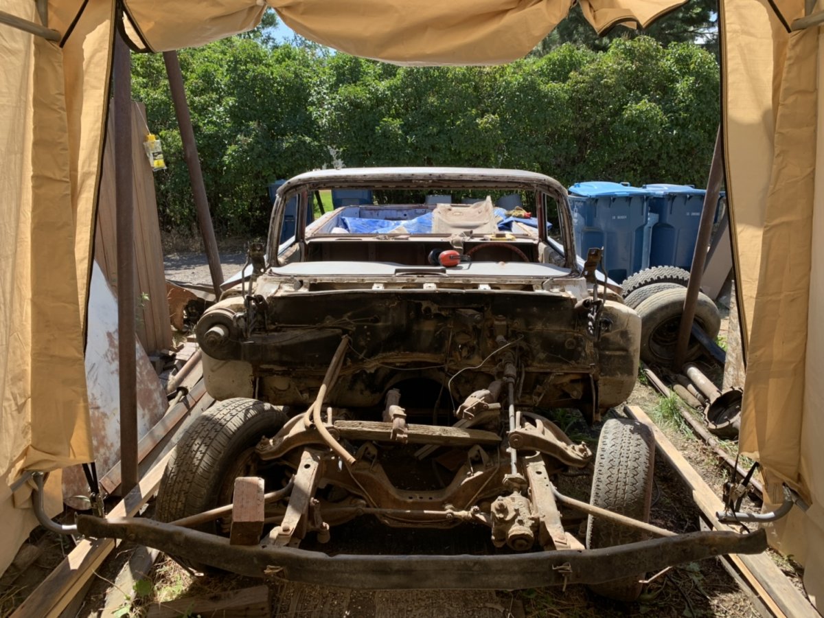

    See how snaggletoothed it looks. The front clip was bolted together wrong. I looked and looked for frame damage and couldn’t see any.
    We stopped for a pork chop sandwich and a cold beer on the way out of Butte and ate with a portrait of a local hero and then drug the El Stinko back to Missoula.

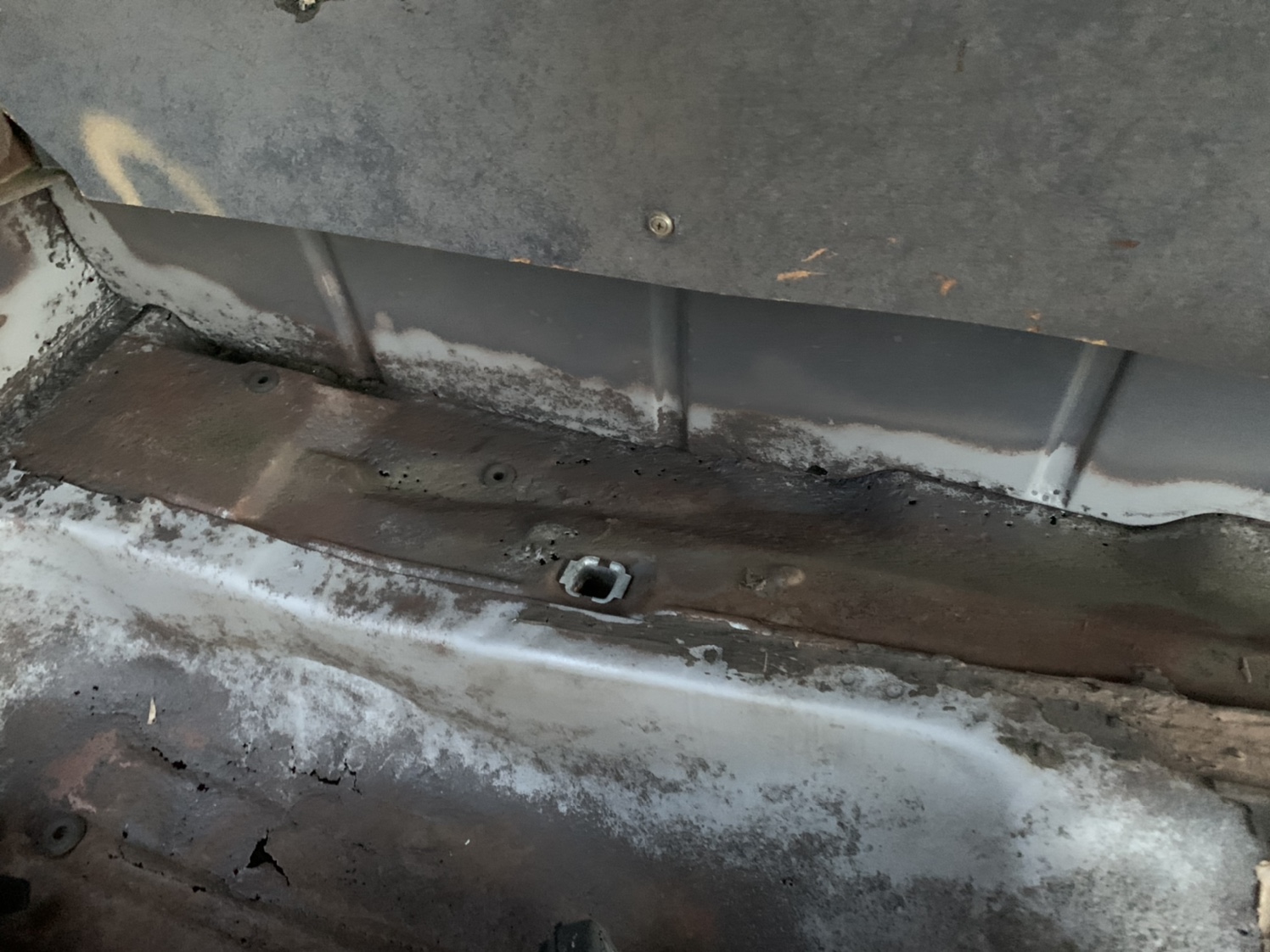

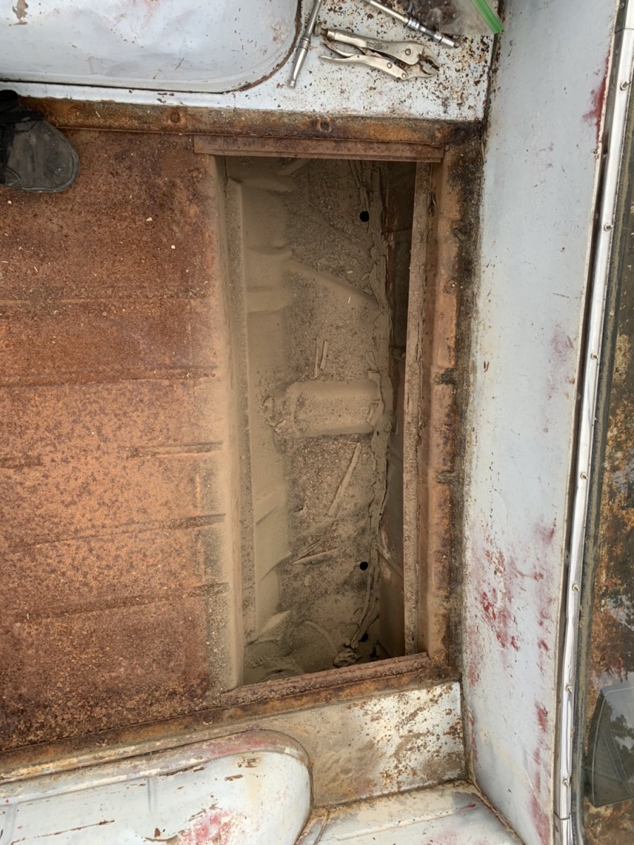

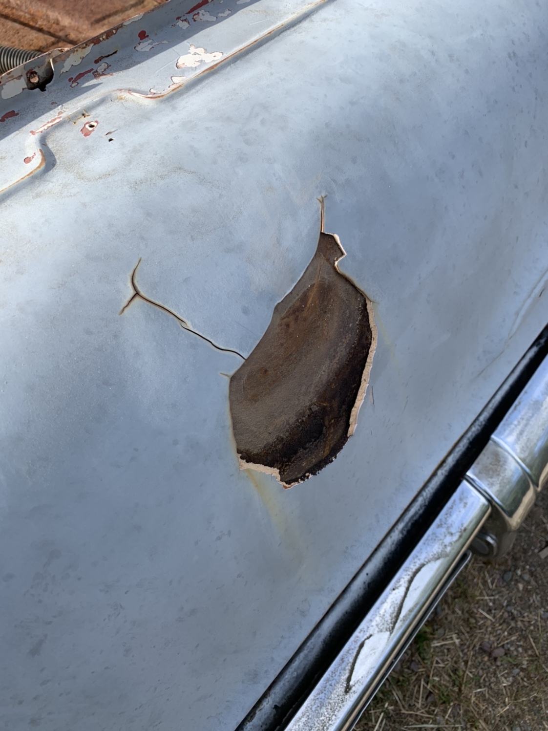

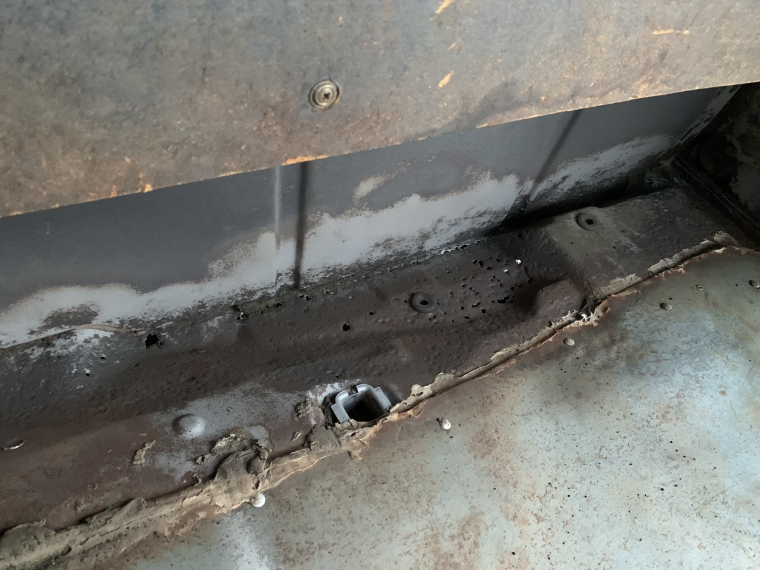

    I dug deeper. The floors weren’t good. Wet carpet had wiped out the floors but the braces were all good. Whole sections had been cut out and pop riveted over. The pan that went under the bulkhead into the smugglers box was Swiss cheese at the bulkhead.
    I blasted a little
    The car looks like it was torn down for paint in the late 90’s and then they lost parts. They cut out the tailgate medallion and caked bondo over a lumpy patch.

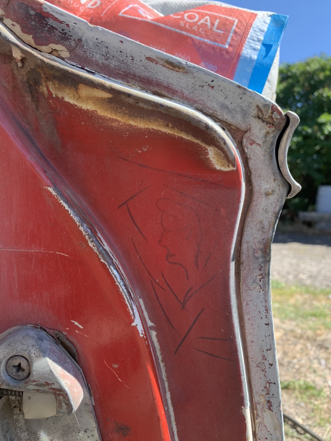

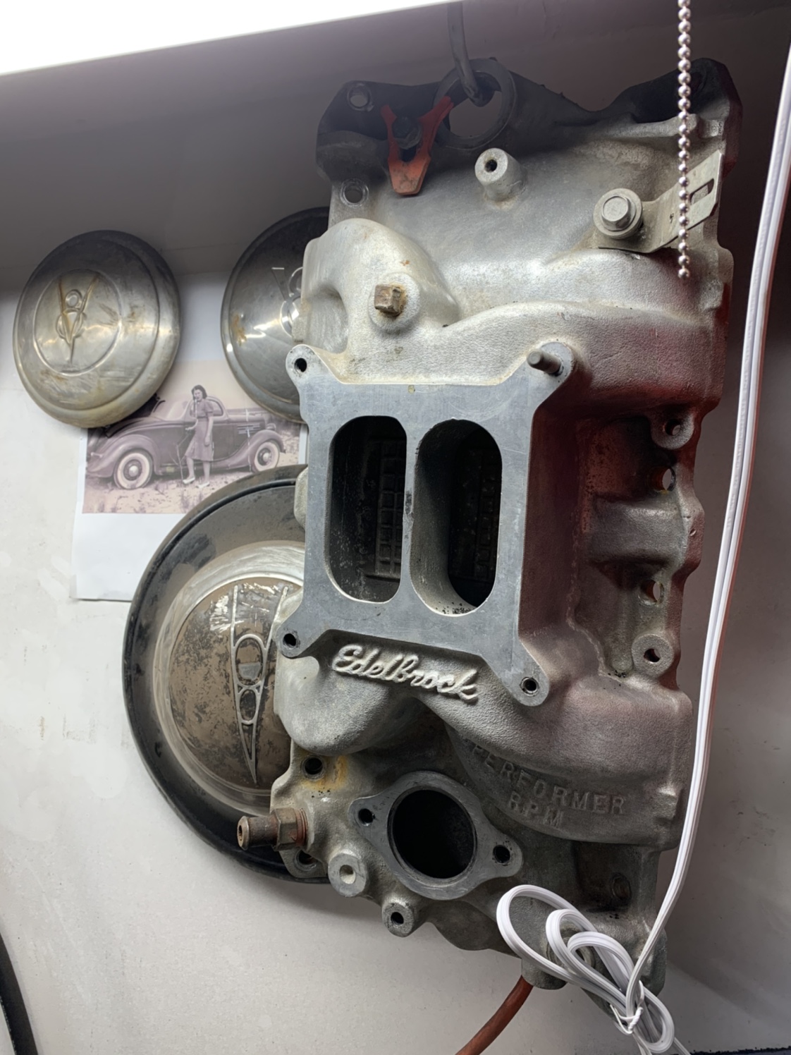

    @lewk I've shared that pic here that's under the hubcap...what's the story on that?...I just noticed that's hangin' on the wall...I thought it was on a table...It'd be quite a coincidence if it was a Family Heirloom...that'd be a dot connector...;)
  6. lewk
    Joined: Apr 8, 2011
    Posts: 1,010
    lewk
    from Mt
    I grabbed it somewhere off the internet. It must have been from you. I’ve got a 35 Ford 3 window I’m working on and that picture is so cool I pinned it to the wall next to my car. Hopefully you’re good with that... I certainly am not trying to step on toes. It’s been on my wall for a few years.
  7. Stogy
    Joined: Feb 10, 2007
    Posts: 26,348
    Stogy
    No problems it has no relation to me I did the same...;)

    It's good to have period correct images around the shop to keep our builds on cue...:D

    I’ve been loosely watching that guys build. Lucky guy has a 348! I hadn’t seen that he had a parts car yet. I’ve got my eyes on one locally but I haven’t pulled the trigger because then I’d have to deal with it.... I also know where there’s a 348 59 sedan on a farm but I’m having trouble getting it. Calling in weird favors to even get contact info...

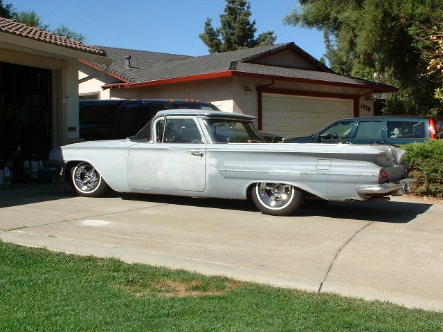

  14. Except for the floors, it seems a pretty decent shape body. Always good to use up parts you have laying around. Here's my old 60 El Camino, kinda beater, that was DD for a couple years back in CA while I was building my 59 El Camino. The 60 had a SBC 307/T350 and did fine driving around. The car had a 400 SBC when I got it that ensured no mosquitos could live around the car, swapped in the 307 I had. Just cut coils and stock drum brakes. Nothing fancy, 5 colors of primer. Picture 001.jpg
    Edit: I sold this and it went to New Zealand around 2006? This is an older picture for sure. But an example of similar to what you are wanting to build.

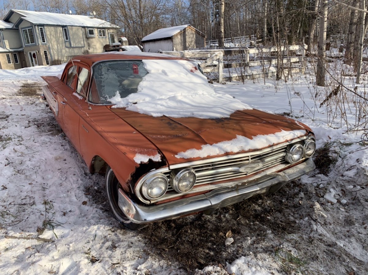

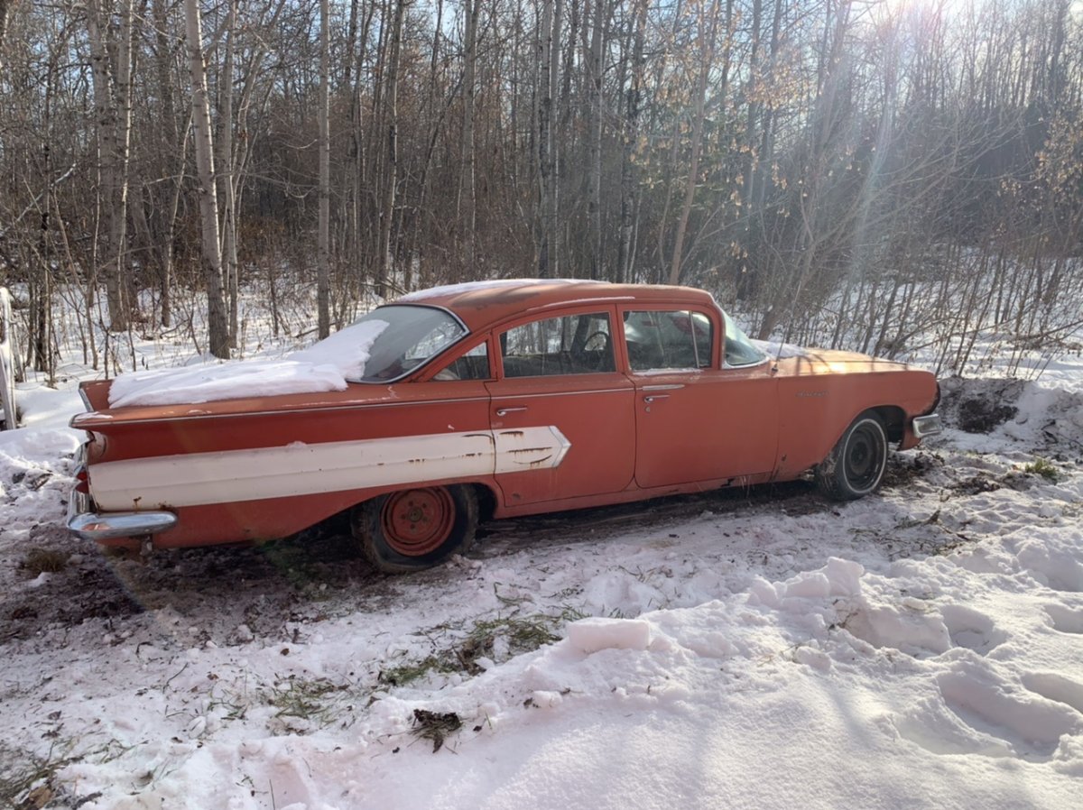

  15. Looks like a great project! I did pick up a 4 door parts car up here in Alberta that I’m just about done picking off what I wanted to. If there are some things you need, PM me and I’ll let you know if I’ve got it. I don’t have any El Camino specific parts up here though.

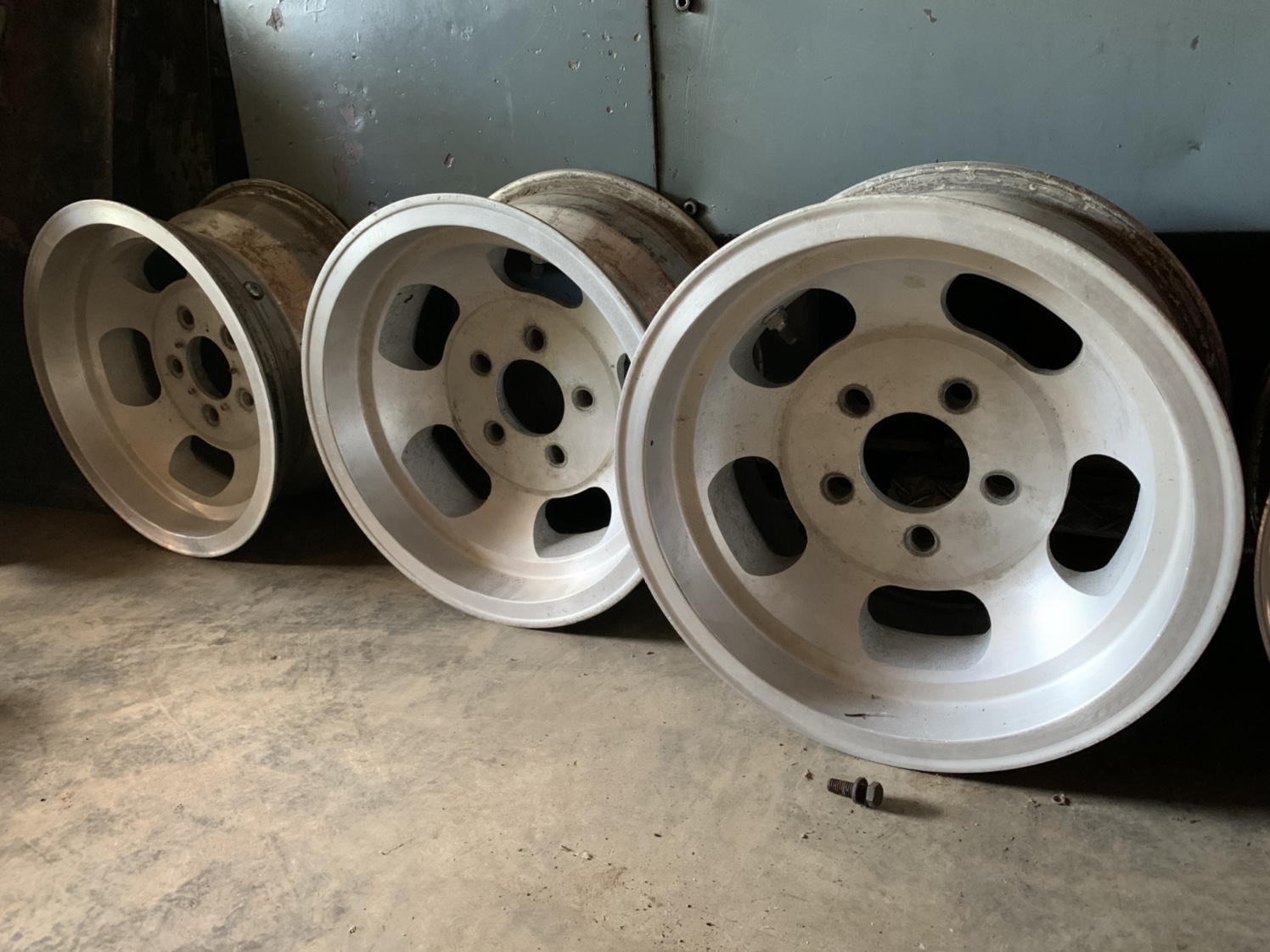

    That thing is sweet, and you’re right, I want to keep mine simple like yours for sure. If I didn’t already have the slots I’d think seriously about Supremes. If you remember, size were your wheels and tires? I’ve got a 63 SS that’s probably getting Supremes in the future.

    I’ve been enjoying your build and am jealous of that 348! Aside from the long side strip, I’ve got all of the El Camino specific trim. I’m still tracking down front bumper, grille, valance, and trim parts but I have a couple options locally. Where in AB are you?

  19. When in Alberta I’m just outside of Edmonton.

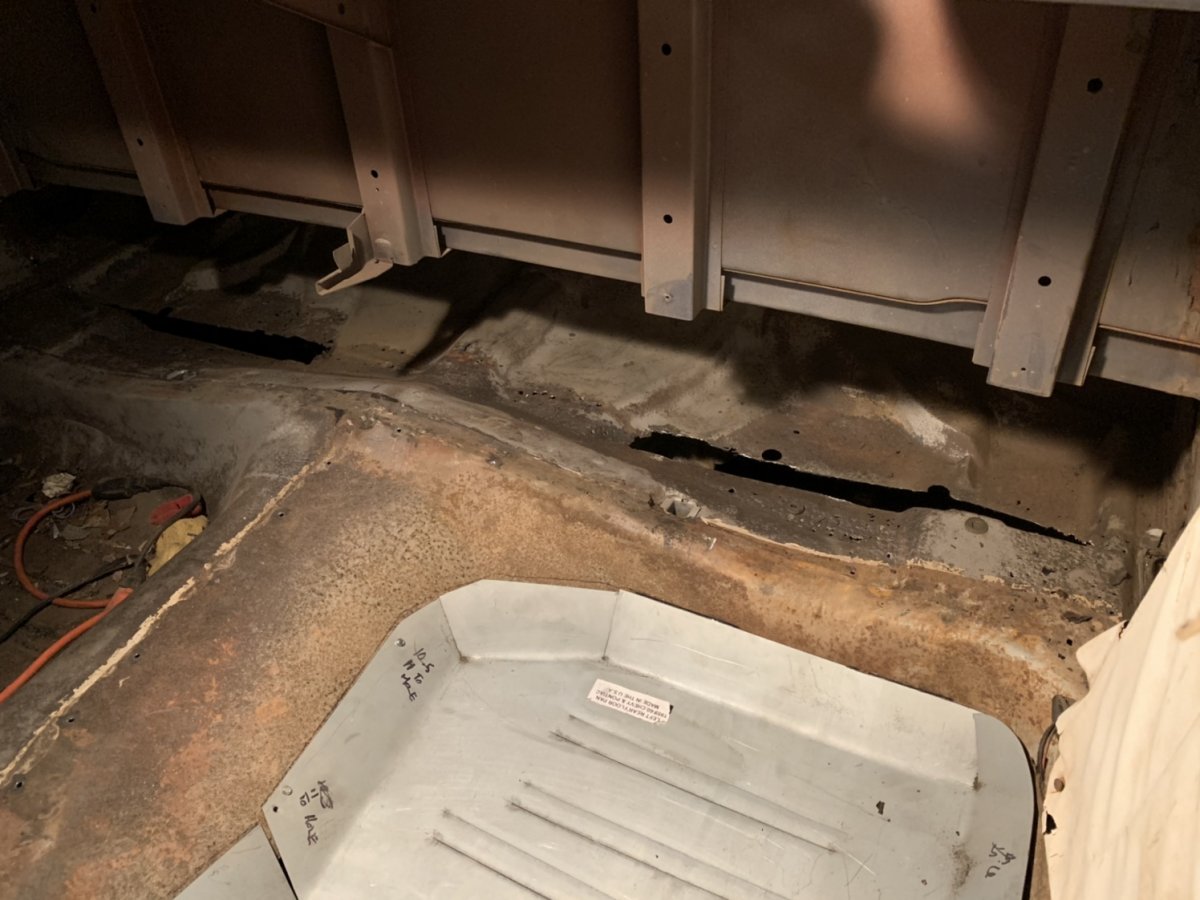

    So I pulled the bed floor to deal with the smuggler’s compartment rust.
    Thin metal Under that dirt.
    My other X frame Chevys
    Got the rust and bondo out of the top. There are a couple dings, but it’s not bad.
    The front clip was barely on anyway, so I pulled it off. Frame still looks ok.
    Started on the floors
    Removed the bulkhead to deal with the smugglers box

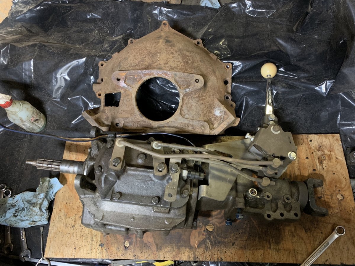

    Saginaw is coming together
    Smuggler box origami. This is 63 sedan roof plus 63 seat pan welded up. They make a full pan for the main floor and pans for this area, but I’d be a grand plus into my floor and childcare with schools closed is killing my fun money. Small eBay pans and origami will get me by.
    Squint. There’s still grinding to do...

    Nice shifter on that 4 speed, gonna be fun.
    loudbang, Stogy and lewk like this.

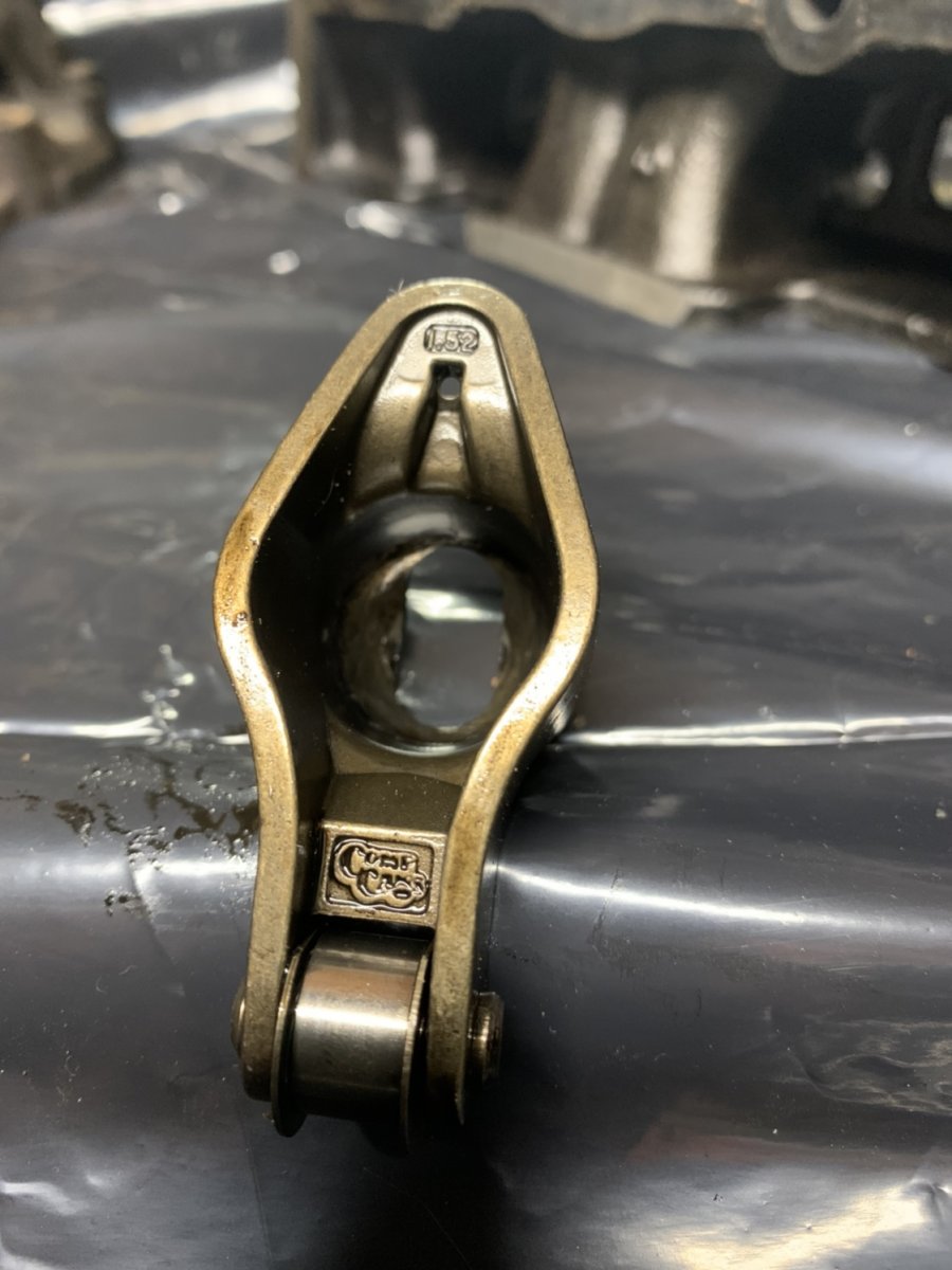

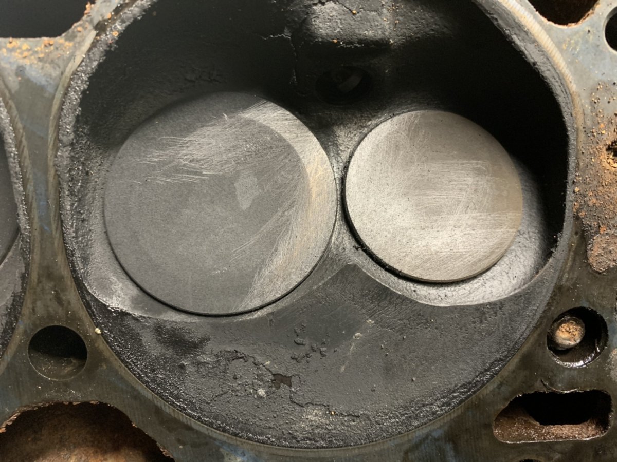

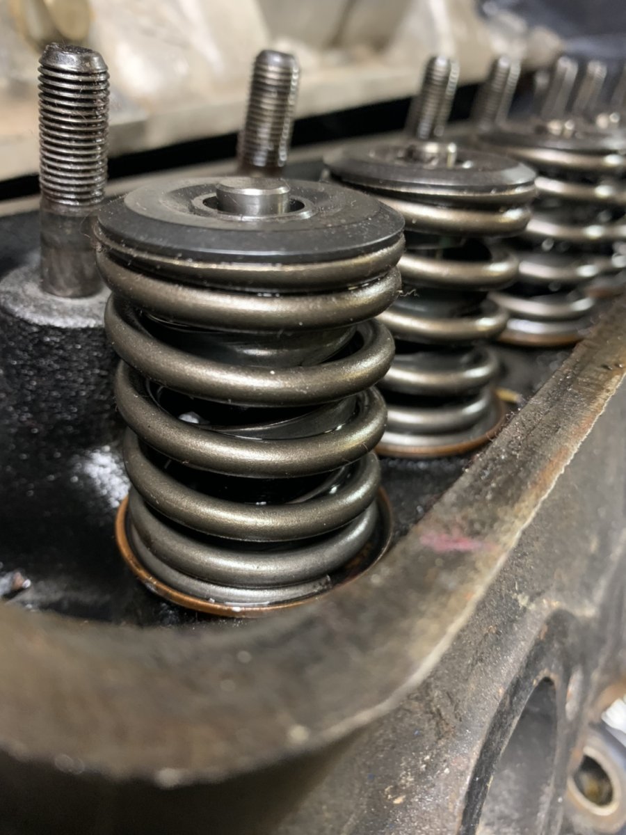

    So I’m pretty well caught up with where I’m at now. The floor is nearly done. I’ve got a 4 bolt 350 under my bench and I needed better heads. Some guy up in Kalispell bought a storage locker with a blown up SBC in it and put it on FB cheeaap. He had 8 guys in line for it but was kind enough to hold it for me while I drove an hour and a half up to get it. It had a broken rod. I scored vortec heads with dual valve springs and 2.02s, a roller cam, roller rockers, and a GM Performance TBI intake. I figure I can sell the intake and get enough for a 4 barrel intake. The heads look healthy. I’m not sure if I wanna spend the money to run a roller cam in my old block. Flat tappet cams and lifters are so cheap. I’m not sure I can even re-use a roller cam. I’d take advise there.... I also scored an Edelbrock 750 carb from a guy’s mud truck that needed more carb.
    If talking about vortec heads bums anyone out, I’ll delete this part. This car is about cheap and fun, ported big valve camel humps aren’t in the cards.

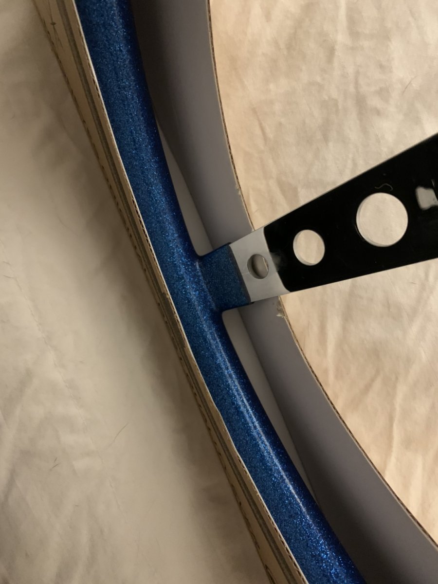

    My wife was kind enough to get me hotrod parts for Christmas.
    Now I’m going to have to do a blue flaked roof.

  26. scrappybunch
    Joined: Nov 16, 2011
    Posts: 415
    scrappybunch
    from nj
    Wrong spark plug in the head, unless it's not screwed all the way in.
    loudbang and Stogy like this.
  27. lewk
    Joined: Apr 8, 2011
    Posts: 1,010
    lewk
    from Mt
    You’re right, absolutely the wrong plugs. I think someone spent $$$ on parts and kinda slapped it all together and it blew up.

  29. I think they were 15x6. I know 15 inch diam for sure. Can't completely recall tire size, but it seems 215/75R15 sounds familiar. Been too many years and too many vehicles.....memory is foggy on some details for the old 60 El Camino. I do think those Supremes just look so good on the early 60's vehicles.
