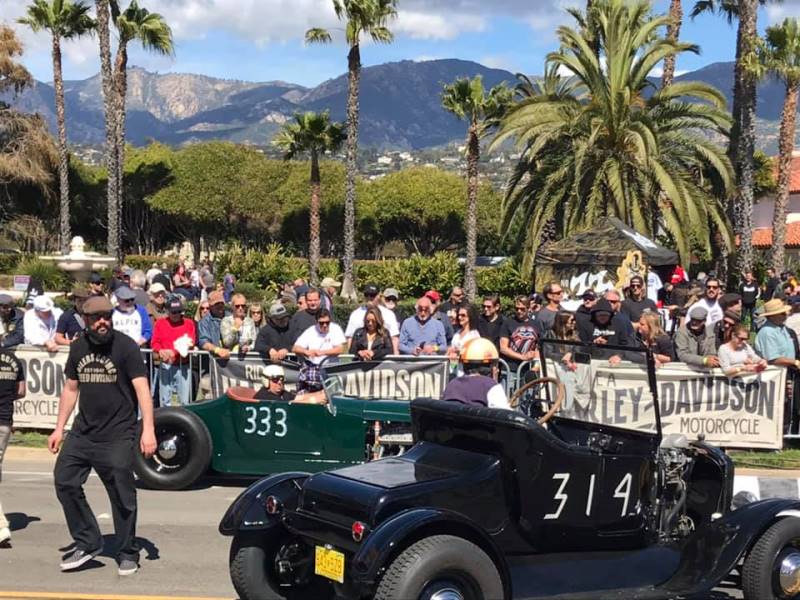

  12. Anyone have any more info on the 314 car? Miller overhead? Cheers.

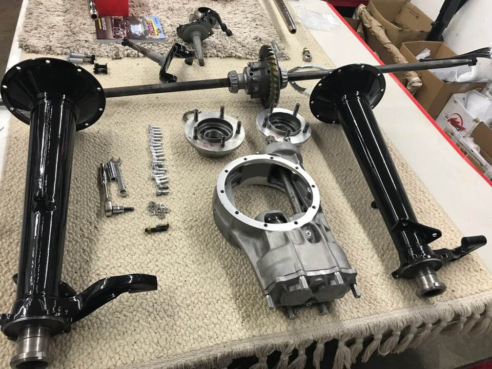

  15. I notice on the table of quick change parts it appears you have engineered a full floating hub to carry the rear end load and not become detached in the event of a broken axle. Am I seeing things or just being an optimist as I look at the rear hubs on the table. Do you use a trimmed down outer half for its taper to attach the axle to what looks like full floating hubs that are secured by a thick snap ring at the end of the housing?
  16. Cyclone Kevin
    Joined: Apr 15, 2002
    Posts: 4,227
    Cyclone Kevin
    Alliance Vendor
    Those are Cook’s Machine Works (CYCLONE) safety hubs, Ends of housing requires machine work and thread tapping. We still have the castings but Cook’s would have to do the machining. The bearings are available at most bearing houses. Many people have copied these hubs, I’ve seen several. Ours have our name on them. 1AA549D8-3DD4-478F-9509-1E185EC7236B.jpeg 704BB5C2-6270-4C04-B430-CB36D9113916.jpeg 7327E055-22C4-45BD-BEC3-DD216997B19A.jpeg E298AD28-18FB-414F-868B-08F511331177.jpeg
