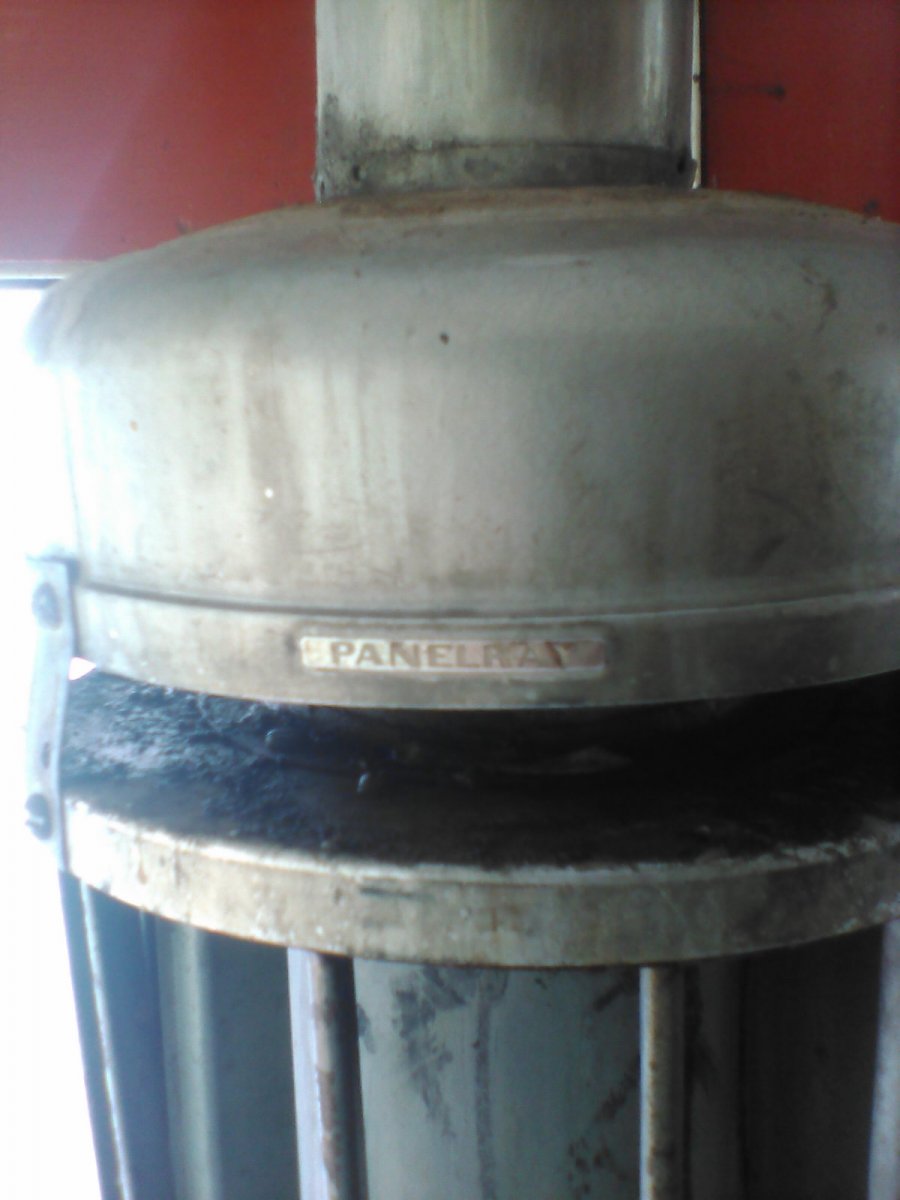

    A vintage (well, now it's vintage) Panelray stale air furnace was installed early on - it's the same type often found in '40s and '50s Airstream trailers. It's a basic one, with no thermostat (either off or on, manually controlled), but it's period to the truck, so I think I'll give it a mechanical resto and leave it be.
    Because tools are hard to sell from a cold truck? I'd agree the stock heater is woefully inadequate for our occasional -10F days!

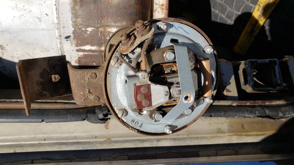

    Rear wheel seals blown, rear wheel cylinders leaking, and a broken return spring on the left rear. Replaced the spring (thank you Jim!), Got new seals, waiting on the wheel cylinder kits.

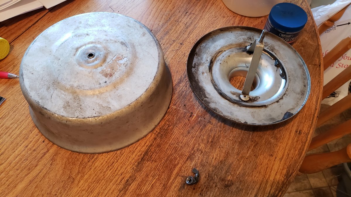

    Welp, put that in, along with new rear wheel seals, and overhauled the rear wheel cylinders. No leaks, temp stays at a steady 180°, brakes work great again. Man, this thing runs just phenomenally well. Smooth, pulls... Well, let's just say it'll hit 50. Eventually. With a strong tailwind. Original muffler has quite a nice sound to it, too.
    Took the air cleaner with me to clean up and see if I could find a K&N to fit it. Think it had an oil bath originally, but has this on it now:

    Truck is officially in my name. Installed new mirrors, the freshened air cleaner (with a new filter), replaced a damaged lifter, un-stuck the choke cable, and determined the generator isn't generating. Also inflated the tires. Little easier to steer now!

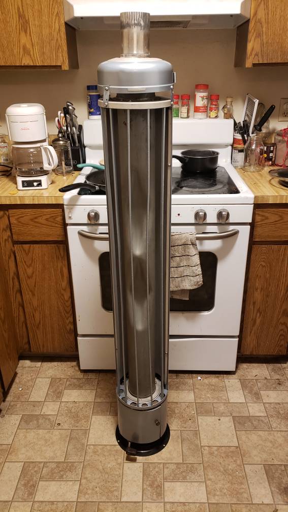

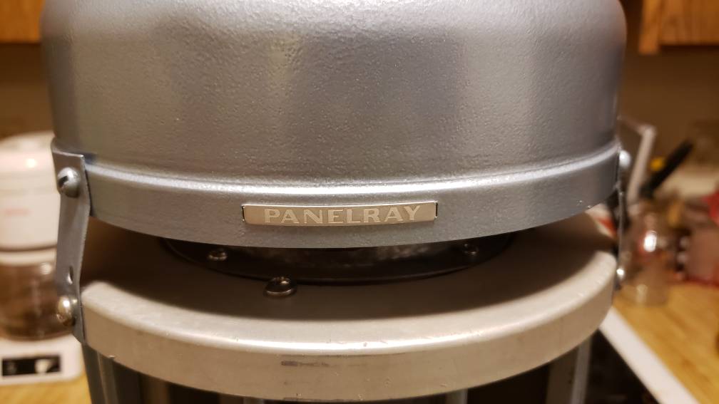

    Restored the PanelRay heater, using my new HF abrasive blast cabinet (cheap, but after some fiddling and sealing, works fine for me).

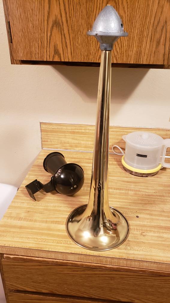

    Also restored the original electric horn, and an antique Reon air horn I picked up for $20. Thought it was steel or tin... but after bead blasting it clean, I discovered it's actually brass! No idea why it would've been painted like it was. Think it may have been a train horn at one time.

    Got the vintage air horn I picked up to work. Will head out this weekend to find a place to mount it. Vid to come! Man, it sounds good!

  29. Alister
    Joined: May 10, 2009
    Posts: 51
    Alister
    from Idaho
    That's true, and they're all things I'm considering!
    Side drafts won't work - they'll collide with the floor and pedal linkage. I'd have to build an updraft and score another Carter BB1 or two, in order to make things appear stock inside. Flowing and synching? No prob! Been a motorcycle mechanic for years, I own two multi-carb British cars and a dual-carb VW. I breathe through multiple carbs!
    Lemme tell you some stories about getting ancient SUs to play nice...
    A 261 would be ideal. Good bump in compression, mild cam, and second carb should get me to the 140-150hp range. Alternatively, I have been toying with the notion of a GMC/Detroit 4-53T. Wouldn't be a Stovebolt, but it'd still be period GM. The late 'Silver 53s' had factory ratings up to 285hp. I -think- it'd fit without major mods, if I find the right configuration (intake/exhaust sides, auxiliary drives, etc).
    The only real problem with the Stovebolt is, that no matter what you do short of power adders or non-pump fuels, 200hp is about all you can get, and still be able to daily drive it comfortably. Otherwise, I'm inclined to keep it simple-ish and enjoy it.
    Another alternative is swapping to a later 250 or 292, which came with 155 and 175hp, respectively. I've built a few, and 300hp isn't too hard, especially with the 292. Torque? Not a prob.
    And last, I already have a GMC 401M V6, modded for a 4bbl. Already have the light truck bellhousing and flywheel. Not a drop-in, but that would definitely provide enough grunt (237hp, 440lb-ft stock)! Probably fit, too, since it's shorter (in height). Valve cover would be tucked under where the Stovebolt's manifolds are.
    The general idea is to keep it old-school. No FI, no LS swaps, no Cummins swaps, and for SURE... no automatic trans.
    Cheers!
    Sent from my SM-G960U using The H.A.M.B. mobile app
