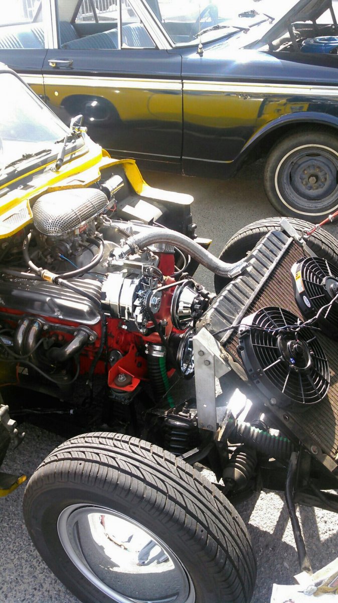

  25. Last one I bought (2006) I paid $700 for. It was a '66 300hp 327, and it came with a th350 with a B+M shift kit. The engine was never rebuilt, and complete from carb to the oil pan. The engine was in a '70 Camaro and the owner was swapping it out for a 400sbc and a 4 speed. I installed it in a '62 Studebaker Lark and it ran great! Used no oil and gave me no problems. Last car I put it in was an OT '68 Triumph Spitfire which became a 1500lb fire breathing beast! The only modifications I did was to add an Edelbrock carb and intake, hei, and headers. Traded it this past fall for my current ride, my '50 Dodge. (The Spitfire scared me- I guess I'm getting old!)
    OahuEli, lewk and grumpy32 like this.
