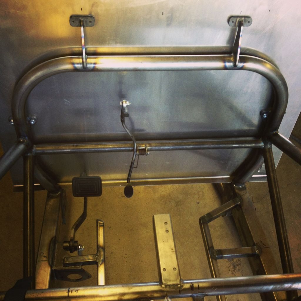

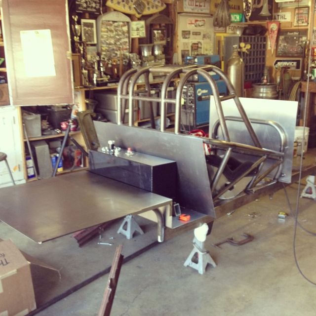

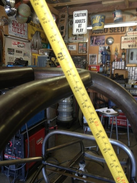

  4. You can see the gas pedal ( I welded the mount to the tube) brake pedal ($90 from Classic Steet Rod MFG at the Turlock Swap Meet) and the upper firewall mounts that double as radiator support rod bracket mounts!

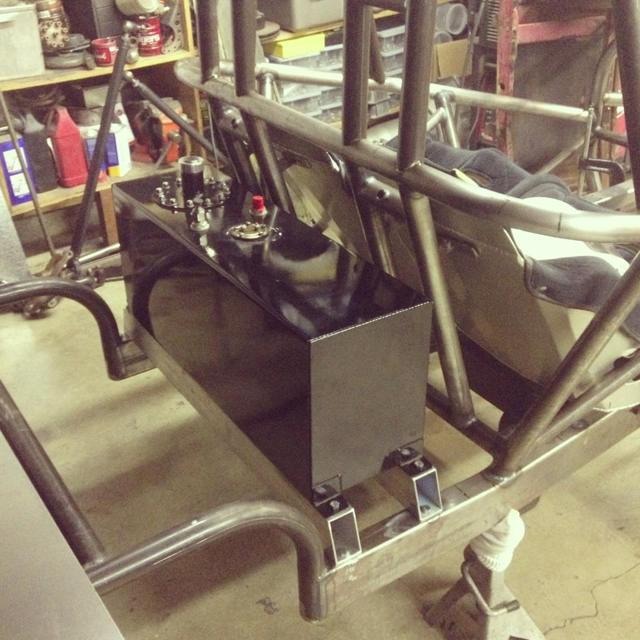

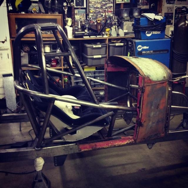

  5. ImageUploadedByH.A.M.B.1375134833.403184.jpg ImageUploadedByH.A.M.B.1375134852.223121.jpg ImageUploadedByH.A.M.B.1375134873.864762.jpg ImageUploadedByH.A.M.B.1375134886.621892.jpg
  6. Mo' pics... I hope the cage is Kansas City Approved! Once I get the body on, it'll be more clear as to how low it is!

    The fabric is called Carbon X, it is flame retardant SFI approved. I made aluminum panels that fit into those pockets out of very thin aluminum. If you have even a cheap brake it will help as the seats have a lot of angles in them. Glenn Kramer padded the panels and stitched them up with French seams and then riveted the panel from the back side. Rickie Jones/quartermax sells the Carbon X and there are other brands. I bet DJ safety would sell you a yard or two.
    Don't forget to put straps over the gas tank.
    waiting on cool air to play with the Nova again.
  8. Thanks for the tip on the straps! It's those little things they don't tell ya' that will haunt you in the tech line!

    sam with all the tubing (over head etc.) how fast do you plan to certify this cage. I know its for safety but it seems overkill for a 10 sec car. (maybe the rules require it??)
  14. Old6rodder
    Joined: Jun 20, 2006
    Posts: 2,508
    Old6rodder
    from SoCal
    1. HA/GR owners group
    All "open" cars're now required to have full cages for NfHRA.

  17. Ken, like Old6rodder said, pretty much anything that hauls ass needs a cage.
    The first time I dumped the trans brake on a 10 second roadster, I was sure glad I had a bunch of tubing around me!
    The NHRA used to spell out in their rule books cage designs "to 7.50 ET"
    Now the basic designs are good to 10.00 ET. :(
    Basic designs being door car, street roadster, rear engine dragster, front engine dragster and funny car.
    Then at some point in the past ten years they decided to have the SFI foundation spec the chassis for anything faster than 10.00
    Chassis have had to have had "certifications" once they go 9.99 ET for many many years...
    But specific spec chassis (2._, 10._ and 25._) for cars 9.99 and quicker is relatively new.
    That being said, it is wiser to follow an SFI spec chassis when you build a car.
    For one, a car like this with any kind of real motor will run 9's very easily. (I plan on it)
    So you don't really want to build something with just a hoop, and then get a new set of heads and cam and need to rebuild the whole car.
    Also, it makes the resale much higher if it certifies to an SFI spec.
    As far as "all the tubing" goes... each and every tube in this cars' construction is laid out in the SFI spec 10.3 chassis manual ($35 from SFI) that I am following.
    I was lucky enough to have Division 7 tech, Ken Gentry come by my house and work with me to come up with a solution to my problem.
    I wanted to build a spec chassis that you could squeeze two people into.
    At first I wanted to build a "door car" style cage... but he said that the basic door car chassis is only good for cars that originally came with a roof.
    So we looked at a street roadster chassis... and they have a lot of tubing in the passengers compartment.
    So we settled on the 10.3 funny car cage... and since the spec does not specify a "width" he said that I could build it, just wider to accept two people.
    That's my nut shell, and I'm sticking to it.

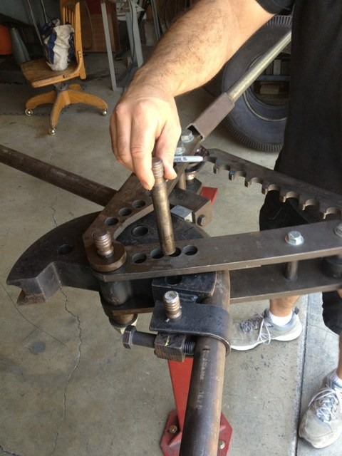

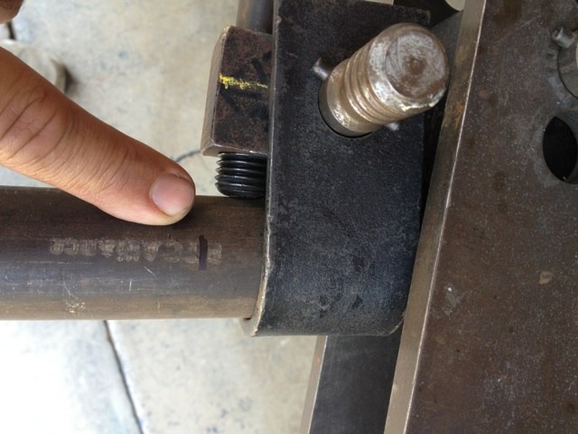

  18. Tube bending 101...

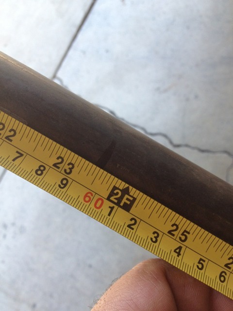

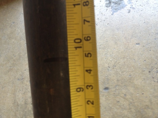

    Measure how long you need the bend to be. In this case, 22 1/2"
    Then mark the tube at 22 1/2" with a sharpie.
    From the top of the bend to this edge of the bender measures 12 3/8" You can see the little yellow mark in the square piece of steel. That is a random point that I measured to... So I have repeat ability with my bends.
    22 1/2" minus 12 3/8" equals 10 1/8" I added an extra 1/8" an marked the tube at 10 1/4" from the end.
    I then put that mark even with my known datum point.

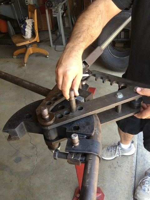

    Once clamped in the bender, I start bending. Sorry for the odd pics... The camera man didn't want to break his new iPhone by taking a pic of my mug. Instead focusing on my rippling forearms!

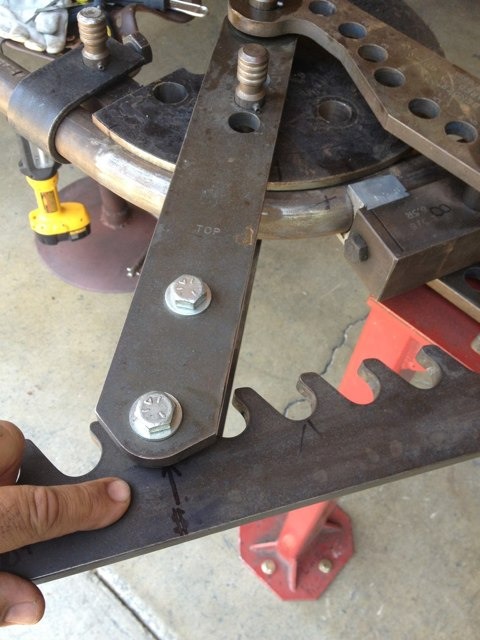

    I then ratcheted it back taking a new bite on the ladder after each pull.
    Once to the end, I had to reset the pin.
  19. And then ratchet it to the money shot notch.
    I marked it so I could do a second bend. It's nice to end on a full ratchet pull... But sometimes you can't (like on a 90 degree bend) and you have to measure the bend and account for spring back.
    Then loses the horse shoe clamp and the bend is done!
