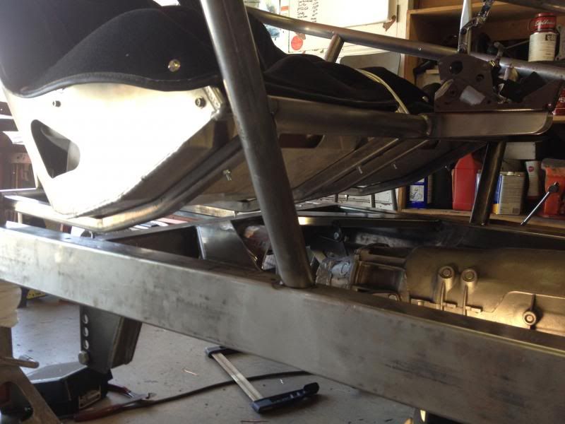

  10. You can see where I used these bent tubes... the seats have distinct bends in the bottom, and I was able to bend the tube to match!
    This tube was .120 wall... a little harder to bend.
    Sam

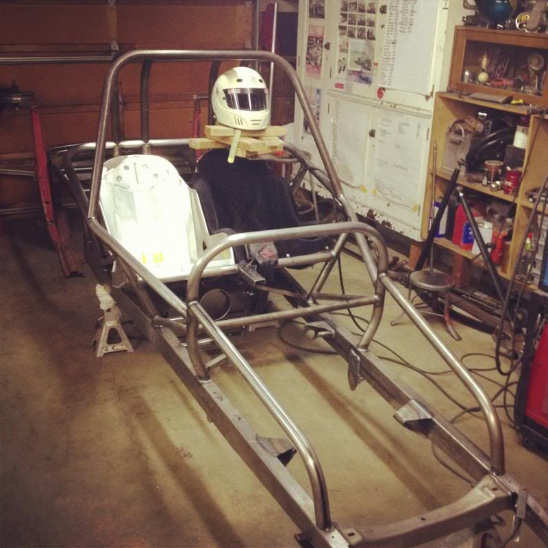

  16. Steve and I bent some tube last night... Need to do the second hoop over the head, and the helmet bars... it's coming along!
    I am going to bend the other hoop over the head and take some pics of how I do it. Probably tomorrow!

    Sam, are you going to brace the rear rails to the cage? How does the tubing all fit within the body?
    Mart.
  21. Yep... there will be bars from the shoulder bar down to the rear rails and an X from the shoulder bar to the shock mounts...
    I've just began the body fittin' scheme... it should fit! :D
    Sam

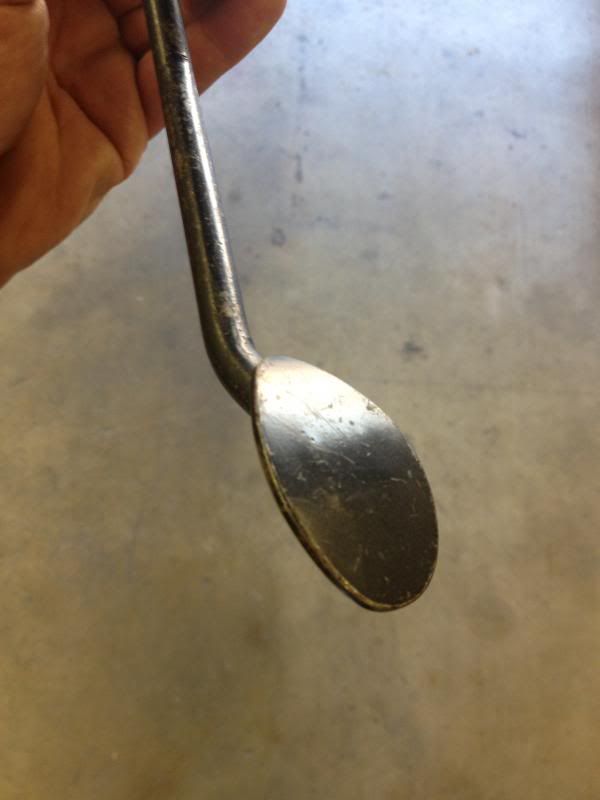

  24. Do any of you Old Skool HAMBers remember the tech post I did about 10-11 years ago where I turned a junkyard Datsun gas pedal into a spoon pedal?
    I still have it.
    I never used it because the pivot point was wrong.
    So I set out to make it work on The Drag Rod.
    Cut this off... welded it back on.
    All ready to go!
