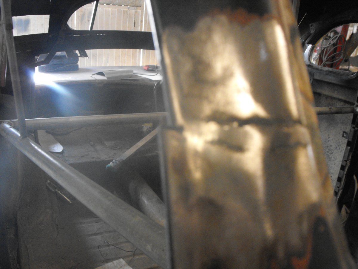

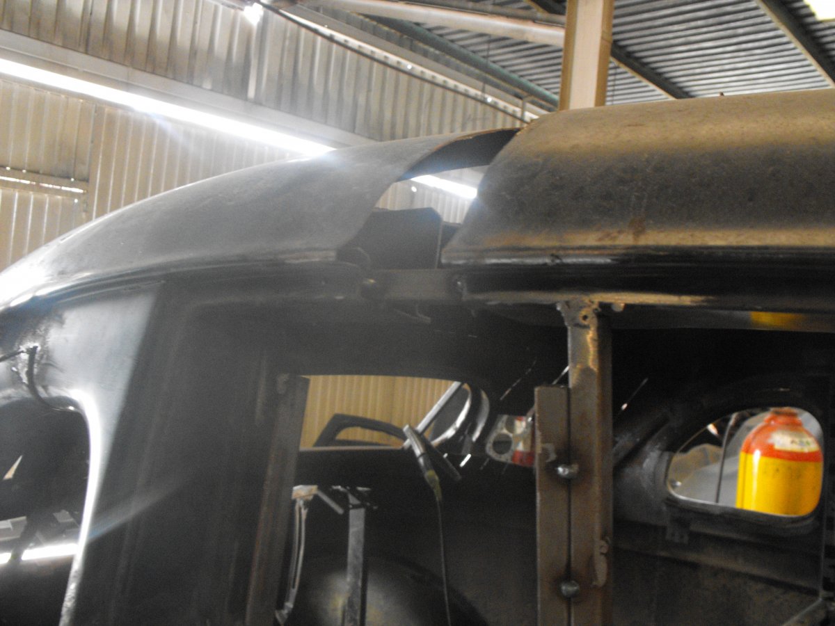

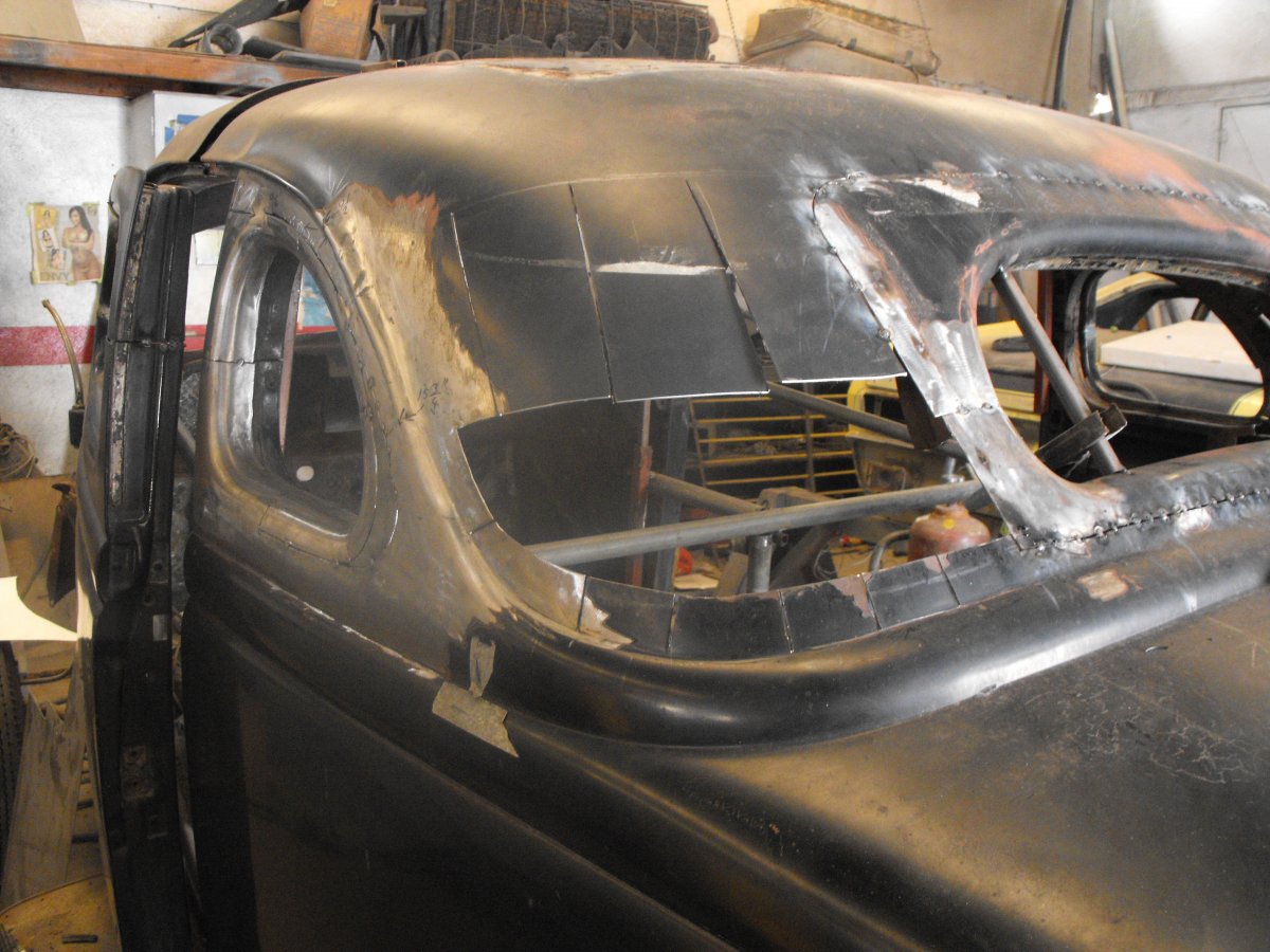

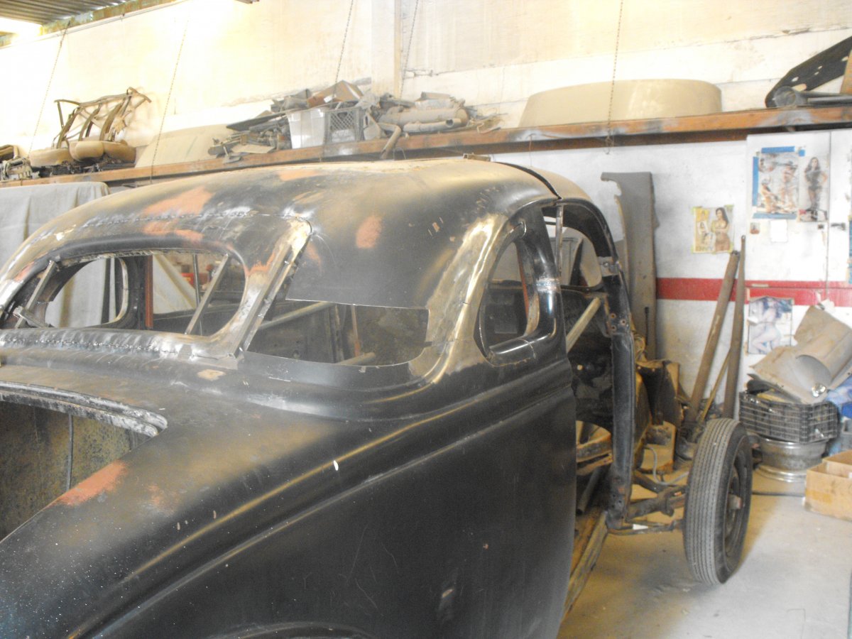

    Ok so back to the chop, first thing to do is install some horizontal bracing, otherwise your A and B pilars will bow out. Next install some veritcal bracing , use some tubing and make it ajustable so you can lower and raise it as you do the initial cuts. My Friend Pedro Kanguro flew out from Auzi and did the inicial cuts. Use 2 inch and half inch tape to mark your cuts. Measure and remeasure , you don't want a crooked chop. Always cut less then what you need cut and save all the pieces, you will be needing them later. Most important, grab a stool and set it about ten feet back and visualize the chop. Look at the whole car and not just the area you are working on, the roof line has to flow.
    I'll post some more later.

    Another important thing to remember is to check your door gaps before you pull the doors off.
    A lot of these cars have rusty floors and sagging doors. Measure and check your stock door openings,
    if your subrails are rusted out or broken, they will throw your measurements off.
    Fix all these issues before you even think of chopping the car. Also put some horizontal braccing between the A and B pillars, otherwise the front and rear section of the body will sag away from each other.I'll try to get some more pictures posted.

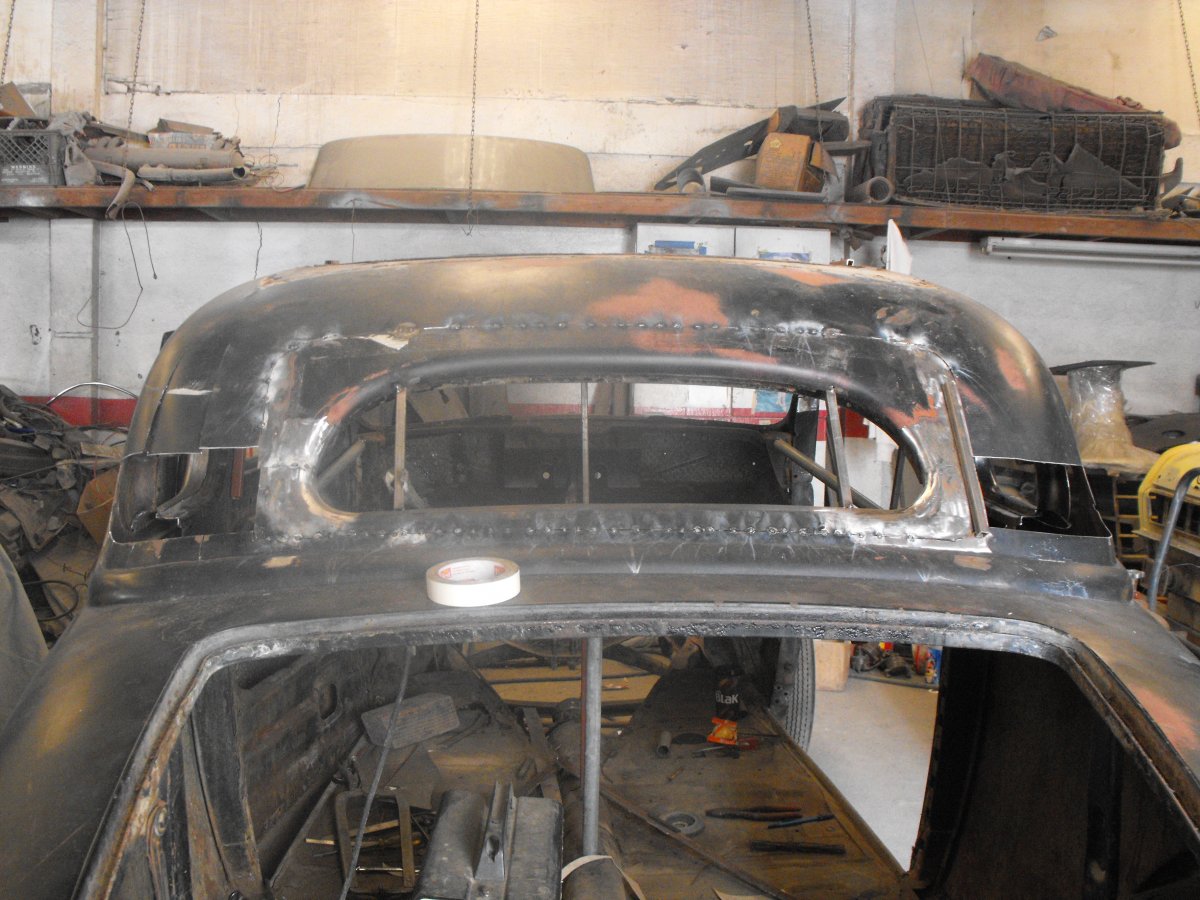

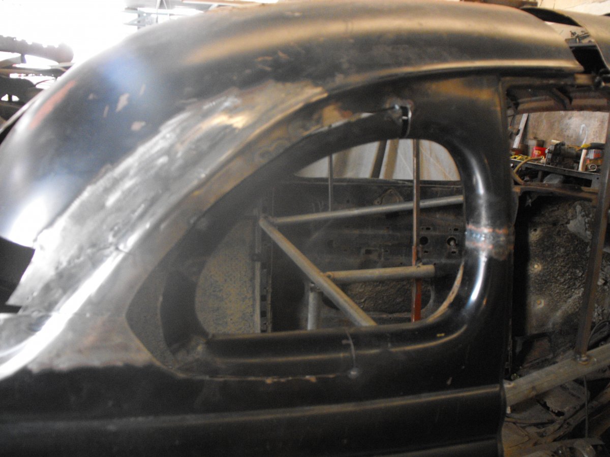

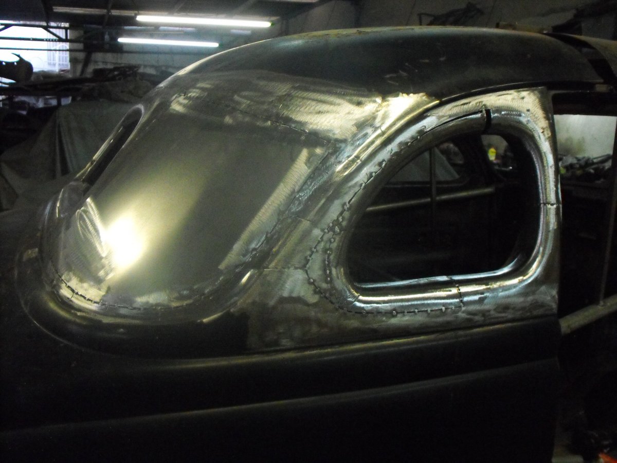

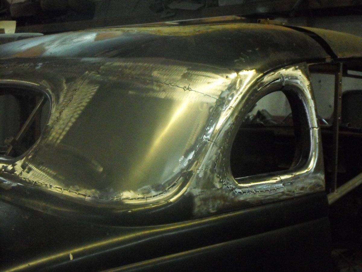

    Notice the rear window has been cut out, you want your rear window and quater windows to be in preportion to the rest of the car. You don't want the quater windows too small or looking like a slice of pizza. I also like to have some extra doner doors for my guys, they have a lot of pieces you can use for the windows and the tops of the doors when you lengthen them.

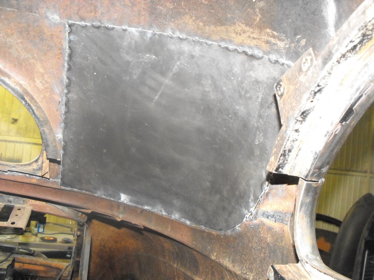

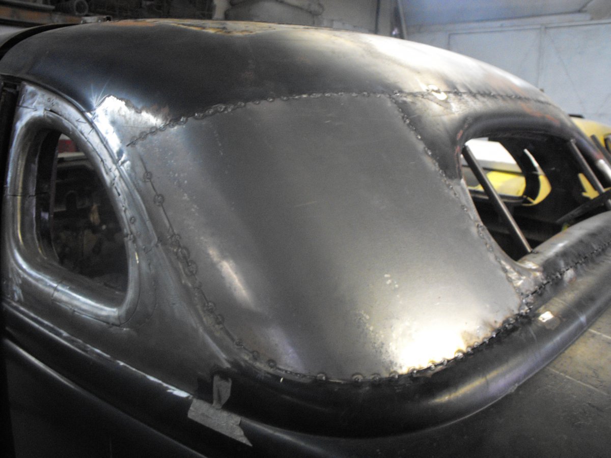

    Notice the panel between the quater window and the rear window.Originaly, this was delt with some pie cuts but we later decided to cut it out and make a new panel. Notice Pete cut out the lower section of the quarter window before laying the rear section of the roof down. This is done so you don't end up with the pizza slice quater window or one that is too small.
