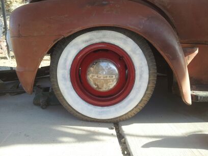

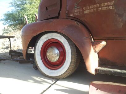

    UPDATE:
    So finally had a little time to mess with small stuff on the COE.
    I cleaned up some 16" steel wheels and set some 215 85 16 tires on them,these fill the front and rear fenders better.:

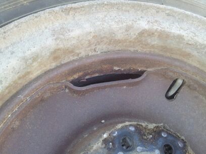

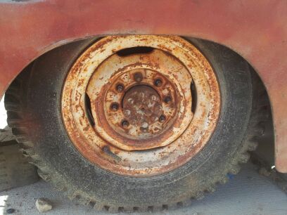

  26. So i have a little update.
    I havent got much done to the coe just curse it and look at it.
    But I did find some 17.5" ford steelies with ford caps that i can use for it.
    The down sides are:
    I only have 3 and they might be Widowmakers ....boooo!(that would make my wife happy.)
    I will pm wheel kid And ask him if he can make em 18"s.
    I also have 2:16" ford steelies that take the ford centercap so I was thinking I could use Those 16s in the back tland the 17.5 in the front...
    Waddayasay???
    The last ugly wheel is the 16"...
    tb33anda3rd likes this.

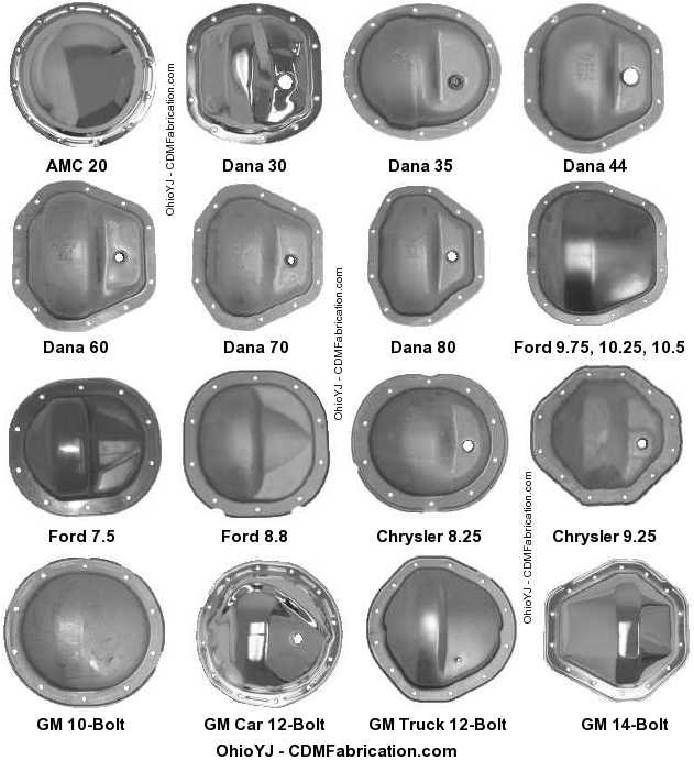

    Also I'm looking for some assistance on ID'ing my axle,i googled the numbers but i got nothing.
  30. The ratio of the rear axle can be figured out by numbers that will be stamped on the edge of the ring gear.
    And type of axle can be figured out from this chart.
    Kind of looks like a GM corporate 14 bolt.
