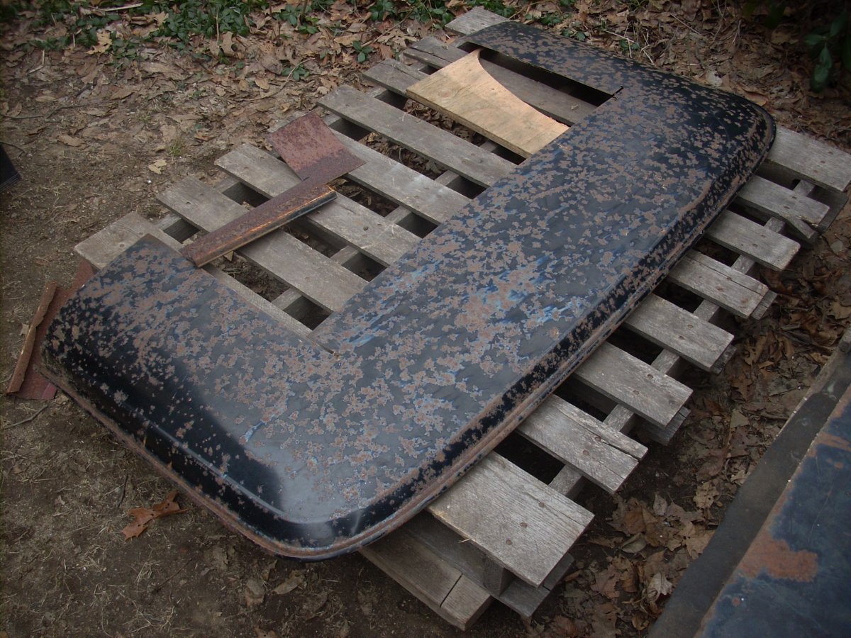

    A friend of mine gave me a '57 Ford wagon roof panel, so now I have a filler if I decide to use one ( also have a 6 ft piece left!) DSCN3754.JPG

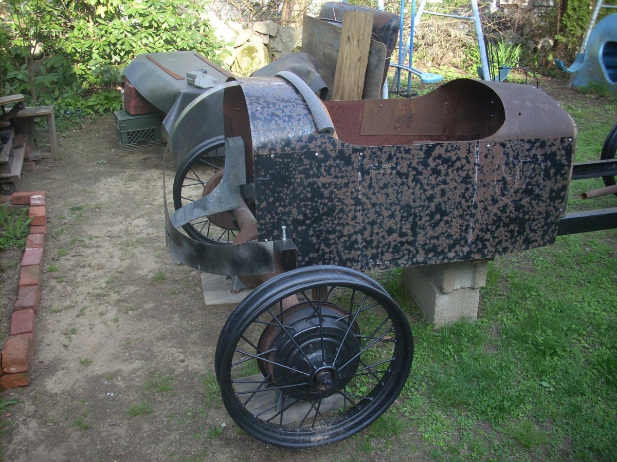

    Hand crafted from a 1957 Ford station wagon roof, sitting on a modified "T' frame, with "A" axles front and rear, this magnificent example of wasting time is ready for a drivetrain. All the hard work is done- with a couple of weekends and some simple hand tools, YOU could be blasting down the beach at TROG giving everyone the finger and singing "Back in the Saddle Again".
