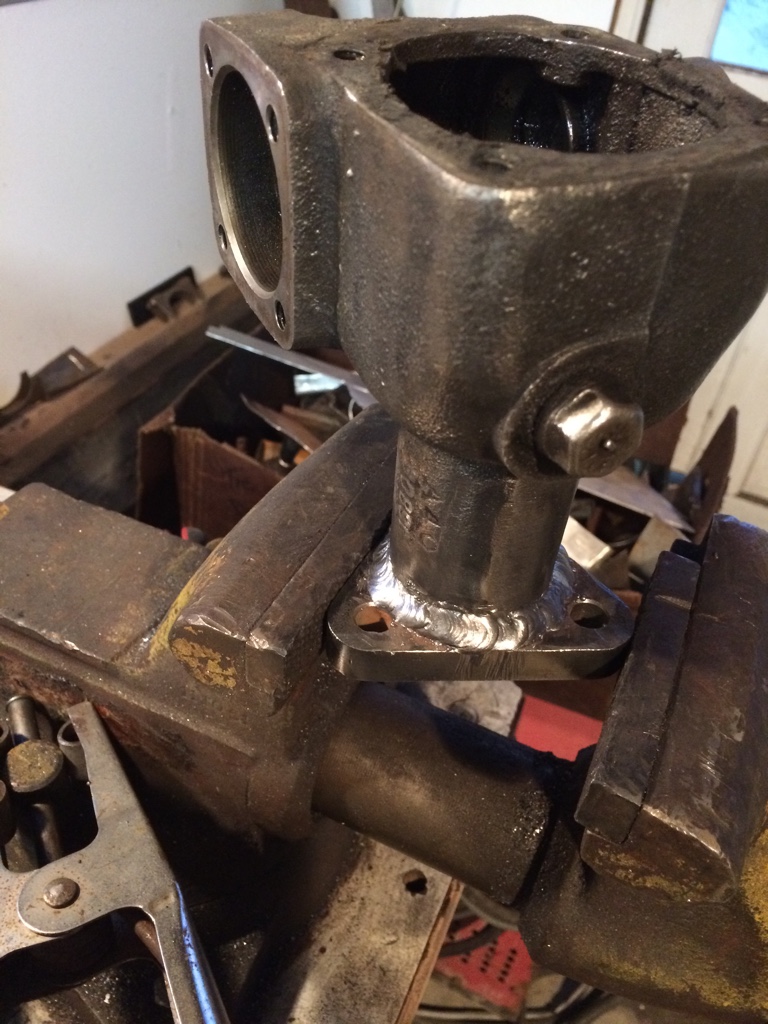

    I spent tonight working on the steering box. I had my wife (who is my go to welding expert) try to tig the flange onto the box but the only filler rod they had at her work kept cracking when it cooled so I preheated the assembly and gave it a couple passes with the mig welder. Not as pretty as the work she does but functional.
    I replaced the bushings and now I need to borrow a reamer to cut them.
