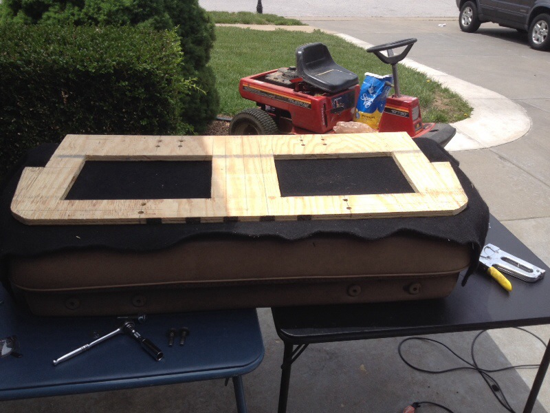

    The base plate that I bolted the seat to. I cut holes in the bottom just to lighten up the weight of it. One thing that is not visible, is that I used a 2x4, lying flat, as a spacer between the seat and this layer of plywood. I used some scrap felt style carpet to cover the base with.
    This is the bottom layer of the seat base. It allows for additional clearance for the seat hinges, as well as lets the mounting bolts be recessed. I used 1 1/2 wood screws to attach it to the other sheet.
    The pieces of plywood screwed together and covered with the felt carpet. I put in 3 seat adjustment holes, spaced like the stock seat, to preserve the primitive "seat slider".
