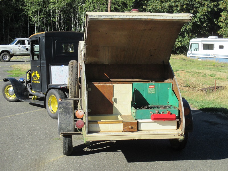

    You will also like the fact that it is powered by a 6 cylinder Chevrolet engine. It also has a 4 speed truck trans with a granny gear. The teardrop was saved from being tossed on a bonfire and restored. I have that in my garage at home and plan on building them to sell. It is 4' x 10' marine plywood sides.

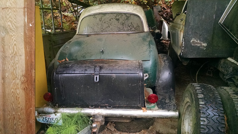

    I would like to see it back on the road which entails gas, battery and tires. The body looking as rough as it does makes us not want to take it anywhere until that is fixed. He changed some things on the car over the years one of the them was running gear. Originally it had a 223 that came out of my 56 Ford pickup along with the 4 speed and the 3/4 ton axles under it. The engine that is in it now is a 250 that came out of my 66 Chev van and the trans came out of my 54 Chev 1 1/2 ton truck. The front spindles were changed from the 3/4 ton drum brakes to 1/2 ton disc brakes and the rear got a half ton 9" as well.
    With the change of the axles came the change to 15" rims with Cadillac hub caps (a look I never liked) and wider radial tires. The wider tires made it harder to steer with the old and worn manual steering box. I would like to see it with the 16" wires again and I think my dad would as well. That could be done by using wheel spacers so that the edge of the wheel center would clear the caliper and rear drum.

    Now that I think about it,the rear fenders are 30-31 model A so replacing the beat up ones that are on there would be as simple as getting a set of repros. The front fenders are from a 31 Graham and the spare tire mounts are not wide enough for the tire to set in so it sets on top. He has a set of non-sidemount 31 Graham fenders that we were thinking about using and still set the side mounts on top like they are anyway. I think it needs the tires on the sides to break up the side a bit. To do the car right I would need to create a sub frame for the body and rubber mount it to the frame because right now it is welded to it. The good thing is now I have the metal working skills to do all that it needs since I have been working at Fosses Hot Rods and Cool Cars for the past 10 years and getting paid to learn everyday.

    These are a few pics that I took last year of the teardrop. I plan on using it for plans to make new ones but widen it so that a full mattress will fit in it. IMG_0288.JPG IMG_0289.JPG IMG_0324.JPG IMG_0325.JPG IMG_0326.JPG

    I got some pics of the car where it is sitting, that show the condition of it now and some of the repairs that it needs. IMG_20151114_125629197.jpg IMG_20151114_125641675_HDR.jpg IMG_20151114_125707477_HDR.jpg IMG_20151114_125714029_HDR.jpg IMG_20151114_125754976.jpg IMG_20151114_125830170.jpg
