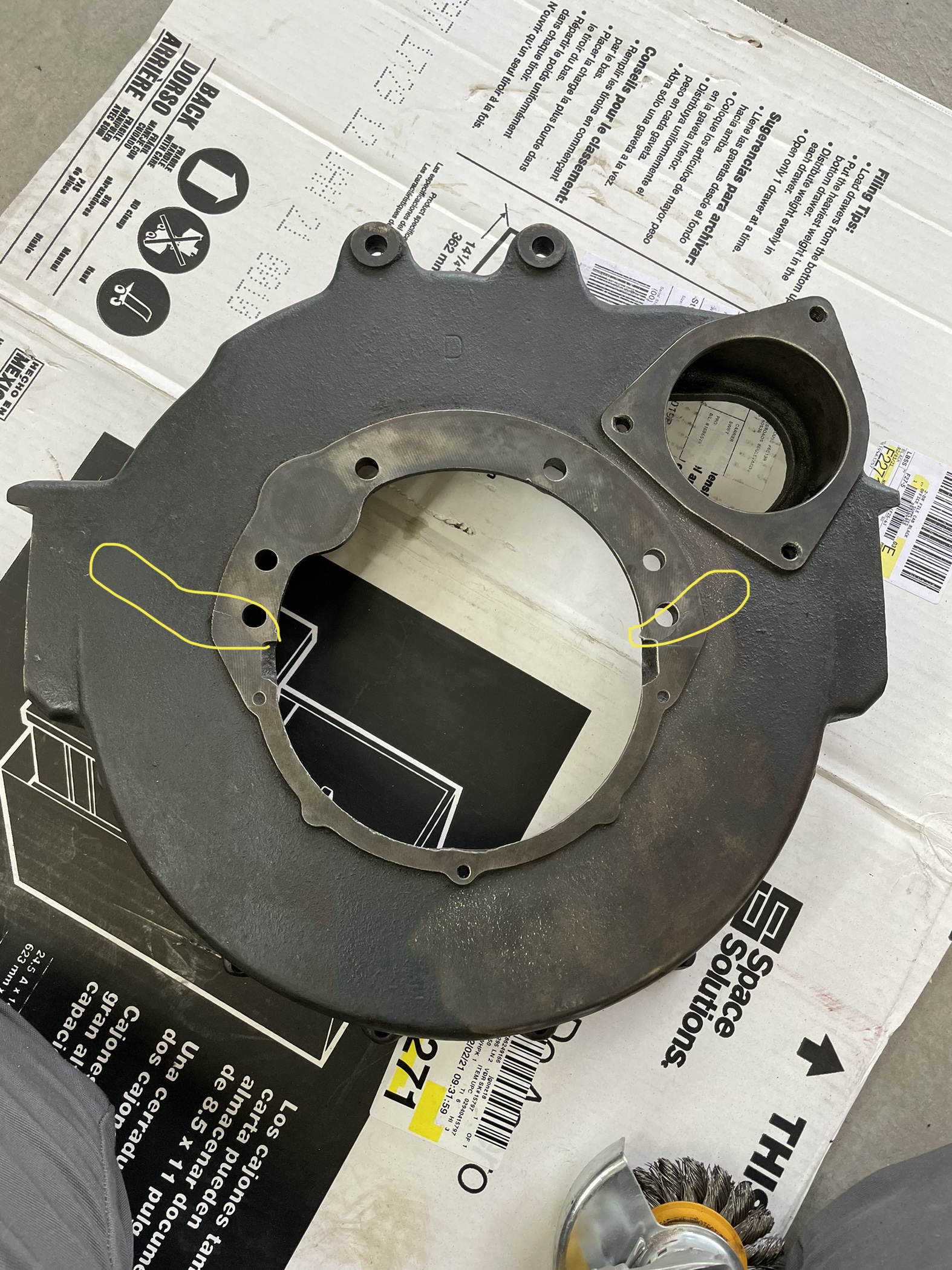

    Well, son of a! The flywheel housing is cracked. I know conventional mig welding is out of the question. I also know some folks say drill the ends of the cracks and run it. Stumped......thoughts? 77D51148-4F3C-4F81-8722-47BDF565BD82.jpeg

    Cast iron?
    Many methods have been used over the years, from welding (usually involving heating ovens first) to an oldie, something you could do at home. Drill, tap and install a piece of threaded rod. cut flush and do another overlapping the first. Look for cast iron stitching. There were a bunch of different weld/braze videos listed to compare.
    Since this can open the crack a bit and the flat surface in your application is critical, I'd check into pro repair and replacement costs to see what your choices are in relation to time, cost and final result. As always, cheap, fast, right, pick two!

    There are guys that can weld that with nickel rod. If it was mine and a stock banger I would braze it. Brazing is probably as strong as the rest of it and a lot stronger than most of the pundits think. It is a legitimate vintage repair on cast metal. You would want to have it surfaced afterword. I wonder why it cracked? Warped? Misaligned? Loose? I doubt if it was torque.

    They do crack. but, henry made 4 million of em, I would find another. If you were close, i'd give you one. they are not that valuable. best of luck for you

    Gonna check Bert’s tomorrow to se if they have a good original. Repops are about $500! Wish you were close, you seem to know a heck of a lot about A’s.

    I have fixed similar with drill end of crack,preheat part to 400 degrees and arcweld with nickel rod.Has worked well

    Good luck finding an un cracked original. Never seen one. Was a weak design and worse if the shims are not used in assembly.

    Score! Found an un cracked 31 housing at Bert’s. That place is a goldmine. May have come home with other crap too... 7767B963-6A62-4F65-BD6B-9A1454FFDB90.jpeg

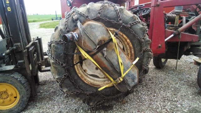

    You are making great progress. Here is how a friend cleans gas tanks. He starts with a couple of gallons of gravel.

    I clean gas tanks similar to that, but use my wheel painting machine, which runs at 5 RPM, and use a tube of BB's so as not to scratch off the zinc plating in the tank.
