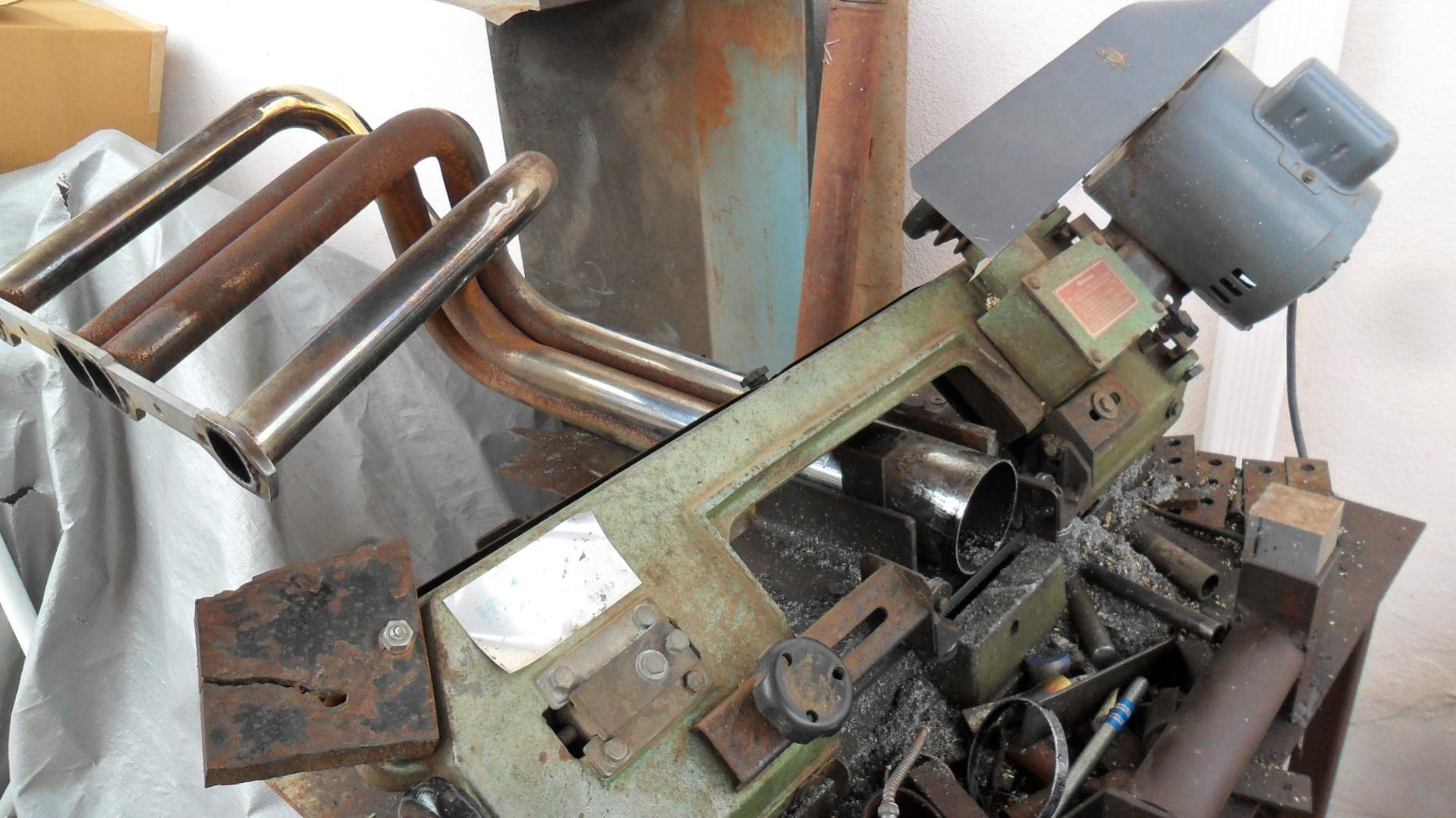

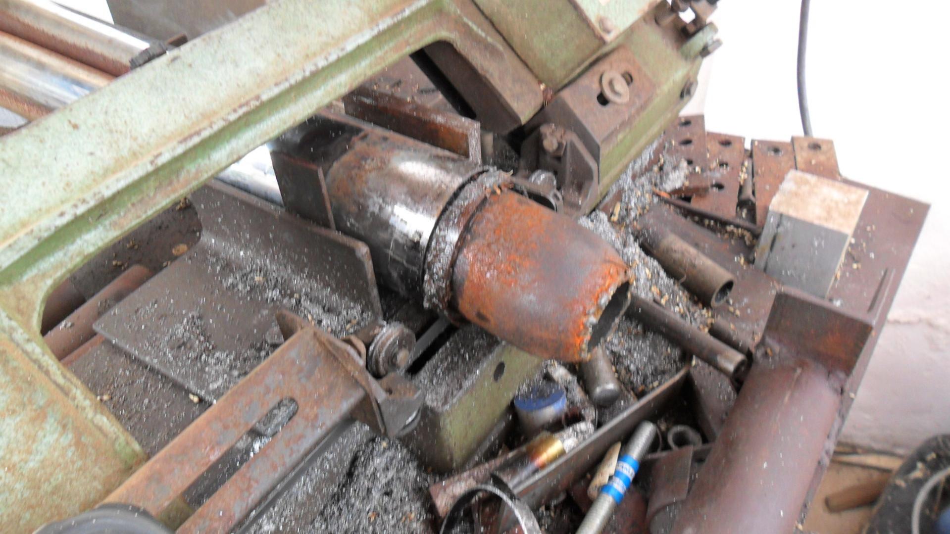

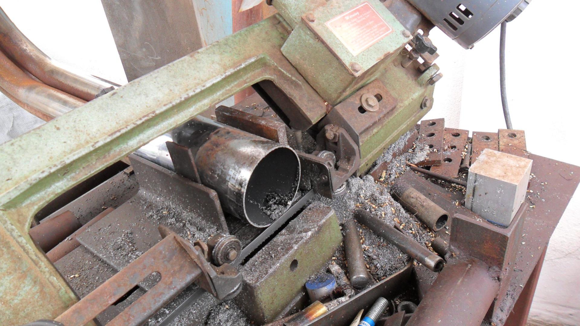

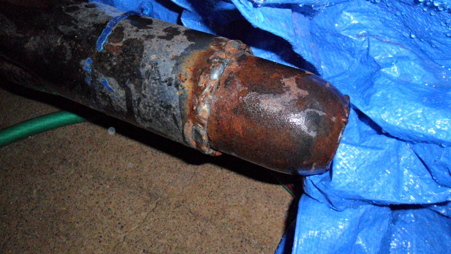

    Hey gang, not much to post as far as progress this weekend as I have had to double down on the touring for my client. I started making something of the headers this weekend. See, the P/O and his buddy didn't have a usable set of turnouts handy, so they decided that cutting an old rusty glass pack in half and jamming it in and welding a bit would do just fine... NOPE! Goes right back to what I was talking about before. If you don't have the "right" stuff, instead of jamming whatever you have in and running with it, take a look backwards to before the "right" stuff was, and think about what you have, or have available to you. In this case I whipped out the band saw and cut the offending glass packs out. From here the plan is to use a straight extension back to the door line, make a four bolt removable cap, a drop that runs under the body into a short glass pack, than paint the whole mess white after a whole bunch of sandblasting. Cheap, simple and just about in line time wise with our self imposed look of '64.
    I did run into one minor hitch though. I went over to one of my semi-regular haunts the other day called "You-do-it-truck-stuff" on west Van Buren, which has for 65 years been a source of big truck parts and accessories and veritable smorgasbord of 3" and bigger exhaust stuff, only to find the doors locked, padlocked and the building empty. There went my plan to buy my exhaust extensions this weekend! There are a couple similar joints around town, so in a few days I'll have some time to get out and do some exploring and find what I need. If not, there is always the exhaust parts warehouse out in Mesa...
    I know it kinda looks like I'm not following much of a plan at this point, and I'm kinda skipping around and doing weird little bits. I have a tendency in life to correct the things that offend me the most first when working on a project for myself. In the little bit of time I have especially in the summer, when I'm not working on the paying stuff, this is kinda how it has to go. As it cools a bit and gets back into some reasonable weather and longer hours to be worked, stuff will make a bunch more sense.

    man, what a dogs breakfast! Good work Chip.
  11. need louvers ?
    Joined: Nov 20, 2008
    Posts: 12,903
    need louvers ?
    Damn straight dog's breakfast! It took forever to go through that mess with my big band saw!

    Over the years I have watched friends do crap like that dozens of times. Its always "well, I just want to get it running, I'll fix it properly later". So then it takes 3 times as long to fix the cobbled up mess as it would have to just run out and pick up the stuff and do it right in the first place, so it stays like that, and they end up spending the next five years making excuses for it.
    My attitude is "Its your CAR for crissakes, you spent all this time and money building it, and now you are gonna screw it up with a bunch of half-assed hack jobs when you are in the home stretch??!!:eek:".

    This car IS a whole batch of half-assed hack jobs after my involvement with the chassis. When I put a chassis together, I ALWAYS go out and purchase the correct length and grade hardware to do the job it's intended to do. Since this was the third car I did for Roy, he said "Don't spend the money this time, we know what to get and where to get them now, you don't have to". So, it's cobbled together with whatever was in my nuts and bolt bin at the time... I found a front radius rod pivot last night that was still just hand tight, and grade 2... Scary stuff!

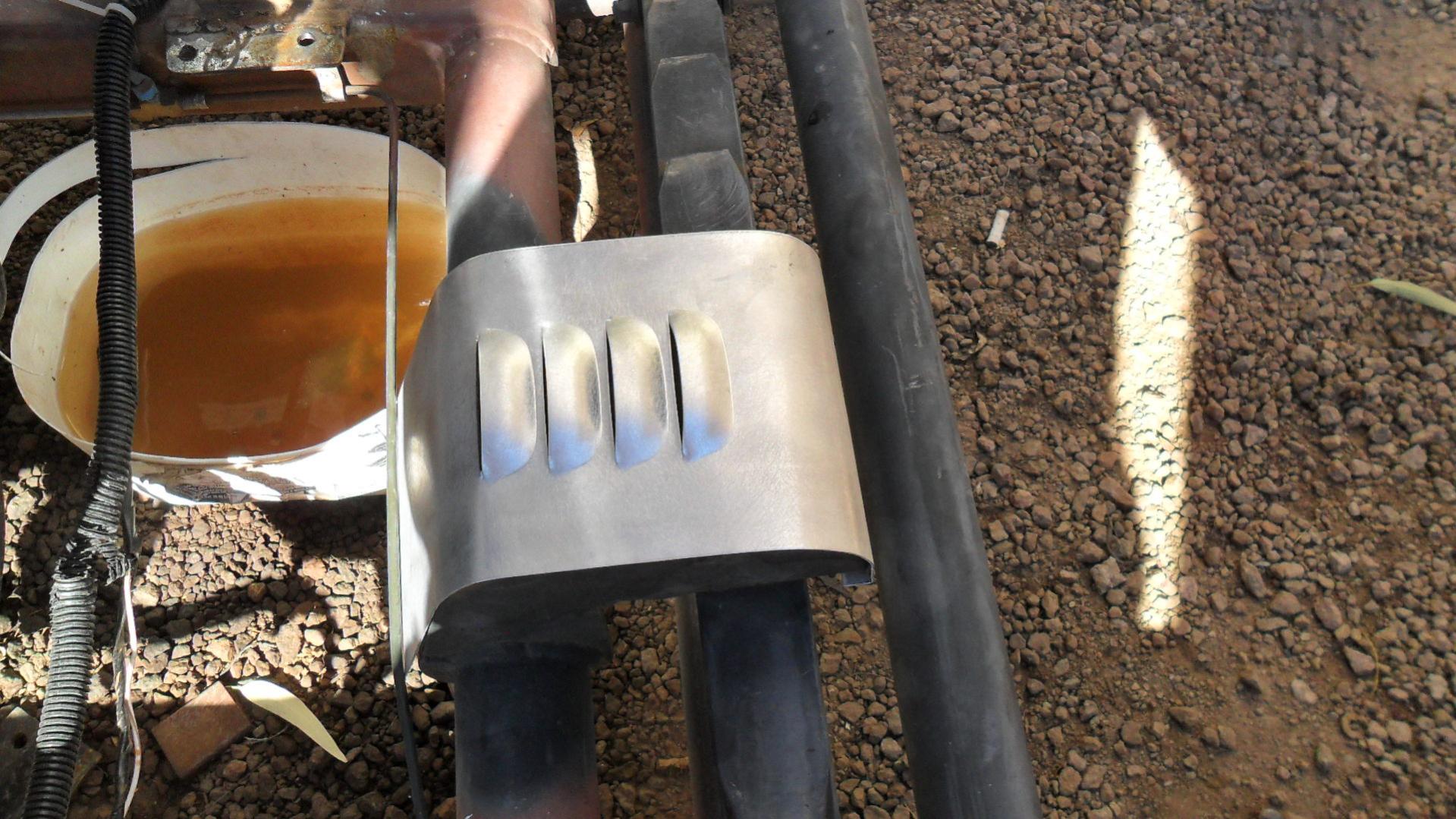

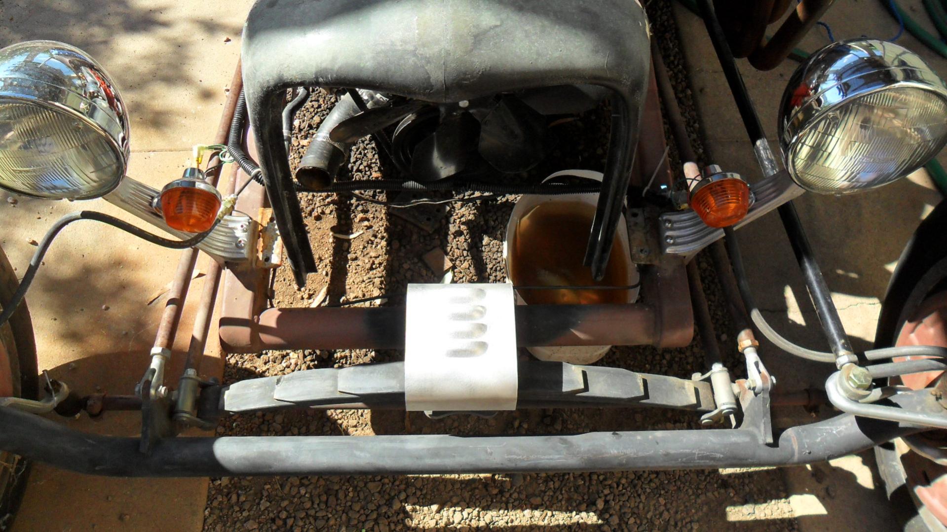

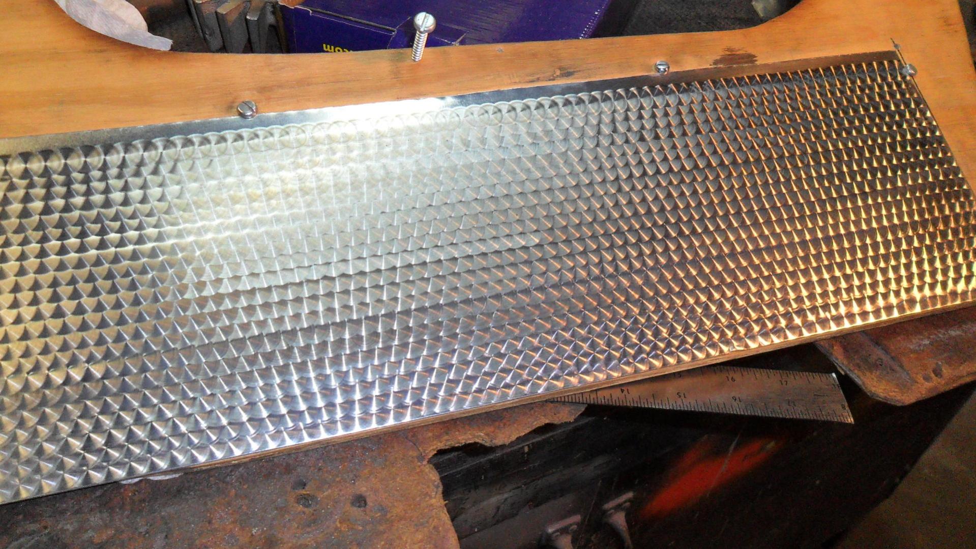

    Okay, it's already about 104 and 75% humidity in my shop today, so I'm going to cut it short a bit as a workday. I have a couple of tiny updates for ya. First, after starting Miss Judy on engine turning our dash insert, she decided that being a hot rod builder's assistant is for the birds, and flew away to Hong Kong! Well, partially at least. She did suddenly take off to Hong Kong to deal with some family stuff, so I finished out the basic panel. I did about three rows a morning for the last few days before I started working, then a couple more after. I'll make the template and cut it all up in the next week or so, so for right now my turns are protected with scotch blue tape and it's sitting on my coffee table in the front room. If you do see us at any event this fall, I guaranty she will tell you she made it, so just play along...

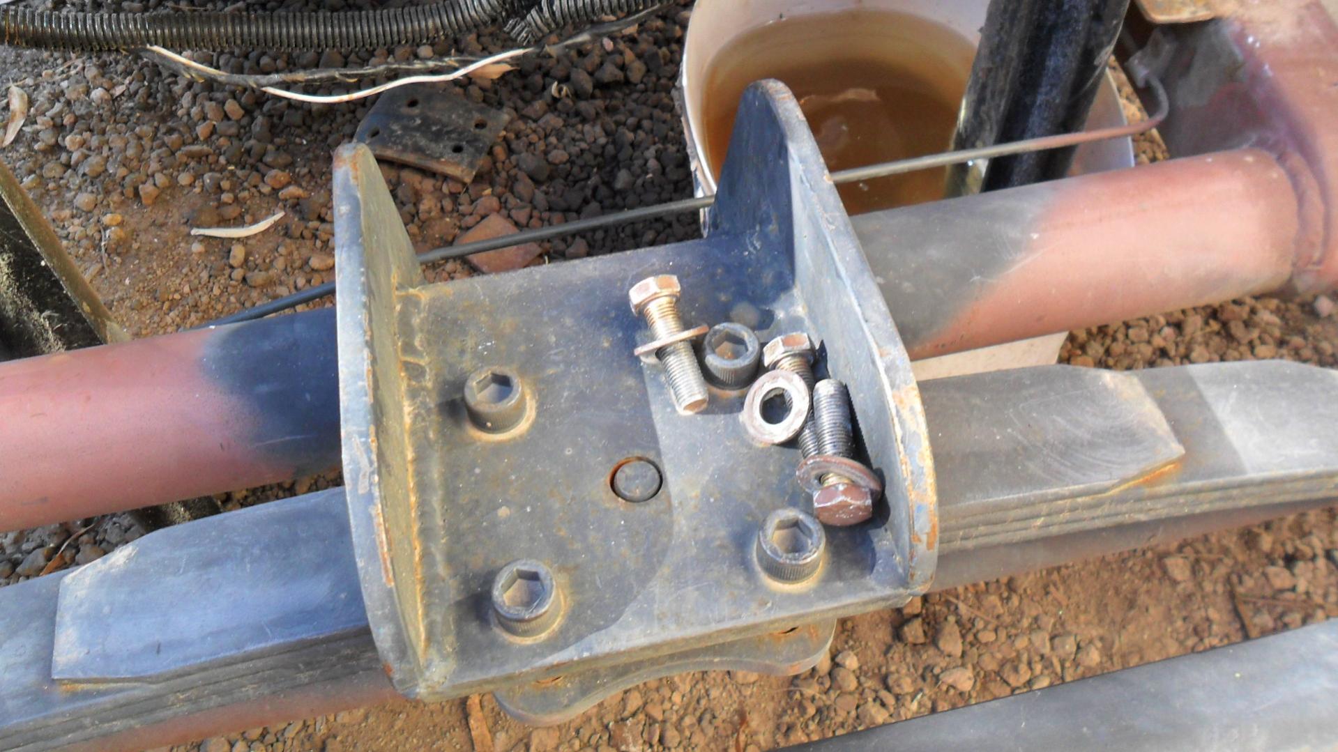

    I also made something quickly this morning to fix something that drives me nuts with these cars. See, when I build a chassis with a suicide perch, I usually build it so it is under hand and use a simple pair of U-Bolts to attach the spring. It's clean and it lowers the car a bit. I didn't build this frame! I noticed it must have made Tommy Ivo nuts too to have all that ugly uncovered, 'cause his car has an overhand perch with a cover too! Since I have a louver press, I added a couple to the mix just because. After really looking at this, I'm not sure that I won't make another with my wider 3 1/2" louver instead of the 2 1/2". Like I said, I'm just nibbling at smaller things that I would put off once the weather cools enough to be driving this thing...
    If any body would care to see it, I shot two tons of pictures on making this cover from a left over chunk of aluminum. I would be happy to do a quick tech piece on it that would cover basic aluminum types, correct use of shears, bending aluminum and louvering. Matter of fact, shooting the pictures took longer than making the cover! If it's something that you would like to see, let me know...

    Damn good point! That perch cover I made today AND the dash insert that we've turned over the last week were just scraps I had left over from a couple of different projects. I don't throw anything away, and my little shop shows that unfortunately.

    I believe many HAMBers would benefit by a thread on engine turned aluminum, me included.
    The louvered spring cover you made is excellent, just a small simple detail to give it a finished look.

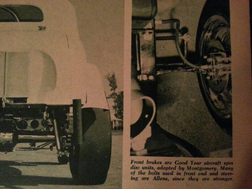

    Ohio George used allen head bolts on his 33 Willys. Here's a picture and its mentioned twice in the article. March 65 car craft. I'd say they meet the 1965 rule because I'm sure it ran that way long before the feature.
