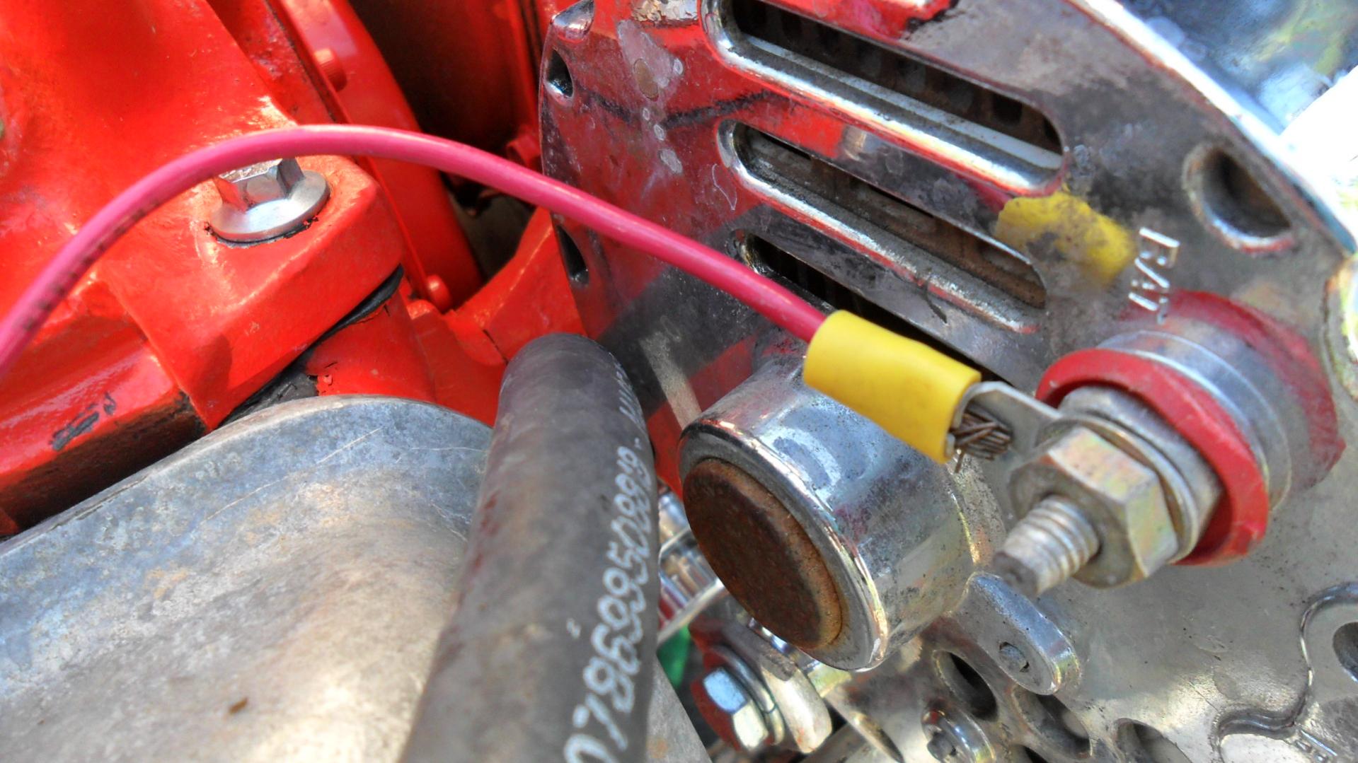

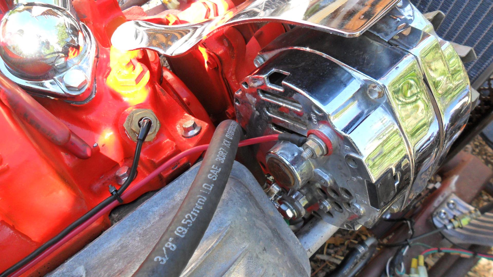

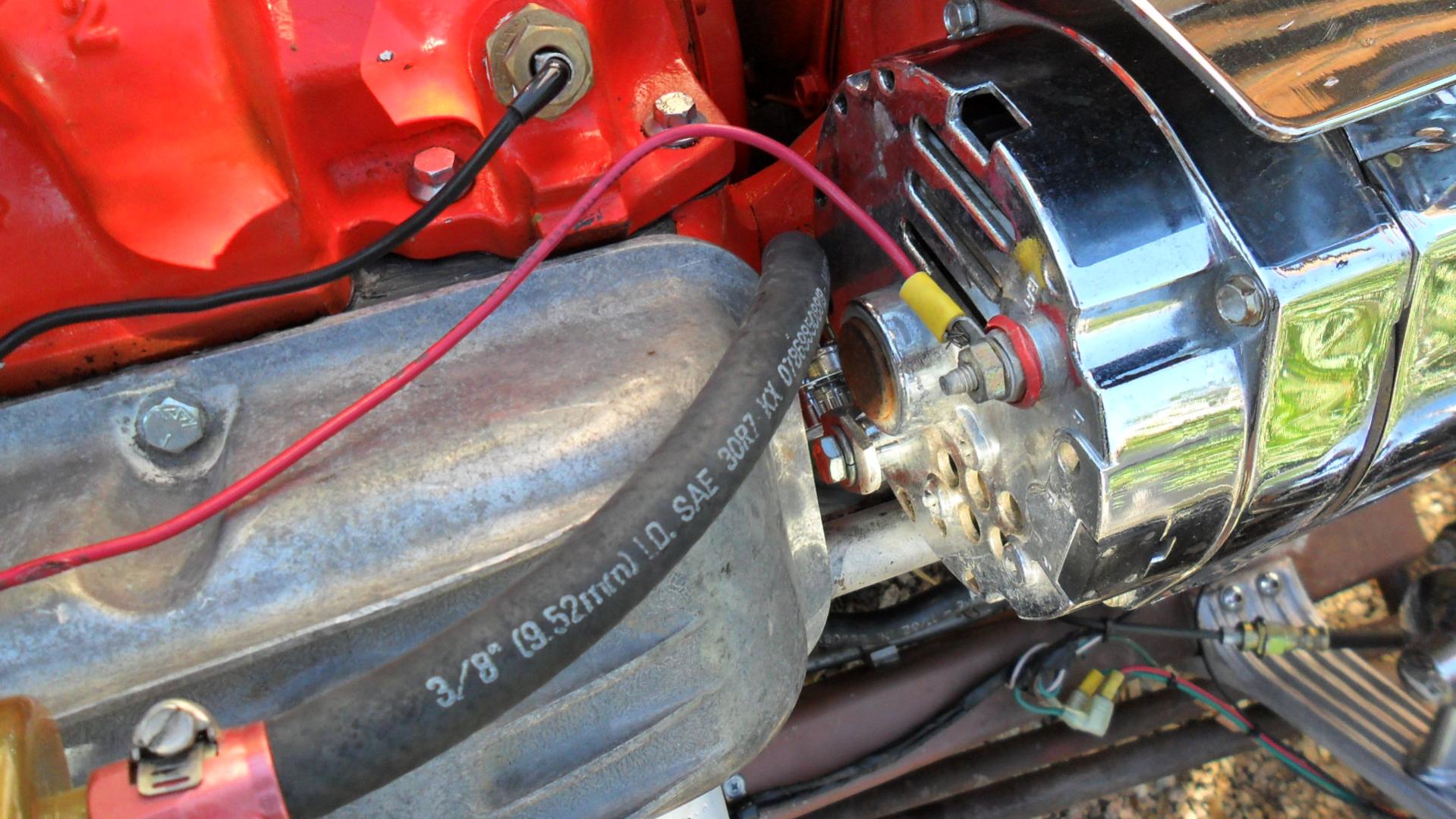

    Okay, so some minor updates for ya! I mentioned the starter woes the other day, and the wiring repairs. Suffice to say, I now have a full 12volts to my starter switch and life is better. It will be smashingly perfect one I build a one piece battery cable to hook everything together.
    I didn't really take to many pictures of the wiring 'cause, well, it's wiring. It's kinda boring. But I did snap a picture of the main power wire coming off the back of the alternator. in the first shot we see a chunk of roughly 18 ga. household solid core wire with a 10ga. crimp on end with a crimp performed with a side cutters.... Wonder why it wasn't charging so well? The second pict shows my new 10ga. wire going directly to the starter poll with a 10ga. loop stripped of it's ugly assed yellow end and properly crimped with a double shrink wrap seal. The whole charging starting system is now done this way, with lighting and tail lighting systems to follow soon. Doing wiring well counts. If anybody would like a quick tutorial on properly crimping and insulating, let me know and I'll write something up.

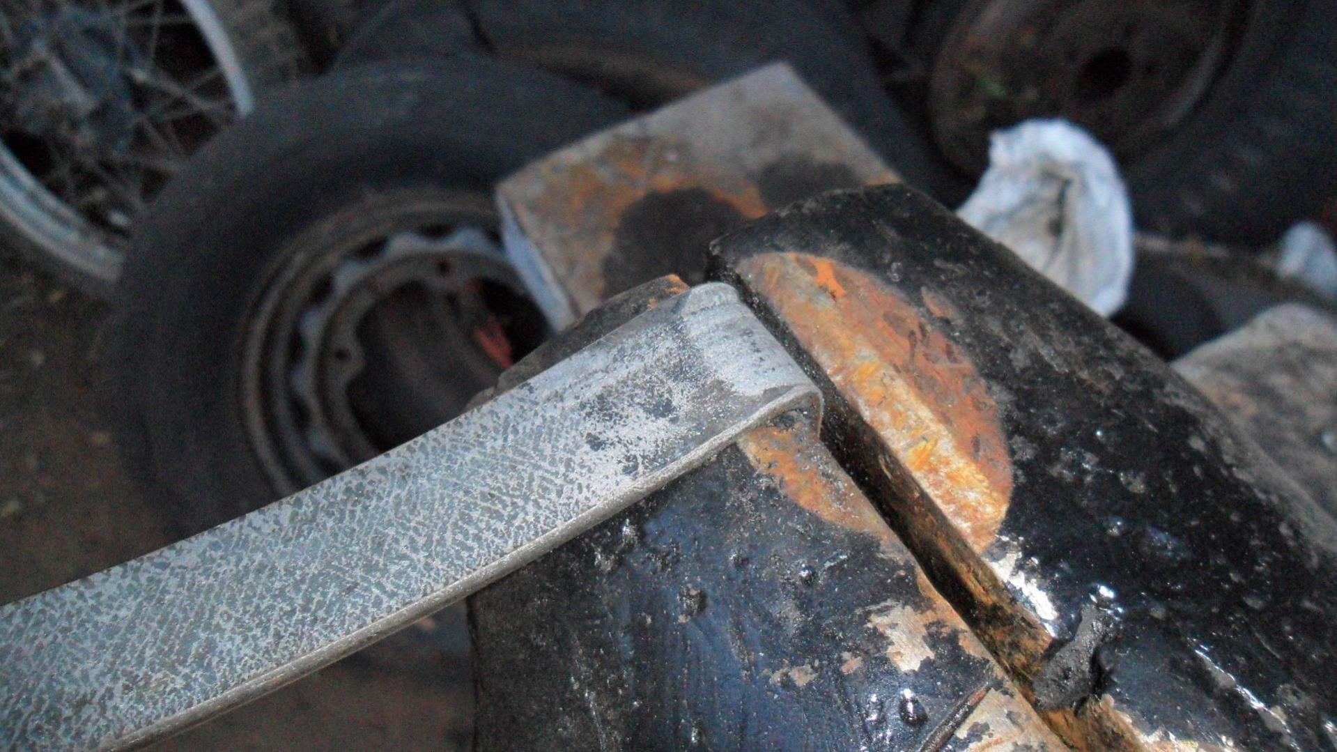

    The next bit is not quite done yet, but Judy asked me how I made them. See, I have a 10" by 31" knock off Moon type tank for this car, that someone had fairly craftily added a pad for a SW type fuel sender into. The only problem is that when I found it at a swap years ago, it didn't have brackets. Up until a couple of years ago, I could just swing by my Alma-Ata, Karl's Custom VW and pick up a pair for basically nothing. Since Karl pulled the plug a couple of years ago, nobody stocks this sort of stuff around town. Boo-Hiss! I could order them from Speedway 25.00, pay 20.00 shipping and wait for them, or hunt the swaps. After asking everybody local, no dice, so make 'em!
    Pretty simple actually. Find something just a bit smaller than the tank to bend around, take my trusty sewing tape and wrap it around the tank to find the circumference I need (31 1/4"), grab some 3/4"x18" hot roll strap and have at it! The first one was made in an anything but elegant manor with lots of swearing, and did not get filmed, thank god. The second one though, I actually used my head and made it tons easier.
    See, my bending fixture is an old VW rear drum that I had laying around from the bad old days. They have a hole in the front surface that you adjust the brakes through. (By the way, it has already been determined that my days in hell will be served in chilly room endlessly adjusting manually adjustable drum brakes while a steady stream of Barbara Streisand and Elton John tunes pollute my workspace... it's comforting to know where you will end up if nothing else!) By clamping the 3/4" stock through the hole, and clamping the drum to the table it got much easier!
    I adjusted the clamp at the last a bit, and got two happy rings of nearly the right size and diameter. The one inch ends were marked off and turned up and out using my vise and Mr. Hammer - It's not just for whacking your thumbs any more! After that, I clamped the turned up ends together, laid them flat on my welding bench and tacked the ends together to make shaping the ends and drilling the holes much easier. cut them apart when I was done... Tomorrow, I'll take the last little scraps of the 3/4"x1/8" and make the feet for this deal, and spot a couple of 5/16" bolts into them so I can drill 4 holes in the floor, drop them through and put four bolts on the underside.

  29. Like your drum bending jig; goes to show you can build nice parts at home without a shop full of fancy tools.
    Noticed the "pile" down by the headlight stand in the first picture, looks like the brake lines need attention like the wiring does. Funny what some people think is an acceptable way to do stuff.
