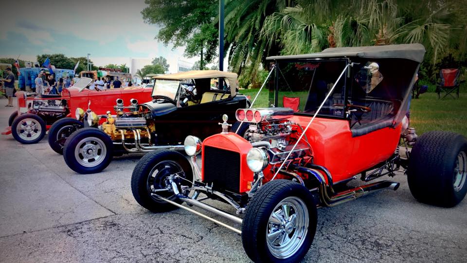

    Yup,fact is that yellowT has Chevy type spindles=arms bolt on ether way,and can be flipped over,making the ackerman right for out front=need longer tie rod is all,but some don't know that.
    I helped a buddy build his red T,he had same type spindles in parts pile with axle for them.
    We faced them too out side front,the rightway for front tie rod. No need to even bend those Chevy type arms,like we do on Ford arms if run out front.
    The photo is Rosh's red T,so arms can be seen. The black "A"bobtail beside it is my hot rod ,I've had from the time I drove it too high school,I'm 77 now.

    If it were me,I kind of always liked the folding "T" 2 part stock windshield,even on the wrong year newer body. But it's not done often,I guess the game of making fit is pass some. Thing is if set up for top 1/2 to flip forward an down flat too lower part,it's the low screen look{cool} and up is great for no bugs in eyes an mouth,yum yum.
    Braces/support are good to use going up too center at fold. Tops are mostly when up ,going to limit your top speed to 55mph in most cases/or rip apart above that. I've see a few that can go higher with lots of bracing etc. I did a tech on making folding tops here as part of HAMB.
    Post # 10801 shows a red 23 "T" Rosh's,one I helped with. It's windshield is a fab'ed frame with braces,over 55 is risky for top. Taking top an screen off with braces too,an adding back lower screen for bugs in teeth can be done,on sunny days.

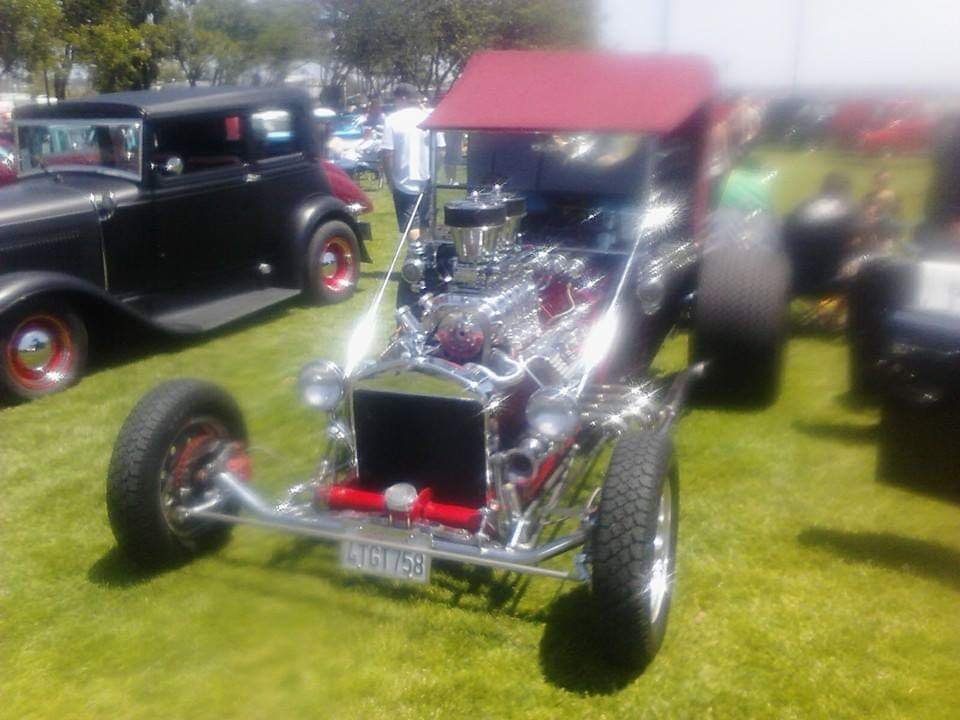

  18. Sorry for the bad pic quality. A mate built this in the mid 80's and if you look close you can see it has a high windshield. It has stays and was good for 150 mph, i know as i was in it and no issue with any mounting points. JW

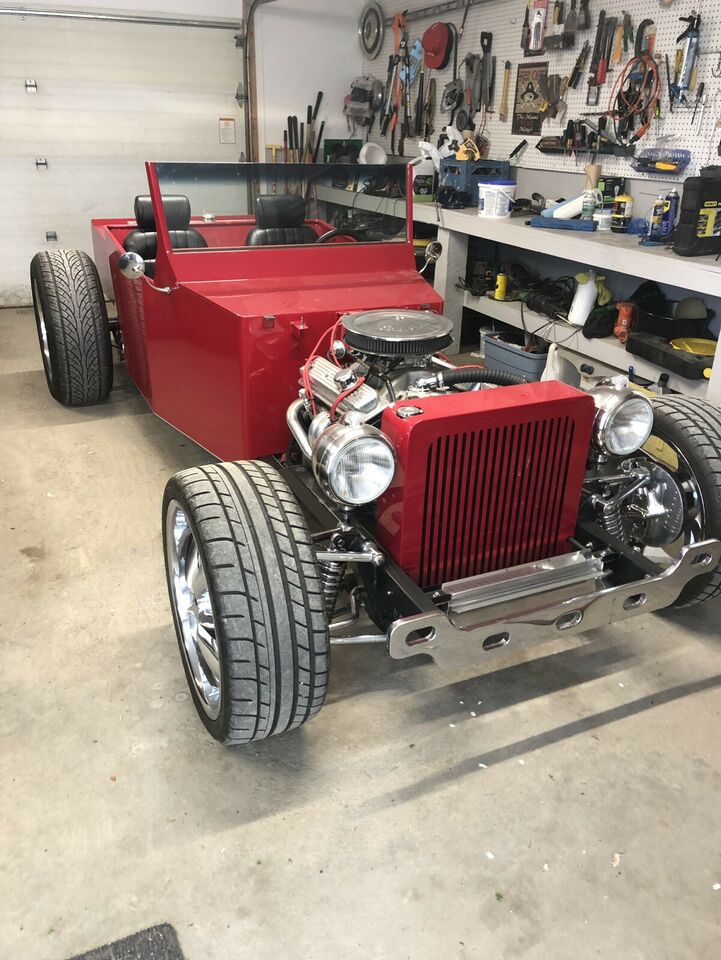

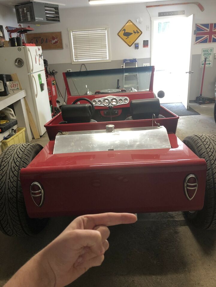

    verde742
    What an effort..... obviously has talent...
    I look at it with the same distaste as those things called the "beast"
    Probably havin' a ball,
    what do you do for insurance ?
    dana barlow likes this.
  27. Blue One
    Joined: Feb 6, 2010
    Posts: 11,459
    Blue One
    from Alberta
    Yes maybe so but talent at what ? And not much of an eye for style or design :D

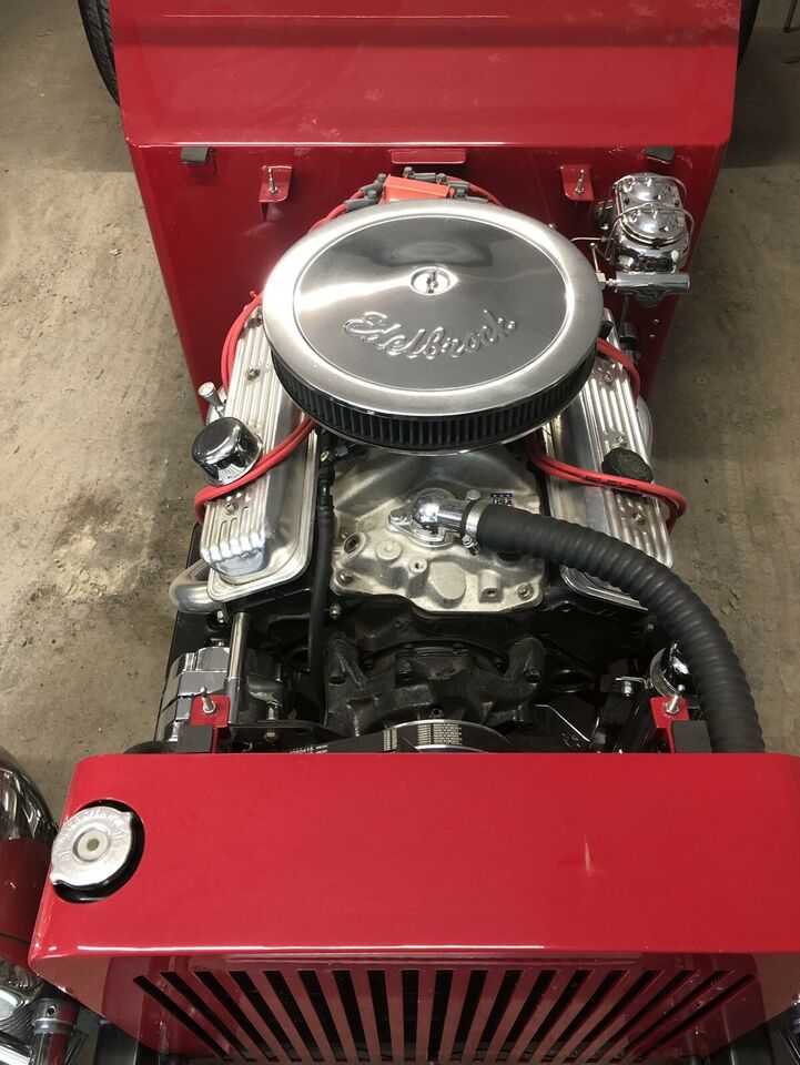

  29. Bandit Billy
    Joined: Sep 16, 2014
    Posts: 12,287
    Bandit Billy
    Just to be on the same page, we are all laughing at the SBC, right?
  30. Blue One
    Joined: Feb 6, 2010
    Posts: 11,459
    Blue One
    from Alberta
    That and the boxy home made body :D
