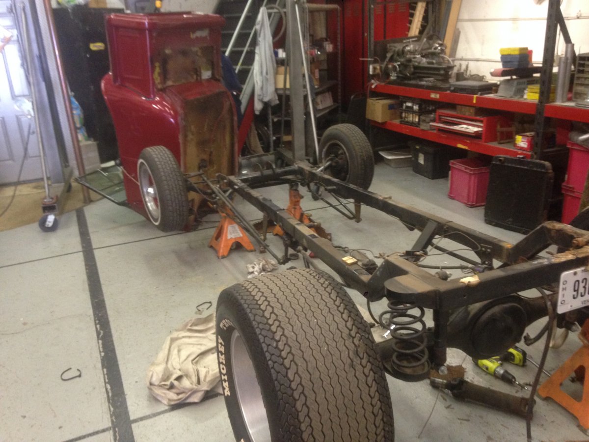

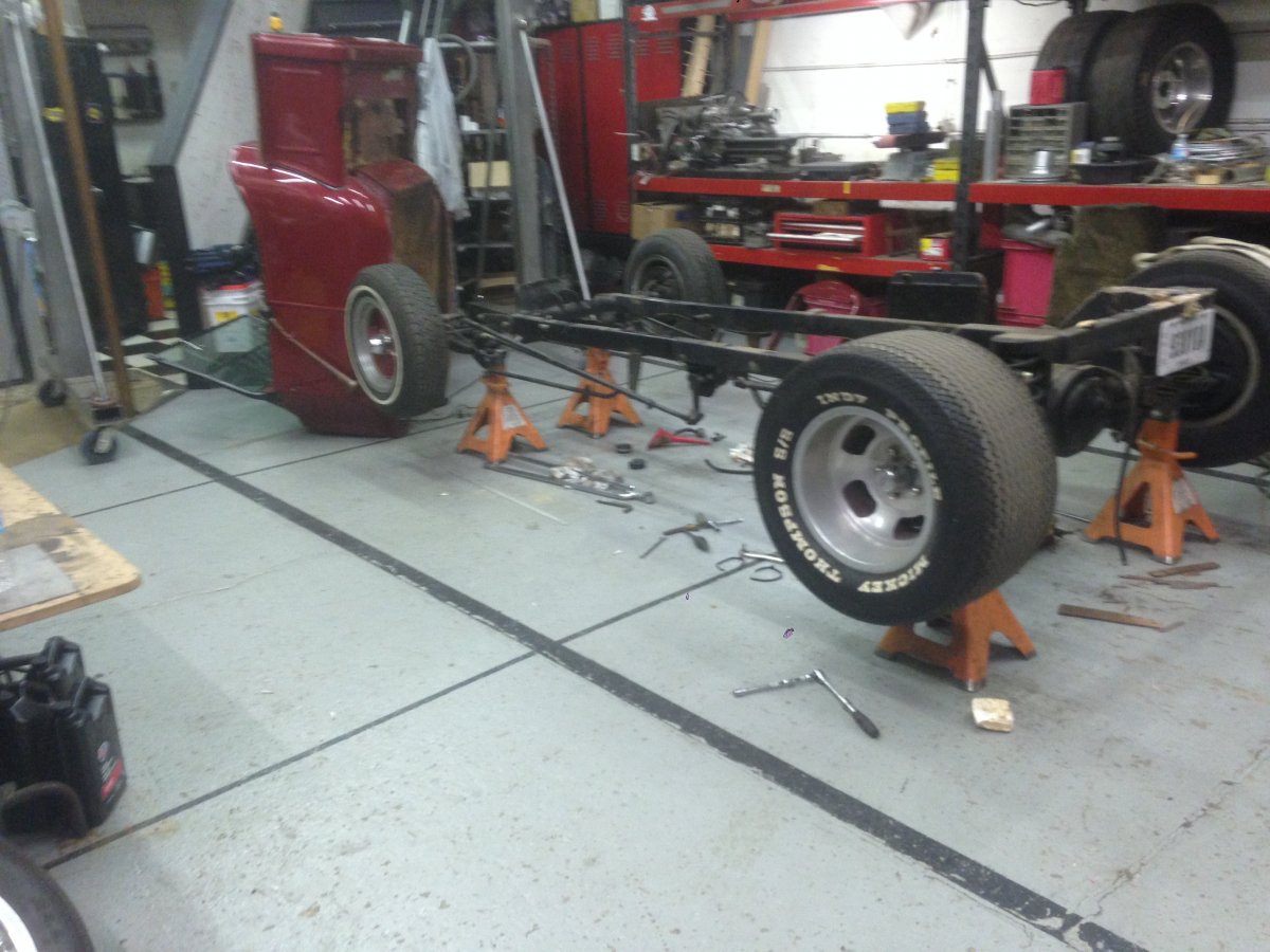

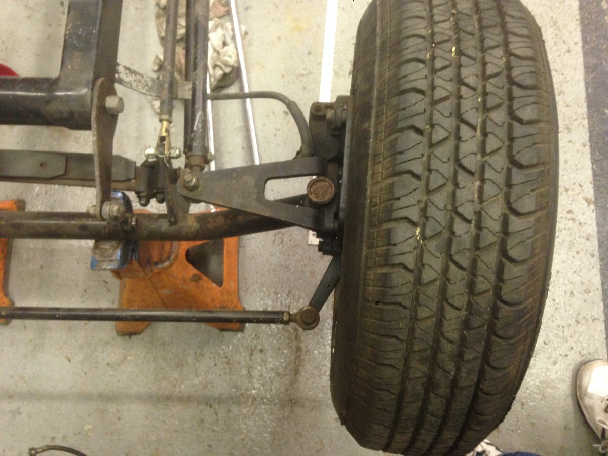

  5. Yeah!!! Here's a t bucket !
    Getting ready to knock a whole bunch of ugly off of this one.
    It will not follow the tires thru a turn.
    Pitman arm is about 3" off the ground.
    Steering column is a joke.
    loudbang and AndersF like this.

    Wow! You got a good foundation, but man! That front suspension needs some serious undoing.

    And the Ackerman angle is the reason it won't corner.

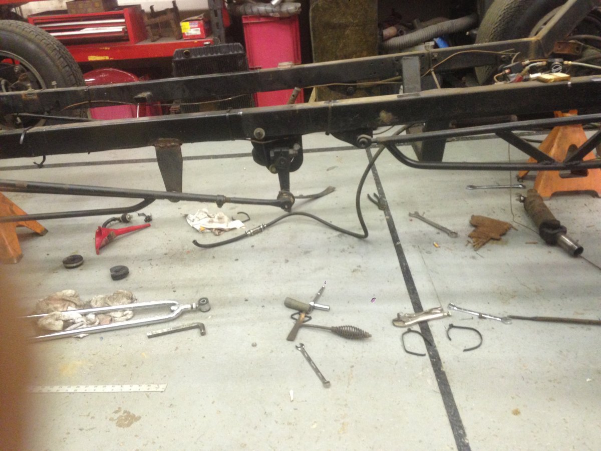

    I'm going to be ordering my rear end set up very soon. I have a question for you guys. 36" or 40" total. That measurement is inclusive of the rear bracket and the rod ends. From your thoughts and experience, which would work best? The 2"x4" is the location of the transmission cross member.

    Fred, with a 100" wheelbase, the front heim of my 36" radius rods are roughly in line with my transmission crossmember. With an stretched body, you could get away with the 40" ones. Really, I don't think there is any downside.
