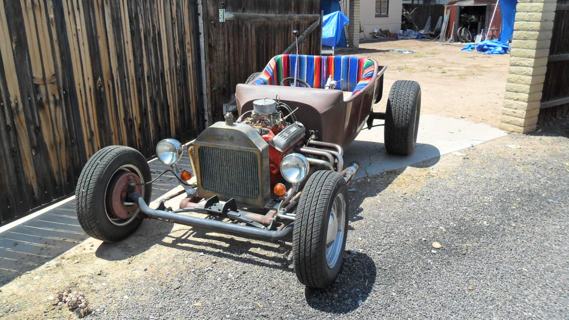

    That's it for tonight. For now feast your eyes on the starting point for the "Bucket of Ugly"... Drove it home like this two weeks ago tonight.

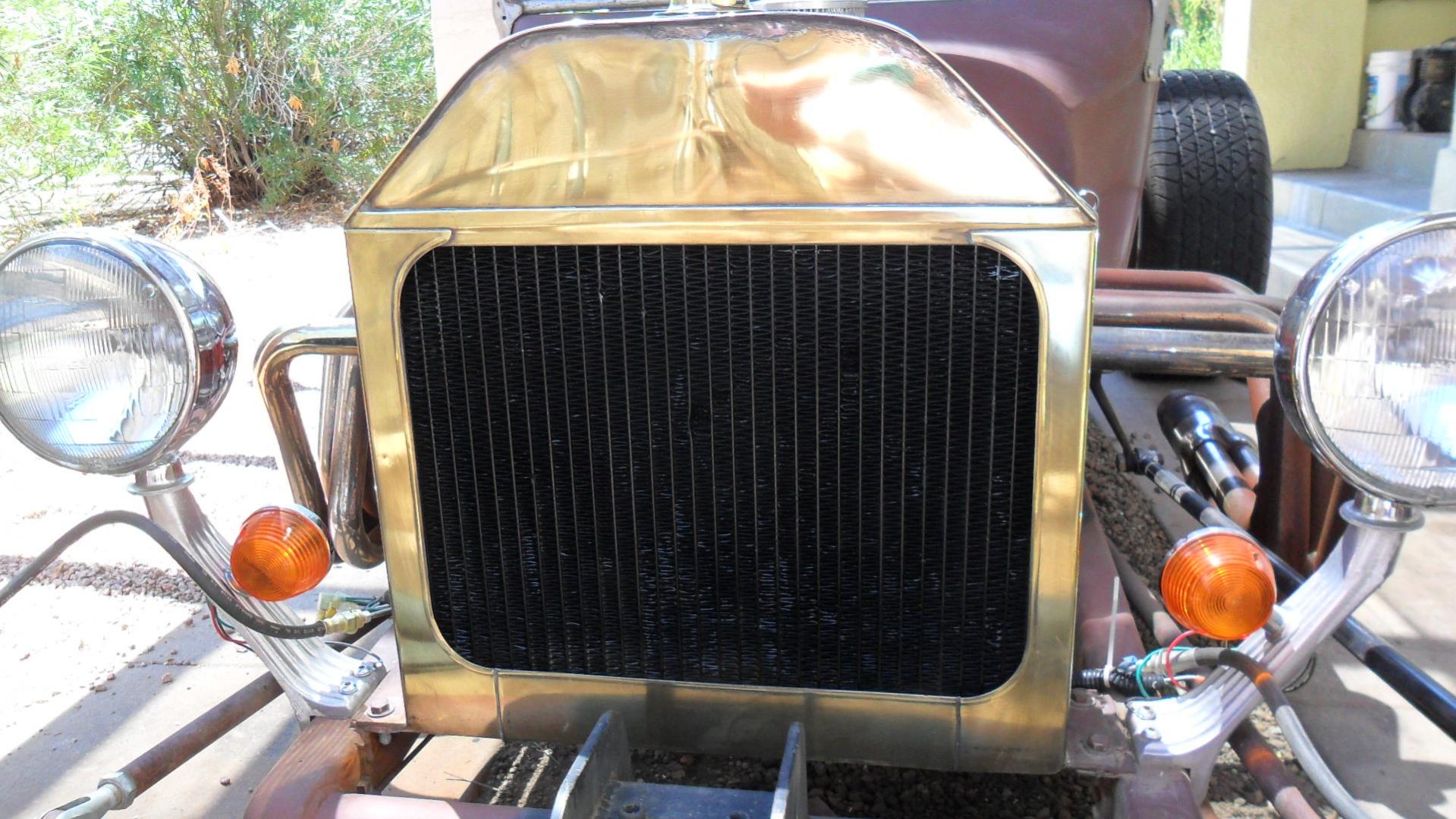

    Oh, kinda forgot, That brass radiator is on it's way out right now as we speak! It'll get replaced by "T" shell or a sizable chunk of deuce shell and a dimple died aluminum insert...

    I've looked the pictures over pretty carefully, and the car has some good bones already. It seems pretty well built with standard t bucket components. Certainly a better start than most we see. Is that shifter going bye bye ?
    Your changes are pretty much in line with what I would do too. Have fun. :)

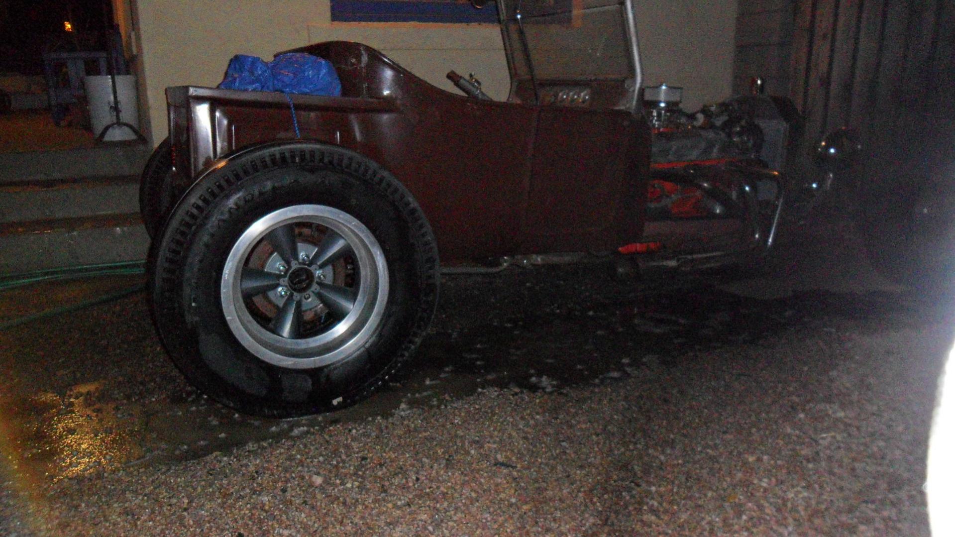

    Hell those wheels make a difference already, keep going...

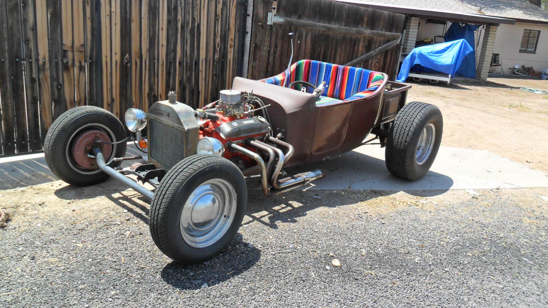

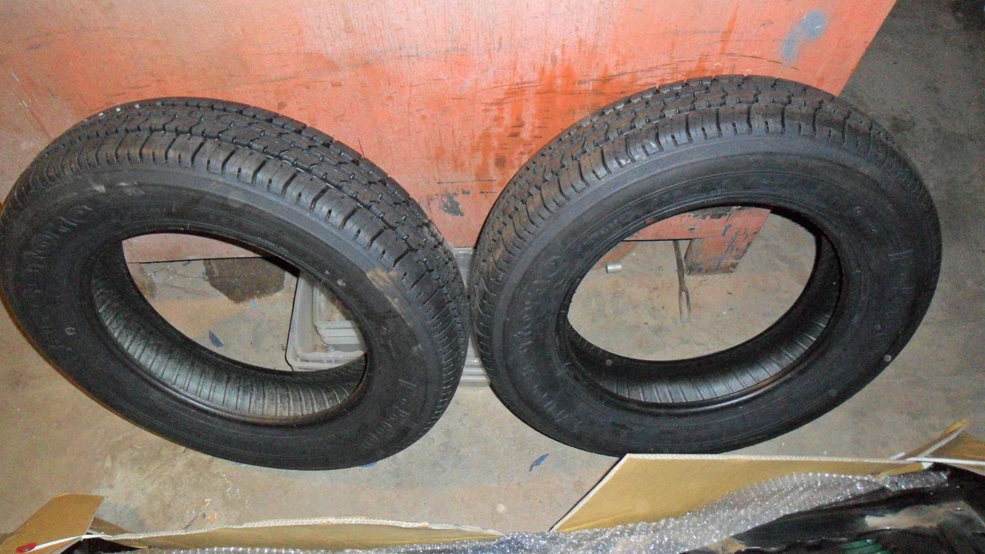

    Got the fronts too! I'm going to disappoint some of my harder core traditionalist friends on this one though... I stuck with radials. I went with 155X15s, as plain as I could find these days. They do mimic a phenomenon common on early sixties buckets, that was a 5.60X15 on a 6" American. they kinda "lofted" a bit, the 155s will do the same, and fill in visually pretty well. My Hurst cheaters are radials, and I DON'T mix on my cars ever since the two complete ground loops in rush hour traffic on mismatched bias/radials about 30 years ago... I really do want her to drive this a bit.

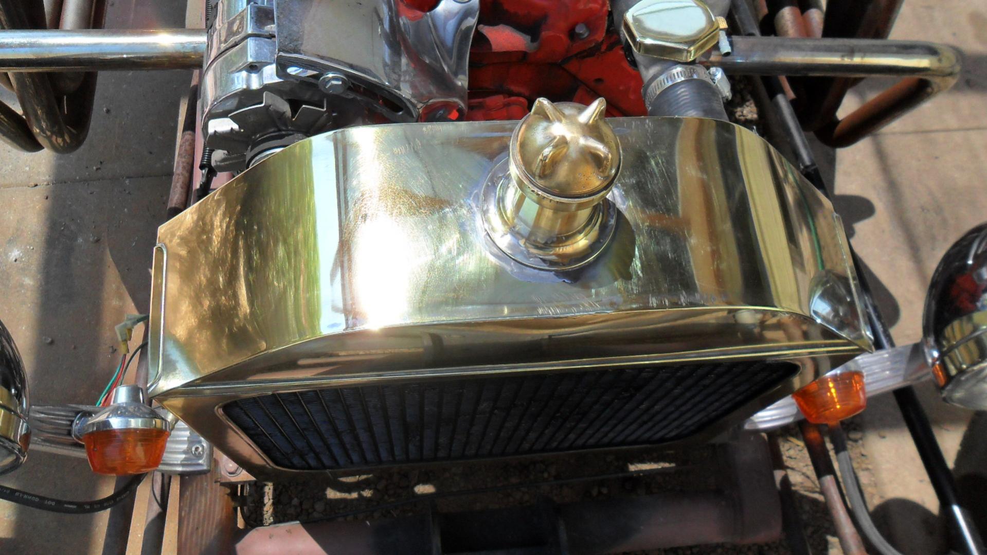

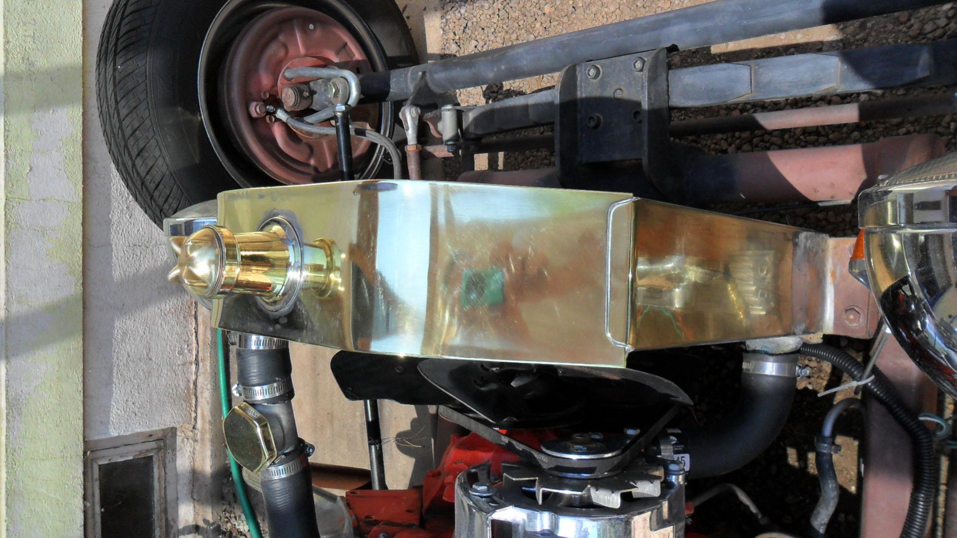

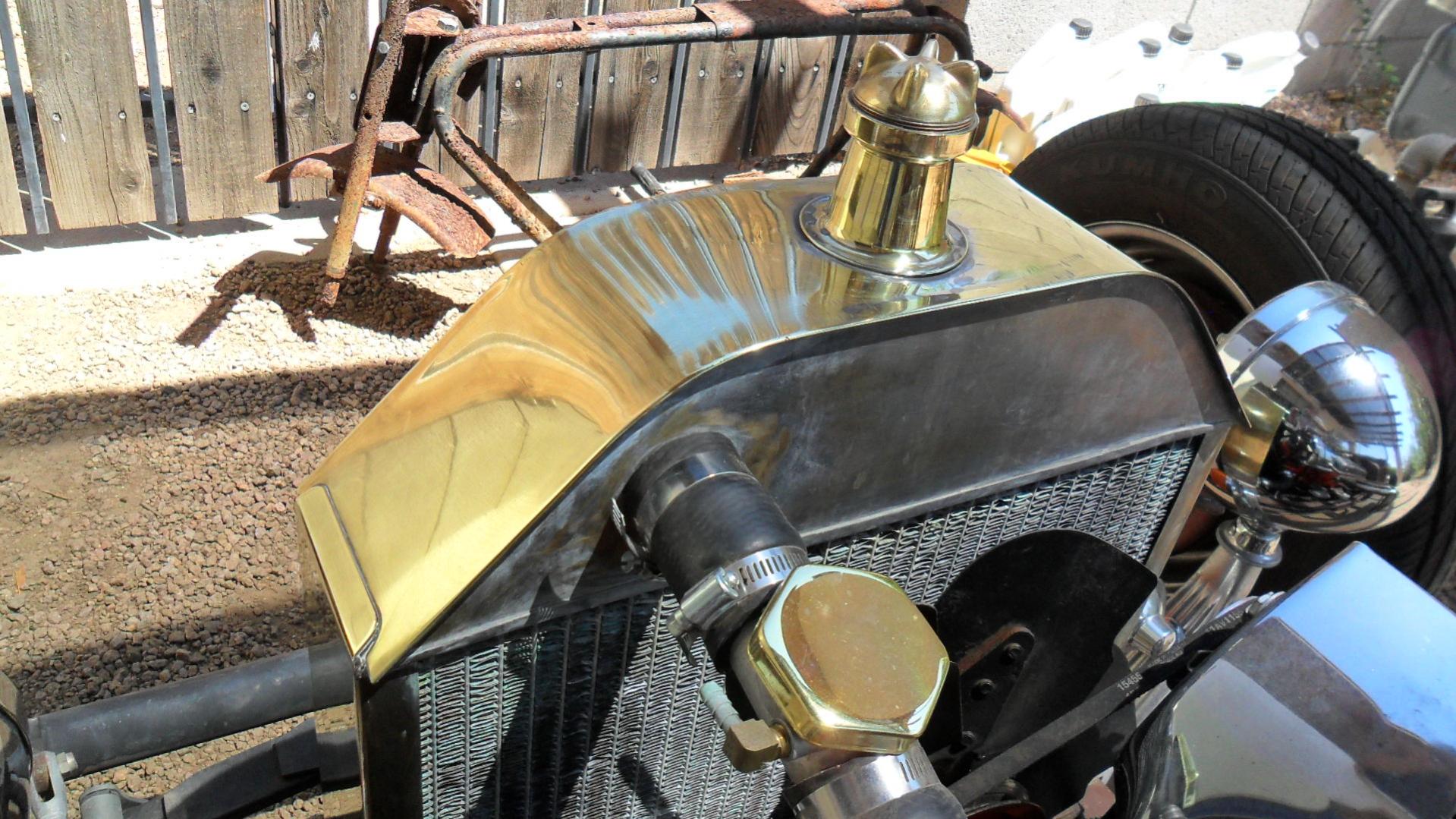

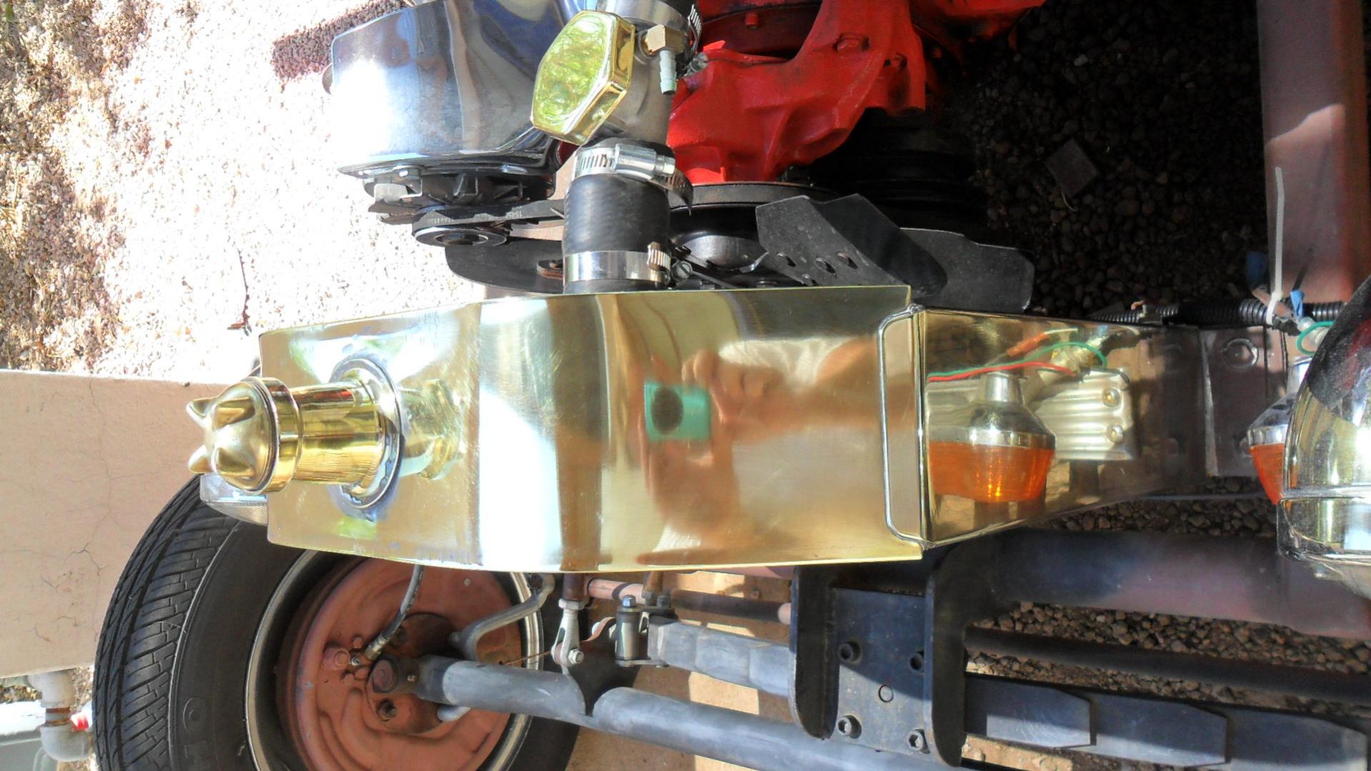

    Part of the deal on this will be using what you've got, to get what you want. This car came with a fairly nice older brass radiator. Now, I do like these, as I am sort of a geek for Dan Woods stuff and I grew up in the seventies when they were prevalent. But, since I'm drawing the fuzzy line in the sand on this one at about '64, it won't fly. I have a few stock Model "T" shells hanging in the shop at this moment, and one might make it to this car. My other thought is a chunk of deuce shell, with a plain dimple died aluminum insert. We'll see what I can scrounge.

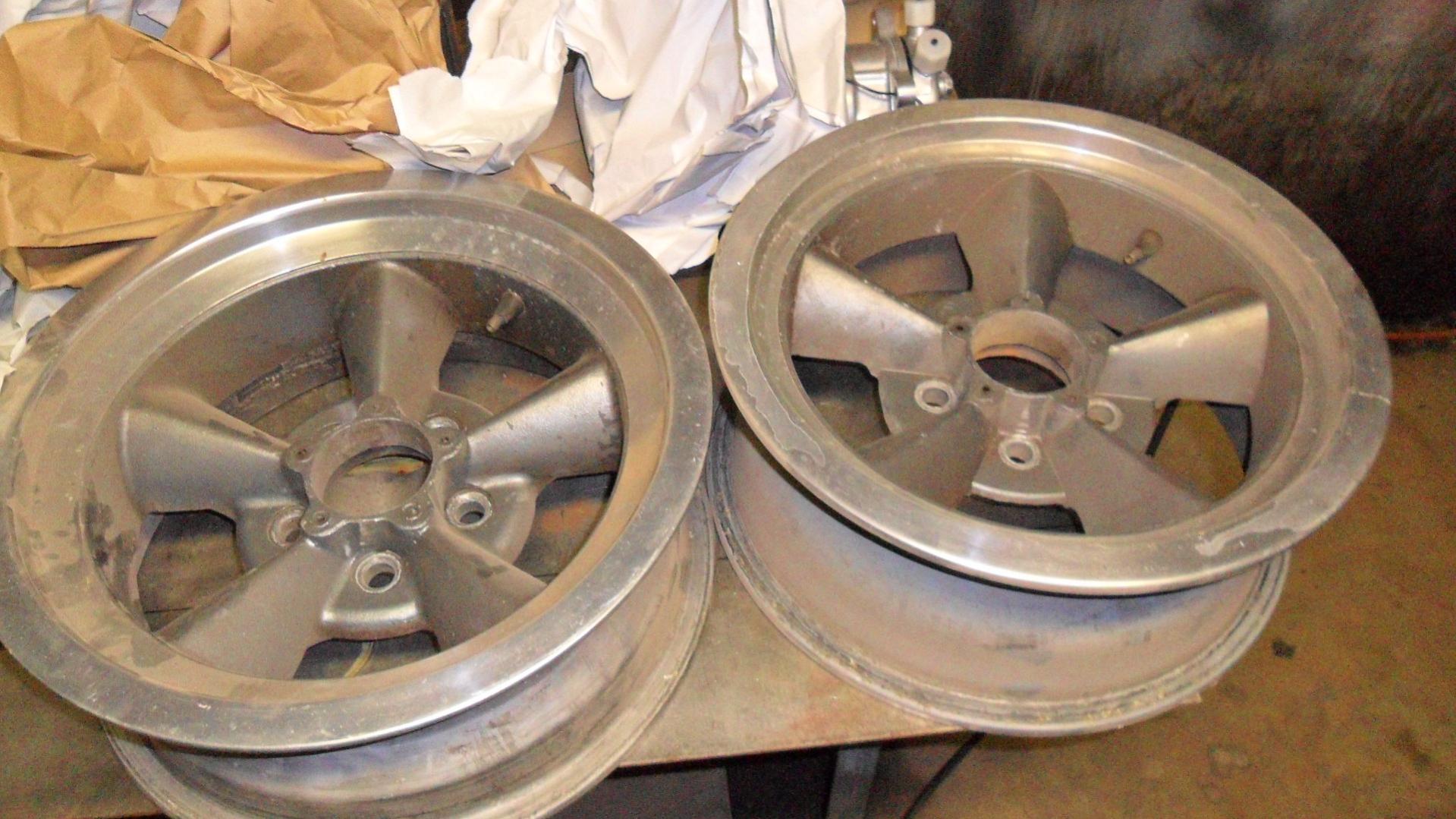

    The other morning was cool and rainy, which is a real rarity in Phoenix in August! So, I grabbed a couple of different grades of sand paper, a block and a couple of types of mag wheel polish and set about putting what I had into photographable condition. A couple hours later, I had this! It's on that auction sight as we speak, with an opening bid that is over double what a replacement aluminum radiator will cost, with about 75 views on it at this point.
    My point with this isn't "woo-hoo, look, Chip's making money", it's if your car has something on it that you don't like and won't use, take some time and make that item the best it can be and sell it to afford what you really want! Also, DON'T use something that doesn't fit your ideal "just because you have it". It's easy to find the right stuff if you look, then it becomes a matter of how to afford it. If I had put this up looking grotty and tarnished, it wouldn't draw half the attention it has. Look at the first photos of the car I posted and you would have never seen that this was out there on the front. It's all about making the most of your resources... Oh, and for the record, when Judy saw it all shined up, she wanted it to stay!!! Nope...

    Oh, another thing, Go back and look at the front three quarters view of the car that I posted in the original post. See how high that radiator sits? That right there is the biggest "why does my T-Bucket look awkward" mistake on the planet! yet another reason why it' will be replaced in the very near future. We'll get it right this time!

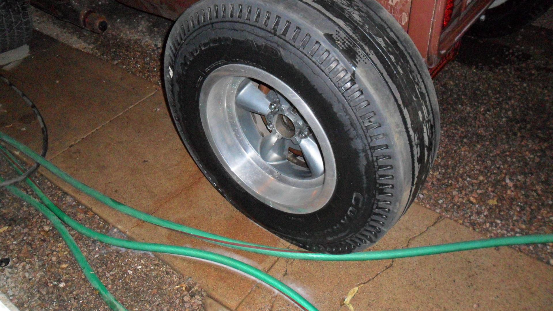

    Steel wheels? If we were talking '56-'59 or so, then steel would be more appropriate. But in about '60, Bill Roland bought Tommy Ivo's car and redid it with cobalt blue paint and Halibrands, and it seems every featured bucket from that point on had mags of some sort until about '65 or so, when we started to see Cragar S/Ss and the first of the motorcycle front wheels on these cars.

    The wheels made a HUGE difference! Now, you've got to pull it out into the drive way and keep walking around it from different vantage points and figure out what stays and what goes. I would recommend staying with a T grille instead of a Deuce shell, using the big, original T headlights, and keeping the car's stance a bit on the "low" side. I'm thinking that the Tommy Ivo bucket from back in the day would be a great point of reference, but just updated a few years in the future with Torq-Thrusts and other subtle goodies. Take up the offer from your buddy and paint it! A nice Oriental Blue with white over black Tommy the Greek striping and a tasteful white tuck and roll interior........

    This is going to be great. When I get my car legs back one of my plans is to de-ugly an unloved T. Those radial fronts appear pretty similar in pattern to the Pirelli radials lots of rods/drag cars ran back then, they'll look awesome.

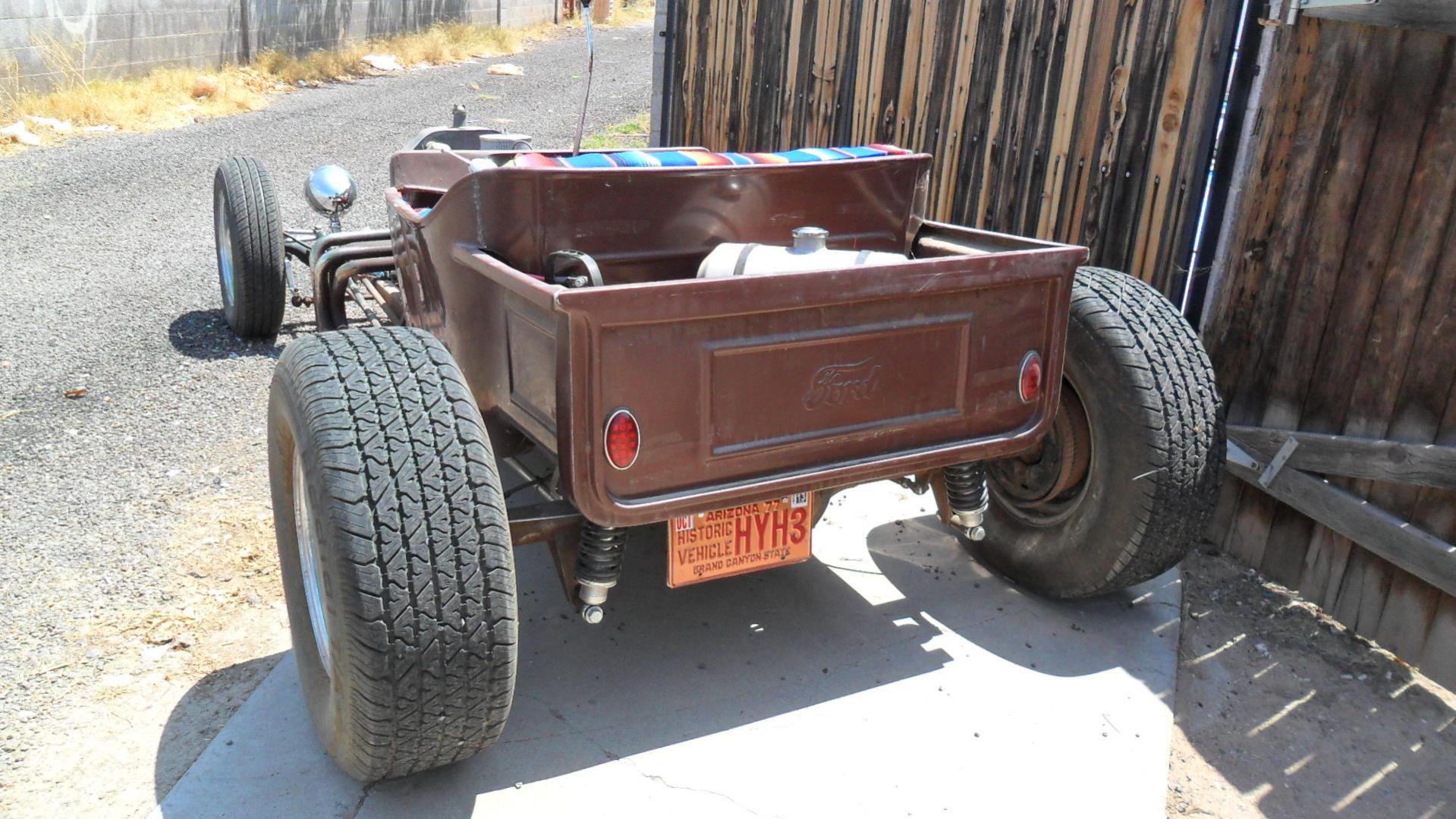

    My biggest gripe with T-buckets is the general ergonomics of the things. Steering wheel too vertical, awkward pedals, poor seats....While you can drive them, its not exactly a comfortable long distance touring car for anyone over 5'6". I've seen some 27's that were better in that regard, though still cramped.
