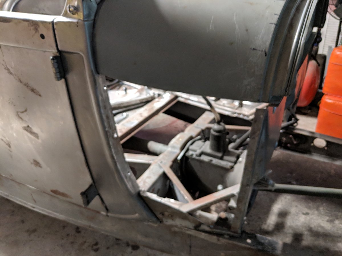

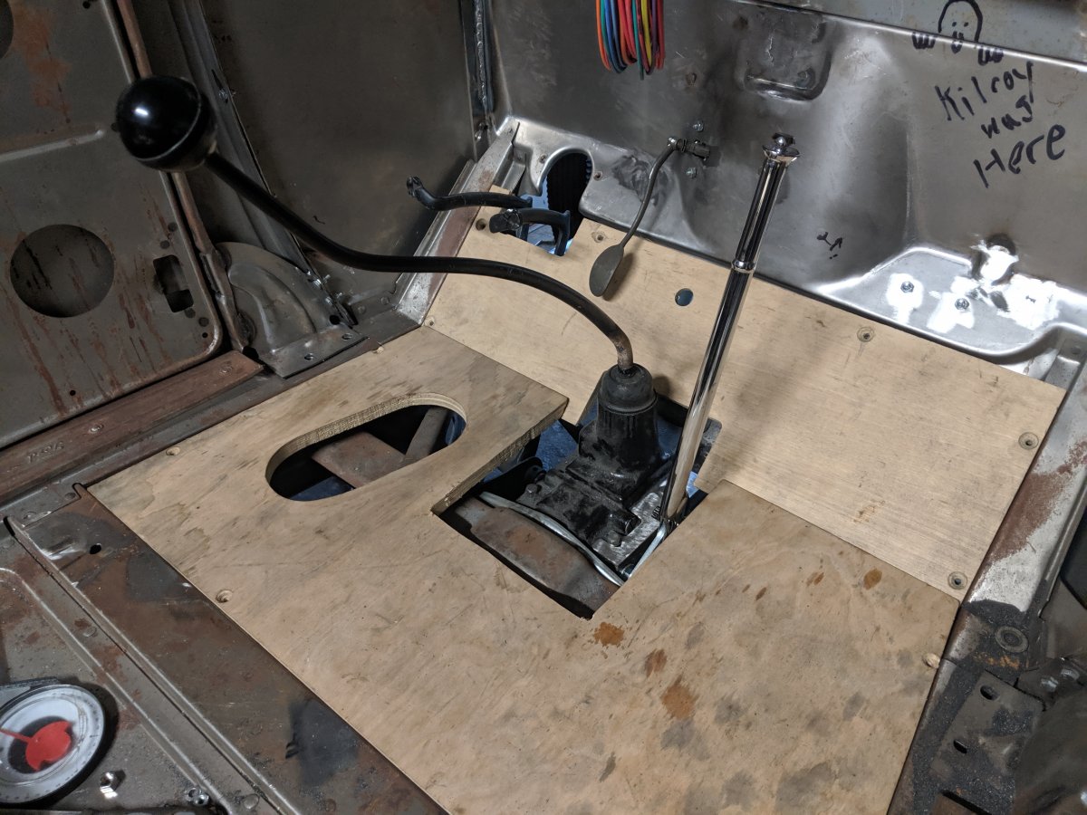

    Reinforcing the subrails where I had to cut them to lower the seat. I used 16 gauge sheet metal and 1x2 inch tubing.

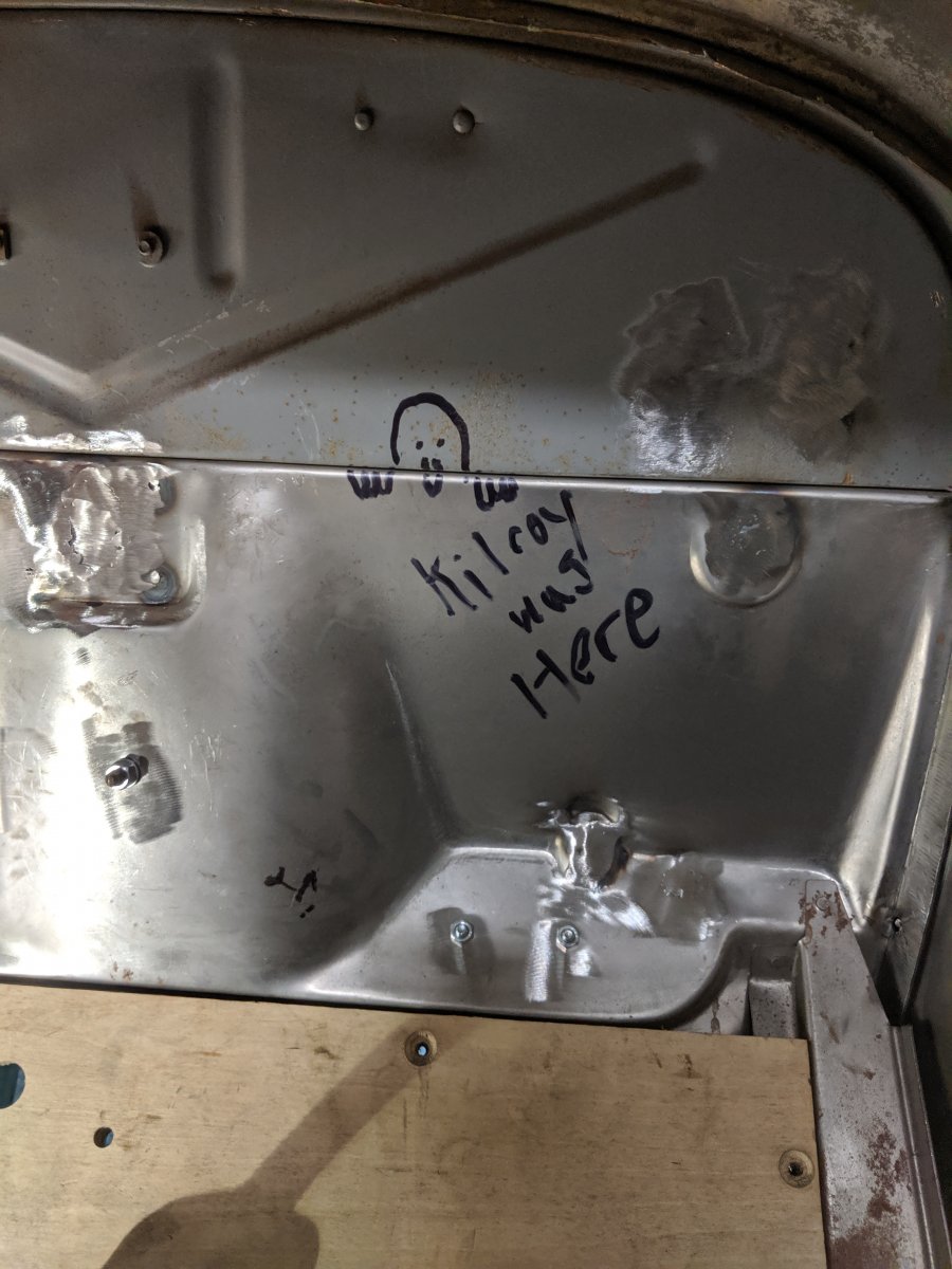

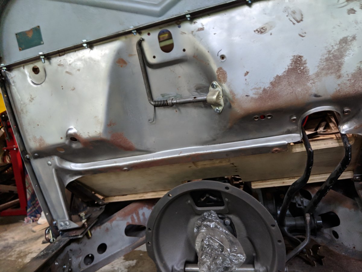

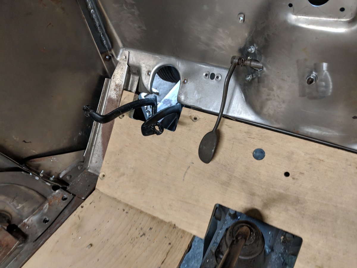

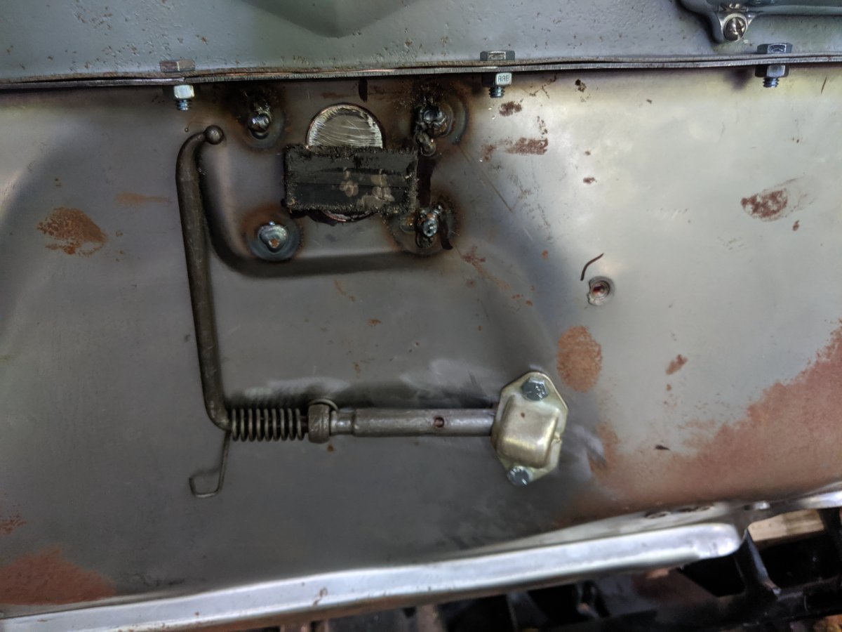

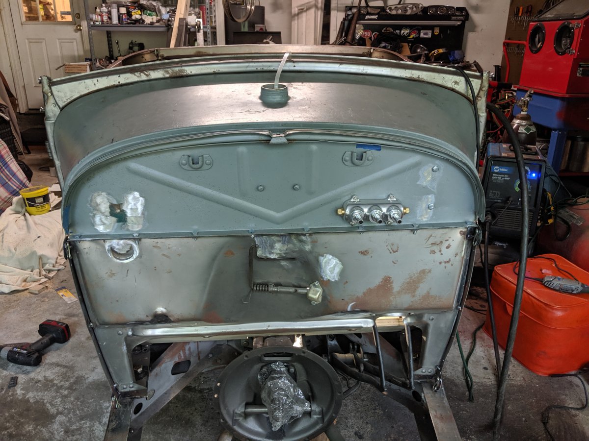

    Still plugging away at getting the metal work done. Spent a good bit of time getting the front cowl squared away. None of the holes on the original tank lined up with the Brookville body so I ended up redoing them all.
    IMG_20190414_130511.jpg IMG_20190414_132516.jpg IMG_20190414_141717.jpg IMG_20190414_141750.jpg IMG_20190414_141724.jpg IMG_20190414_145849.jpg
    Still not done but getting closer.
    Thanks,
    --louis

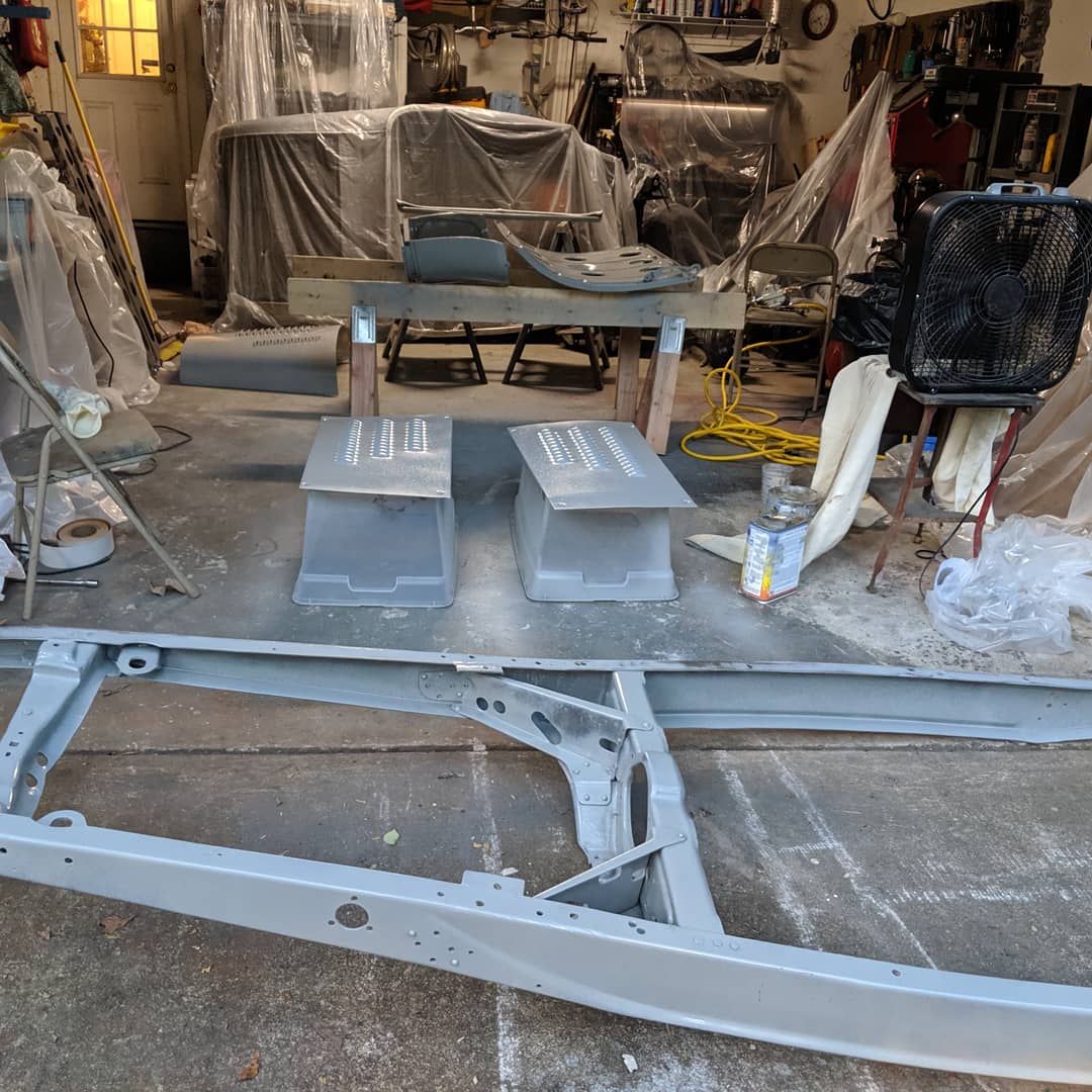

    Not a whole lot of progress on the roadster this past month. Had family visiting for the past month which took up most of my free time. Mainly been tending to small things. Looks like we might have some progress on the motor here soon though.
    Few pics of random stuff done.
    42433CA3-77AF-461A-8850-CF3177D810E7.jpeg F1638C96-CAC2-4437-AD9E-946B3E06FA8D.jpeg C04DDAAD-1A3C-4886-BD67-0798D20BAC7E.jpeg B2F66926-FAC1-4E02-A2A8-BF948F5CC4A4.jpeg 281AC2EB-48BF-407E-9D7F-241506512599.jpeg B09CF8D3-E227-4622-903E-F67475E63D26.jpeg CEBCE3D6-0CD7-418C-A188-93BBA79D91CE.jpeg
    Hoping to get it in primer in a couple of weeks.
    —louis

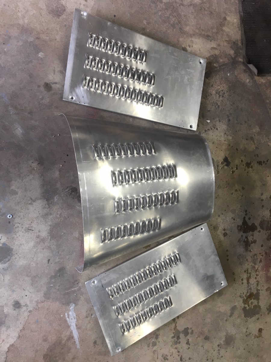

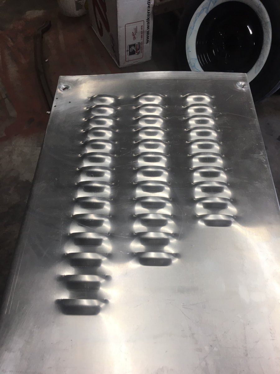

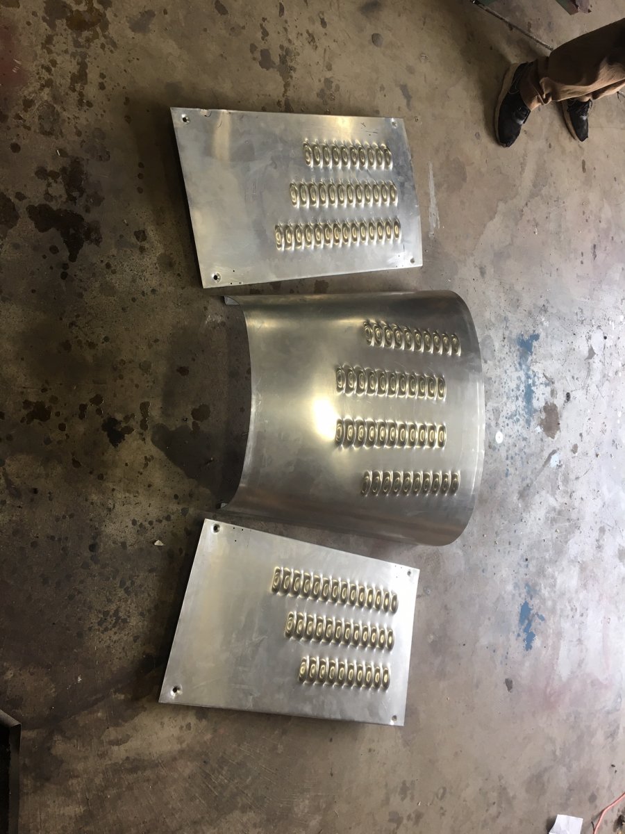

    Just got these pics from @thunderbirdesq at Kholer Kustom of him punching the louvers in my hood and sides. Veddy Cool! The cost was really reasonable too.
    1DDD965D-B6A7-4A82-81FB-905BF249429F.jpeg C3F673DA-232A-41C7-BCEE-42FCF712C4C9.jpeg 56849FC1-9510-4367-9CB7-576C96863832.jpeg C9890418-6692-4027-8CD0-AED77D2C66C2.jpeg
    Thanks,
    —louis

    Two suggestions...from experience building my own '29/'32 using the same seat - see link below.
    One, block your car at ride angle (frame rake) before settling on the seat position. The view changes.
    Two, the front of the seat bottom (lower thigh area) should be noticeably higher than the rear (butt area) for best comfort in a flat-floored car. Looks like yours is pretty much level. I added a 1 1/2" support under the front of the seat brackets to accomplish this.
