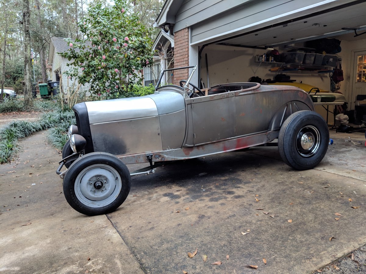

    Finished up the hood and rolled it outside to get a good look. Ugh!
    Grill shell needs to be lowered more. I am thinking about 1.5"- 2".
    --louis
  11. Aaron D.
    Joined: Oct 27, 2015
    Posts: 853
    Aaron D.
    Dang it man!!! I would agree with you though.
    It's coming together nice, you're really moving along at a good pace.
    Aaron
    louisb likes this.
  12. louisb
    Joined: Oct 13, 2008
    Posts: 1,000
    louisb
    Cut two more inches out. Looks much better.
    --louis

    Good thing you caught it now. There are a lot of cars out there with hoods that run uphill. It's a tough thing to get right, but an important part.
    48fordnut, chryslerfan55 and louisb like this.

    I ended up sending the radiator back to have 3" cut out. Here is a mock-up. I will have to remake the hood but why should it be any different than the rest of the car. Now I am trying to decide on a louver pattern.
