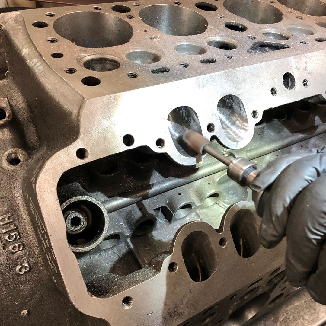

    Tired of seeing flathead engine building pics? Nah, me either. Sometime in the past the 59L block had been mildly ported but Dan wasn't happy with the work and spent some time reporting the block and intake to his satisfaction.
    61996094_154241062301393_5595405058375003939_n.jpg 66294786_1252147041633700_3736583438978782777_n.jpg 66321180_125031338756273_4975113515826692966_n.jpg 66417507_476646129572199_5503684358273409460_n.jpg 66420132_389398098595581_1772956947175901202_n.jpg 66427555_2359127967679046_7057460169413743707_n.jpg 66509207_401450113827007_7244310164606423883_n.jpg 66682412_2317527668334329_5630326653181351310_n.jpg 66690128_650605628772456_694906959412446253_n.jpg 66989836_371015913605032_3287732560154508180_n.jpg
    Thanks,
    --louis
    Stogy, Tim_with_a_T, brEad and 4 others like this.
