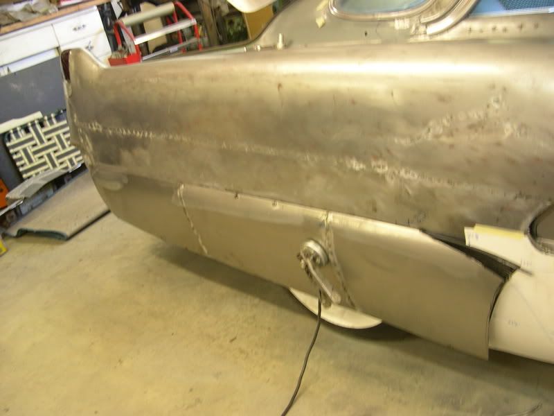

    Saturday morn...decided to work on the passenger's side skirt again...went ahead and made a cardboard template (of the "done" side-the driver's side) with all the measurments on it and cut out so that I can match this skirt to the other (and matching is the hardest part)...
    As you can see, the front of the skirt needs some help...but the round rod I use is dead on to the pattern...a little metal fill here, a little welding there...and it "should" look like the other one...
    More later, I'm working on the Caddy all weekend...
