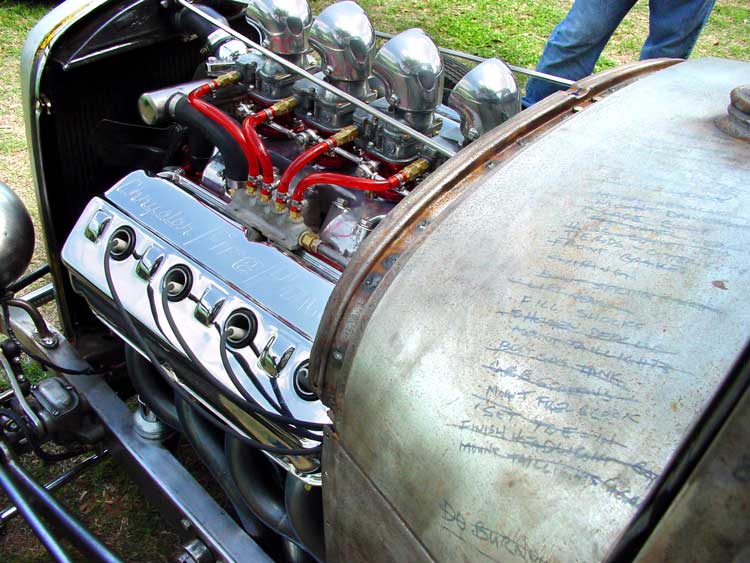

    I hope you guys aren't getting tired of seeing this car yet.
    Anyway, I got the motor back in the chassis last night and rolled the car outside today to snap a few pics. The weight of the motor put the stance closer to where it needed to be. I painted the motor House of Kolor Candy Red over Pagan Gold...it shines pretty good in the sun.
    I started mocking up the '32 header panel above the windshield. I think it's going to end up looking good....but I have a lot of work ahead of me to get it to fit well. I also mounted the headlight stands to the frame and tacked in the cross bar.
    Gonna need some patch panels in the doors and quarters...this body was no prize to begin with. (Yes I know the door handle is upside down on this side...I need to order the right one.)
    I will be making the cowl fit the deuce frame instead of vice versa. Most people think the rails need to be pinched to fit the cowl..I think the cowl need to be spread to fit the deuce frame. :)
    1" Lug nuts are influenced by Bonneville rule requirements.
    I got lucky and a 6 cyl Mustang fan I bought at the last swap meet fit perfectly. Just had to redrill the bolt pattern to fit the Hemi water pump.
    The motor is pretty much all assembled now except for the intake and valley pan. I wanted to leave them loose until I set the valves so I could pour some more assembly lube on the cam before firing the motor. Also need to make a remote thermostat housing and build a generator bracket among other things.
    I think I'll be able to fire it by Friday...wish me luck!
    Thanks for looking...
