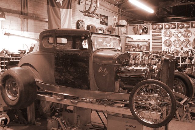

    I've just about finished the rolling chassis for my Model A...I just have a few odds and ends to do here and there before it's totally complete. Of course I have to run the brake and fuel lines still, and it's definitely not going to get painted or plated before the Lonestar Roundup.

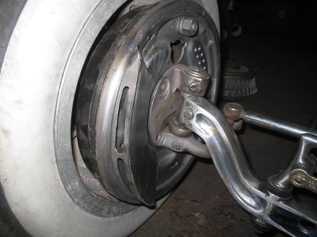

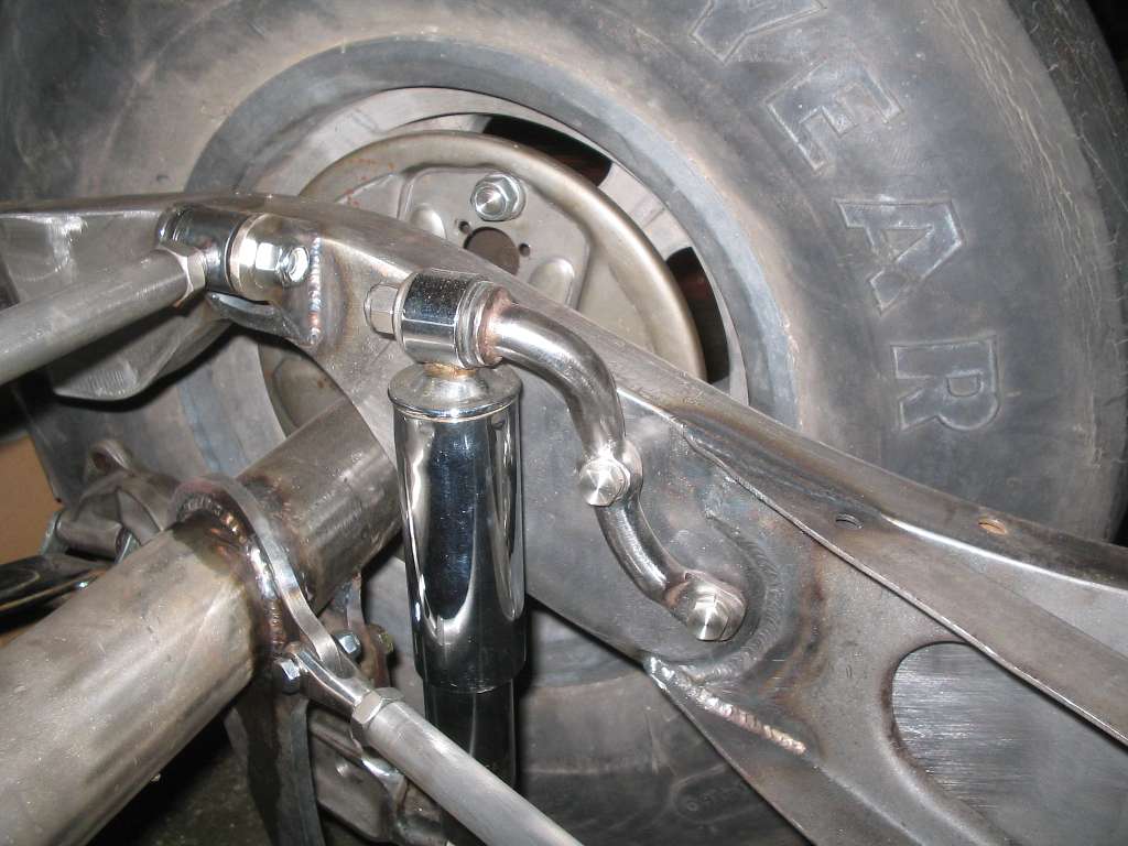

    I'm using 'Delco Lovejoy' knee-action lever shocks in the front. I drilled the arms out, which was a royal pain in the ass. I added 3/4" OD DOM sleeves in the frame to run the shock bolts through, so they should stay put.
    You can also see the Ford F-5 (dump truck) steering box has been mounted in that last pic. I built a box around the steering box out of 3/16" and 1/4" plate while I had it on the welding table, then cut the frame and stuck the box in the hole. I then set up the cowl and figured out how much the steering box would have to be angled off of the frame rail to make the column straight, and put the steering wheel in the right spot. After I had that done, I welded it all up. This leaves a recess in the frame that the steering box sits in, and does not compromise the strength of the rail.
    Another shot of the shocks and the drilled F-2 backing plates with Buick drums.
    I also got the rear shock mounts figured out. I used '40s Dodge truck shock mounts and bent and cut them to mount the top of the tube shock. The bottom goes to a bung that I welded onto the front side of the cut-off '36 wishbones. I still have to box around the weld bung on the wishbone and blend it all together. It should be a really clean installation when finished. (I hope!)
    I made the gussets in the ladder bars like the ones on the 'Rico Squaglia roadster'...America's Most Beautiful Roadster in '51.
    Because I mounted the shocks there, I had to put the panhard bar mount on top of the rearend housing. It seems like it will work just fine...A friend and I jumped up and down on the chassis and it didn't bottom out on the housing.
    I think one of the best things about this chassis is that there are only a few "store-bought" parts on it. The American Stamping '32 rails, shackles, heims, chrome shocks, tires, and misc. hardware are the only things that came off of a shelf. The rest of the stuff was either made by me or scrounged at swap meets and junkyards.
    This should show proof that you don't have to spend a ton of money to have a first-class chassis. With a little know-how and a lot of determination you can do it yourself.

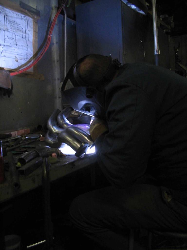

    I posted a few pics the other day of the header I had started building for the passenger side of my Model A Coupe...
    Since then I have pretty much hammered out the other side.
    I just knew it was going to be a real pain in the ass to get the primaries around the dump truck (F-5 truck) steering box, but it actually ended up being a little easier than I expected. Unfortunately, since I am using the side steer box, I had to make the headers different from side to side, but I don't think it's a big deal. Who says hot rods have to be symmetrical in the first place? :)
    I'm still running my "roller" Americans on the front right now, because I haven't gotten my prettied up 16" wheels back yet. I hope the guy shows up with them tomorrow.
    Here's a close-up of the installed driver's side header:
    And here's another look at the passenger side:
    I have to say that building the headers was easily one of the most difficult parts of building this car so far. I've got a little over 3 days worth of work tied up in them, and I'm still not finished. I still plan on adding a merge collector to both sides with a long extension like the early "lakes-style" headers. They should end up looking something like the headers on Ken Gross' roadster (TRJ #14).
    I'm a firm believer in the theory that hot rods should be fast, so I did some research and talked to a few people before I decided to go with 2" primaries, and the 4 into 1 style header. It would have been easier to build a tri-y header on the driver's side, but this motor should respond better to the 4 into 1.
    Looking at the driver's side header off the car and on the ground, it's amazing to me that it actually fits in the space between the steering column and frame.
    The passenger side still needs an extension on a couple of the primaries to match the length of the other side.
    Right now they exit under the car in kind of a staggered formation.
    In the interest of time, I'm probably just going to run the headers like this to the Roundup (if I make it)...after I get back I'll add the collectors and have them chromed.
    This is the first set of headers I've ever built for a car...and I think they came out pretty good so far. Thanks again to Joe Martin of the Martin Brothers for the 2" mandrel bends...and thanks also to the distinguished Jimmy White for the nice 3/8" flanges.

    Here is a couple of pics I took with Bass in action on his headers, along with a few others pics of the build up. Watching the build of this car on a daily basis has been awesome.

    I spent the last couple of days sandblasting 76+ years of rust off of my Model A Coupe body, one piece at a time. I've got some patch panel work to do now, but I'm really more concerned about making the body fit the frame properly.
    Anyway, here's a picture...it's actually starting to look like a car again!
    It's hard to capture in a profile pic, but the rear tires are actually perfectly centered in the wheelwell arch.
    Since the deuce frame is curved, I'm going to end up pie cutting the bottom of the cowl...and also notching the lower rear valance to make the flat-bottomed Model A body fit. The stock '32 gas tank is going to complicate things a little bit, but I'm pretty sure I can get it to come together and look nice.
    I forget how many louvers are in the decklid skin, but there were initially only supposed to be 6 rows and not 7. I was pretty pissed when I went to pick it up from the louver guy, but now that the dust has settled I think 7 rows looks pretty decent.
    I'm going to be using a '32 Ford 5w Coupe/ Sedan header panel above the windshield. I've mocked it up already and I think it's going to work great. For now the windshield is just sitting in the hole, but when the header is installed it should fit a little more nicely.
    I'm undecided on whether or not I want to fill the top and run a 'fake' insert on top, or if I want to run a real '32 style insert. I'm definitely not going to wrap the canvas down to the driprails like the '29 Coupe was originally though.
    At any rate, it looks way better with the header above the windshield (not shown here):
    The Hemi is in the machine shop right now, I just got the radiator and driveshaft back, and I'm working on getting the brakes plumbed. There's still hope that I'll be able to drive it to the Roundup!
    Thanks for looking....
