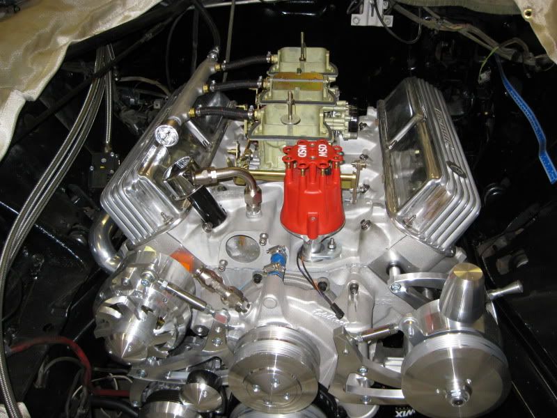

    and here is where we ultimately ended up. This, friends and neighbors, is a 500 cubic inch, ALL ALUMINUM Side Oiler/ Super Cobra Jet, with a mid rise original Three Deuce set up. the only major difference is the sizes of the carbs, which instead of 500/300/300, is 500/500/500.

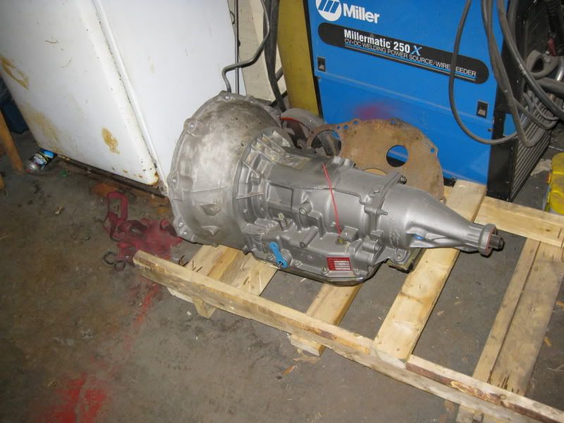

    That is a LenTec a.o.d. It is rated to 1000 h.p., and has overdrive. which is a plus, because that means we can then use one of these...
    which with 4:10 gears, oughtta get this big boy scootin. but before I get too far ahead, I want to show Y'all the HOW it went down. it may look like it just fell in there, but I assure you, it did no such thing.
    see, some of this was easyish. for example, I used the stock Lincoln motor mounts reversed from side to side, and there were a set of "knockouts" already in the crossmember to do so. sort of. the biggest troubles we had to start with was simple. time. The transmission and block were built to order. ( yeah. if you wanna build a motor like this, expect your "6 to 8 week wait time" on your block to be more like 4 months. and the first one they sent us my machinist immediately rejected for a myriad of reasons. lesson learned. if it doesn't say "WORLD" or the name of one of the big three on it, don't expect to just pull it out of the crate and start slappin parts on it. )

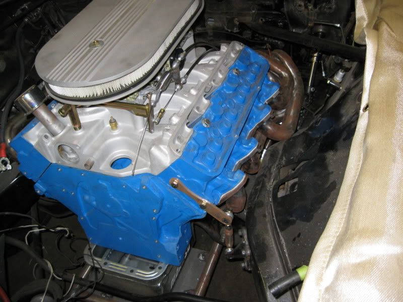

    but I digress. We went ahead and bought a poly block and heads for mock up. this is the first one I have ever purchased, and I gotta say it was pretty damn awesome. not without it's flaws (impossible to make ANY weight related changes, and sometimes the bungs act out.) the Transmission, thankfully, arrived on time and was a beautifully built piece and only had 1 or 2 minor things to change, at no fault to Len Tec.
    so I bolted the two together and after some wrangling, whipped them into the engine bay.
    ( I got a bit ahead of myself here, as I am already building headers at this point, but You get the jist.)

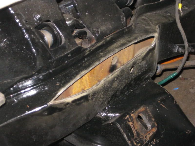

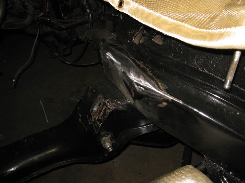

    the immediate issues were this. the pumkin sized gearbox, and frame rails were in no danger of making for a set of easily built headers. so I ditched the box, and "clipped" the rails...
    trimmy trimmy...
    tracie tracie
    weldy weldy...
    grindy grindy...
    lil flesh tone, and done...sort of.

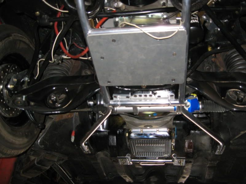

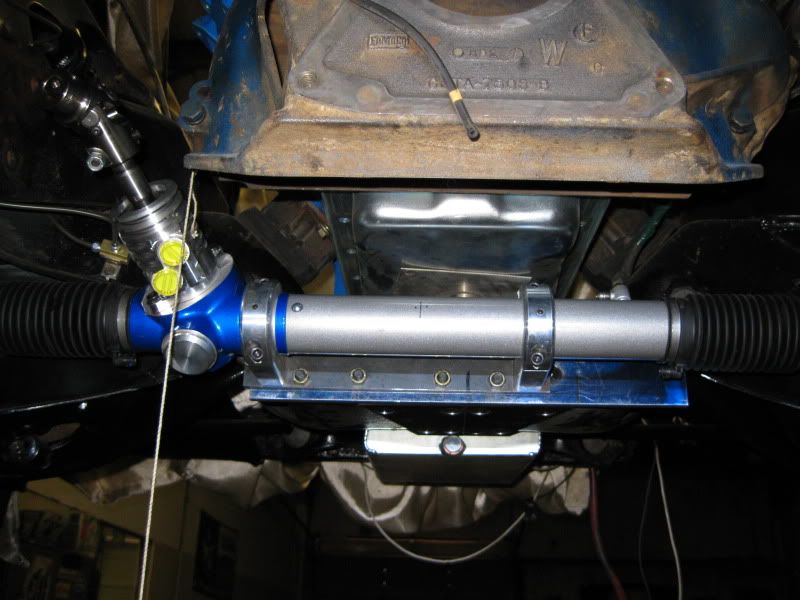

    the gearbox was 86'ed. so I decided to get all modern and such. Flaming River has just released "universal" power rack and pinion assemblies. cake.
    I started by removing a pretty good sized chunk of crossmember to get to a parallel spot with the steering arms. then boxed the bejeezus out of it.

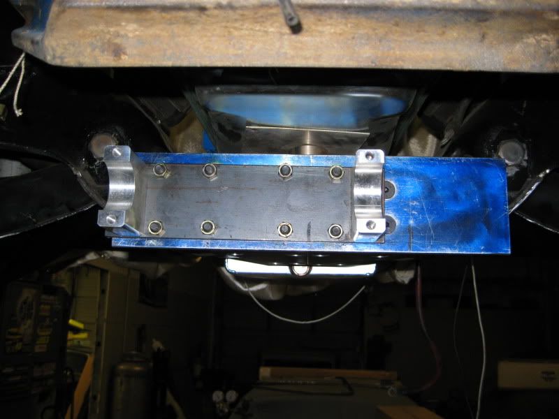

    Then, I faced the logistics of mounting the rack....
    the silver colored plate bolts to the modified crossmember via about 20 countersunk grade 8 bolts. the "carrier" plate then bolts to it the same way.

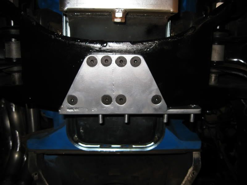

    another issue at hand was a fairly complex one. see, we decided to use a deep sump oil pan, and it hung out below the crossmember. on top of that, there were a pair of flat stock "braces" that no longer had anywhere to bolt to. hmmmm...
    one skidplate/ chassis brace comin' right up.
