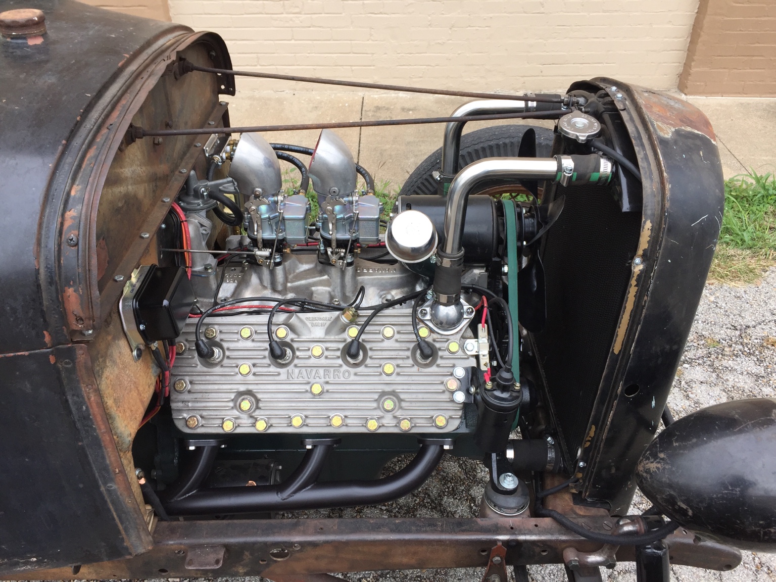

    Great build. I like the way you did the riser for the kick up. what radiator are you using?

    It’s a custom cut walker

    Exhaust wrapping up using some mandrel bends and 35/35 driveshaft cut in half [​IMG]
    And we have fire !!! She’s alive

    Agree with those who recommend boxing the frame. Too flexible without it.

    This is a Av8 not a street rod, if you think this needs boxed then you just don’t understand what it is, boxing has its place but not on traditionally built pre 48 style car

    Couple curious questions......I see the crab type distributor. Did you change out the timing gears from the 49-53 type to the 35-48 type?
    The generator appears to be the 40-48 type that uses a voltage regulator, yet you’re using the fan mount type pulley. Any idea which front bearing is in there? We get asked these questions all the time and I like to see how guys solve those problems.

    The tranny cross member you used what donor vehicle did it come from?

    Sorry.....reread the thread, F1 cross member. You have a fine talent!
