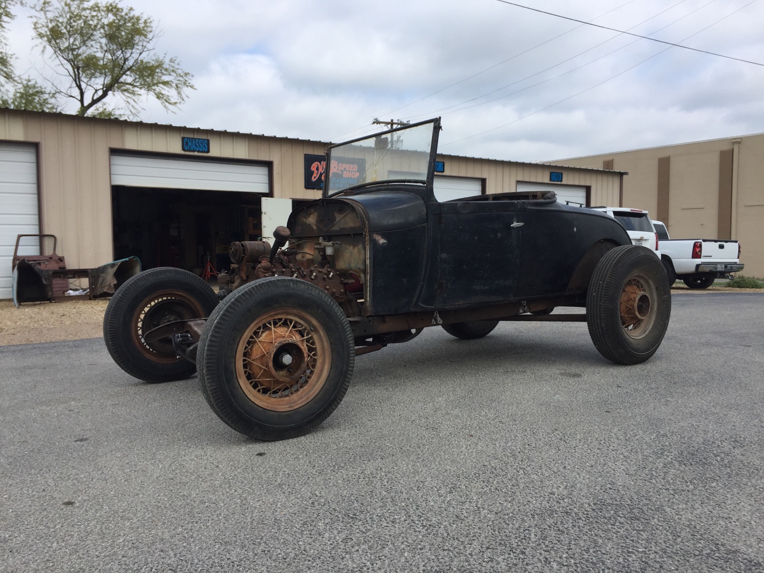

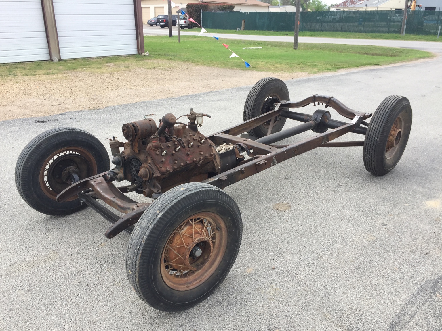

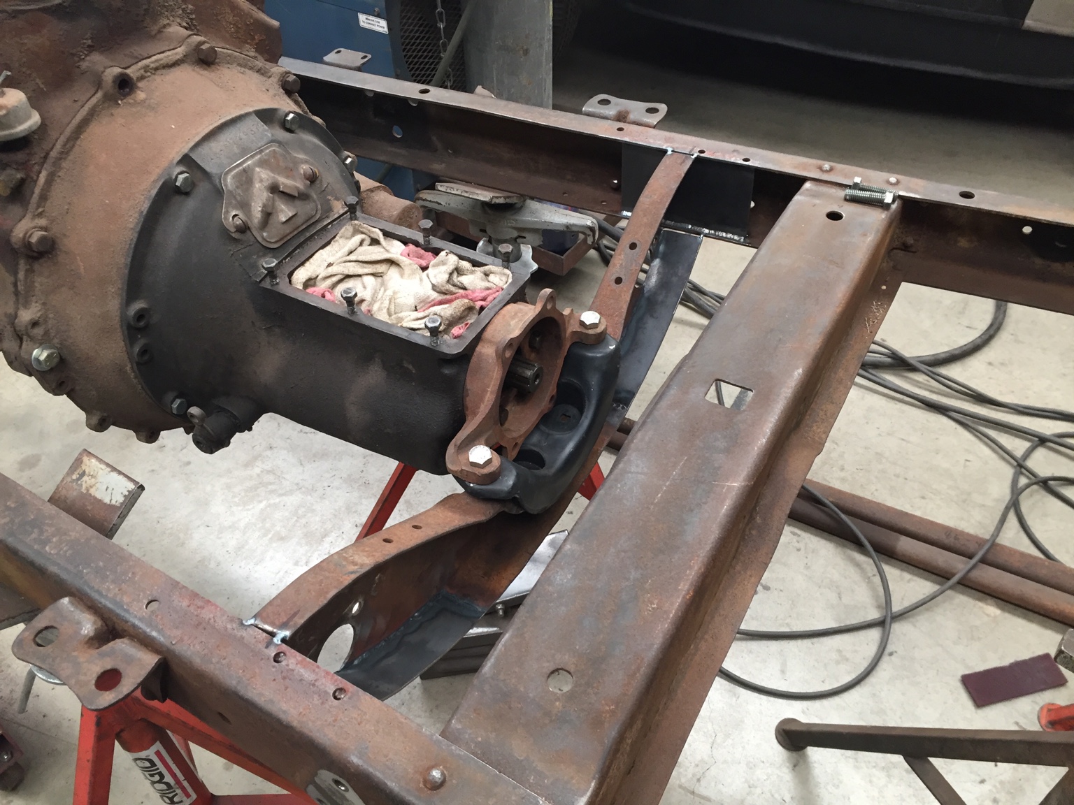

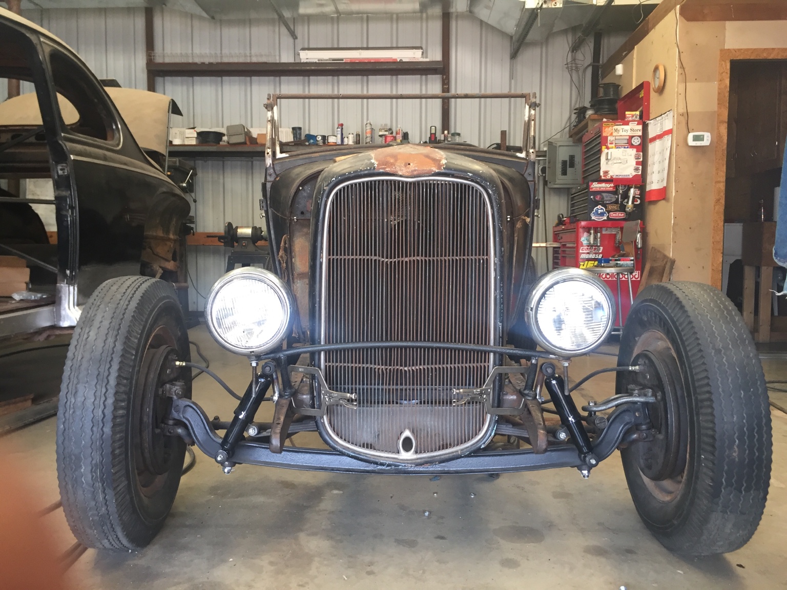

    Been hard at getting this 28 roadster going for Mr Arnett, started as a stocker, that we wanted to keep as correct as something a high schooler of the 40's would of wanted or even a Race of Gentlemen would want now, using as much original parts as we could . I'll try to catch the build up to date

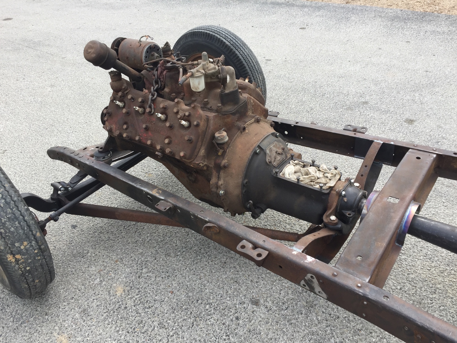

    Unsplit front 32 wishbones
    32 front dropped axle
    Flathead
    39 tranny and rearend
    Installing the f1 crossmember

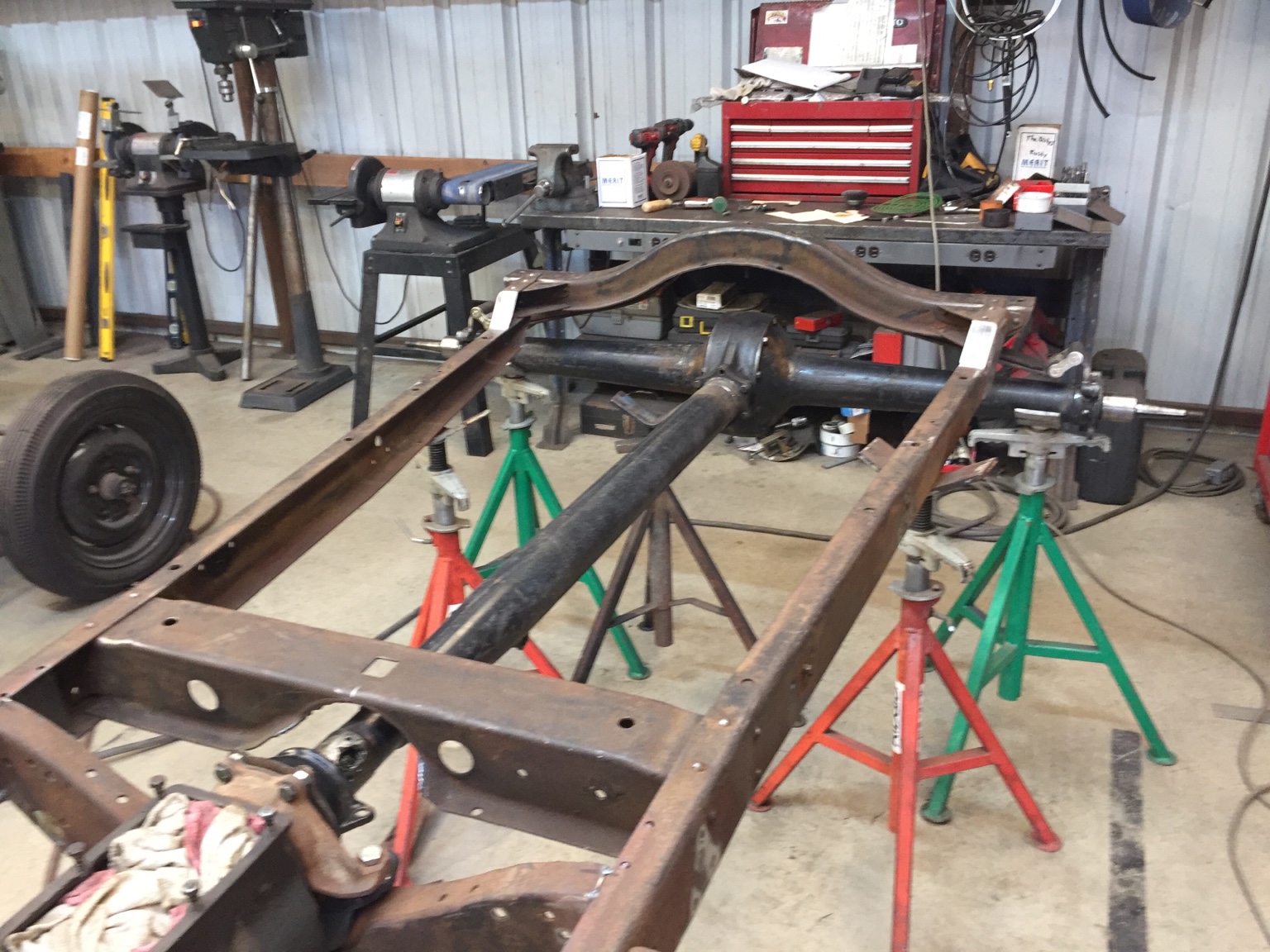

    The rear small z and model t spring set up on the 39 ford rearend
  3. Very good start!
    Are you boxing the frame?
    What brakes?
    Keep us posted.................

  7. Ohhh those rear shock mounts.....sweet utilization there.....work great work team Dirty !

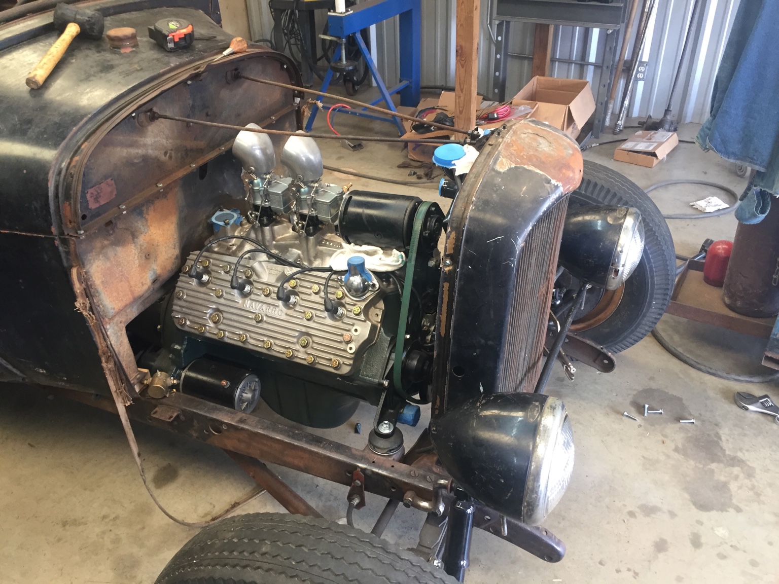

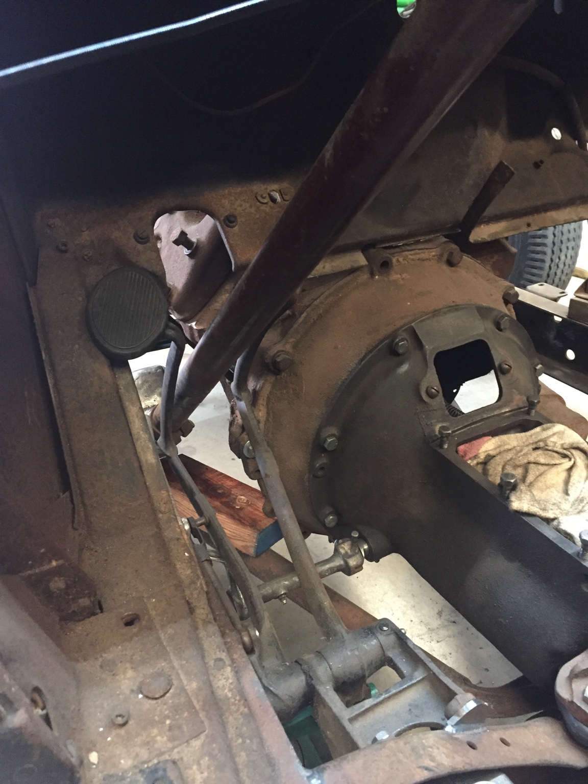

    Setting up the F1 pedals [​IMG]
    Turning down the f1 steering for the new flange to be welded on

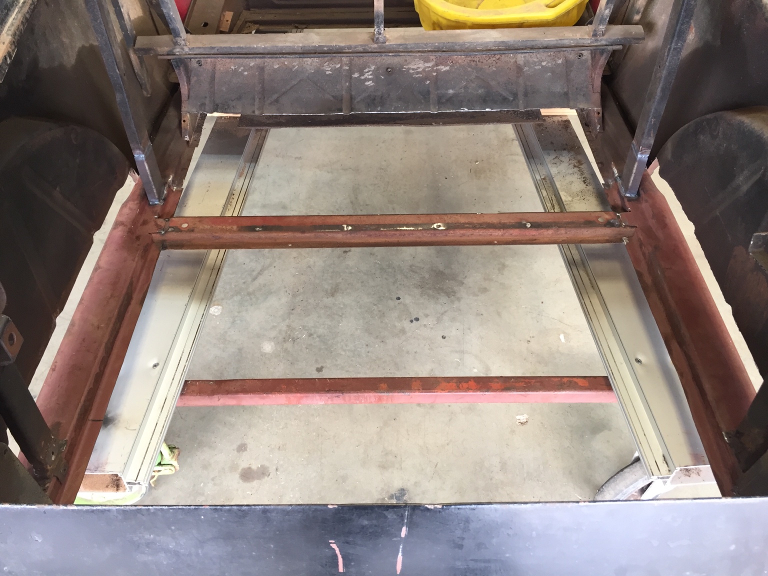

    Some of the rust repairs
    Had some spare stock subrails that found a new home on this car
    BigO, brEad, pecker head and 3 others like this.

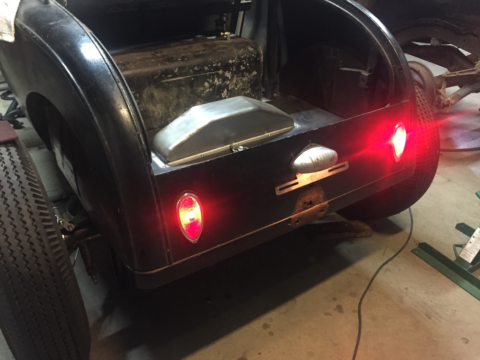

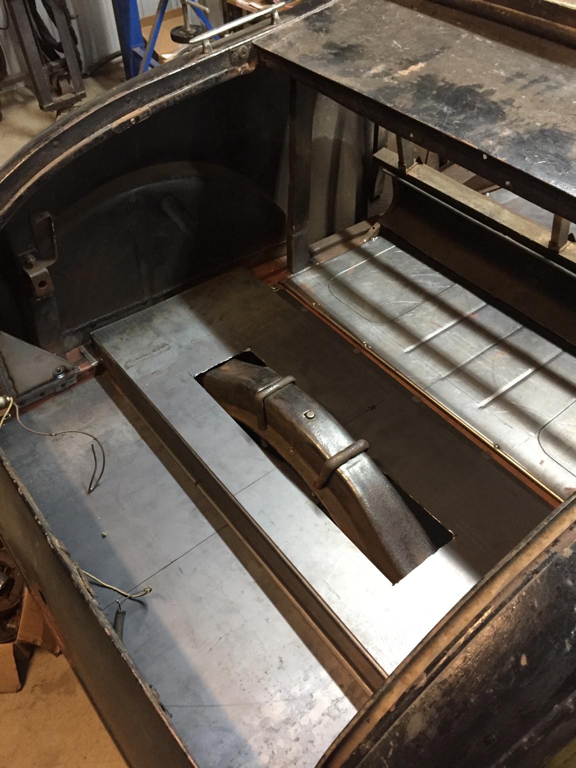

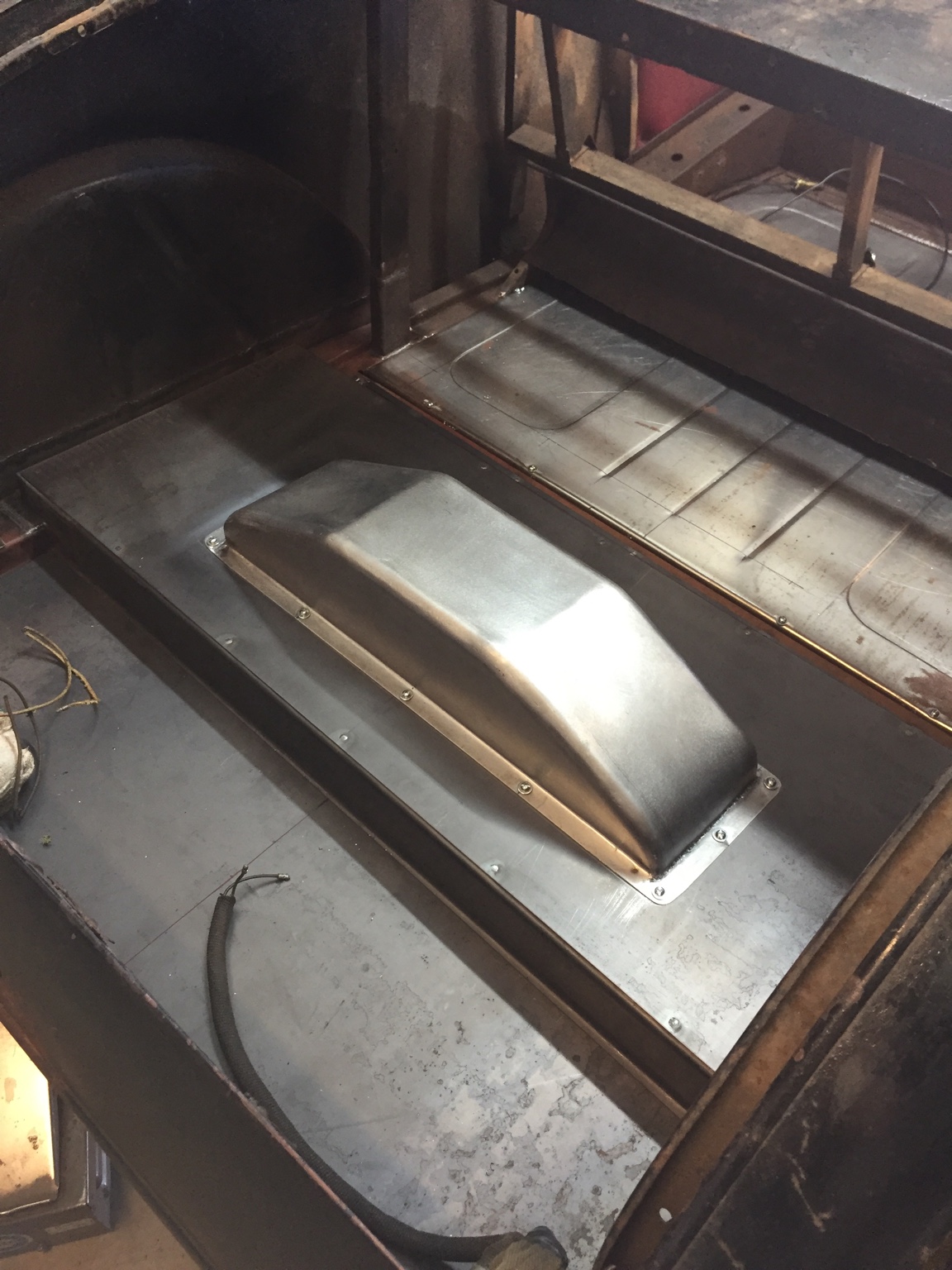

    Building the riser for the rear z area
    Whipped up a crossmember cover
    BigO, brEad, pecker head and 6 others like this.

    No not boxing the frame, stock 40 brakes

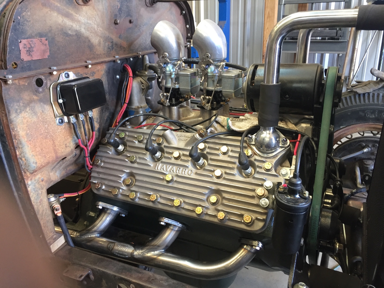

    Looks great Rusty. Any plans for a belt driven fan?

    Yes sir the fan is mounted to the generator
