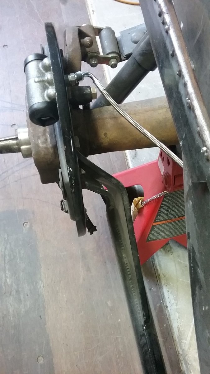

    As shown before the hard line from the master cylinder morphs into a -3AN braided line at the firewall and then back into a hard line for distribution front and rear. I did this to absorb any possible vibration between the body and the frame which might cause a hard line to fail.
    Traditional hot rods didn't have a proportioning valve, but were regulated instead by varying sizes of wheel cylinders and brake shoes in the original configuration. I've retained that OEM configuration but added a Wilwood adjustable proportioning valve to fine-tune the front/rear balance should the OEM configuration not be quite right for this roadster.
    The main line then crosses to the passenger side along one of the crossmembers and attaches to a mirror-image tee before heading to the rear. This tee also holds the brake light switch.
    Both sides then head rearward to connect with -3AN braided tubing lines to the rear wheel cylinders, also fitted with speed bleeders. Doesn't show very well here but there are brackets to the frame which retain the flex lines and adapter fittings at this junction.
    The -3AN braided lines exit neatly from beneath the frame rails and attach to the wheel cylinder with a 90-degree turn to make everything fit right and tight. I will probably use some black heat-shrink tubing to cover the braided portions of the brake lines to simulate the old school rubber lines. I know, that's cheating...

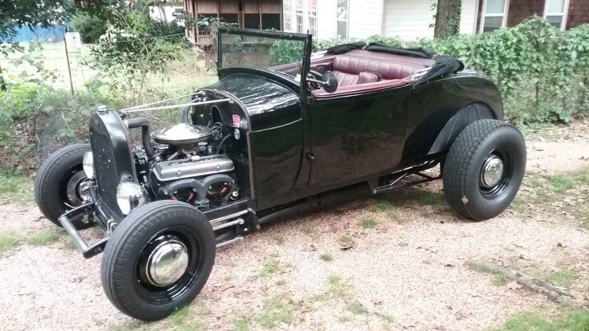

    A nasty bump-steer problem in my black coupester took a while to diagnose and fix, taking me away from Arin's roadster for several weeks. And, an "unfortunate" (you can read that however you want!) trade deal put me in possession of a red '30 roadster that was built so badly that it could not be safely driven beyond the end of my driveway has taken up even more of my time and resources. Yep, Arin isn't happy.
    So...what's happening now. Well, the black coupester got a complete new Pete & Jake's 4-bar front suspension - along with a bunch of other related stuff - to get it back on the road and driving better than ever. And, the red roadster is getting a total ground-up make-over to correct some really bad engineering and workmanship. I can't just push it into a corner, cover it up and pretend it doesn't exist now can I...?

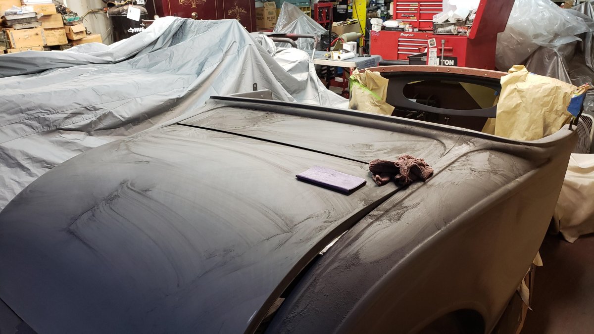

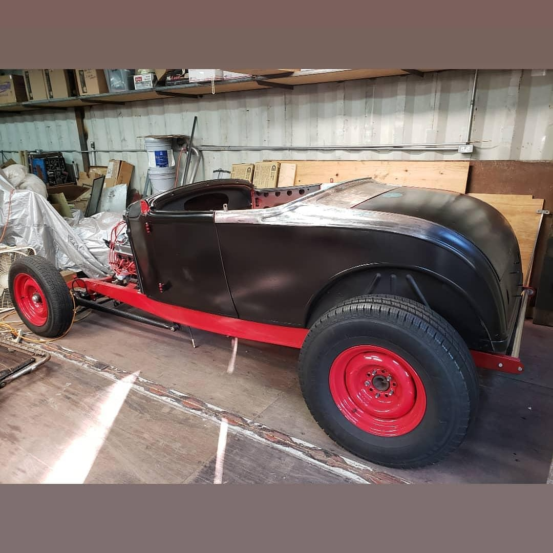

    Back in the day it didn't take much to do an "outstanding" paint job because there wasn't much to compare it to. Today, however, it's pretty tough for a hobby builder to do his own paint and then park it next to a $5000 professional paint job and feel good about it. But I'm block-sanding my little heart out to make the body straight enough to look good with shiny paint. I've done a couple of test parts to be sure my prep is going to be okay so now it's just a matter of finding the time to finish it up. It's 104* in the shop today so I'm taking a break to write this before I die of heat frustration...
