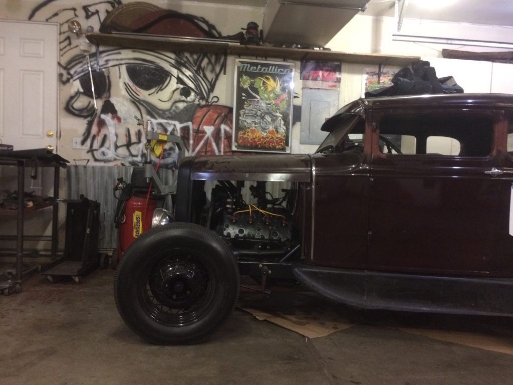

  3. carbed87
    Joined: Nov 3, 2008
    Posts: 586
    carbed87
    Yep. Gonna see what I need to do for rad clearance. Getting close to a test drive

  5. carbed87
    Joined: Nov 3, 2008
    Posts: 586
    carbed87
    Was able to get the radiator mounts roughed-in this weekend. Just need to pull everything apart and paint it all black.

  6. carbed87
    Joined: Nov 3, 2008
    Posts: 586
    carbed87

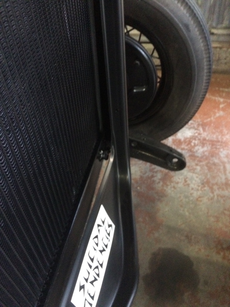

    Had a little time to fiddle with the car so I decided to make my radiator H.A.M.B. Friendly.
    Also did some trimming of my radiator mounts so that they are a little more hidden when the grille shell is on
    Damn petcock is interfering with grille placement. Not the end of the world though.

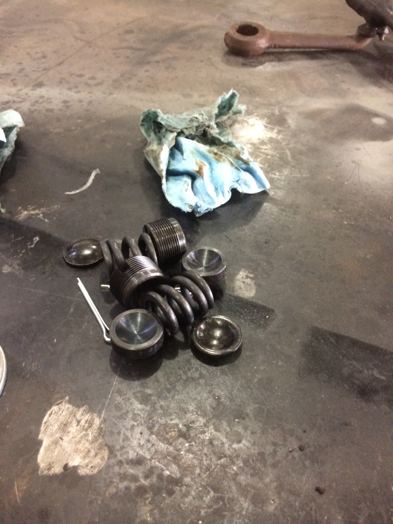

    On deck:
    Swap out shift fork
    Figure out radiator hoses
    Firewall/throttle cable situation

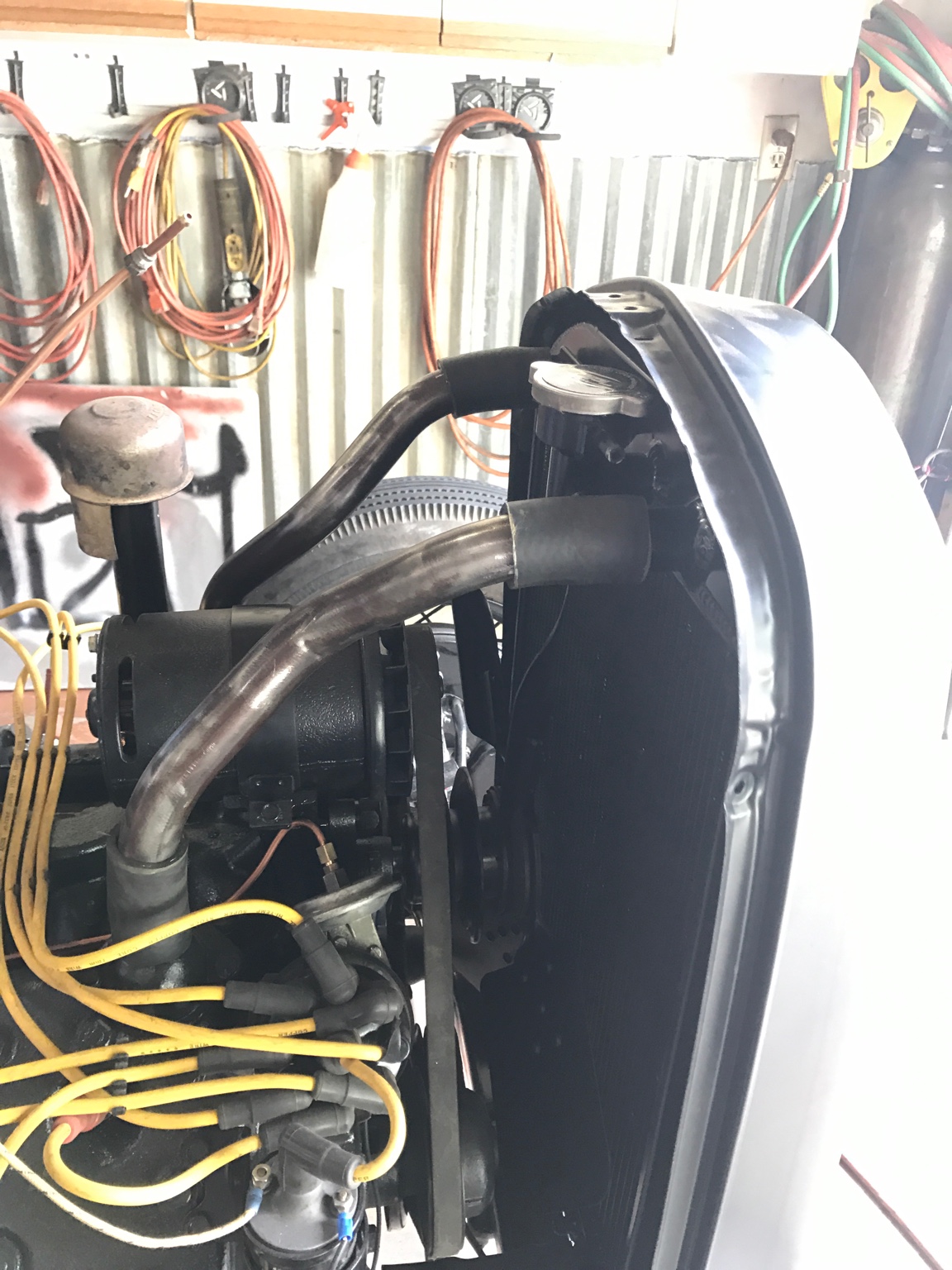

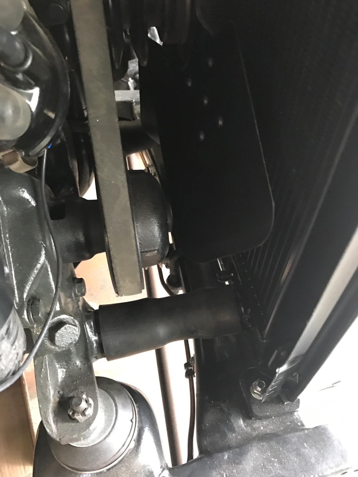

    Had a little snag this weekend but came out ahead.
    Got my upper radiator hoses all figured out

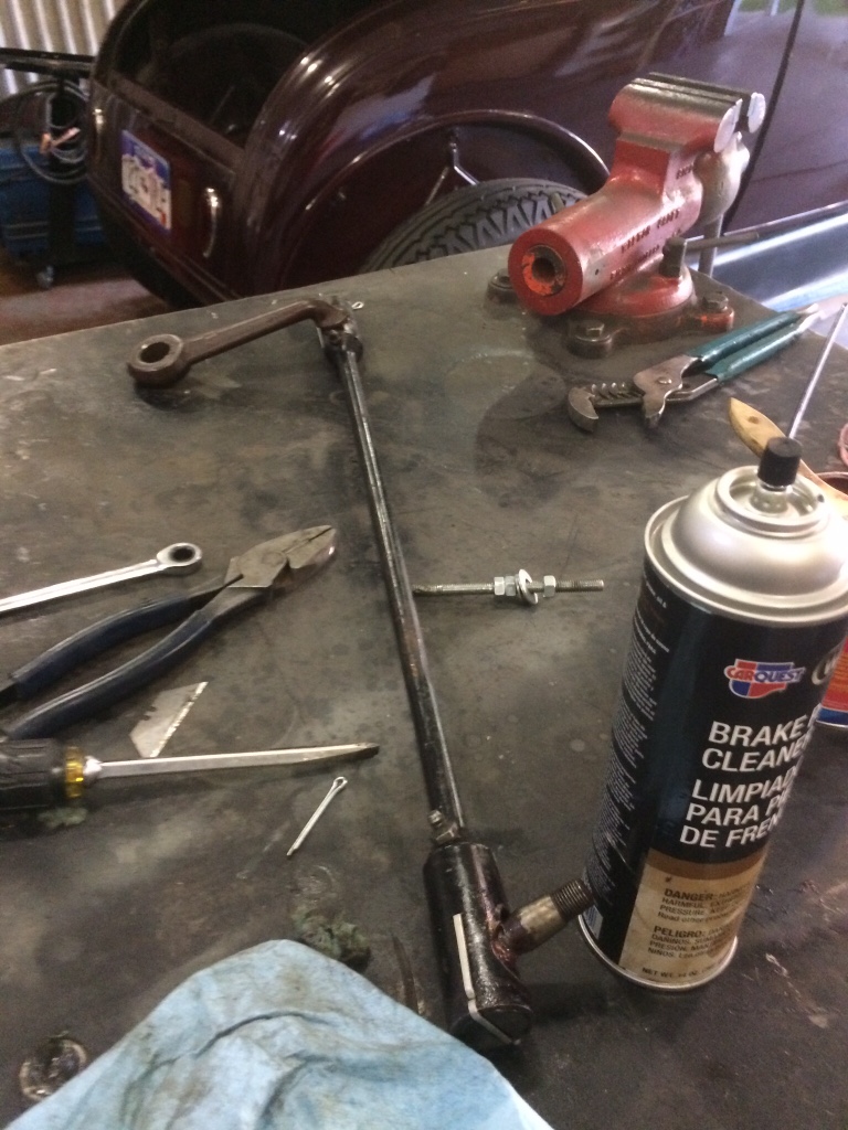

    Rad hoses painted and some throttle linkage
    Pedal is a later v8 unit, the linkage I got from Berts is the timing linkage from a stock model a, bent and cut/shortened then threaded with a 10/32 die to work with a coupling I had maying around.

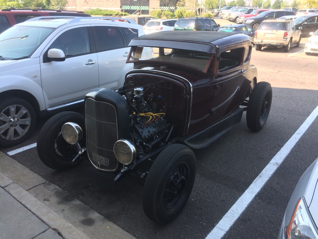

    Guess I should update this just for the hell of it.
    Car is running and driving, wired it a few weeks ago, was running kind of choppy under load so I ordered a delco distributor from bubbas...best $300 I ever spent. Here are some pics
    brEad, kadillackid, Stogy and 11 others like this.

    Love the build, have read it front to back twice now, keeps me motivated to stay on mine. The fan set up, is that just stock 8BA parts? my motor didnt come with a fan so Im sorta trying to understand what I need.
    carbed87 likes this.
  21. carbed87
    Joined: Nov 3, 2008
    Posts: 586
    carbed87
    Thanks everyone, lindy the fan is stock stuff, shouldn't be too hard to find.
