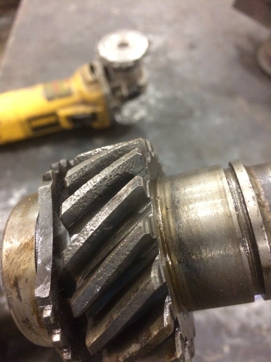

  3. Thanks for all the compliments guys. Not really sure why, but it has been a struggle to make any decent progress. Anyway, last week i took my transmission over to a good friend's shop for him to look it over (bonus points if you can tell whose shop it is in the first pic). While it was found out that i have a Lincoln gear-set in my trans...it's a little rusty. Here are some pictures of what we found. I was told to look for another set of gears. Kind of a bummer. 027.JPG

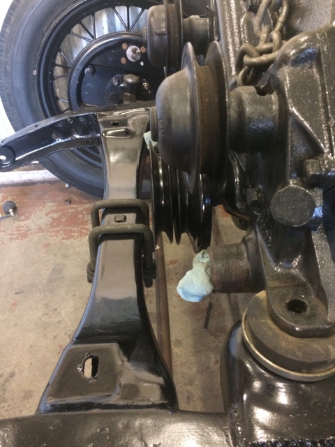

  17. Kiwi 4d
    Joined: Sep 16, 2006
    Posts: 3,581
    Kiwi 4d
    image.jpeg If this clearance is as tight as it looks you will have issues changing belts.
    9 degrees caster is still close to good and only slightly over the recommended .Straight line will be better .

  19. Hey guys, got some updates for ya. When I get to my computer I will update more. Kiwi you have a good point. Belt changing may be an issue...guess I'll have to figure something out there.

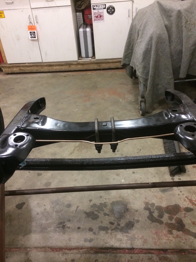

  25. Forgot the pictures
    IMG_0400[1].JPG IMG_0401[1].JPG IMG_0402[1].JPG IMG_0403[1].JPG IMG_0405[1].JPG
    benchseat4speed and Runnin shine like this.
  26. dentisaurus
    Joined: Dec 11, 2006
    Posts: 399
    dentisaurus
    from Boston
    Making some progress there!
    In the last photo the brake line looks really close to the shackle. Is that just an optical illusion? I wondered if the shackle would contact it if the suspension unloads over a bump?

  28. It's just an illusion, that was a top priority when doing these lines. I can pick the rear of the frame up by the crossmember and the shackle will miss it even at full droop.
