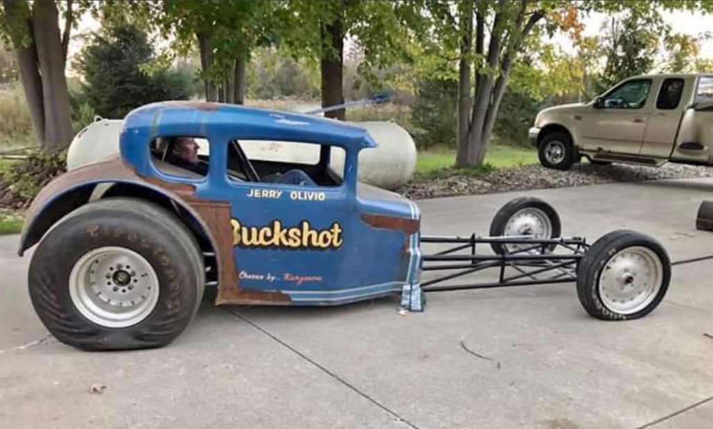

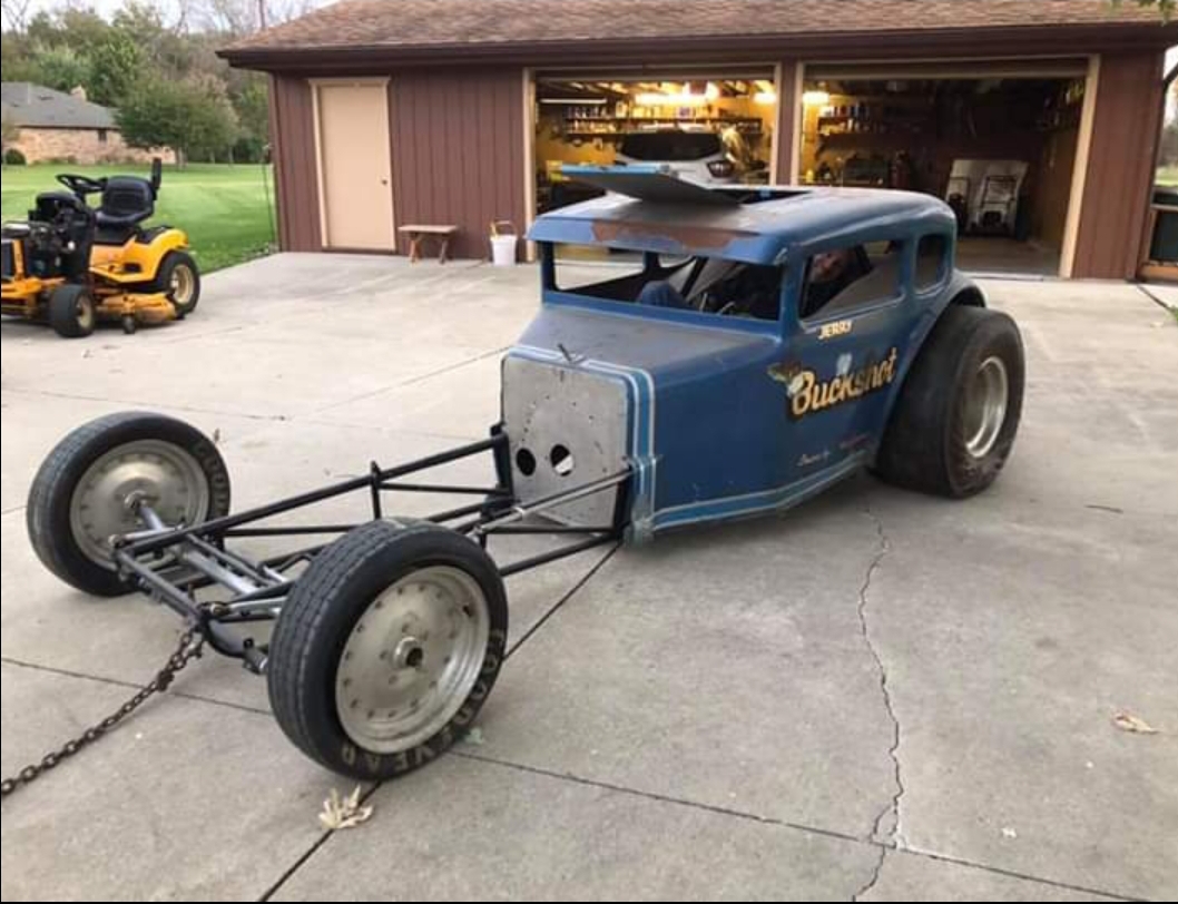

  23. It was up in Michigan and my truck was acting up, or I would've bought it, I'm pretty sure someone bought it for $3500
    It was center steer and the whole body lifted like a funny car, the guy was listing it for his boss which was rebuilding it after he purchased it, but ran out of know how and got frustrated. It actually lasted over a day on marketplace and I was just watching it slip away with my broken ass truck in the driveway.
    https://www.facebook.com/marketplace/item/2056979097673616/
    Screenshot_20201026-213039_Facebook.jpg Screenshot_20201026-213108_Facebook.jpg
  24. Another marketplace offering, I think this one was in the $8500 range, wouldn't pass current tech and offered as a cackle car if I remember right.
