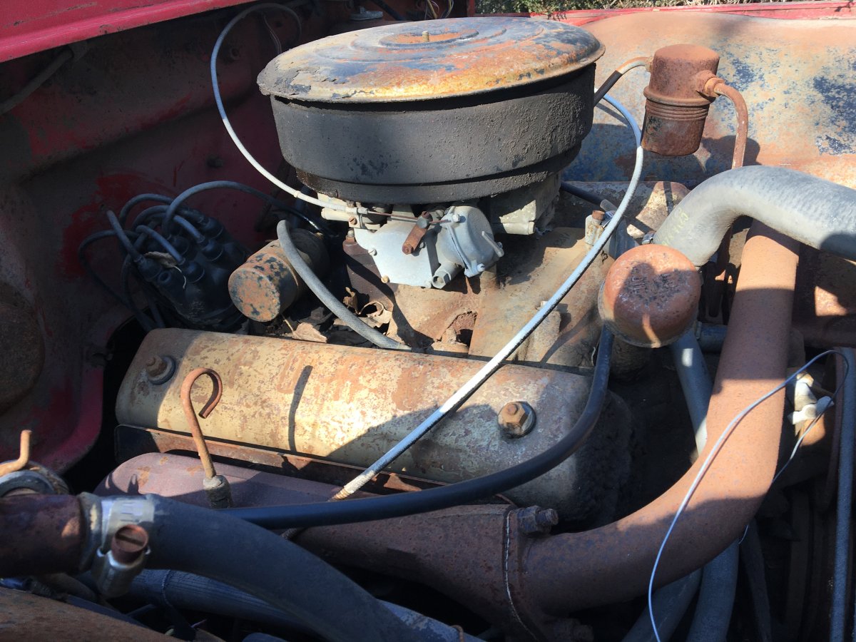

    Glad to find a wizard of the Y Block. I just bought one in a Fairlane and while I've wrenched on cars all my life I don't believe I ever done more then a tuneup to a 292. I just bought the 56 Pictured and was told the engine had been rebuilt. has sat sense 2002. Speedo shows 52,000miles, hummm. The seller was kind enough to allow me to get it running at his house. At a glace it looks good. Bad Seller replace the 4 barrel with a 2. Worse wouldn't start and due to how it turned over I pulled the valve covers to fined half the push rods bent. The motor is very clean inside, no sludge or buildup in the lifter valley or heads. I haven't check yet and unsure if the motor can free wheel with a bad chain but guessing with this many bent push rods there is a timing chain problem. Anyone agree? I don't see much on the net about this. I see where people mention stuck valves and recommend tubular pushrod replacements but also see where there maybe issues with the ball size on the rocker arm adjusters with those replacement. Mine has a flathead adjuster with a locking nut. I'm going contact Motor Machine today but would appreciate any voice of experience in this matter. Thanks
  9. So, if it was just rebuilt and it never ran, and now the push rods are bent it could be the cam was timed wrong. The gears don't go "dot to dot" they go off to the driver's side with 12 pins of the chain between them. If it is wrong, valves could hit pistons.

    I concur with 46international,
    The timing chain is easy to get wrong so it was probably wrong from the rebuild and never has run.

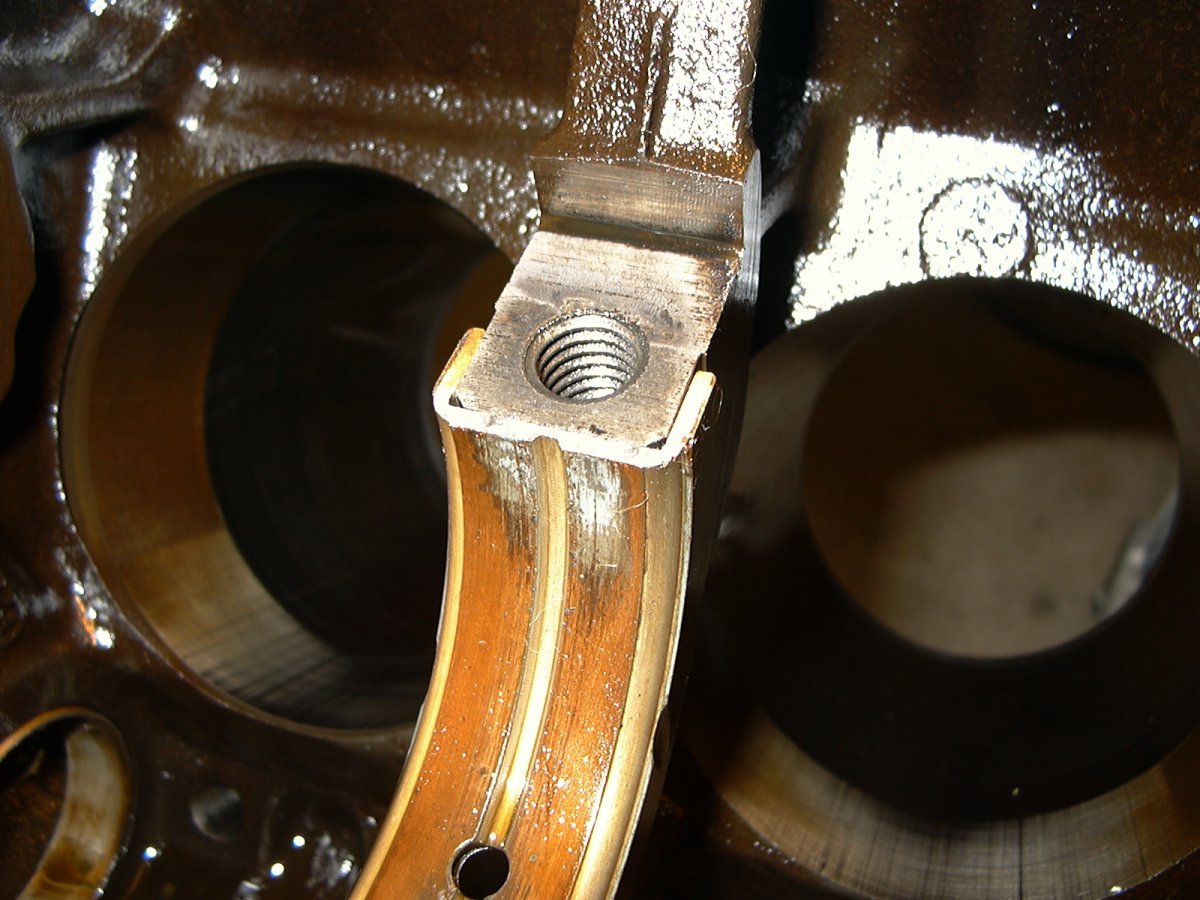

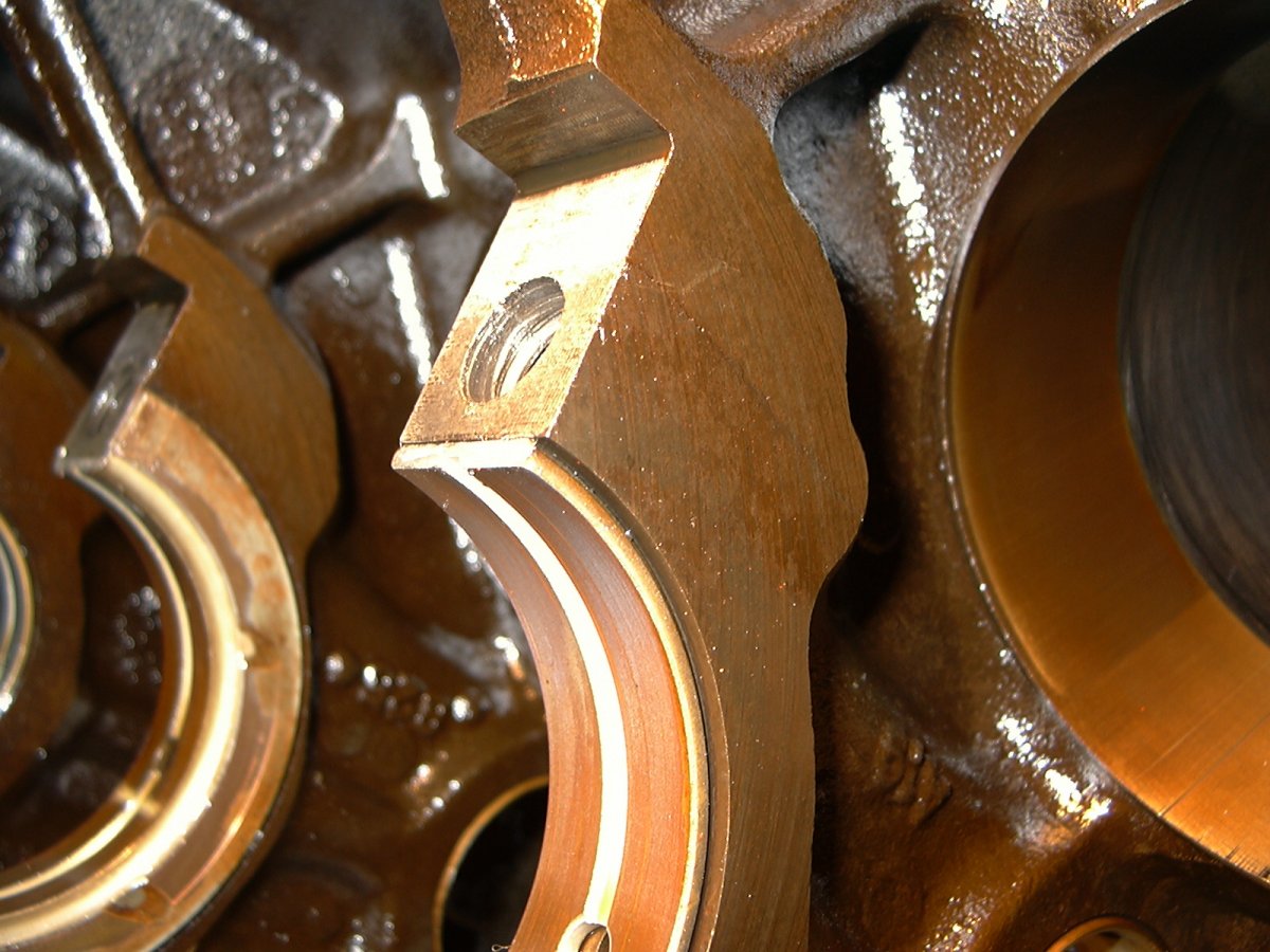

    This is the original block out of my 57 T-Bird. You can just see the crack heading up towards the cam bearings. If I remember right, three of the mains had cracks like this. Most went across the main bolt holes. I was able to find a good replacement block with a local T-Bird guy and it's been in the car the last 15 years or so.

    Kind of an odd place to crack, isn’t it! Looks like it cracked in the thickest part, but I guess the bolt hole weaken it some. I guess the y-block could use some cross bolts, like the 427 FE?

    I was wondering about that. They did have (excessive) incorrect torque specs in the shop manual at one time. That's about how they would crack if reefed down too tight, no?

  20. I had a 292 block that looked just like that, cracks in at least 3 main bearing bolt holes. someone had tried to braze them up but they had re-cracked.
