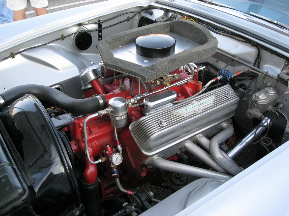

  5. 55blacktie
    Joined: Aug 21, 2020
    Posts: 793
    55blacktie
    I like the Gunmetal Gray 57 T-bird. The right color and wheels can work wonders on an otherwise cute, effeminate car. My 55 is Raven Black.

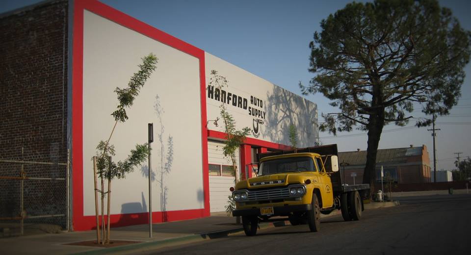

  13. Yes, I like Y-Blocks. I have several cars and trucks with them. I have a D/GR (gas roadster) with a 304ci Y (.080 over 292) that has gone 192+ mph but one of my favorites is my F-600 shop truck. The engine was built with "junk" parts that were considered undesirable to most but I made do with them. 312 block with three sleeves, .030/.030 crank with on rod journal burnt and heads with a casting number nobody wanted. Bore the block .105" over, offset grind the crank to 3.5" and rework the heads to run the larger 1.92" intakes with a little port work and the end result was a 335ci Y with enough power and rpm to get the old truck to 90 mph with the stock gearing. I believe it is my best demonstrator to show customers what a Y can do. Although the roadster is pretty good too. :)

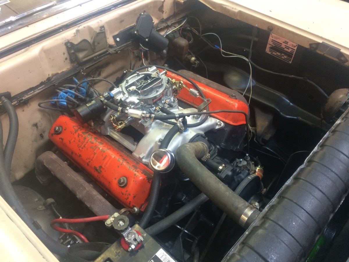

    Definitely,
    Here’s the 292 I picked up used and put in the wagon.

    If you can find a later valley pan it has a hole for a pcv valve with a baffle under it.
    On my 292 I just drilled a hole in the valley pan and used a pcv valve for a 302 and plugged it in to manifold vacuum. I haven’t had a problem with it picking up oil even with no baffle under it.

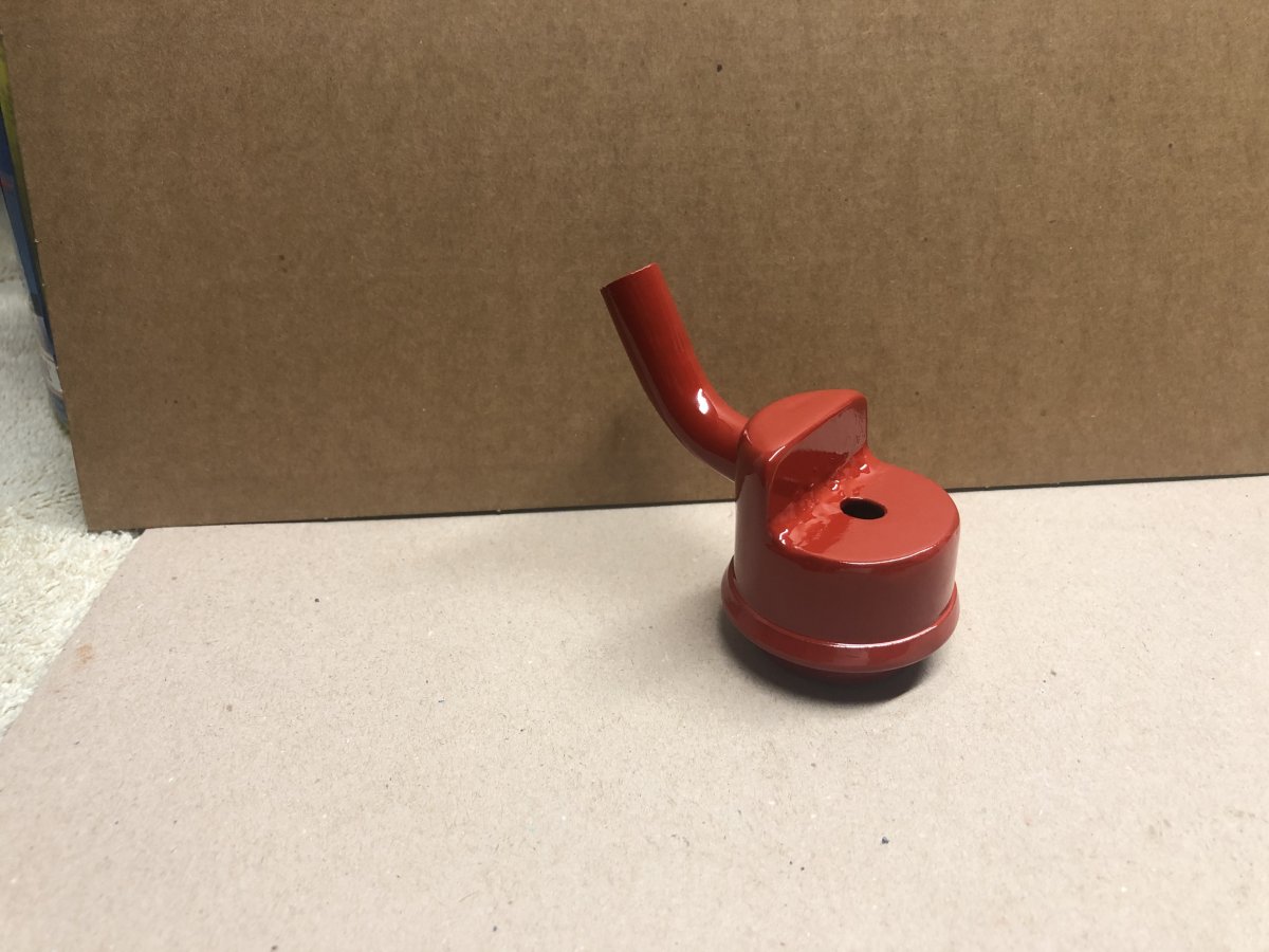

    Valley pan with valve and grommet installed in draft tube location. This pan happens to be the elusive "E" code variant, note indented top surface, and is needed when using factory 2x4 intake. There is no such requirement for after market intakes. The pans with the road draft tube came on all '55-'57 Thunderbirds and trucks after about 1959, maybe earlier. (sorry, not up on truck specifics)

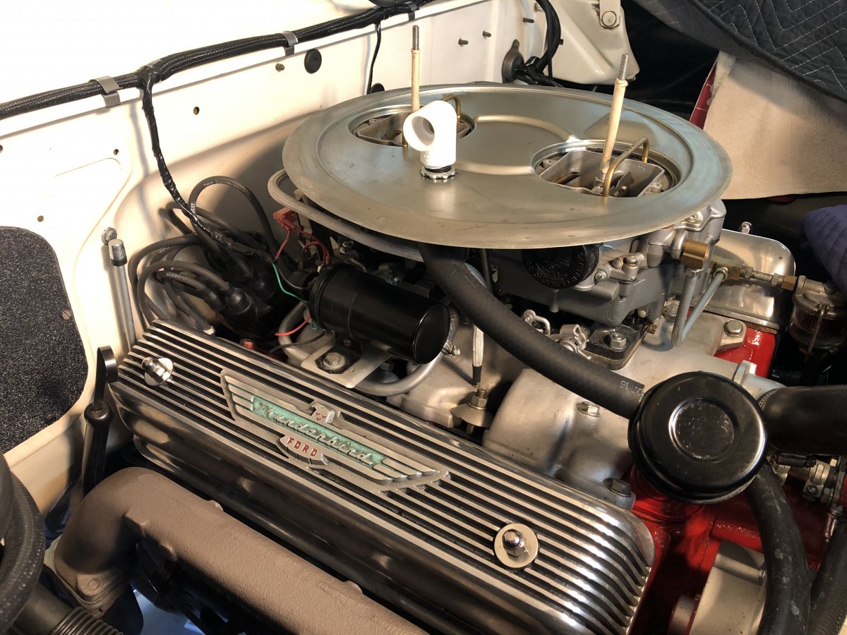

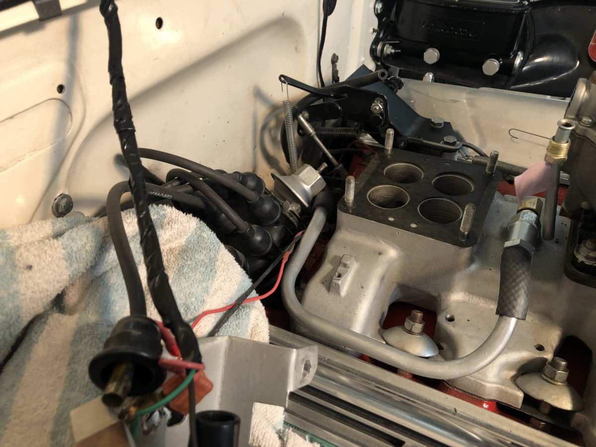

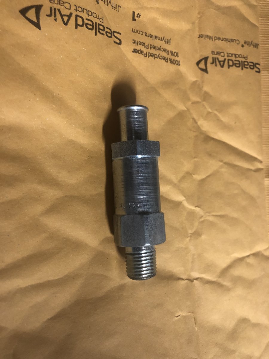

    With dual quads it was a little harder. 1961-4 Ford Merc PCV valve. 1.5” of vacuum on the pan. No engine smell in the garage. Rear main seal leak/drip now negligible. Factory T-Bird side car road draft tube plate. C765676C-525C-4C3C-B930-92FF0DC5FB7E.jpeg 5F5B99AD-D4C1-47B4-ABFF-1278E3CBD63A.jpeg F4BE7C6B-D138-452B-9766-690556BA656D.jpeg E5B163C0-DE19-48A4-ADD2-C13ABF8C9FD6.jpeg
