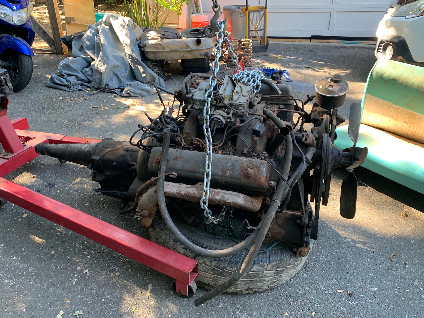

  3. Ok, here it is guys and gals. Dirty on the outside but clean on the inside. I can't verify that it is a 312 until I pop the tranny off. Carb is a Ford 4 bbl (replacement), starter and gen included. Plus about a gallon or two of antifreeze. I am going to hope and be optimistic that the engine still has life left in it:rolleyes::D.
    Truck64 and loudbang like this.

    It has the 57 and up exhaust manifolds and looks to have the 57 and up distributor and if is a 57 engine it should also have the good rocker arms.

  5. Well I found the little aspirin on the crank flange. So I am pretty sure I have an unopened 312 with about 47K on her. I will verify her main caps later this summer when I check the bearings.

    47k or 147k? What seems more likely?

    I hoping 47.L. At least that is what I am choosing to believe. As far as I can tell the engine has me never been opened and the car’s odometer said about 47k. That and the plate I got said it was last registered in 97. Either way the heads will come off and go in. But I am hoping this bodes well for the bearings.

    @1930artdeco
    Have you fired it up yet?
    The valve rockers, rocker shafts etc., look really clean. That's a good thing. Are the undersides of the rocker shafts galled up, or show scoring? That's where they get trashed, due to poor oiling generally, because that's where the load is concentrated.
    Can remove the cotter pin, "wavy washer" and loosen up an end pushrod and slide off one of the rocker arms completely and take a peek. Or just loosen up rockers in the middle and they will slide over and out of the way. Maybe use an inspection mirror to look at the underside of the rocker shafts. Also look at the rocker arm tips, where they contact the valve stem.
    If it cleans up, compression is good, oil pressure is good, rockers getting good oil flow I'd sure not be in any hurry to tear it all apart. Y-blocks are a little bit different, they have their idiosyncrasies.

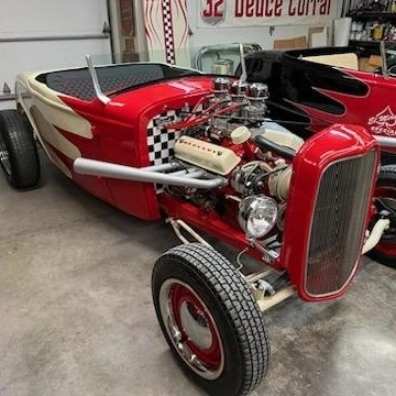

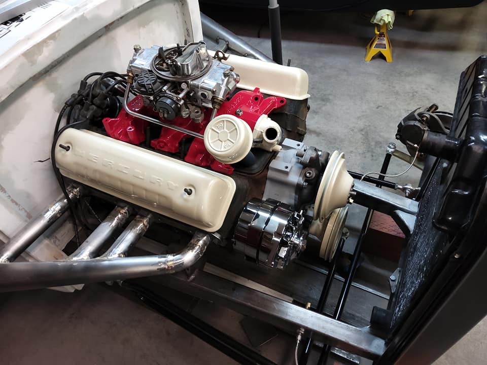

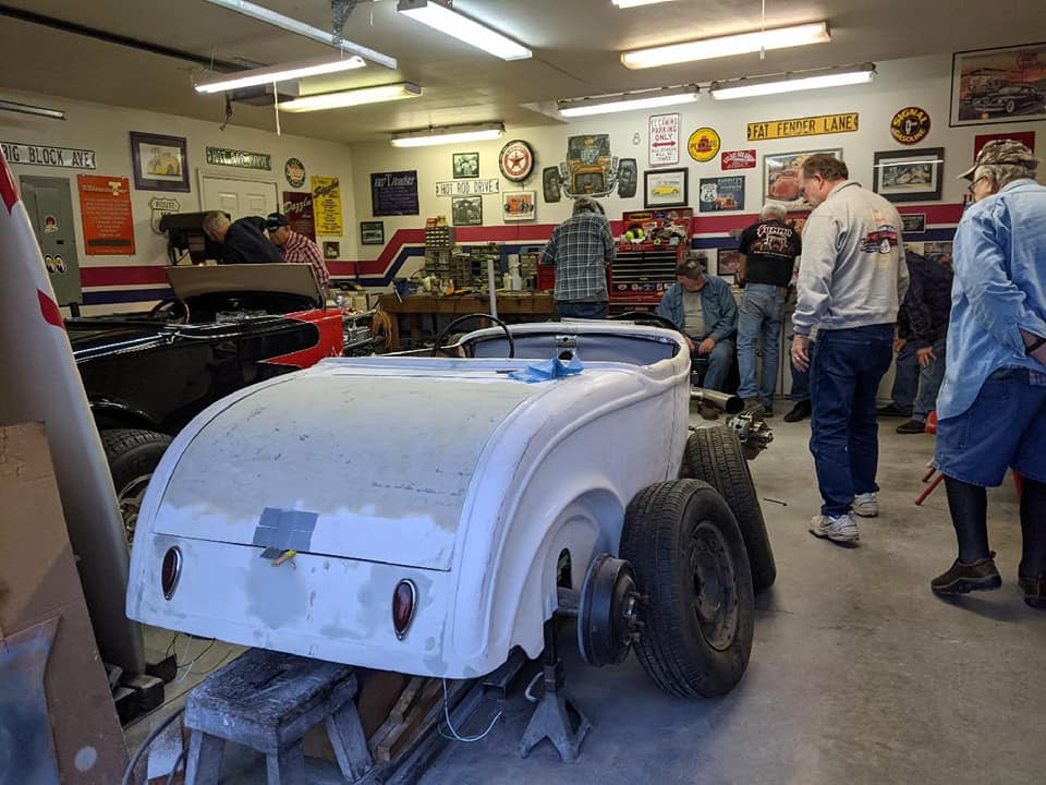

  11. Thought I would post a couple of more recent photos of our 32 with Y-Block build. Again, doing this on the cheap so not a lot of chrome but trying to do a lot with paint. Sanding and painting is cheap compared to chrome and we have lots of hands to sand with! 223976272_4261119827278496_5823506942252865360_n.jpg 223391100_4261119823945163_741742702307879920_n.jpg

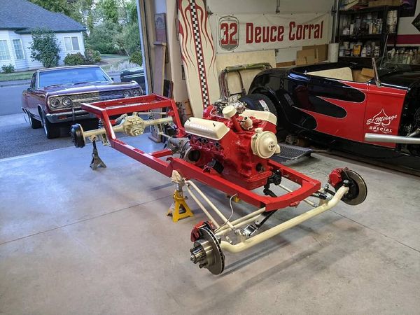

  18. Okay, a little further along with the Y-block powered 32 build. This picture is from a week ago along with the build guru, Jeff Foster owner of CJ's Hot Rod shop now retired. That is his personal 425 nailhead 32 project in the background that is NOT being built on the cheap. Thanks to Jeff for providing the space and knowledge for our charity project build. 20210826_194327.jpg

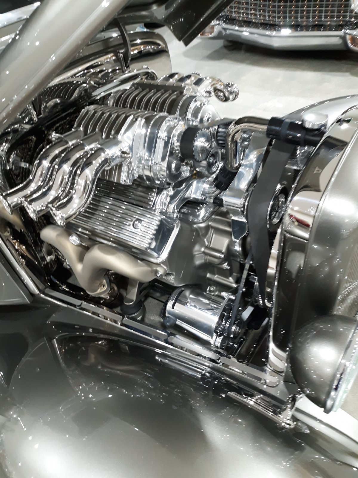

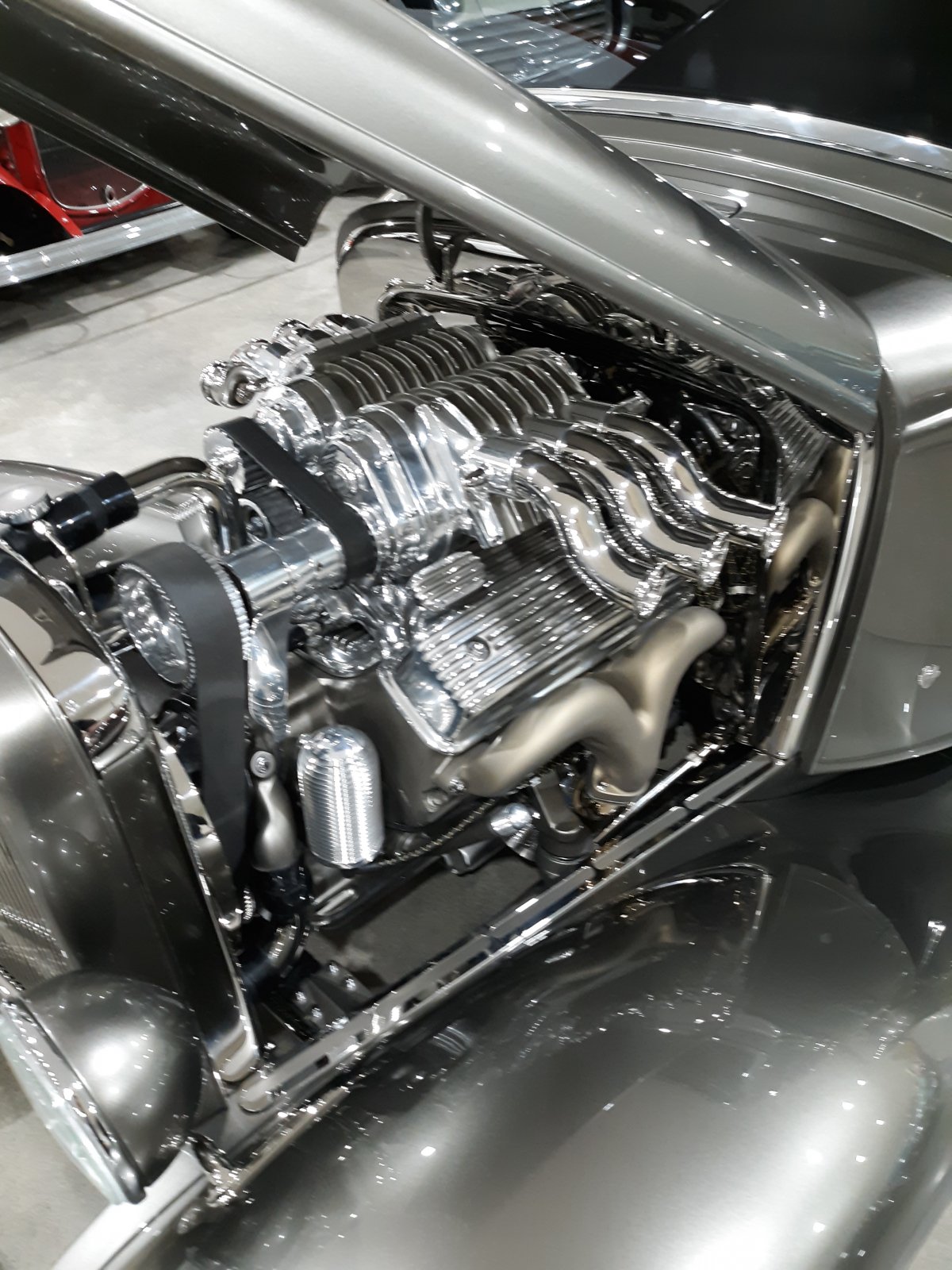

  19. I was invited to view a private car collection with some really high end cars in it and saw the Y-Block that was the nicest and probably most expensive I have ever seen in my 70 years. Even the block was body worked to be as flat and smooth as the rest of the car. Two blowers, and everything else they could throw at it! Amazing! Sorry the pictures are a little fuzzy, my phone camera isn't great. Mark 20211016_132131.jpg 20211016_132115.jpg

    The HAMB crowd never disappoints! :D:D:D:D
    Bones
  21. ^^^^ Now that's what I call Zoomies!^^^

    Those exhaust manifolds are so nice…

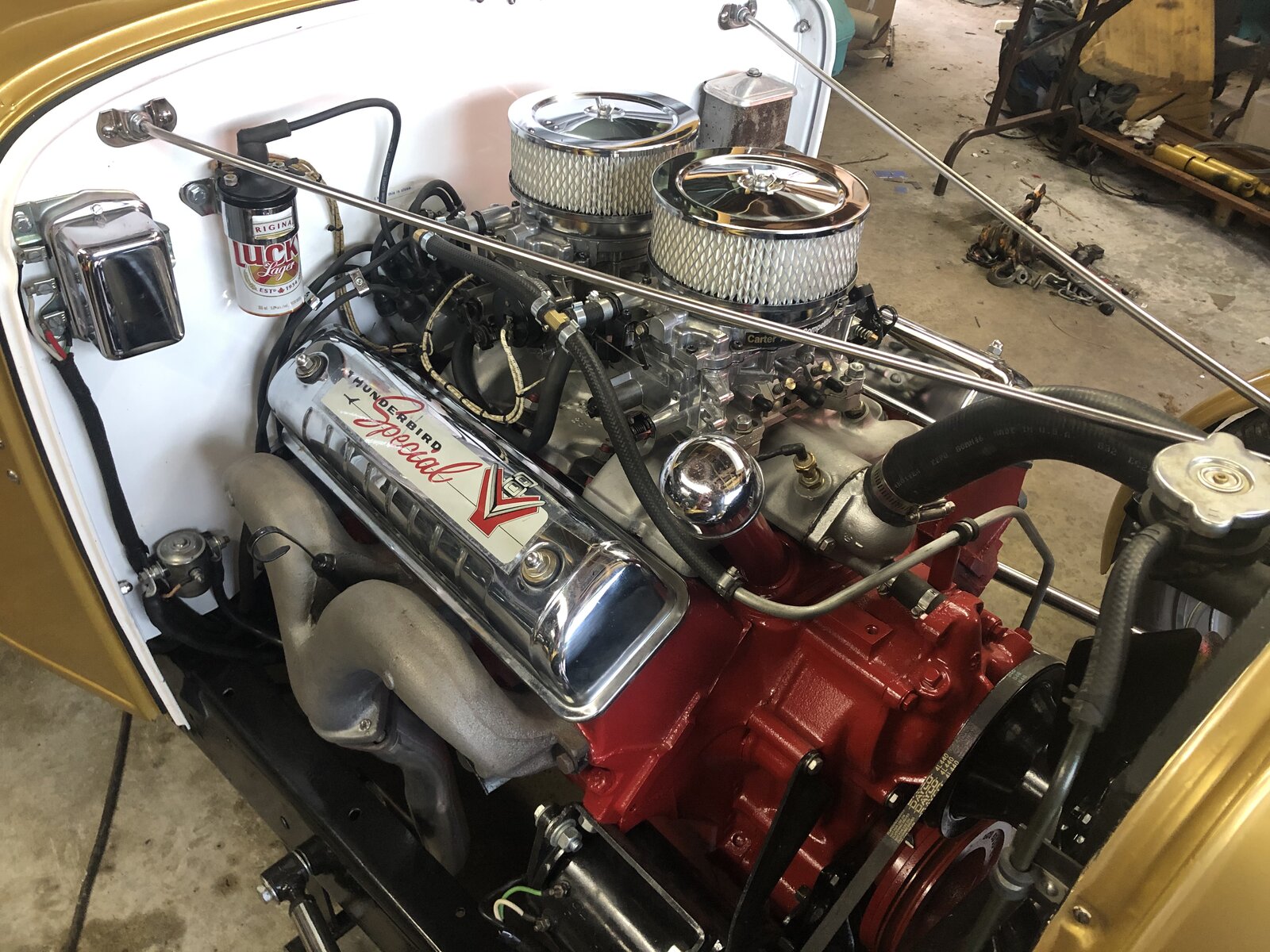

  23. 278670625_5176688805721589_7693596537990717023_n.jpg 279110871_5176688815721588_3764682714097632080_n.jpg 279022673_5176688812388255_5691345397951421596_n.jpg
    Well, just to keep the ball rolling on our project car we fired up the 292 tonight for the first time. This engine last ran some 15 years ago so we had no idea how it would run. No coolant and no mufflers but it fired with 50 lbs of oil pressure and didn't sound too bad. We didn't run it very long. Tough old engines these Y Blocks.

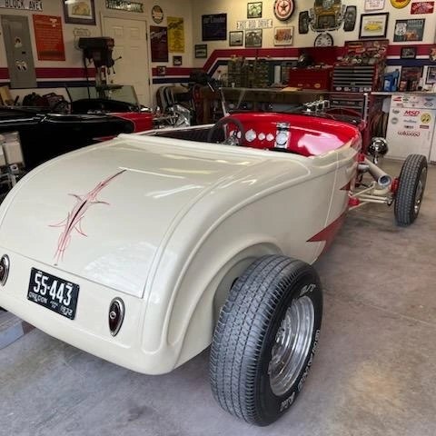

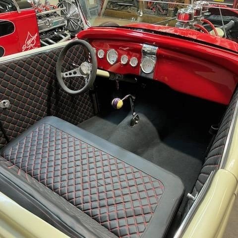

  27. I posted some pictures a while back (April 21) of a Y-Block powered 32 roadster we were building as a group. Been a while so I thought I would post how it looks today. Almost done, interior is in, baffles in headers done, need some work in tweaking and touching up dozens of little items when building a new car. When car is completely done we will be putting it up for sale, donating any profits to local charity's and starting the next project this next summer. This is the fourth car our group has built, don't know how many more we can do as we are running out of good knees and backs! Great way to spend Thursday nights with like minded friends and a great way to give back to the community! 324724581_1107683883281835_7690135678903548552_n.jpg
  28. Hi everybody! Our Y-Block powered 32 is finally done and up for sale, I have posted pictures here before with the story of our builds. The proceeds (profit) of the sale go to charity, we pick local ones that don't have much overhead. It is posted on Facebook as many people have followed the build there. https://www.facebook.com/jeff.foster.779857 $25,900 if anyone is interested, contact Jeff Foster. 330821676_1887368504966551_3381995370203201736_n.jpg 323169430_965697148137722_8074048453955404676_n.jpg 329718153_896643888210294_3038285710426459267_n.jpg
