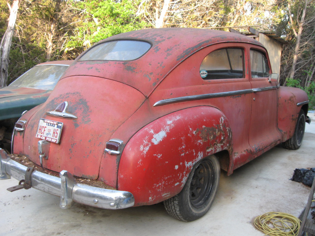

    This will be a build thread documenting the resurrection of my 48 Plymouth 2-door DeLuxe sedan. Some OT mods were made to it by the PO, but considering he was an old-school railroad man I can look past that. I won't talk too much about those things here, but suffice to say it drives & rides like an early 80s Regal. 'Nuff said.
    That tells you what the smoking, knocking little engine that's in here is too, which will be coming out. But don't tell me to "Keep it all MoPar" please; it's too late for that and I'm not a fabricator so I can't put a 318 into what this car is underneath. I'm a parts swapper and I just want to get this cool ride cruising again.
    One Mr. Rideout welded this all up in the late '80s and passed not long after, so refinement was minimal and then it sat & deteriorated.
    Going for a '60s look with concessions to long road trips and the daily driver I want this to be. It's the coolest thing I've ever owned and I'm going to learn a lot tearing into this. Unsure of the grand plan yet, but wanted to start this as it hit the slab today and it won't be long 'til it starts to come apart.
    Hoping this will inspire others of less-than-fabricator abilities to take something on & just chip away at it.

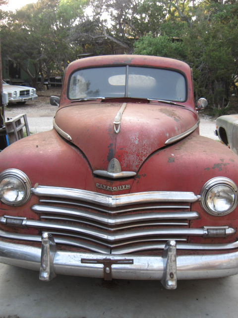

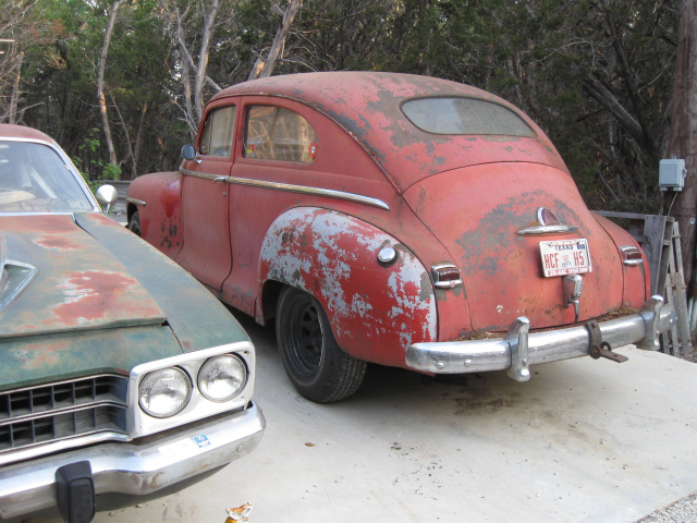

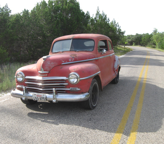

    The Lone Star Roundup got me all revved up. This thing has been sitting here waiting on me. It ran & drove enough to take it into town a few times, but warmed-up oil pressure issues and a slippery trans meant that was as far as it went.

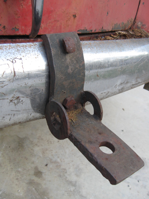

    I love this thing, I love all the art deco touches like the taillamps, and I love the hitch the guy welded up for it. I don't love that he used the ENTIRE wiring harness from the donor car. There is nine miles of wire in this car, eight of it wrapped, coiled, or hanging loose and going nowhere. I think two would run the whole buggy. The whole clusterfuck is coming out, I scored a wiring kit from a car buddy. That's near the top of the list once the big leaky lumps come out.

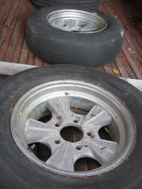

    Had picked up these from an old hot rodder for the front, one wasn't salvageable and the good one won't hold air in the tire for long... but this is what I'm going for. Black steelies in the back. What interesting steering wheels (remember, GM column) would I have seen bolted into mild street cars like this in the mid '60s?
    Lastly, anyone know when the red white and blue Garlits tach came out?
    I appreciate the '60s detail help and info.

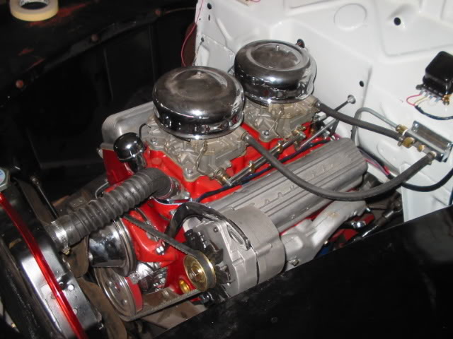

    HAMBer Greezy posted this pic, not sure if it's his or not (and I hope it's ok I use the pic here) but if realistic circumstance leads me to SBCdom, this is about the prettiest thing to my eyes... I wouldn't mind having that under my hood at all, honestly.

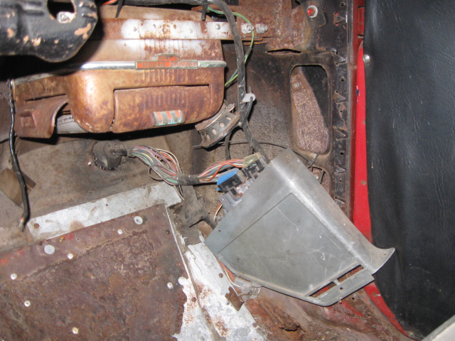

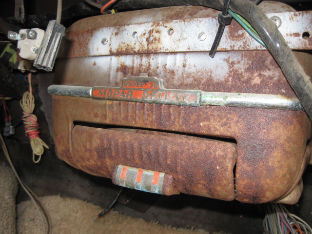

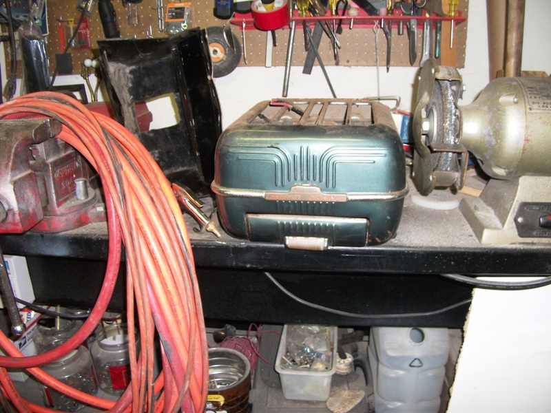

    Well guitard, your Plymouth is the first I've seen with the same heater I have. The Eastern cars all had a much bigger heater under the hood.

    Ulu - is it? What can you tell me about it? It's something I'd like to have working for sure. Is there a 6v blower in there I need to fit a 12v in place of... any suggestions?

    It'll be real obvious once you get it out. You can see the 6v motor from the top & the fan is visible from the bottom doors.
    It looks very similar to any 12v GM blower motor, from what you can see externally, so there are probably lots that will fit. I've got one stashed away somewhere for it, but I can't recall what it came from. Possibly from an old Chevy.

    Oh yeah, if you use a GM, check the rivet with the ground wire from the brush to the metal case. On many, it also went through a small insulation board. That wears from vibration, and the ground loosens up eventually on OEMs.
    I've seen aftermarkets do this in 6 mos! It took my Caddy several years.
    That insulator is only needed on the hot brush wire, but the ground rivet helps hold it in place at assembly. Anyhow, I've replaced those rivets on a few cars, to get the insulator out of the connection, and that fixed it permanently.

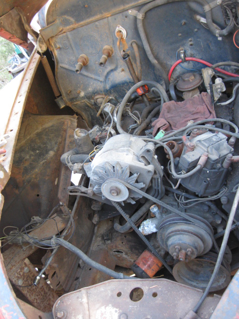

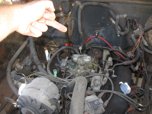

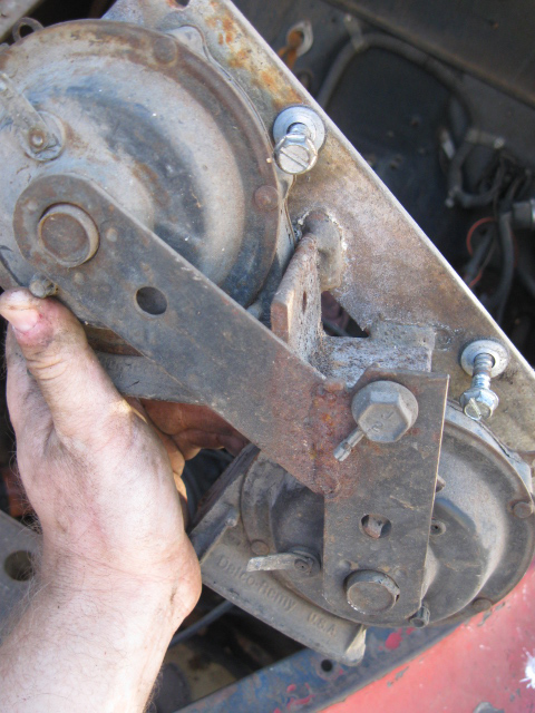

    Well, round one went well. This thing is coming apart easy. The radiator was wedged in, held in place by the hoses & tranny lines. The elec. fans were held to IT by one piece of bailing wire. And on closer inspection, the inner fenders aren't doing much - they're not connected down low, just to the fender up top. They were intimidating me because of the tight engine compartment; five bolts later, that passenger side flop-fest is coming out. If the driver's side is the same (I'm betting it is), ie providing no support or attachment points to the fender, out it comes. To me, this means great airflow through the engine compartment and NO space issues. Cool.
    First pic is "Before" and my impression of twenty lines & gadgets coming off a carb, a hammering smoky no oil-pressure having greasy lump, and ten miles of wiring under the hood, most of it going nowhere...

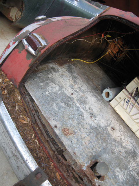

    This is the kind of stuff I love... long ago, this was one guy's project for his project. Probably had the cassette player going, maybe a dog lying in the shop. Probably a cold Coors in a can. And some scrap metal... and an idea of how to mount his horns in his ride. This was one man's evening in his shop. I'm honored to have it.

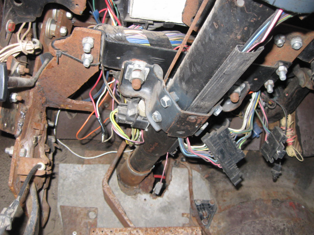

    guitard

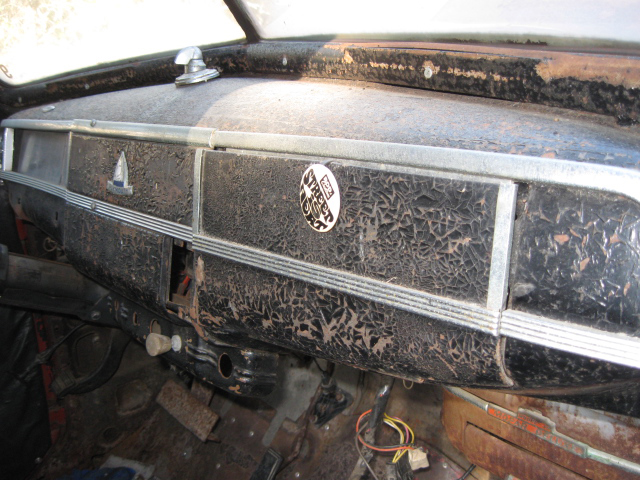

    THIS is the stuff I DON'T love... all this probably seemed like a great idea in 1988. And I do have my work cut out for me with the floor rot... I've never welded anything in my life. Methinks that's about to change. Of course, I've never wired up a whole car either, so what the hell. Welding 101, wiring 101.
